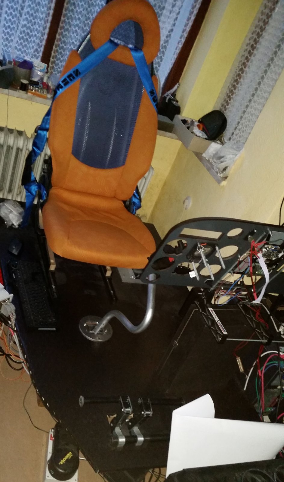

    my static EC-120 flight-sim shall transform now to a base in motion.
    Some information about me:
    During mechanical engineering studies in the 1980's I started learning and development of CAD and joined to the engineering bureau of my dad. Together we made many different prototype machines for other factories.
    Since I had always developed the CAD software for our office, I came to a trade fair company in the early 1990s to develop aid programs for trade fair planning.
    In 2005, I started to develop tuning parts for model helicopters. In 2010, our first 3D printer came to the office, with which we then produced scale add-on parts.
    At the end of 2014, a model mate wanted to have parts for his XPlane Simulator. That was the start of our replicas for helicopter controls.
    Of course I also had to build a cockpit to test them.
    And the journey started.....
    This is my base which I used with beamer and a 3m screen right in front the cockpit nose. Now I use a Oculus rift.
    And now the desire of converting it into a motion system grows.

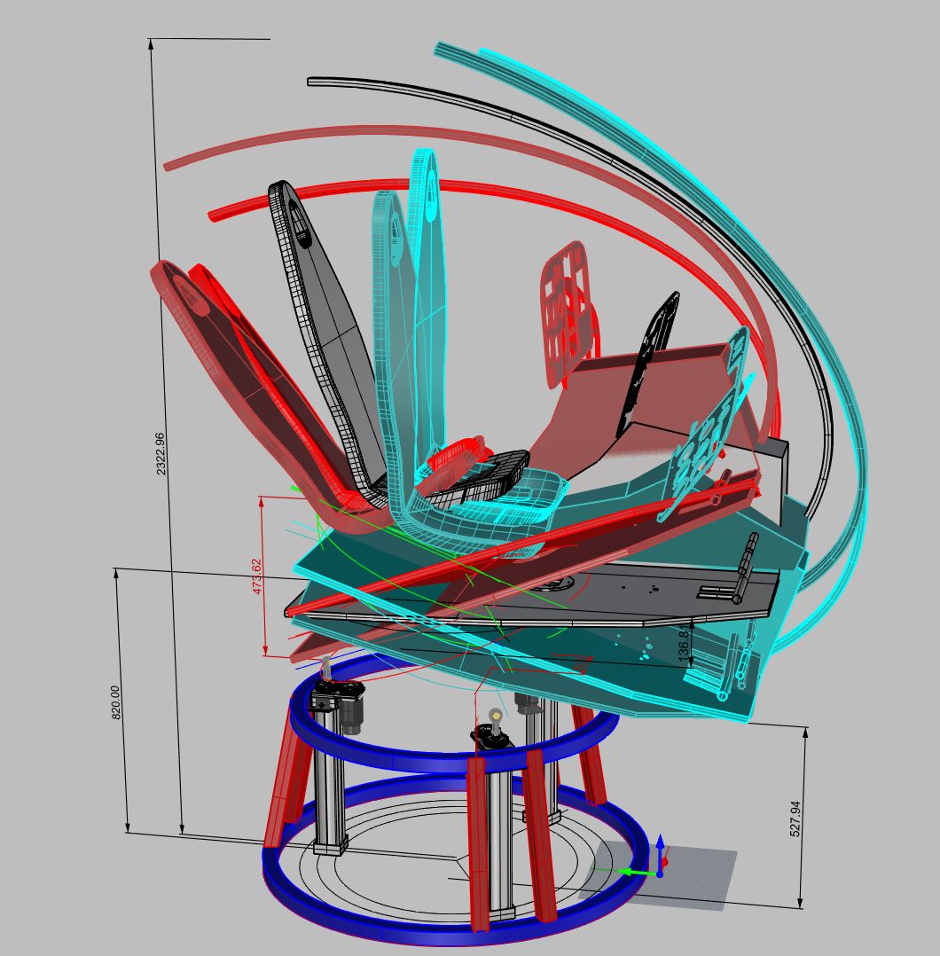

    before starting the design process I try to evaluate the different stages of realism.
    First I have to decide what deflection my platform should make.
    I am not the youngest and I am not a coaster fan:(. But without motion hard flying in the static pit made me sick too. The 8 vibration units in my seat reduced it significant.:thumbs
    At moment I think that the system should be at least a 3DOF with pitch, roll and heave.
    Therefor I need 3 axles with enough force to move the platform.
    For a complete 6DOF, the single forces can be lower, but I need 6 units. :think
    Some time, I also thought of the fluid muscles from FESTO, but this is too costly , as anyone could copy it. And it would make to less movement inside their specs :(.
    For a "standard" system would be the decision between linear actuator and wormgear-DC drive with lever.

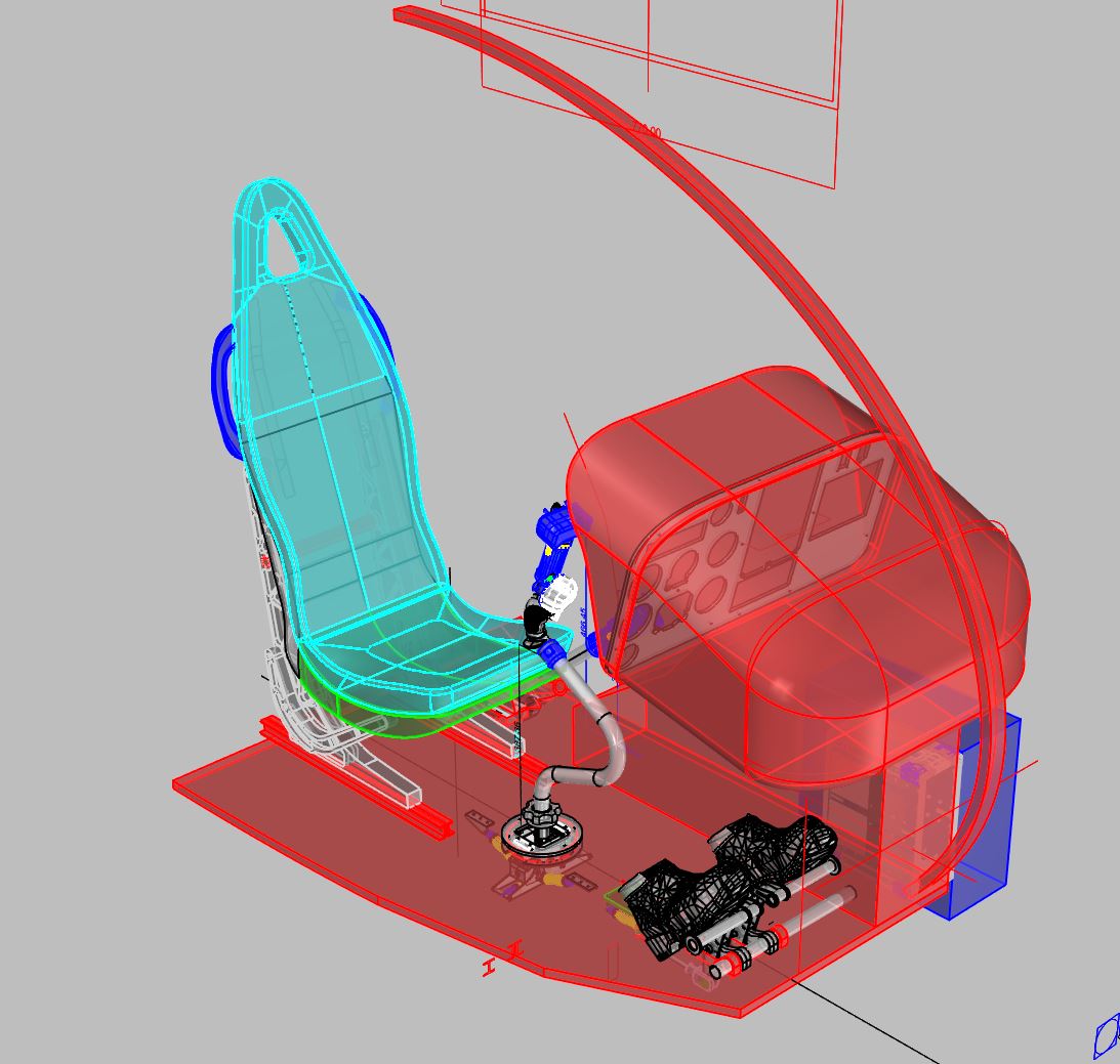

    and this should be moved:
    plus some "too heavy" pilots:(, so the base should be able to move between 200 and 250 kg with adequate dynamic.

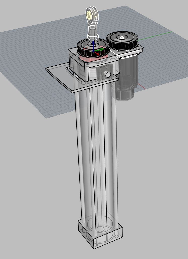

    some decisions are made.
    First version will go 3DOF.
    I will design my own linear actuator.
    • lift force 2000 N
    • speed 100 mm/s and more :D
    • total movement 500mm
    • driven by closed loop NEMA 23 3Nm at 50V (round about 370W)
    • driven spindle nut, not the ballscrew spindle 20x5. This will only moving linear (less vibrations and less bearings)
    The moving base should reach in this state of planing:
    • +/- 20° pitch
    • +/- 20° roll
    • +/- 100 mm heave
    • Speed 100mm/s at an estimated weight of max 300kg.
    grey version shows the leveled flight. The colored are 20° pitch + 20° roll.
    The angles seems to be really big.:grin

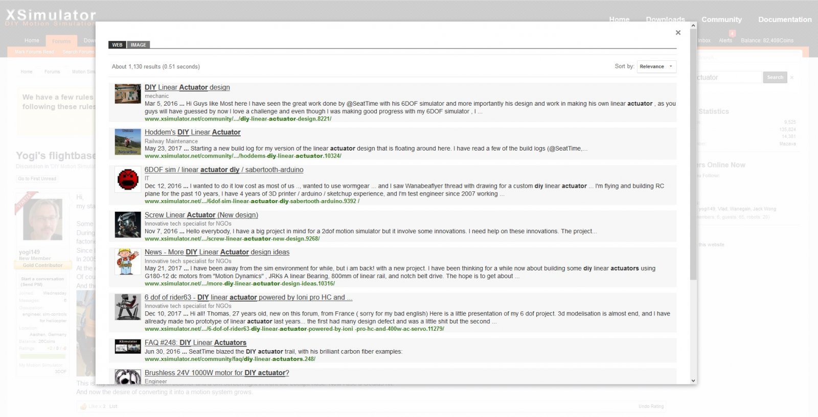

    BTW: I tried to find something similar in your FAQ, and in the motor and hardware section. I read nearly every thread back to 2009. Why are there so much threads that have no active pictures in it (dead links inside this forum) and why are so many threads stopping after only 1 reply, but no answer? That is really frustrating :( The most frustrating threads signed to a thread where I came from 2 or 3 posts earlier. (But perhaps that could be a joke I do not understand)
    Some interesting looking threads sign unfortunately to threads which seems to be deleted, and showed only 404.
    I try to be not so frustrated and hope that I can perform this thread to a functioning moving base.
    21,511
    150,686Coins
    +11,018 / 55 / -2
    There is a DIY actuator thread in the FAQs: https://www.xsimulator.net/community/faq/diy-linear-actuators.248/
    And you will find many member variations by using the Custom Google Search box toward the top right of pages.
    While some are far more detailed that others keep in mind that member threads are not How Tos, rather they are what members share, sometimes they are deleted by members and sometimes members link to off site information that may change.

    Hi noorbeast,
    yes, I used the FAQ, and yes all link pointed to the same thread. And yes, this thread was found through the search too.
    And yes, even the google search pointed to the same thread, because this link seems to pop up in every thread someone search information about linear actuators.
    That's like driving a carousel, but you don't really find any new information.
    But I will try to give technical information for my design, so others can use them for variants or simple rebuilds. :thumbs

    I am not sure I understand what you are looking for, or are finding information hard to get at, as there are a range of members who have built and added their own refinements to DIY actuators, perhaps I am missing what you mean, but I do look forward to following your own approach:

    Hi noorbeast,
    have you taken a look to the 4. link you show?
    1 round more. :thumbs
    But this will be a thread for my motion base. And I promise that no information will deleted here. :think

    Again I don't get it, search results are by nature going to bring up all relevant comments including previous ones concerning the FAQs, but I guess I am just missing the point somewhere.

    how shall I explain: if the link shown in the FAQ drives you direct to a link that says: take a look in the FAQ, this seems to be without any sense for me.
    And that should be all to this theme, please.
    Interest for a flightbase does not seem to exist here. (no hints, no comments:()
    And I do not want to have a monologue about this here.
    So I will probably continue this thread only when I come across software problems.
    21,511
    150,686Coins
    +11,018 / 55 / -2
    If you mean this thread: https://www.xsimulator.net/community/threads/screw-linear-actuator-new-design.9268/
    Then what that indicates is that the thread starter never progressed the thread any further, but it will show in a search results because Xsimulator.net is a member thread based site, it is not curated, information is whatever members choose to post.
    I hope that clarifies how Xsimulator.net works, as a member based site.
