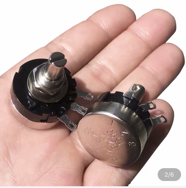

    The yaw swing arm now has a situation, that is, when it slowly swings to the extreme position on one side, it will suddenly return to the extreme position on the other side at a very fast speed. This situation occurs when the vehicle drifts around a circle. Is this normal?

    What type of motors and sensors are you using ?
    Do you antrollover selected
    Is washout enabled

    600w12v DC motor, rotating adjustable 300 degree carbon film potentiometer. The sequence file can only work on one side when washout is used. I only play drifting and I am not going to use yaw to switch to extra1.

    this is normal but not correct! it happens when you reach to the extreme position, means +180,next is -180 and not +179! so your actuators try to move fast to the oposite side, this problem discused before a few times in the community and i think it can be solve by adding a few more line code, i donno maybe there is a filter or washout in the Simtools...

    When it comes to drift the axis used should really be traction loss (pivot point near feet) not yaw (central pivot point). Yaw is useful and realistic for say a helicopter, but in a car is mainly relevant in a spin, whilst traction loss relates to the rear end breaking loose, as it does in drift.
