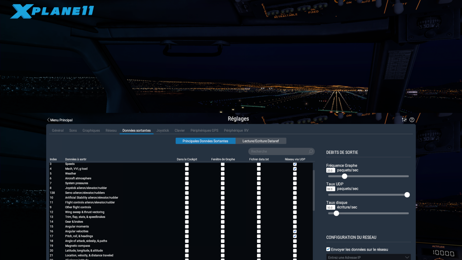

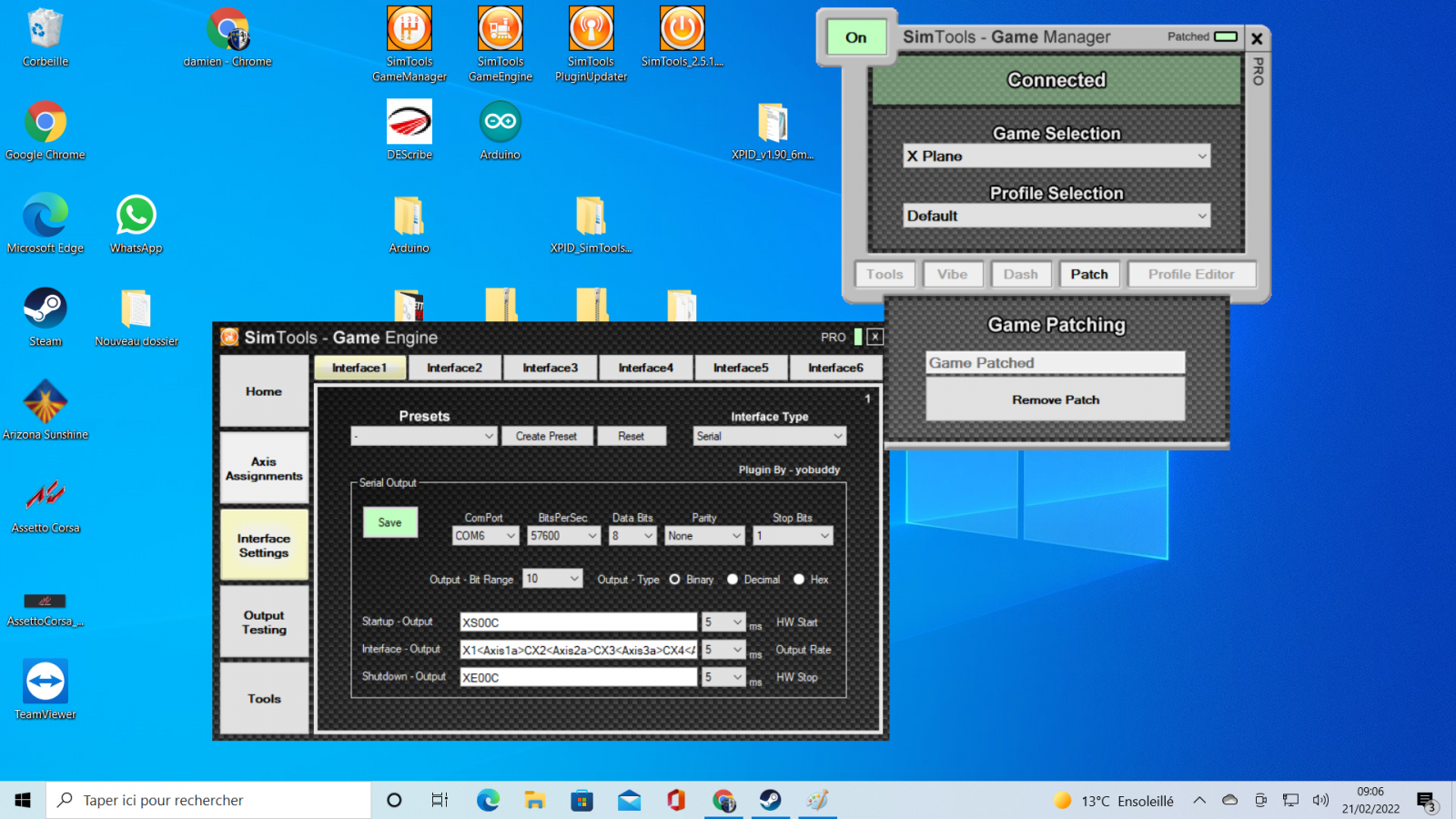

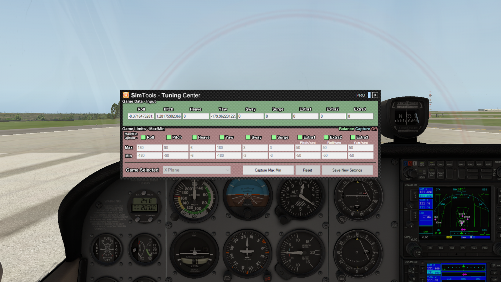

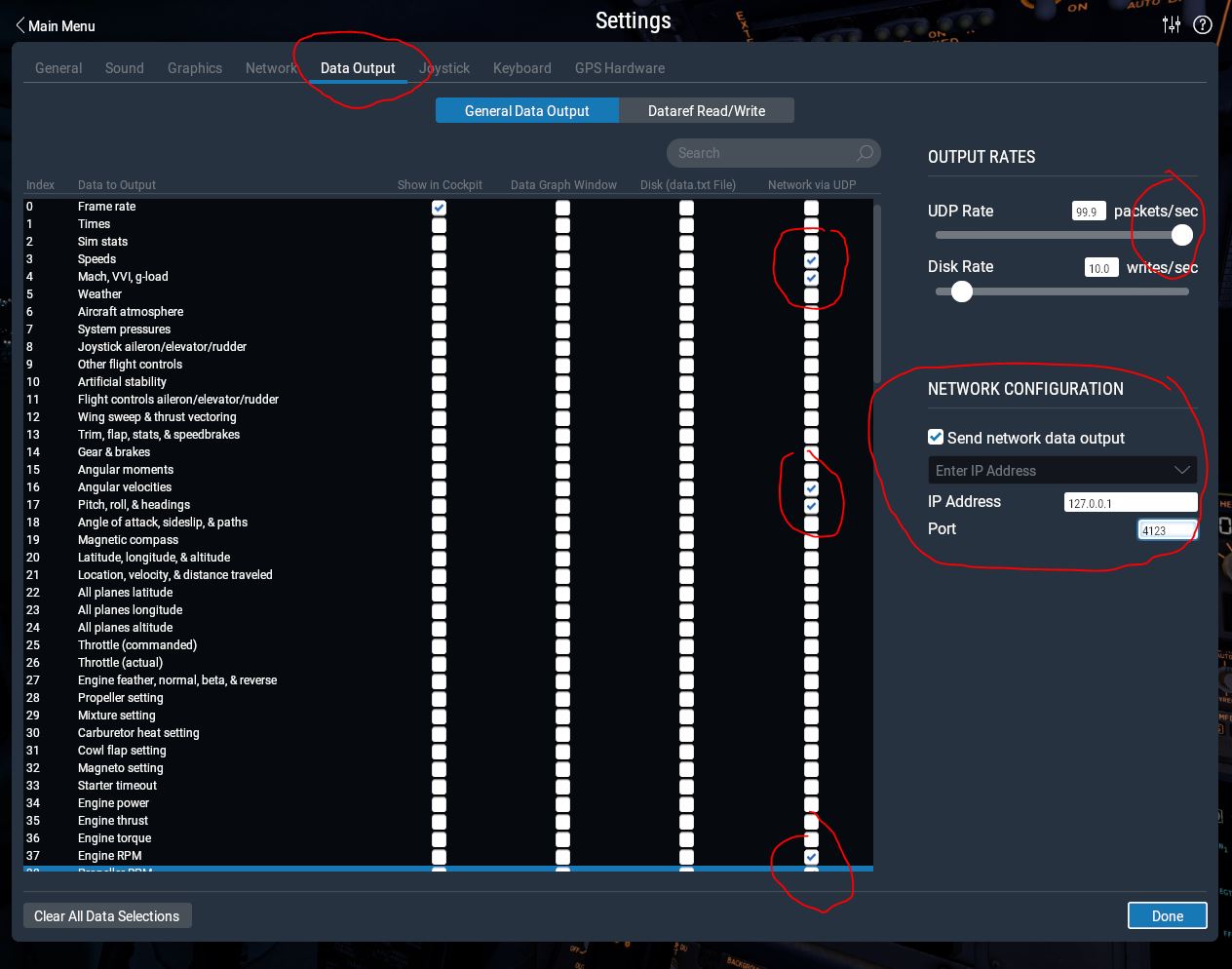

    Hello I have a problem. after installation I do not have all the information coming out of the game.
    I have ROll PITCH YAW which works but I don't have SWAY and SURGE there is no data coming out.
    I have checked the checkboxes in the game everything is good
    I reinstalled the plugin and still nothing.
    Do you have an idea to solve my problem?
    Thank you
    22,219
    154,783Coins
    +11,217 / 57 / -2
    Can you please post pictures of all of your settings, including the Tuning Center while the game is running.

    Do you need somthing more ?
