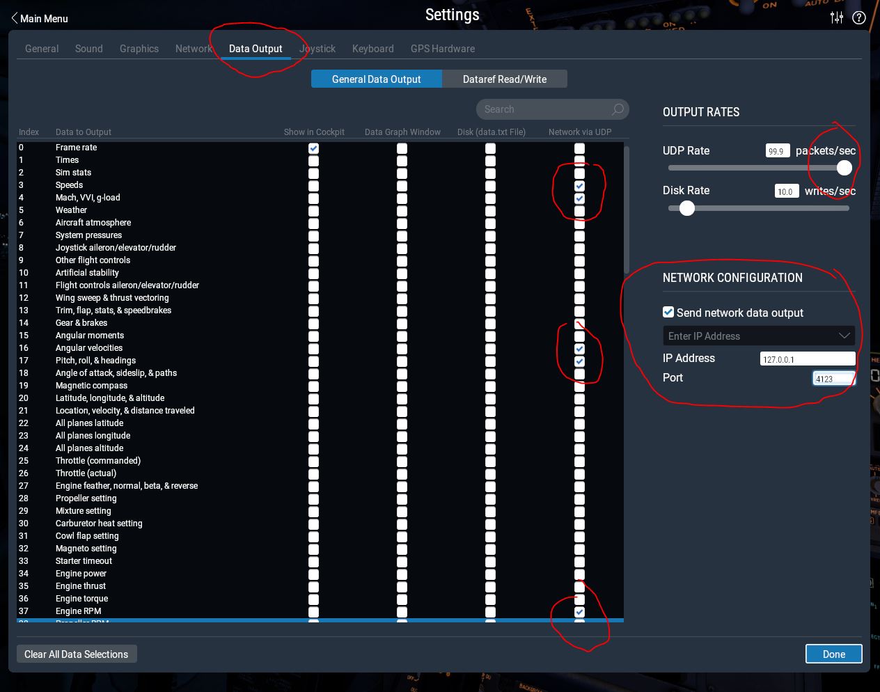

    Hi all,
    Just starting this thread as a guide for users on how to setup X-Plane 11 through Simtools and depending on your motion system, how best to set it up for maximum realism. I will try and update it as new things come along.
    Thanks to @Archie @noorbeast and @SixDegreesOfFlight for their contributions thus far.
    https://www.xsimulator.net/community/threads/x-plane-11-6dof-motion-platform.10542/page-13
    Getting SimTools to talk to X-Plane 11
    Download SimTools and apply for or purchase the license. When it asks if you want to start SimTools with Windows click Yes to both the Manager and the Engine.
    Download the game plugin for X-Plane. Even though it is quite old now, it still works with the latest version of XP11
    Using the SimTools Manager apply the patch to XP11.
    To install the plugin use the "SimTools_PluginUpdater" located in the root Simtools installation directory
    Step 1: Getting SimTools to talk to X-Plane
    To get SimTools talking with X-Plane, start XP and Click on Settings > Data Output
    Now that you have the screen with all the checkboxes, check the following items in the last column "Network via UDP"
    3 Speeds
    4 Mach, VVI, g-load
    16 Angular velocities
    17 Pitch, roll, & headings
    37 Engine RPM
    38 Propeller RPM
    Check the box, 'Send network data output' and enter IP Address 127.0.0.1 and Port 4123.
    Set the UDP rate to maximum (99.9 packets/sec)
    NOTE: After you patch the game you may need to relaunch and check the dataoutput settings in X-Plane 11 ,as it added many more data points no.s 0,1,2,13,14,15 etc when I patched it. Untick these as it seems to make the game engine crash if they are all ticked. Stick with the data outputs above only.
    For the time being, that's all you need so you can close X-Plane.
