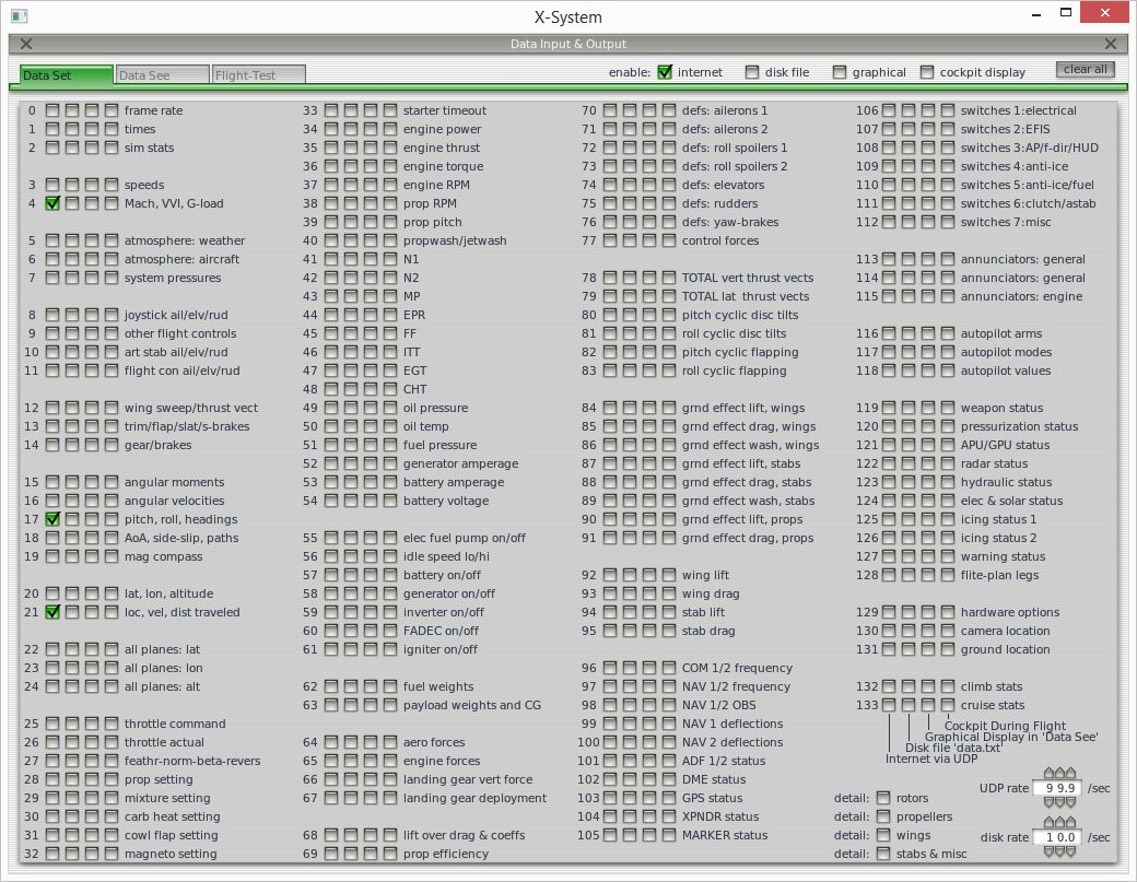

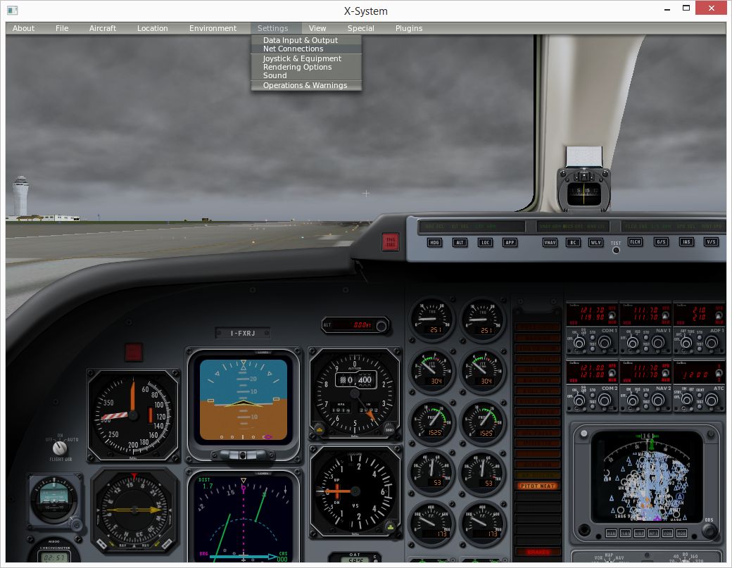

    Hi @ericRacer
    I don't have X-Plane V9 available but let's try. Use the corresponding menus with your X-Plane V9:
    • Patch the game with GameManager.
    • Start GameEngine and X-Plane
    • Select Settings - Data Input & Output in X-Plane
    • Check the box Enable Internet and select the following 3 entries (and only these!)
    ▫ Mach, VVI, G-load
    ▫ pitch, roll, headings
    ▫ loc, vel, dist traveled
    They are possibly not located in the same slots as in V10. This is not important. What is important though, is the order in which these values are (Mach first, loc last). If this is not the case, please tell me.
    On the bottom right enter 100 as UDP rate.
    Close the Data Input & Output window.

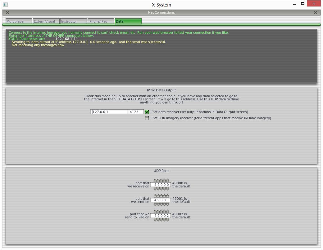

    • Select Settings - Net Connections
    • Check IP of data receiver.
    Enter the IP address of your 2nd PC (where GameEngine is running) or 127.0.0.1 if you're running SimTools with a single PC setup.
    Enter 4123 as port.
    Close the Net Connections window again.
    If this works fine, you should now receive data in the GameEngine Tuning Window.

    thank you, you are the man ! :thumbs
    It works fine (the communication !) i receive the data on my second PC ! :D

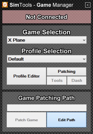

    HI @value1
    I am new with this... I downloaded your plugin... I drag and drop into the plugin installer... but the Xplane doesn t appear at GameManager... Probably I skipped something...
    any help will be appreciated!
