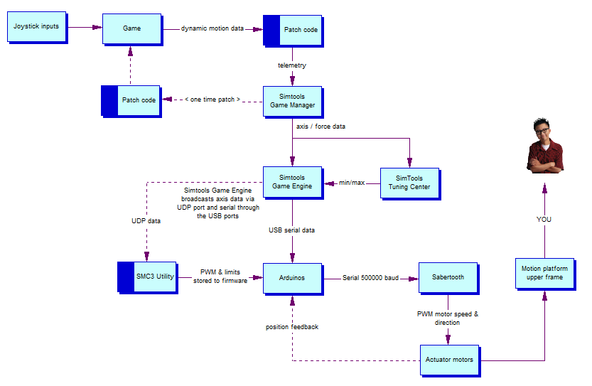

    I am still trying to understand how Simtools works overall from a systems perspective and have tried to diagram the flow. Is this right?
    Finally, I can set the PWM/limits/settings by SMC3 Utility - are these values stored in the Arduino, Sabertooth or somewhere else?

  6. SeatTime
    2,572
    I use Assetto Corsa or Nolimit 2 for Testing. Have not driven LS for a long time. The SMC3 Utility changes the settings in the Arduino sketch. Simtools has no connection back to the Game software.

    Thank you - it makes sense to store them in the Arduino firmware. I do have Assetto but it might be easier to use Nolimit 2 because it doesn't need a joystick. Would you mind having a look at my depiction of how the whole Simtools system works to see if my thinking is correct please? When I started out at the beginning of the build, I read everything I could find but couldn't find anything like this diagram to help with understanding how Simtools and SMC3 worked together. Thank you

    @noorbeast
    OK thank you. So does the patch send the telemetry directly to the SimTools GameEngine module where the user settings are applied and then sent out on UDP? I know you are saying that SimTools has no connection to the game but what role does the GameEngine play then?
    Sorry if these are annoying noob questions, its just that I haven't seen it explained in a way that noobs can understand :(
    22,045
    153,866Coins
    +11,152 / 57 / -2
    Game Manager acts as a connector between the game and the SimTools Game Engine, it extracts and delivers forces and values from game to the SimTools GameEngine, along with other functionalities such as patching a game and storing profiles. The Game Engine is a connector and controller for the motor interface of your motion simulator. The Tuning Center lets you tweak Min/Max values to ensure that the motion you output to your simulator is as refined as it can be.

    Perfect! Very clear thank you for a concise explanation :thumbs

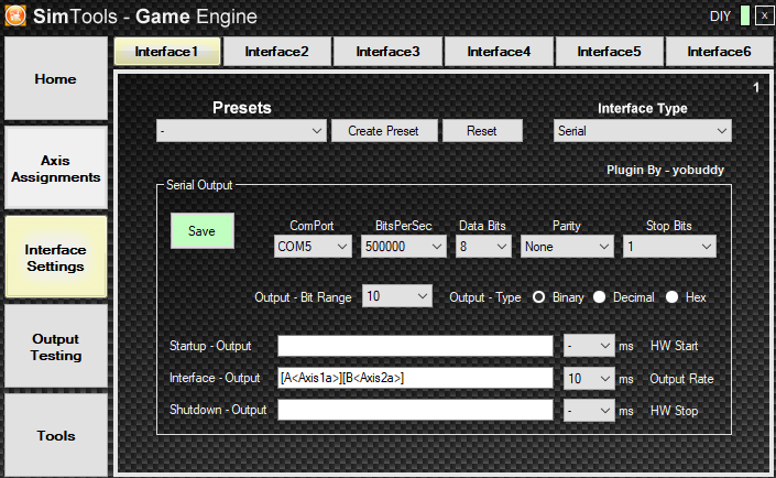

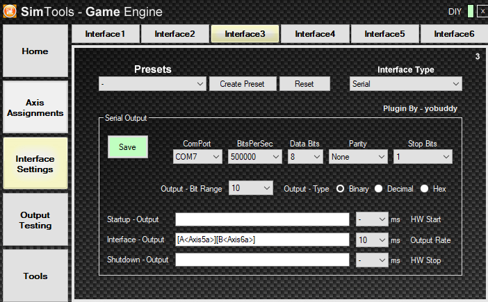

    This is probably not much interest to anyone, but when I was Output Testing with SimTools actuator pair 1&2 on Com port 5 would not budge. If I shut SimTools down and loaded SMC3 Utils they both worked fine o_O
    As I am starting to get the hang of how all this works I thought I would remove the 3rd axis from the interface string ... bit of a long shot.
    So from this: [A<Axis1a>][B<Axis2a>][C<Axis3a>]
    To this: [A<Axis1a>][B<Axis2a>]
    ...and it started working. Go figure :cool:
    Mind you the other two Arduinos were working fine with the 3rd axis.
    I have since changed Interface 2 & 3 as well so they are all the same.

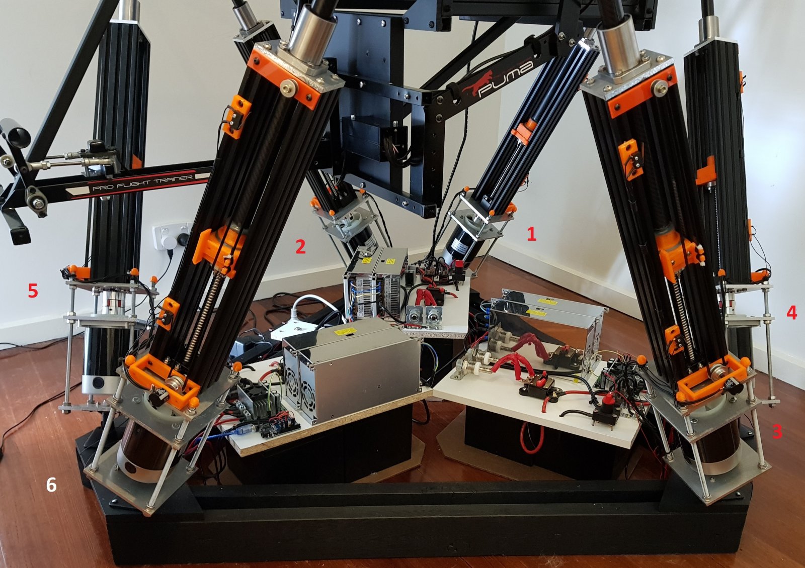

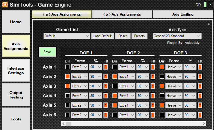

    The interface settings for all the actuators is shown in images 1,2,3
    I worked out which actuator corresponded with the axis in SimTools using the DOF3 Heave force. After setting axis 1 only to Heave and all the others to blank, I watched which actuator moved. I then reset axis 1 to blank and set axis 2 to Heave etc. In this way I was able to work out the numbering system shown in Image 4.
    Once I knew which actuator was which I could set the direction for roll, pitch etc. images 5&6

    To get SimTools working with X-Plane @noorbeast kindly gave me a link :thumbs which had this in it:
    In the Data Output settings, last column "Network via UDP" click
    3 Speeds
    4 Mach, VVI, g-load
    16 Angular velocities
    17 Pitch, roll, & headings
    37 Engine RPM
    38 Propeller RPM
    Click Send network data output and enter IP Address 127.0.0.1 and Port 4123. I also reduced the UDP packet traffic to 10.6 packets/second. Edit: 10 packets / second doesn't sound enough seeing as the baud rate between the Arduino and the Sabertooth is 500k baud. I will play with this to see what effect (if any) increasing the traffic rate.
    Once I had put those settings in, I closed X-Plane. I removed the patch using SimTools Manager and applied it again. However, I had to disable SimTools Engine from starting with Windows because it would crash when X-Plane 11 started. So what I am doing now is starting SimTools Manager with Windows then starting the Engine manually once XP is running.
    Now comes the fun part .. PID tuning and tailoring it for XP hug:

    @noorbeast
    You are spot on! I have opened the Tuning Center and could see the values coming through but had no idea what to do with them once I had captured them. Looks like more to learn - the link you sent was very helpful. I will need time to get my head around this new software.
    Before I start, can you explain what the best approach would be for getting the ballpark figure for SimTool Force % on each DOF? At the moment I have wrongly set them all to 90% but one statement in the link says "Total axis allocation should be around 100%" - does that mean, reading horizontally across for each axis should add up to 100%.
    It is a little over three months ago that I was only thinking about a motion platform :)
  20. noorbeast
    22,045
    153,866Coins
    +11,152 / 57 / -2
    Yes ideally reading horizontally across for each axis should add up to 100%.
    For flight sims filters also come into play, but first focus on the fundamentals, do each axis/force one at a time, including Tuning Center values, then turn them all on and tweak.
