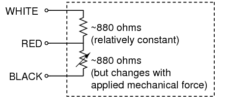

    2 common types of load-cells
    - you have 3 wires load-cells
    20100816-3wirestraingauge.png a single resistor is variable under load​

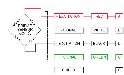

    - or and 4 wires load-cells
    wc1a.jpg 2 resistors are variable under load​
    Some Theory
    Here you can find some theory nicely explained :
    As far as I understood the point,
    - 4 wires load-cells are in Wheatstone bridge configuration and that's the best for measuring the small variation of resistance.

    - 3 wires load-cells, like Fanatec brake pedal or any low cost chinese load-cells, are only half bridge...

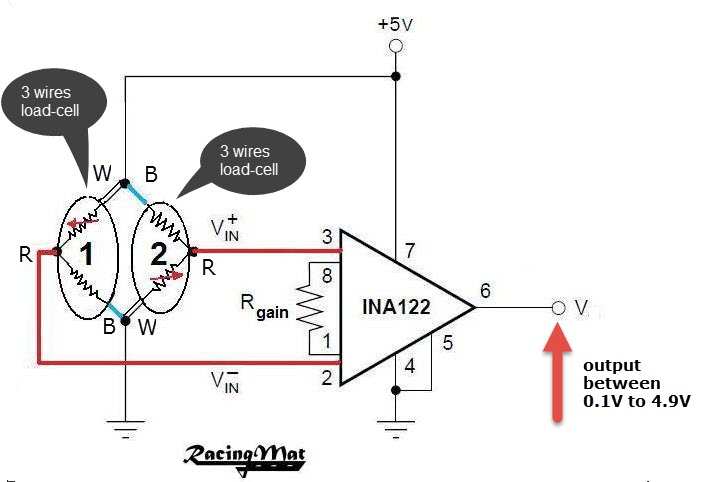

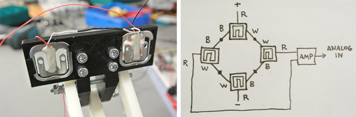

    but you could increase sensitivity by using
    - a pair of them back to back : like I did for DIY brake pedal

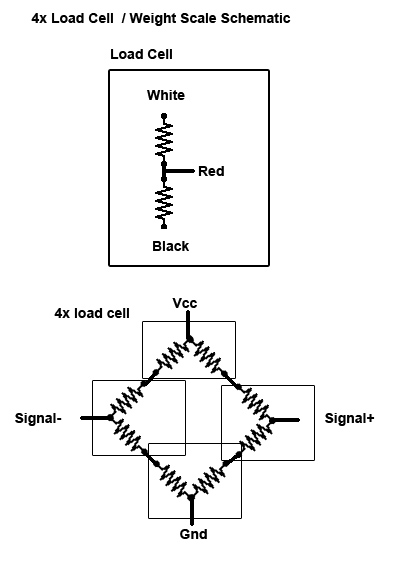

    - or by four : http://www.neuroproductions.be/experiments/6-axis-robot-arm/

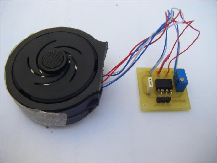

    - or if you want to use a 4 wires PCB amplifier with your 3 wires load-cell: you can proceed like Jet Badger did

    INA122 PCB board is perfect for turning a laod-cell into a "potentiometer":
    the output is an analog voltage
    the price is around 10€ (chip, PCB...)
    http://www.ti.com/lit/ds/symlink/ina122.pdf
    Operation supply voltage range: 2.2V to 36V

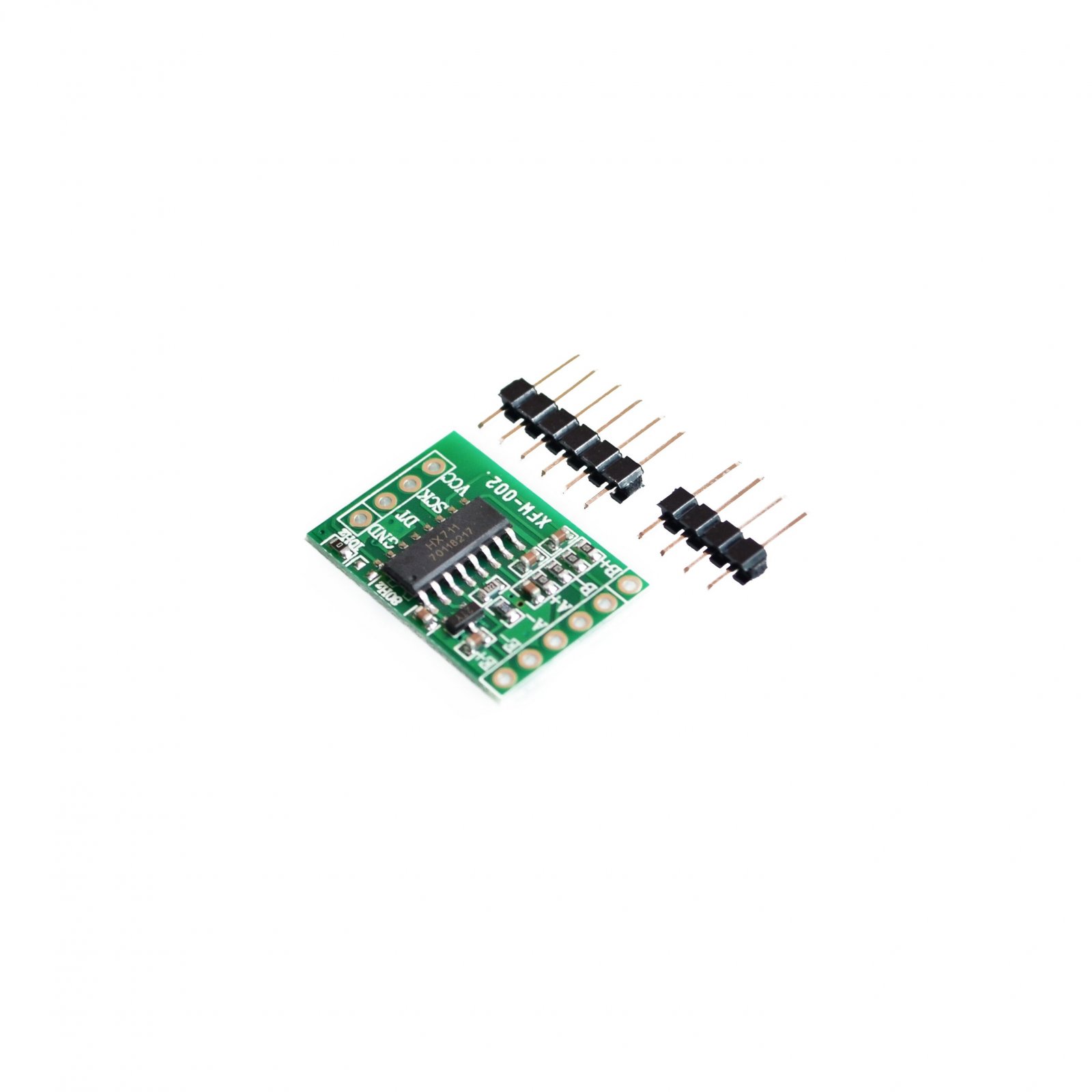

    HX711 is really low cost
    0,6€!
    but the output is serial communication: it requires an arduino or a microchip establishing a serial communication
    .jpg
    Operation supply voltage range: 2.6 ~ 5.5V
    https://cdn.sparkfun.com/datasheets/Sensors/ForceFlex/hx711_english.pdf

    Just one point to add about using two separate load cells for a full bridge is that they need to be matched exactly in resistance otherwise there will be an inherent difference that gets amplified via the comparator. This is not a resistance that can be measured with a multi-meter as it is too small. I noticed this on one pedal that I made where it looked like the accelerator was being pressed ever so slightly.
    Great write-up!

    Thanks guys!
    Yes @Alexey, indeed the pair of load-cells should be exactly the same!

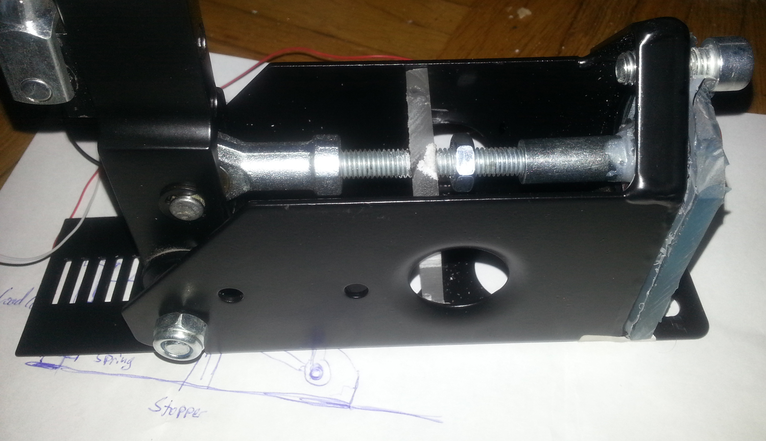

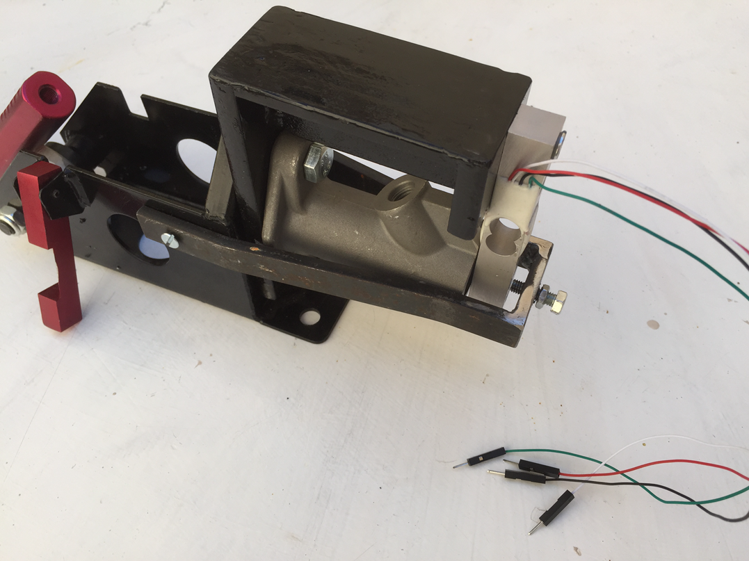

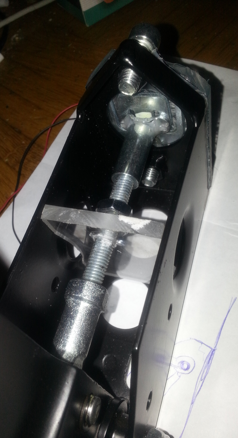

    so i made some further testing on my Handbrake with the Fanatec loadcells. I found a great Info sheat how to use only one of them.
    http://www.fut-electronics.com/wp-c...Tutorial_for_Load_Cell_weight_sensor 50KG.pdf
    At the Moment I get some readings rom 0.6mv to 2.6mv. I can't press with full pressure because the handbrake is not mountet yet. I hope I'll recive the in122 this weekend and try to amplify the signal.

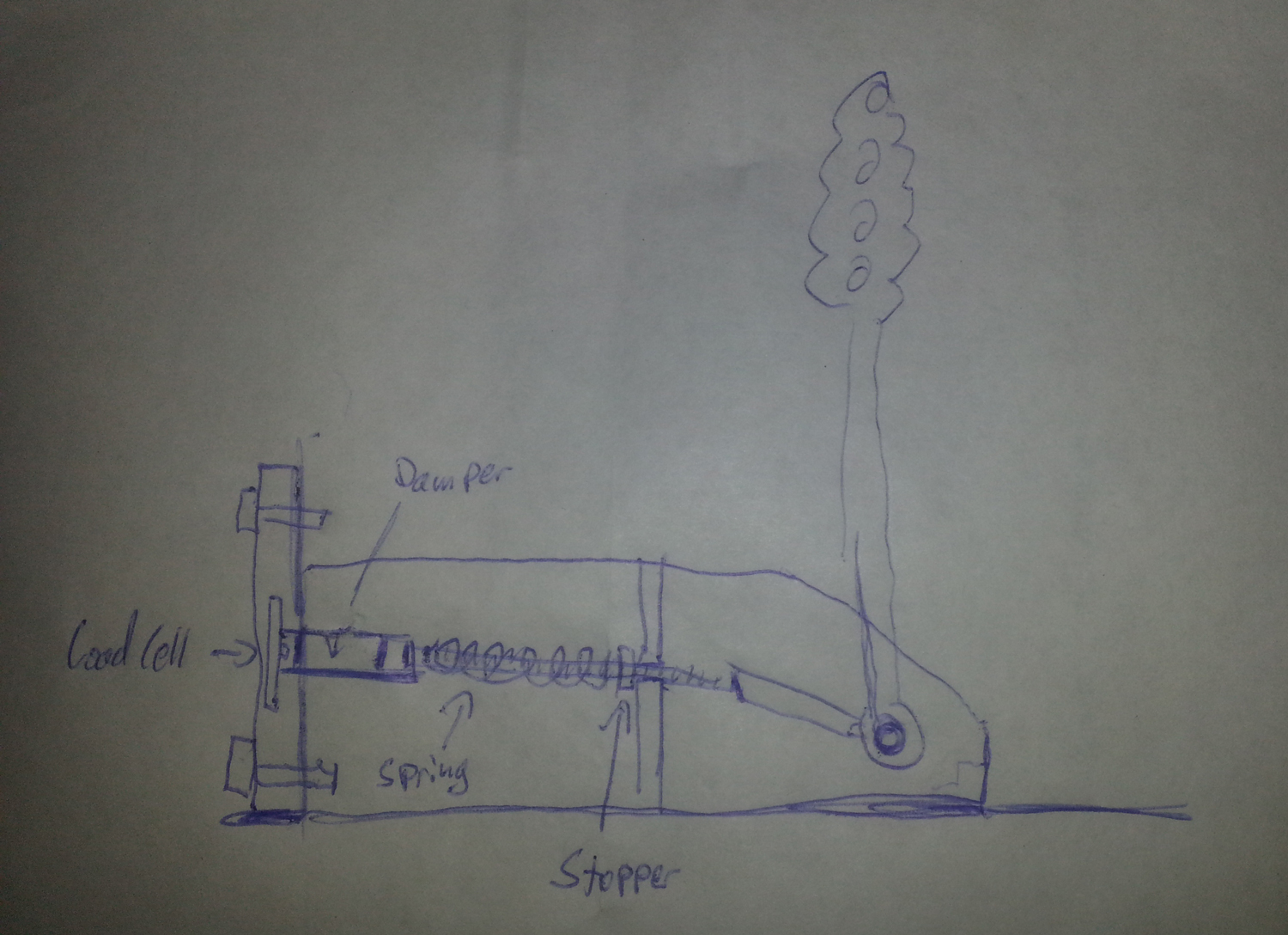

    Here is a Picture of the current test setup. I have only plexiglas as building material at home. There is also a little sketch so the hole concept is explained.

    thanks @tombo! nice document about 3 wires load-cell

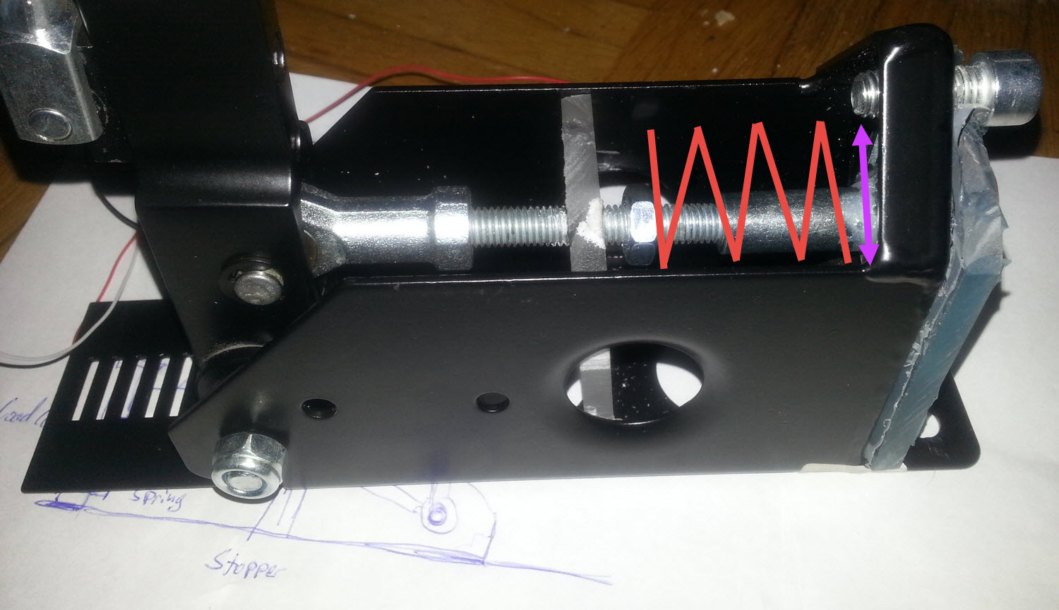

    about your design, here are my thougts :
    - it's good to have a mechanical stop behind the load-cell to prevent over-pressure (that could destroy it)
    - what is the purpose of your spring? in the configuration you drawn, your spring does nothing...

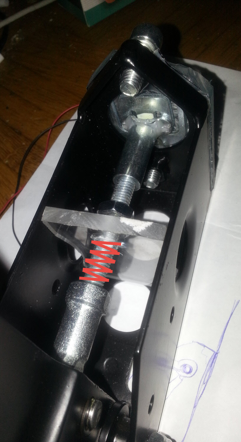

    I have some kind of mechanical stop but you can't see it. I milled the form of the Loadcell in the plexiglas so it can move and at the end stop at the plexiglas.
    For the Spring, maybe I'm a little bit stupid but it should bring the lever back to start position.
    If the spring would be between the nut and the tube at the loadcell it will compressed when you pull the lever. I'm anyways not shure about position of the spring maybe in front at joint and plexiglass.

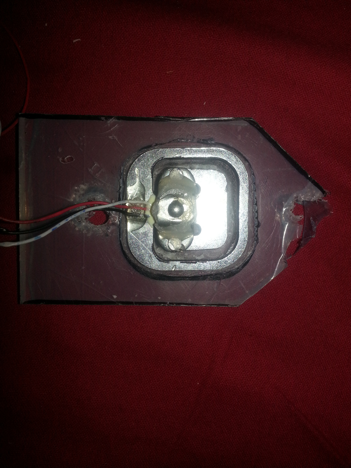

    I get my notice today that my parcel with ina122 will arrive in next 2 days so I will keep you updated with the final result at weekend hopefully.
    Here are some pictures. You can see its broke at the upper hole. Plexigas isn't the right material for this. I will try aluminium.
  8. RacingMat
    2,233
    21,085Coins
    or here but much larger: it should not touch the load cell itself 1.jpg

    thanks for your explentation.
    I'm woking on the design anyways and added a plexiglas plate which holds the tube. Now the pressure of the spring is against this plate.

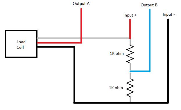

    Today I managed to get the qater Bridge loadcell design working. It semms that my loadcells are very cheap, because all of them, output a little voltage when no pressure is applyed. It's the same at my fanatec break pedal where I used them as replacement.
    Maybe i change the resistors again. As RacingMat mentioned low toleraqnce ones will be good. I'm currently using 2,2Kohm instead of 1K in the above tutorial.

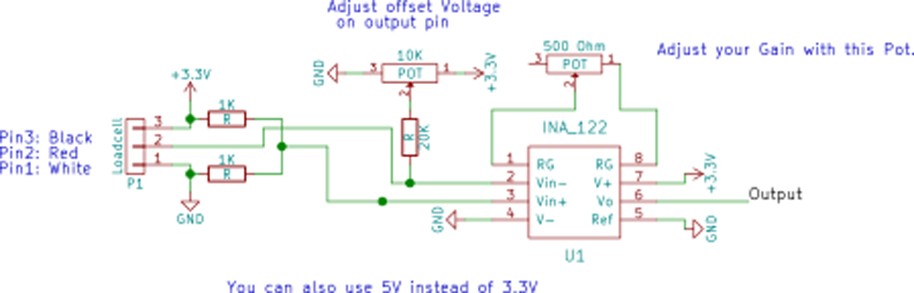

    @tombo, you have to use resistors that are the closest to the internal resistors in your load-cell!
    measure between the 3 wires:
    you should find something like 1 kohm, 1kohm, 2 kohm
    or X kohm, X kohm, 2X kohm
    therefore you have to complete the bridge with X kohm resistors
    not other values! if not, the bridge would be unbalanced
  11. Alexey
    Alexey Well-Known Member
    Sep 23, 2014
    452
    Electronics Technician
    Adelaide, Australia
    8,066Coins
    +623 / 2 / -0
    It's not so much using the same resistors but having the same ratio. What you are looking at is called a voltage divider. When the load cell is strained or compressed its internal structure changes and thus creates more or less resistance, almost like becoming more dense (less resistance) as it is compressed. The change in resistance causes an imbalance in the voltage divider and that is what you measure. Unfortunately this change cannot be detected using a multimeter which is why we use a comparator to detect the change and then amplify it to something we can measure.
    Using plain old resistors on one side of the full bridge is setting the 0 point of detection, so it should match the ratio of resistance from the other side. The comparator looks at the voltage output of your two passive resistors and compares the voltage to the voltage coming out of the load cell voltage divider. The comparator will then amplify the difference in voltage.
    Using passive resistors is never going to be perfect because of component tolerances.
    When a load cell changes resistance due to strain it changes at a rate of about 0.04 ohms per kg of load (different cells will have different values but in the same ballpark). Your standard component tolerances on a 1k ohm resistor even at +/- 1% tolerance is a swing of 20 ohms which is 500 times the size of one 1kg change in the load cell.
    Basically what I am saying is that it is virtually impossible to match a load cell with passive resistors.
    One way you might be able to do it is with potentiometers. Set up the full circuit, have no load on the load cell and adjust the potentiometers until there is no voltage on the output. Sounds simple but it can be quite tedious.
    I'm terrible at explaining things but I hope it helps.

    for me it helps, I've done it like you said and I'm able to use my handbrake with quaterbridge design.
    I've had some ussues but finally find out that these are caused by my gear indicator. If it is plugged into usb the handbrake readings go crazy.o_O

    Ok,
    the upper circuit worked properply, but was a pain to set up.
    I found a much easyer way. I used one cell with two 1k resistors like before. Now there is some little offset Voltage. This can be adjusted by the second trimmer. Just connect the output to a multimeter and set it to 0v with the offset pot. Than you can adjust gain normaly.
    Testet with 3.3V on fanatec Pedals and 5V on breadboard.
