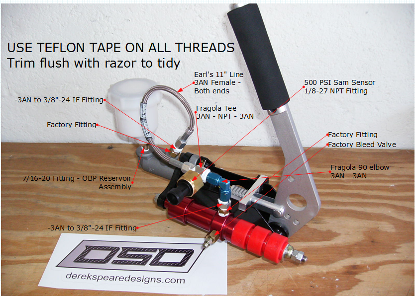

    I started a project of hydraulic handbrake
    I wished to do like DSD
    http://www.isrtv.com/forums/topic/10762-dsd-hydraulic-handbrake-diy-project/
    but it would have cost 150€...
    So I decided to convert my hydraulic handbrake into a load-cell handbrake!

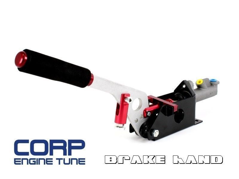

    shopping list
    eBay 33€
    "HYDRAULIC HAND BRAKE WITH PUMP S14 S15 AE86 RX7 DRIFT HORIZONTAL VERTICAL RED"
    http://www.ebay.fr/itm/HYDRAULIC-HA...ERTICAL-RED-/311068773989?hash=item486d24ce65

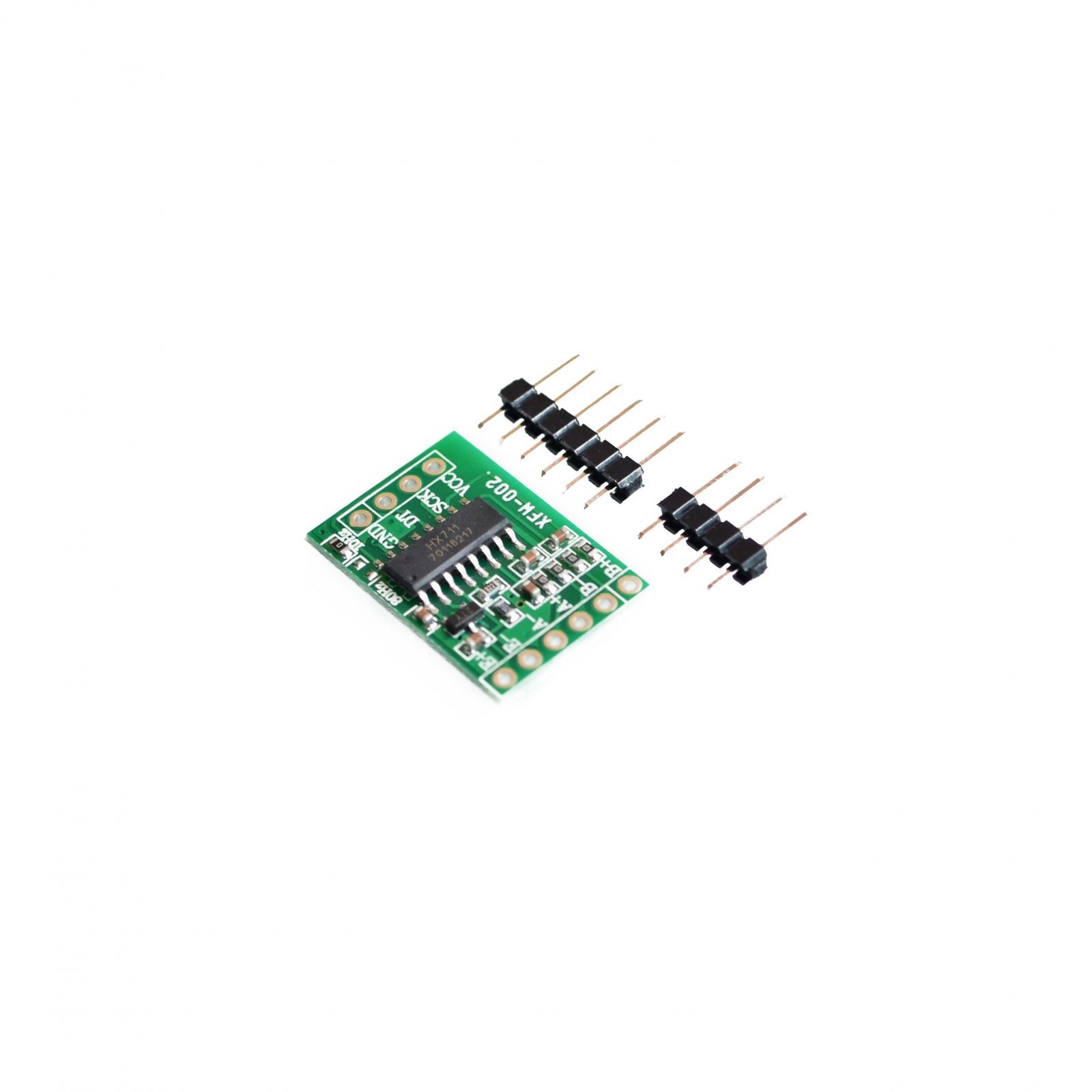

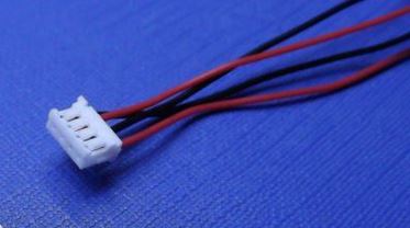

    load-cell amplifier - HX711
    communicates in SPI with an arduino for example
    www.arduino.cc/en/Reference/SPI
    0,69€
    http://www.aliexpress.com/item/For-Arduino-Dual-channel-HX711-Weighing-Pressure-Sensor-24-bit-Precision-A-D-Module/32323968927.html
    ____________________________
    http://fr.aliexpress.com/item/20kg-....tmeRpX&ws_ab_test=201407_2,201444_6,201409_3
    4,87€ load cell 20kg

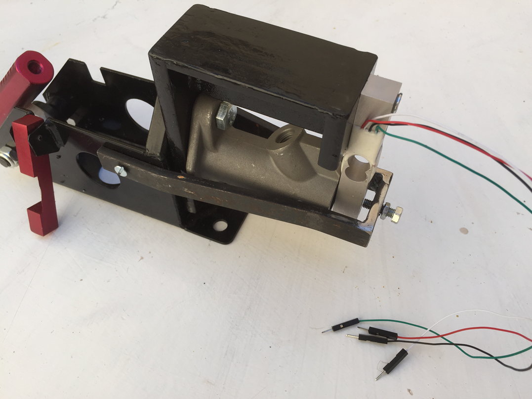

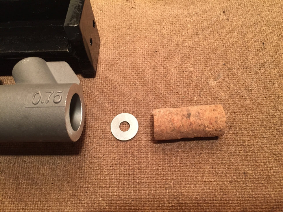

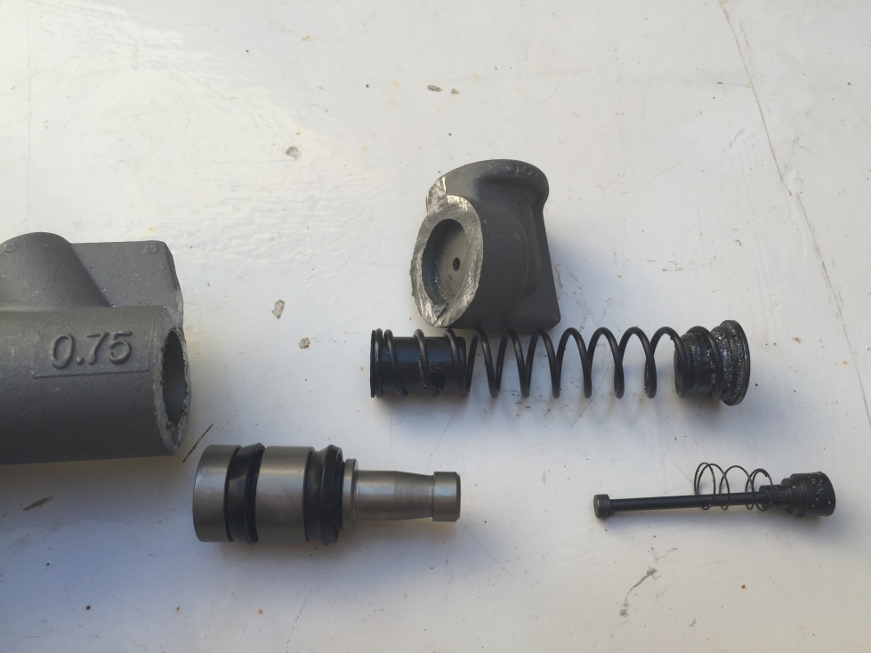

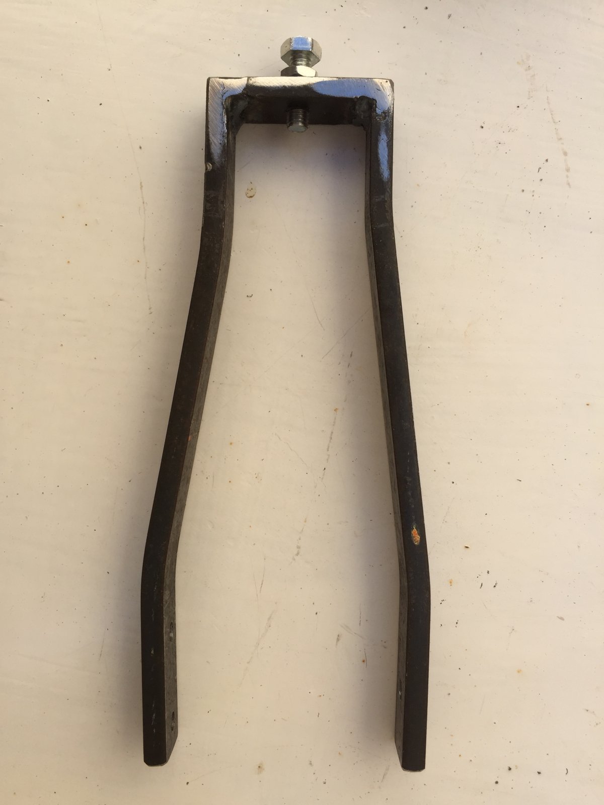

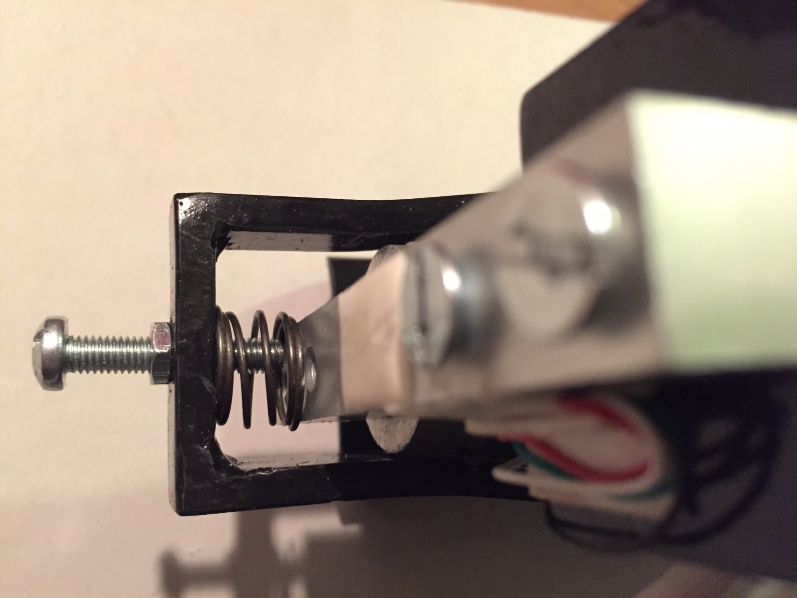

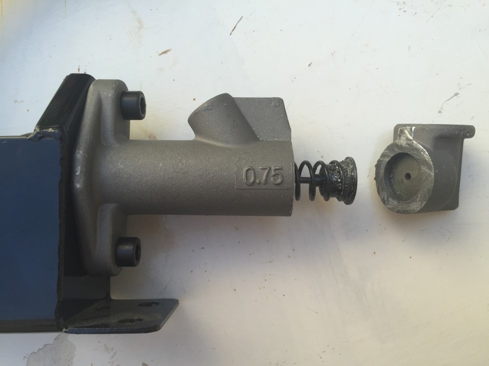

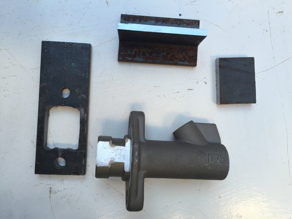

    Building steps:
    635319Freinamainloadcell1.jpg 588279Freinamainloadcell3.jpg 188311Freinamainloadcell6.jpg 115823freinamainloadcell6.png 433876freinamainloadcell4.png IMG_1173.JPG IMG_1172.JPG
    I had to add a spring behind the load-cell in order to come back to zero value.
    Without spring, the handbrake was seen as still braking by windows controller.
    It very good now and I think it is finished. :cheers
    Hopefully I have other sim projects awaiting me!

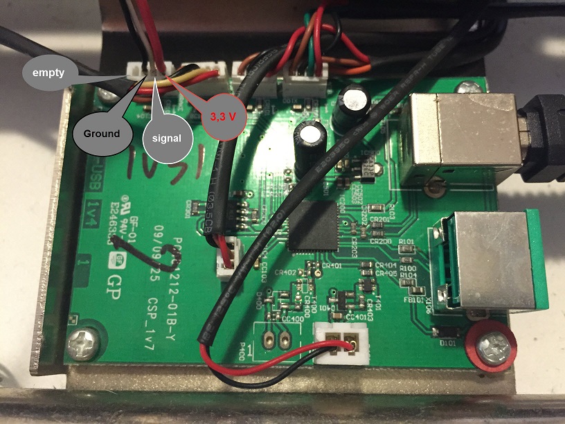

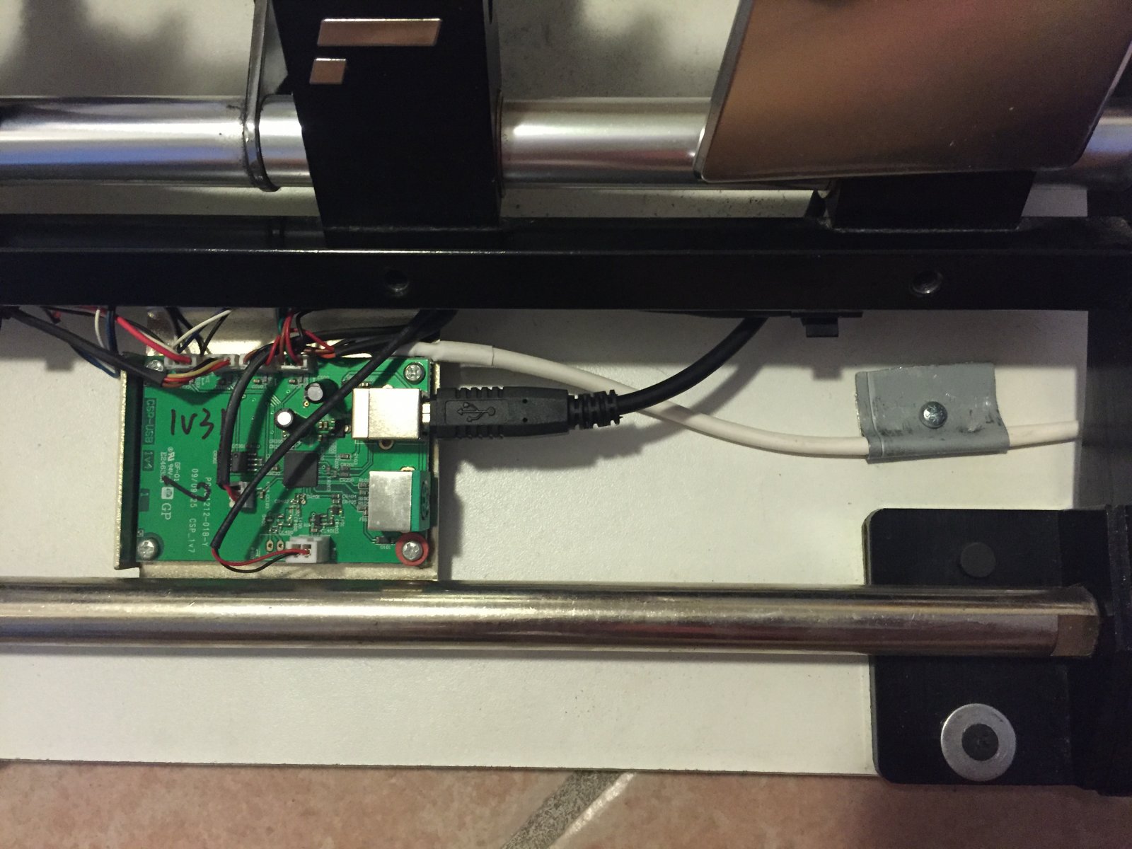

    Link to PC
    via CSP pedal handbrake analog comport
    this pinout from https://www.gtplanet.net/forum/threads/clubsport-and-csr-elite-pedals-handbrake-diy-info.280445/
    Thanks to Mrbasher, here is how I wired the hand brake onto the PCB

  11. Nick Moxley
    17,054Coins
    +2,504 / 30 / -2
    Nah never got into the Pin out of the PCB, sorry matt.
    If you still need a hand i can ask around, Jon from Basherboard would 100% know for sure.
    What EXACTLY do you want to know ?

    Mat, Pin 2 is the sweeper from the pot so yes it reads the voltage change. I did this mod on my Fanatec Elite pedals as well. Then I switched to a Teensie ++2.0 instead when I built my button box/shifter

    As I didn't find any spedification from Fanatec documentation,
    before wiring, I'm just worried about the little mistake written in the post https://www.gtplanet.net/forum/threads/clubsport-and-csr-elite-pedals-handbrake-diy-info.280445/
    Like Historikr, I think it should be pin 2.
    I'm interested in your feedback! and Jon's expert information on how to plug an analogic handbrake on the CSP V2.

    Mat, use a volt/ohm meter with the board plugged in and check the pins for voltage.

    Ok, I have had a look with the voltmeter: look.gif
    nada...
    but when i check between pin 1 and 3, then the throttle adn brake are varying in windows controler...
    Then I lost my throttle and I had to restart twice to get it back... but no voltage
  17. RacingMat
    2,234
    20,895Coins
    +2,084 / 21 / -2
    Finally, I didn't manage to read any voltage... but I wired the handbrake: it works!! spasibo.gif
    I'll post some pictures
  18. RacingMat
    2,234
    20,895Coins
    +2,084 / 21 / -2
    It works fine!
    Here is the pinout with colored wires

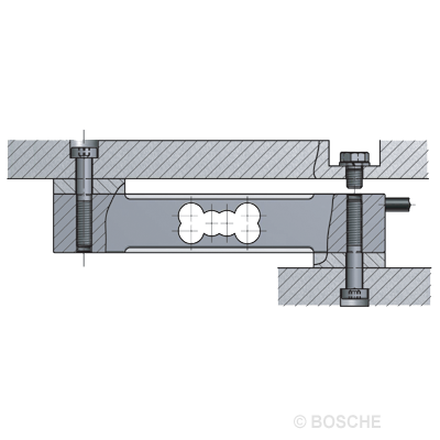

    I have many loadcells laying around as replacement for Fanatec Break pedal.
    So I have a question. In the pedal thread you wrote you need two loadcells for a Bridge.
    You use only one. Does your lodcell internally consits of two?
    Sorry but I never worked with loadcells.
  20. Nick Moxley
    17,054Coins
    +2,504 / 30 / -2
    the Fanatec Cells are only a 1/2 bridge as i understand.
