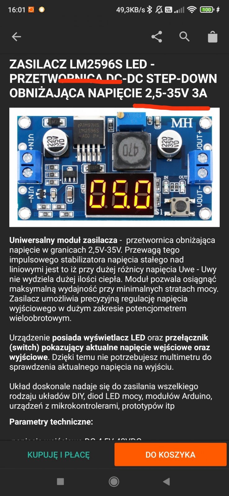

    How u connect servos and psu to arduino on 7 volt? Do need motor controller?

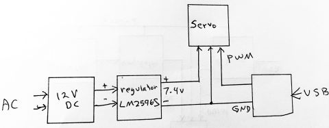

    Arduino has a library to control (by PWM) hobby servos, which have 3-pin connections:
    1. ground - connect to servo power and Arduino ground
    2. PWM - connect to Arduino PWM pin
    3. power - connect to e.g. 7.4 VDC supply, separate from Arduino power.
    My 7.4VDC power derives from a 12VDC bulk power supply reduced to 7.4VDC by a buck regulator.
    I chose a buck regulator which also limits current (to less than 5A)
    and has supercapacitor bank between the buck converter and servo for peak (e.g. stall) currents.
    Separate Arduino power is by its USB connection.
    Hobby servos do not require motor controllers.

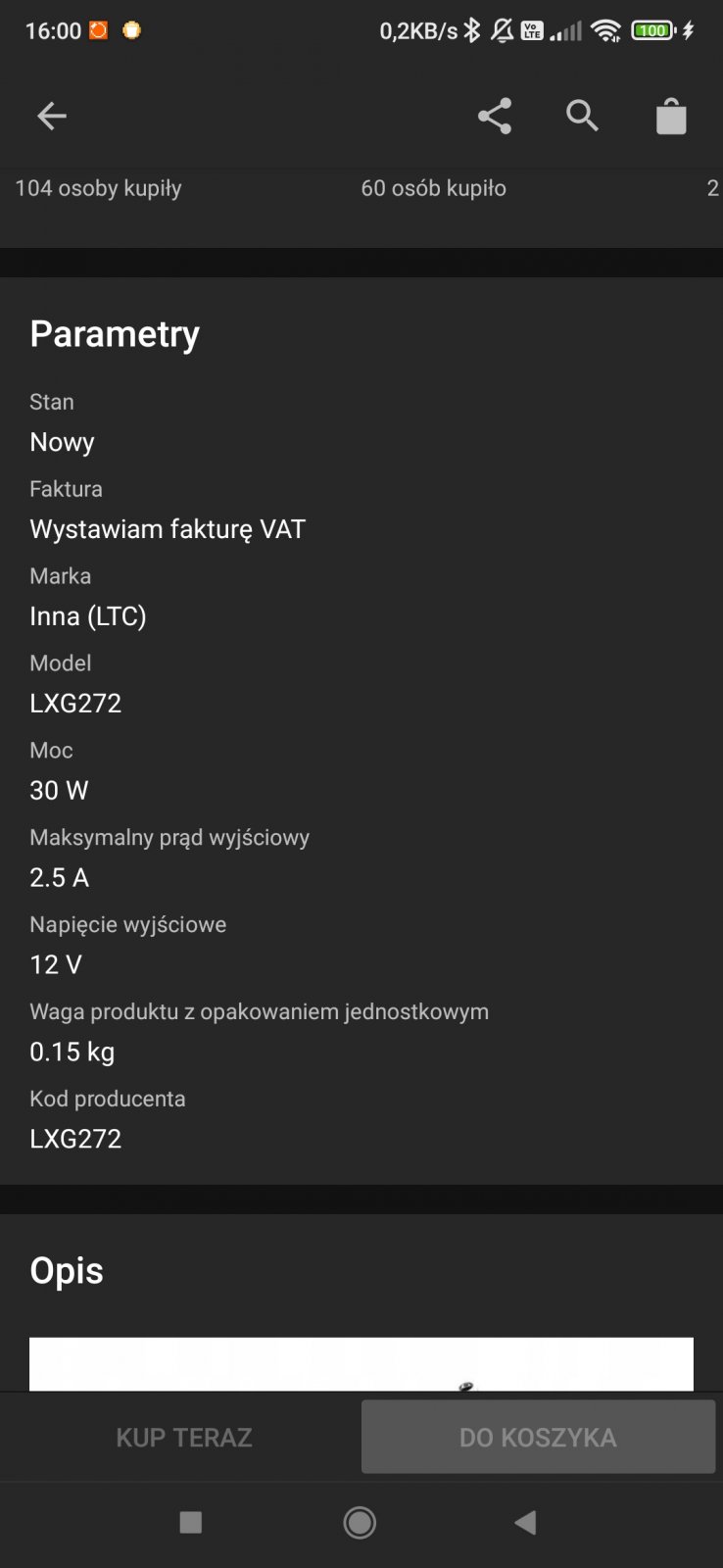

    I have a regulated 12v power supply, when it gives 7 volts and connect it as you wrote, nothing happens. Should I set it to 12v and connect a regulator like this?

    12V[​IMG] will damage hobby servos.

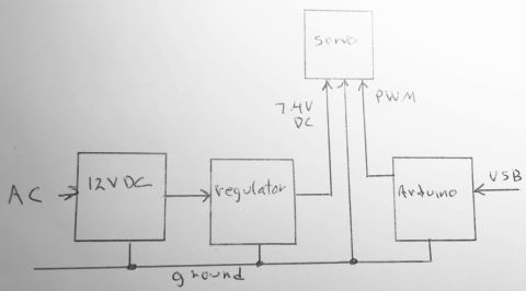

  15. blekenbleu
    blekenbleu New Member
    Jan 8, 2021
    6
    121Coins
    corrected wiring for your regulator
