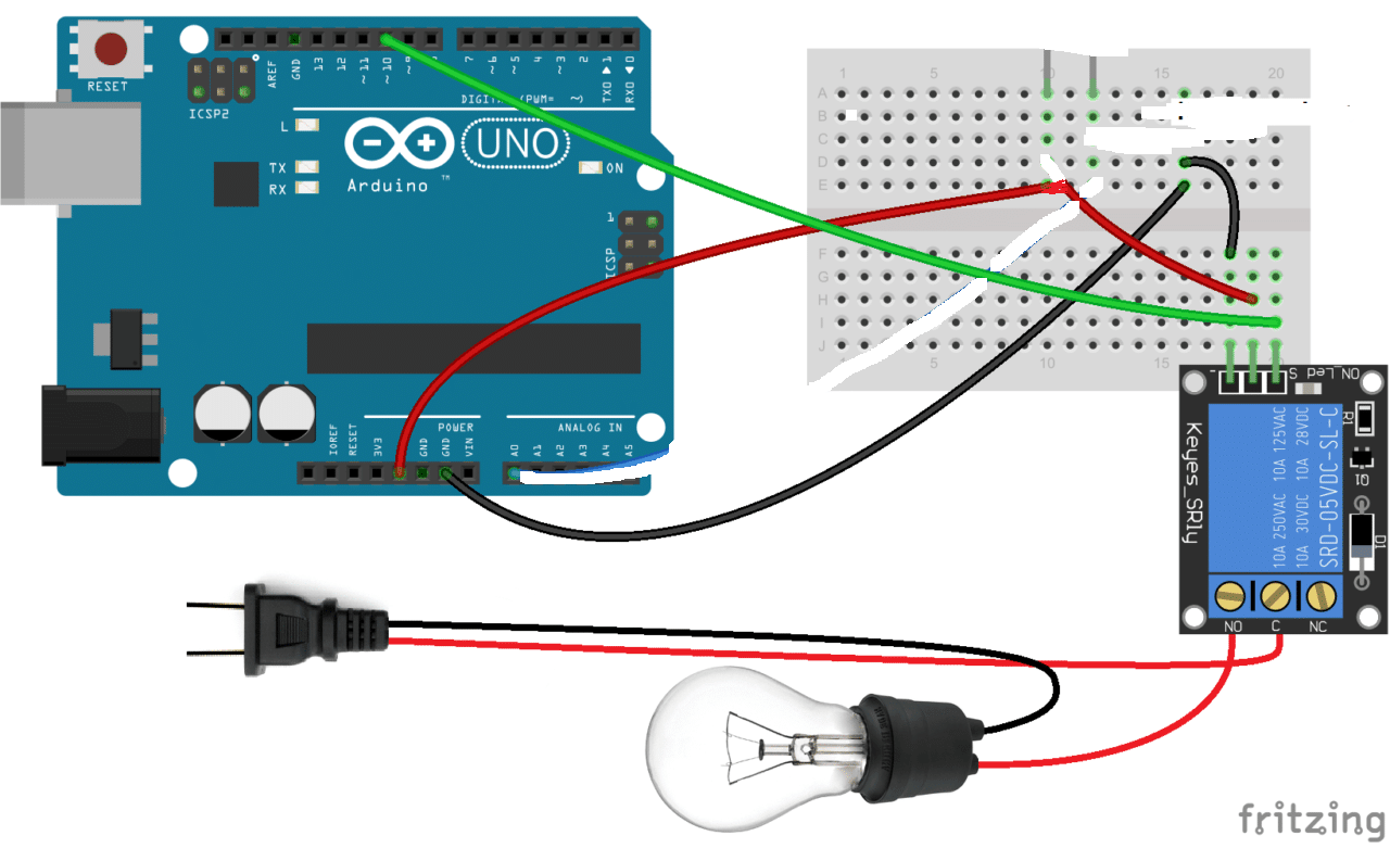

    @RacingMat
    Have you run across any Arduino sketches that can use the serial output of Game Engine and output a signal to drive a relay board which in turn switches my air air valves on and off??
    Thanks...

    have a look in the FAQ about GameDash
    https://www.xsimulator.net/community/faq/gamedash-settings-tips-and-tricks.21/category
    driving a relay is extra simple: you change 1 digital pin (here pin 10) from low to high
    you should open a dedicated thread to get more specific help :)

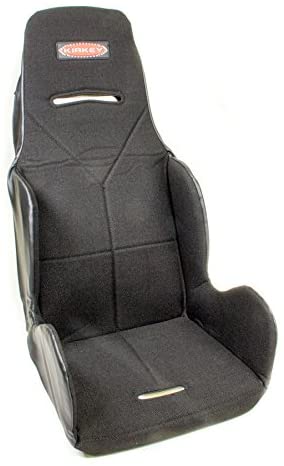

    @Gadget999 I have been working on an airbag system for what seems like a long time...
    And I spent (wasted) way too much money on it...
    But that is the way you learn I guess.
    The one thing I am convinced of is the seat can make your project much easier..
    I picked up a Kirkey 16800 Seat and the matching cover.
    I love the seat / hate the price...
    I went with an air compressor and solenoid valves..
    Although the motion is not linear it does have lots of power and is fast.
    Properly adjusting the turn on points with my diy control circuit and Game engine produces a pretty good feel...
