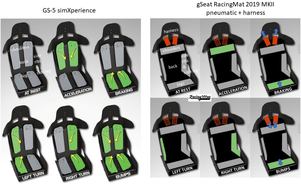

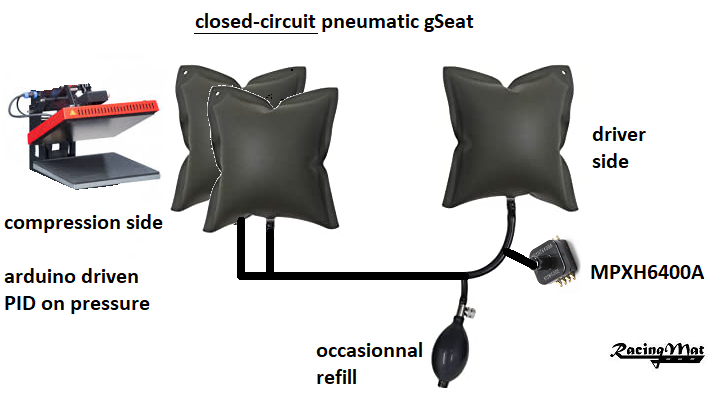

    Hi guys!
    In 2014, I thought about building a pneumatic Gseat with a closed-circuit in order to prevent the use of a compressor, valves, exhausts (leading to noise, oil, large footprint, cost).
    1/ I have built a 2DOF full mobile : it was fun but enventually unsatisfactory
    - long effects were not sustained
    - movements induce 3 phases effects with wrong feelings:
    during a braking, the 2 DOF starts to push you in the back (wrong) and then to restrain you with the harness (OK), and nothing special with a slightly tilted plateform (wrong).
    - I didn't like being shaked (am I getting old? :D)
    2/ I have owned a Gecko gSeat but having the backrest of an arm chair strapped on my back like a backpack, was not comfortable and the seat itself was not self-centered, so the user has to keep in mind to stay within the limits. If not, it bumps the mechanical stops. These factors are not good for immersion...
    3/ Black friday made the GS-5 at 2500$ vs 3000$ but where would have been the DIY fun? And I don't like the position driven gSeat. I only believe in torque (or pressure) driven gSeat.

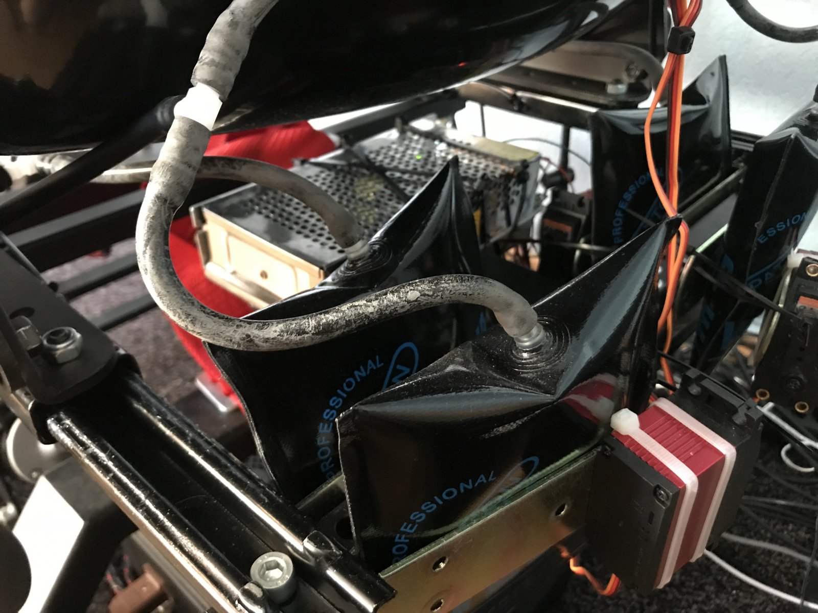

    With a position driven gSeat, if you move away, the wrong force will be applied.
    Since that I have spared some money and I'm starting to build my pneumatic closed-circuit Gseat! :)
    The advantages are :
    - no precision mechanics (bearing blocks, rollers, cardan shaft...)
    - 1 DOF by pressure pad: no mixing needed. Gain of time in setups. Simplier code: 1 arduino per DOF.
    Good Wife Acceptance Factors:
    - preserve the racing seat esthetics: pressure pad under the seat cover.
    - small footprint
    - no moving parts around the seat dangerous for bystanders (2DOF ou 6 DOF actuators): pressure devices enclosed in a remote box (under the seat?).
    The drawbacks are :
    - low reactivity. This will be counteracted by tactile transducers (and by tubes of large diameter if necessary or faster motors).

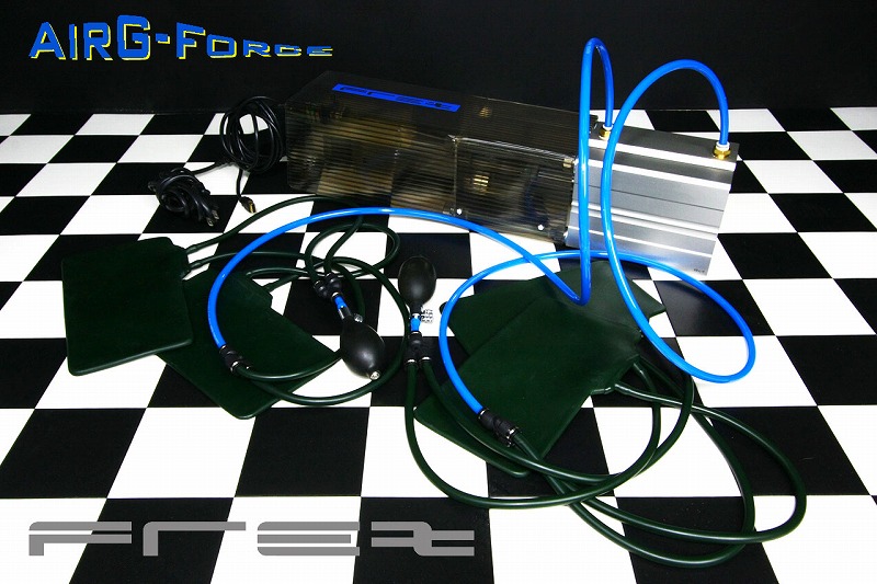

    14 décembre 2015
    Frex
    FREX:
    "We are working on pricing.Standalone USB device. It will be around US$810, 770 euro plus shipping from Japan.
    One set includes 2x2 bags for side sway or surge. 2 sets need for 2DOF."
    "1 set for side effect when turn corner is very good.
    1 more set on back and under knee for accel/braking.
    So 2 sets will be full AirG-Force setup: 1620$"

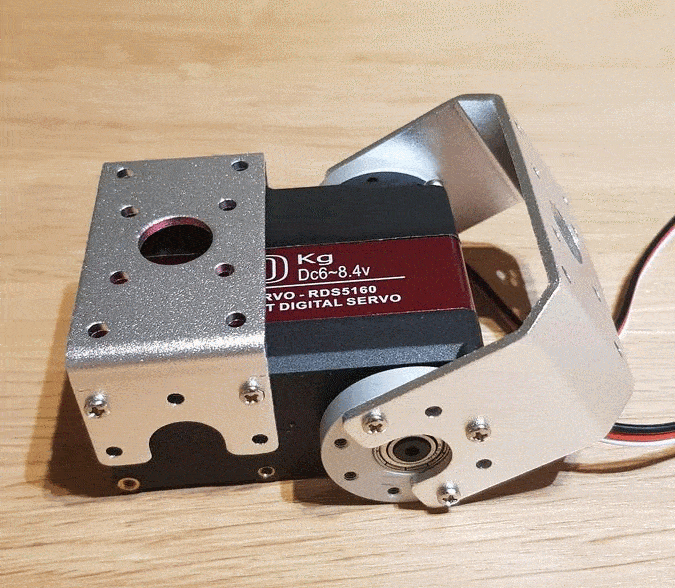

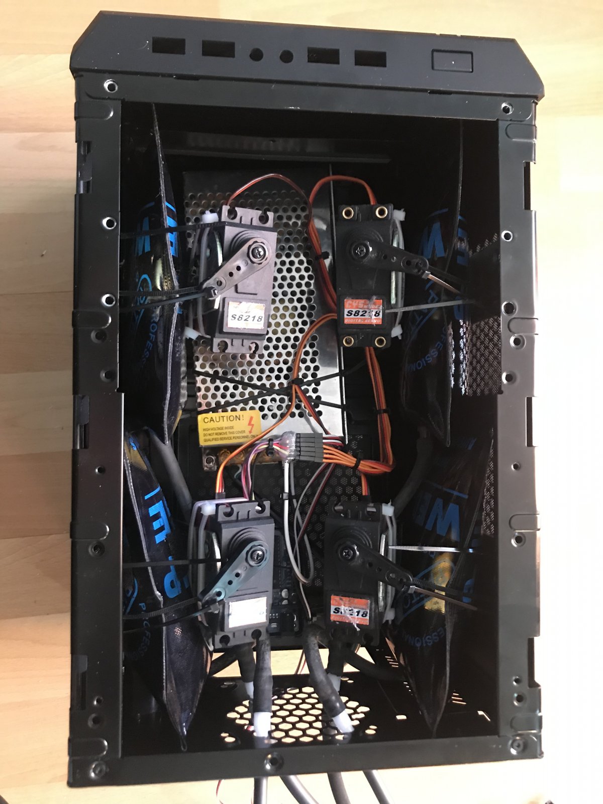

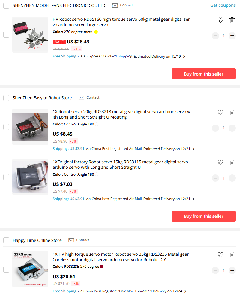

    Actuators:
    The working angle of the servo is 180 degree or 270 degree (PWM: 500us-2500us)
    Some remote controls can only output 1000-2000, it is recommended to buy 270 degree.
    I choose these servos beacuse I thought the brackets are really convenient in this configuration to squeeze a wedge :thumbs
    Here is what I received.
    Speed: 0.17sec/60 degree at(6v)
    0.15sec/60 degree at(7.4v)
    0.13sec/60 degree at(8.4v) -----------> 1,3 tours/sec
    Torque: 58kg.cm.at(6v)
    65kg.cm.at(7.4v)
    70kg.cm.at(8.4v)
    Voltage: 6v-8.4v
    Speed: 0.13sec/60 degree at(5v)
    0.12sec/60 degree at(6v)
    0.11sec/60 degree at(7.4v) -----------> 1,5 tours/sec
    Torque: 29kg.cm.at(5v) -1.9A
    32kg.cm.at(6v) -2.1A
    35kg.cm.at(7.4v) -2.3A
    Voltage: 5v-7.4v
    Speed: 0.19sec/60 degree at(5v)
    0.17sec/60 degree at(6.8v)
    Torque: 18.5kg.cm.at(5v)
    21kg.cm.at(6.8v)
    Voltage: 4.8v-6.8v
    Speed: 0.16sec/60 degree at(5v)
    0.14sec/60 degree at(6.8v)
    Torque: 15kg.cm.at(5v)
    17kg.cm.at(6.8v)
    Voltage: 4.8v-6.8v
    Max current
    60 kgcm : 6,2A stall current at 8,4V
    35 kgcm : 1,5A stall current at 7,2V
    Beware that these servos need particular voltage supply...
    I had to buy 2 power supplies
    a 8DCV adjustable +/-3% -> between 7.77V and 8.24 V
    and a 7DCV -> between 6,80V and 7,21V
    R&D needs some sacrifices...

  10. RacingMat
    2,237
    21,031Coins
    I'm not sure Frex sold many of them...
    In my opinion, it's a really bad design:
    - With a single double-action actuator for 2 cushions, the cushions are at half pressure at minimum and you cannot actuate them simultaneously for a bump...
    - Plus they didn't take the opportunity to use both tubes for quicker response. They monopolise 1 tube only for occasionnal refill... :confused:
    - And final, it's not pressure driven...

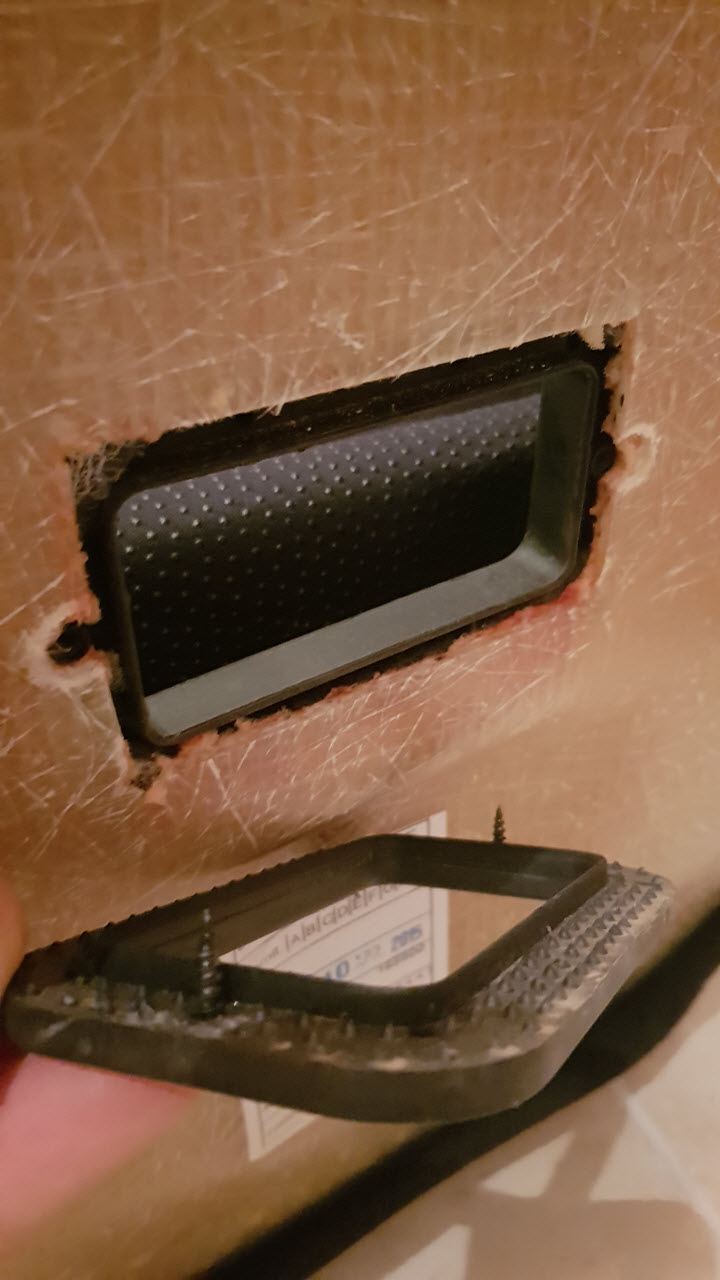

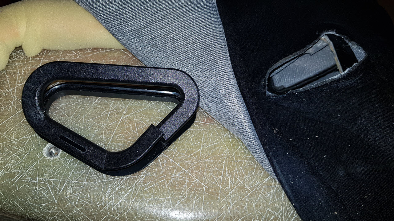

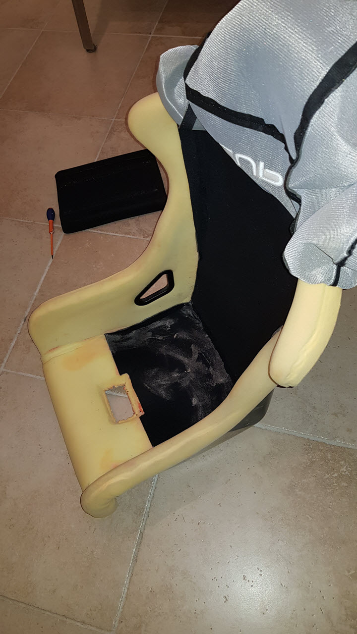

    here is my fiber bucket seat being stripped!
    seat clamps that are screwed, it's fine
    but the clamps that are clipsed... :confused: I broke it...
    I'll now try to determine how to attach tactile transducers (back, left and right), throne thumper below and brackets for a harness tensionner maybe. :)

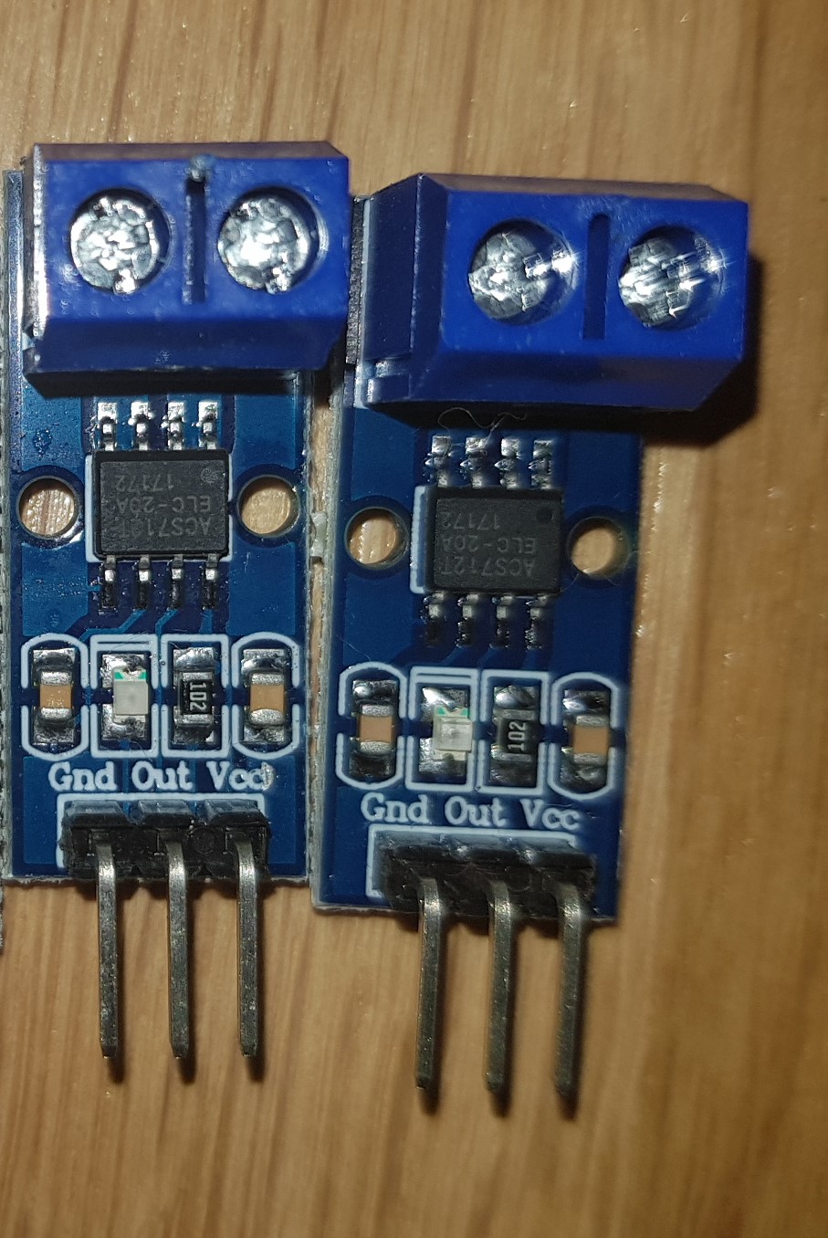

    I received the 7V PSU (for the 25kg servo not received yet) and I'm waiting for a 8V for the 60 kg servo
    and pressure sensor
    and ampmeter
    I got work to do :)

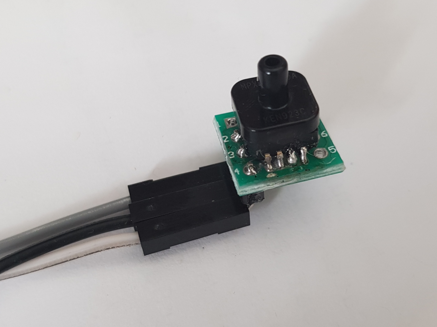

  13. RacingMat
    2,237
    21,031Coins
    that's really a small sensor (see arduino pins in comparison)! hard to solder it nicely...
  14. SeatTime
    2,573
    28,321Coins
    When things get small you can use a flux pen, solder paste + hot air for a way better finish.

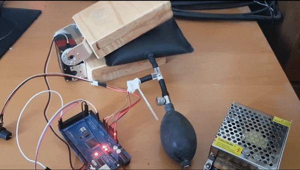

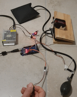

  15. RacingMat
    2,237
    21,031Coins
    Hi!
    first trials with this "pacman" configuration : servo at the center
    the torque is too weak
    it's sad because it was compact and mechanically fine
    so I went the @xxpelle way for pressing the cushion: servo at the end :thumbs
    In these trials, I'm using the pressure sensor (under the white tape) to monitor the system.
    If the pilot is moving away, the servo will press more in order to keep the right pressure (send from Simtools)
    if the pilot gets closer, the servo will release its pressure.

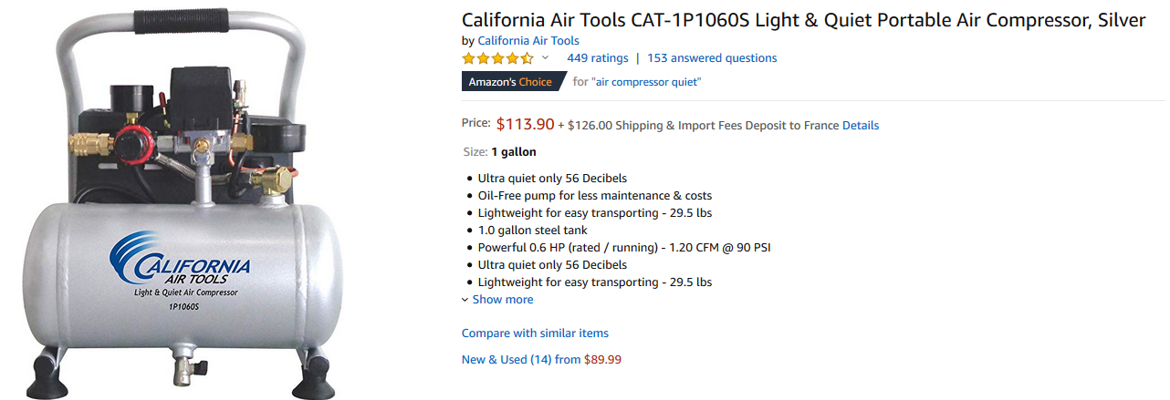

    I didn't go this way because of the noise of compressor and exhausts:
