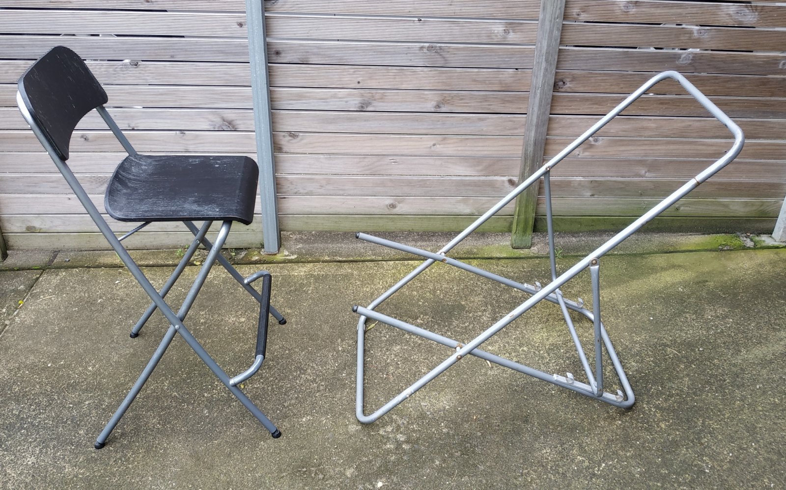

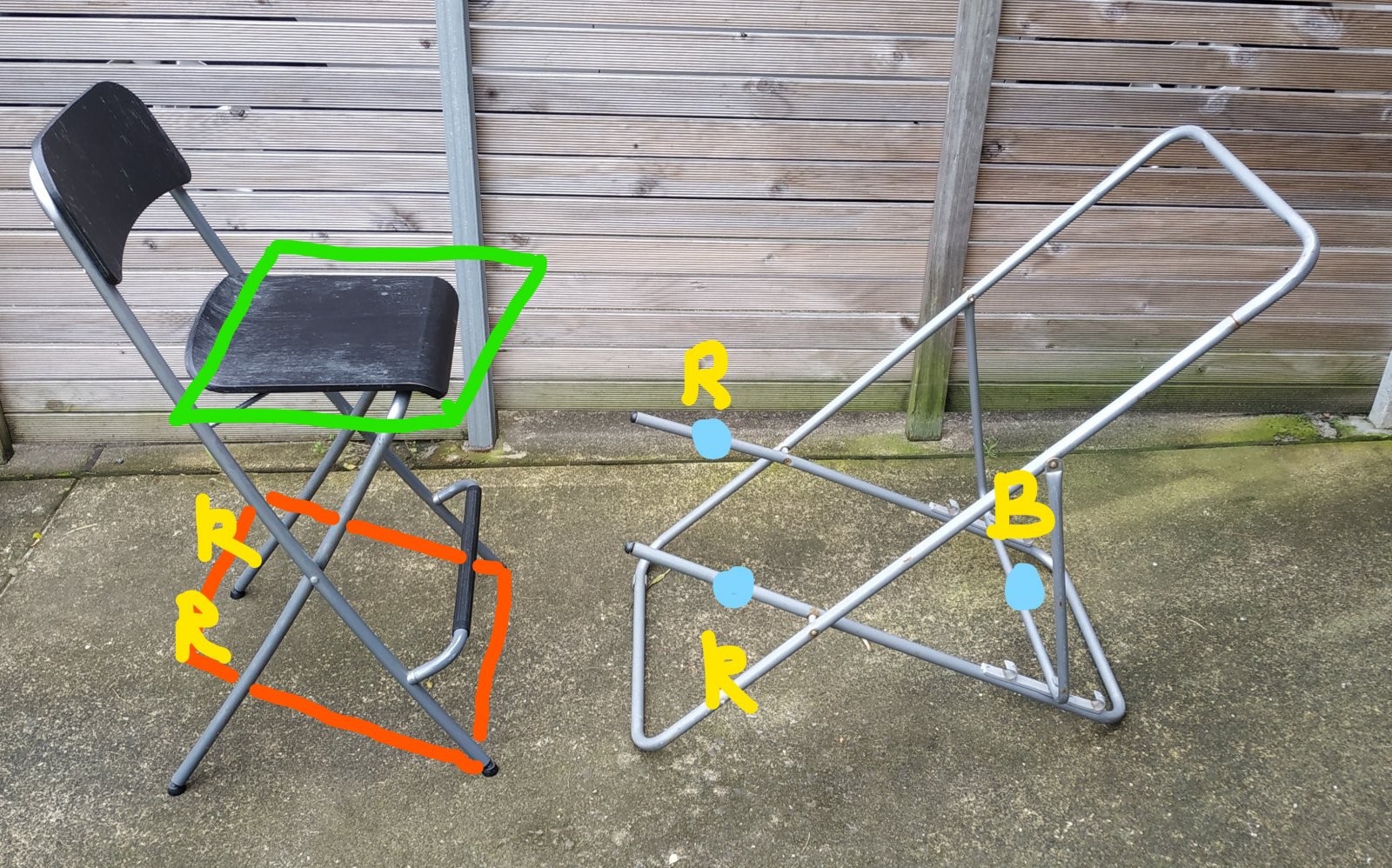

    First thing first, the base
    I looked in my garage and found and good structure to start from
  3. Banfy
    Banfy FR/AU
    Jun 11, 2020
    131
    Australia
    299Coins
    +55 / 1 / -0
    DC motor, Arduino
    An Ikea chair and a Lafuma Deck Chair...

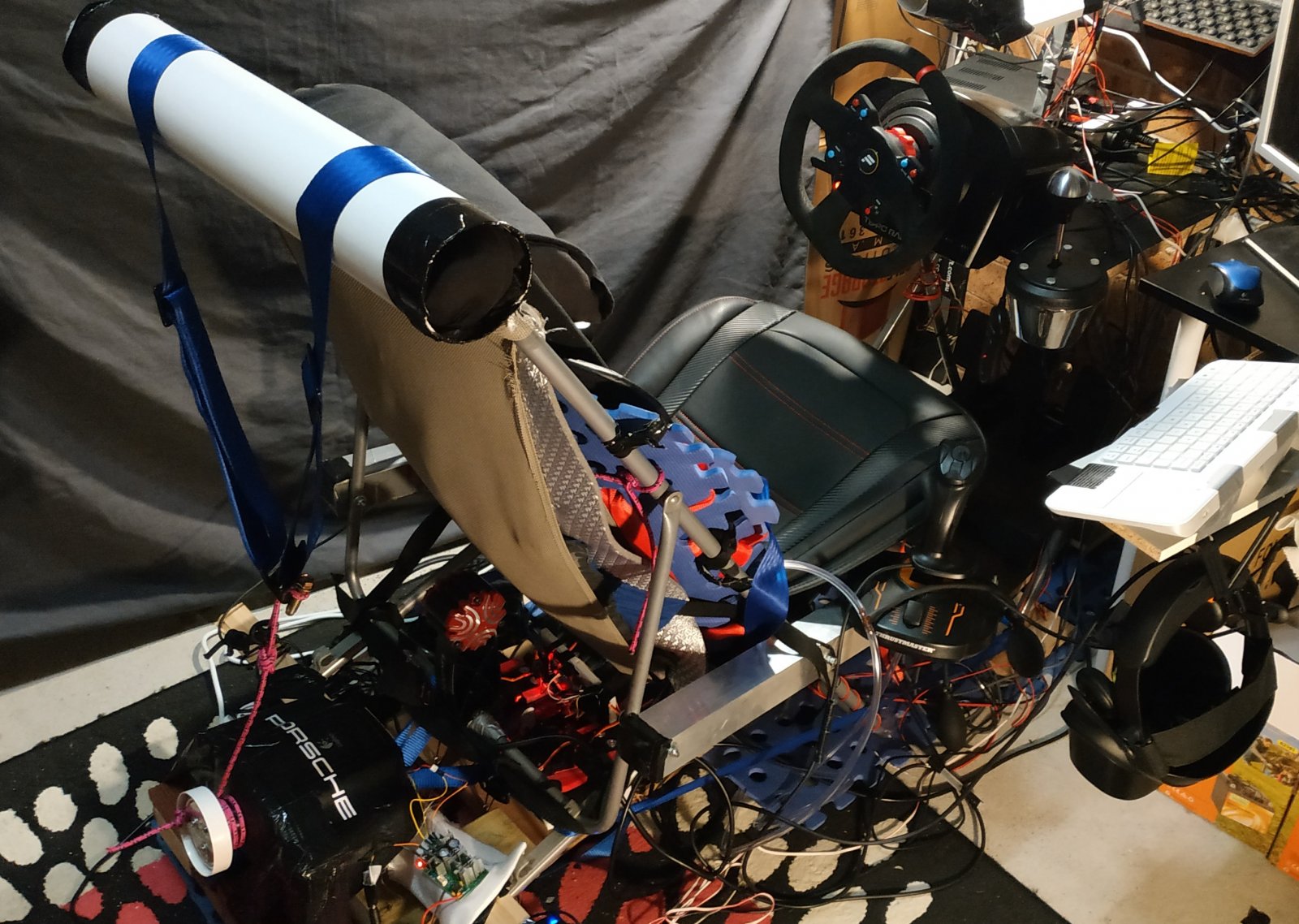

    The RIG will feature:
    -4 rumble motors (1 per wheel, letter R on the picture)
    -a Buttkicker (letter B)
    -a wind Fan
    -a G-Seat with Simtools
    -a seat belt harness with tensioner
    I will put a larger wheel plate by replacing the chair seat (in green) and I will add a pedal plate.

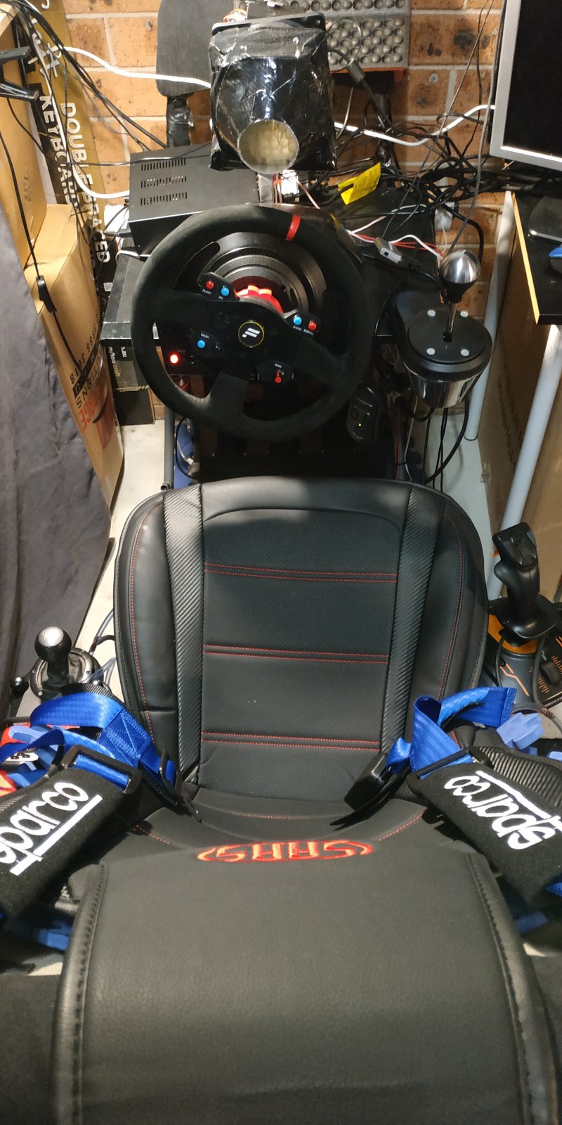

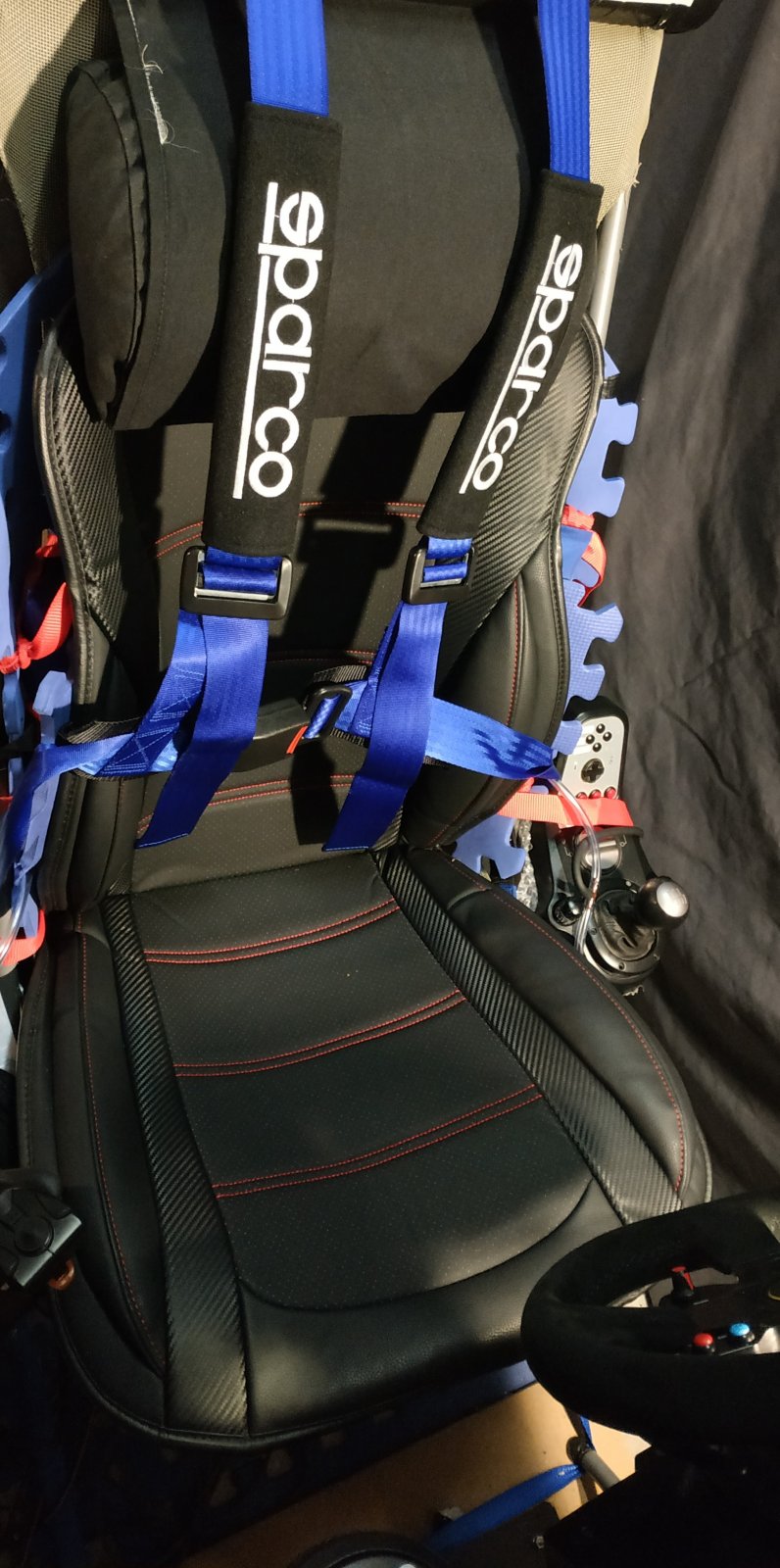

    Now, let me show the final results and I will provide details in further posts
    As I said, design is not the priority ;-),but it does not look to bad from this angle actually
    to be continued...

    Viewed from the back , it is another story ...
    I have just finalised the Gseat part, so it is still work in progress

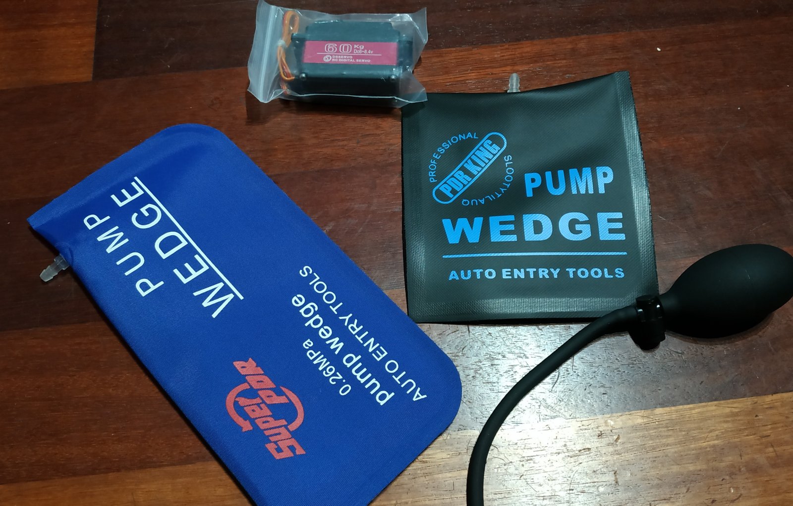

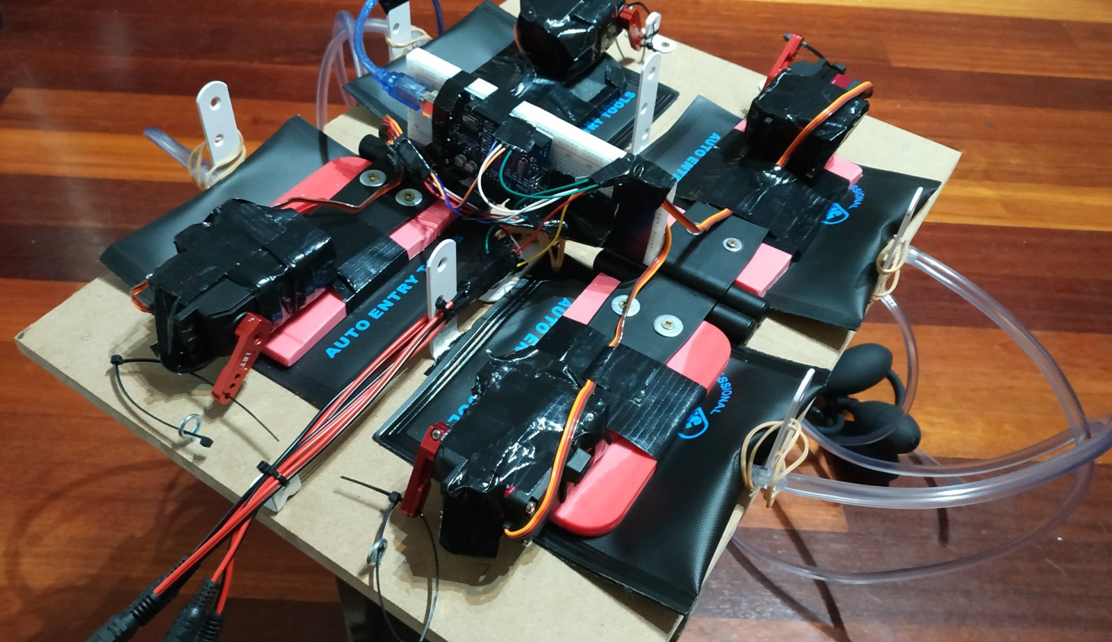

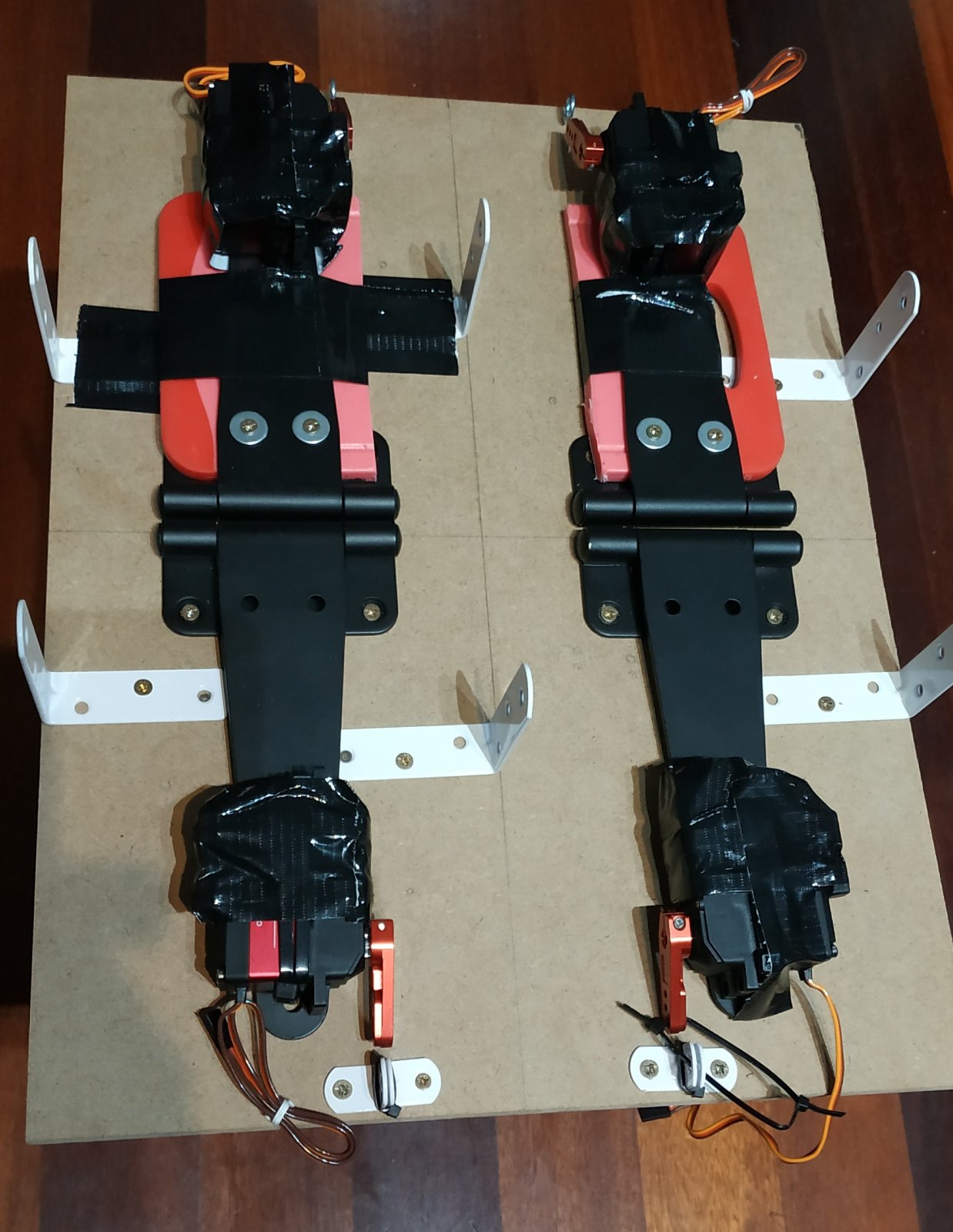

    The good thing with part ordering from overseas, is that it gives you the time to think and rethink and rethink again your plans until you receive them ;-)
    I could not find the hinges used by other contributors, but i found T-hinge in my local HW store, strong enough to do the job.
    I bought some random 60kg servos, they look fine, we will see how they handle over time.
    My plan has been to do a G-seat system with minimal integration so i can very easily remove it from the seat.
    It has to be low profile to fit in a moving box and to be installed beneath the sit.
    and finally , It has to be simple and easy to fix
    I have choosen the pneumatic option
    It fits on this 34x45cm board. it is around 15cm in height
    this is step 1:

  12. Banfy
    Banfy FR/AU
    Jun 11, 2020
    131
    Australia
    299Coins
    +55 / 1 / -0
    DC motor, Arduino
    base3.jpg and step 3, with the arduino and power cabling

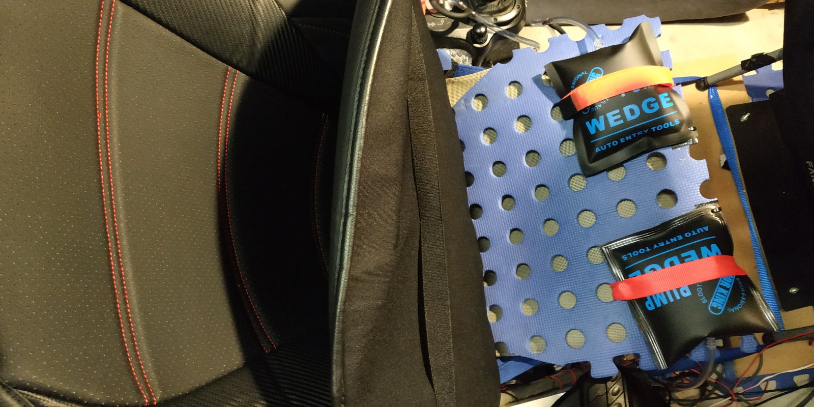

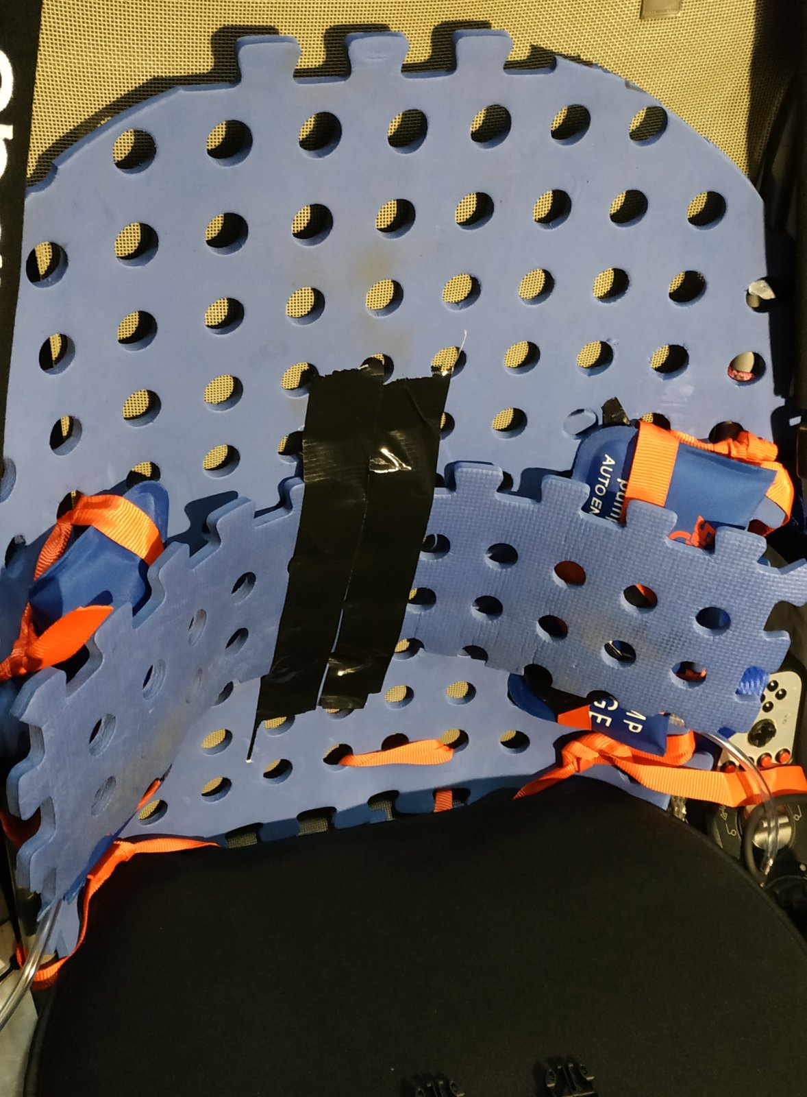

    On the seat itself, i use this blue foam padding. It helps for confort and provide many attachement options for the air wedges.
    I have put 2 at the back for surge and sway: seat wedge back.jpg
  14. Banfy
    Banfy FR/AU
    Jun 11, 2020
    131
    Australia
    299Coins
    +55 / 1 / -0
    DC motor, Arduino
    and 2 under the legs at the front, for surge and sway as well.
    I have put the small wedges only. I might add a 'butt' lifter later for flight sims ;-)

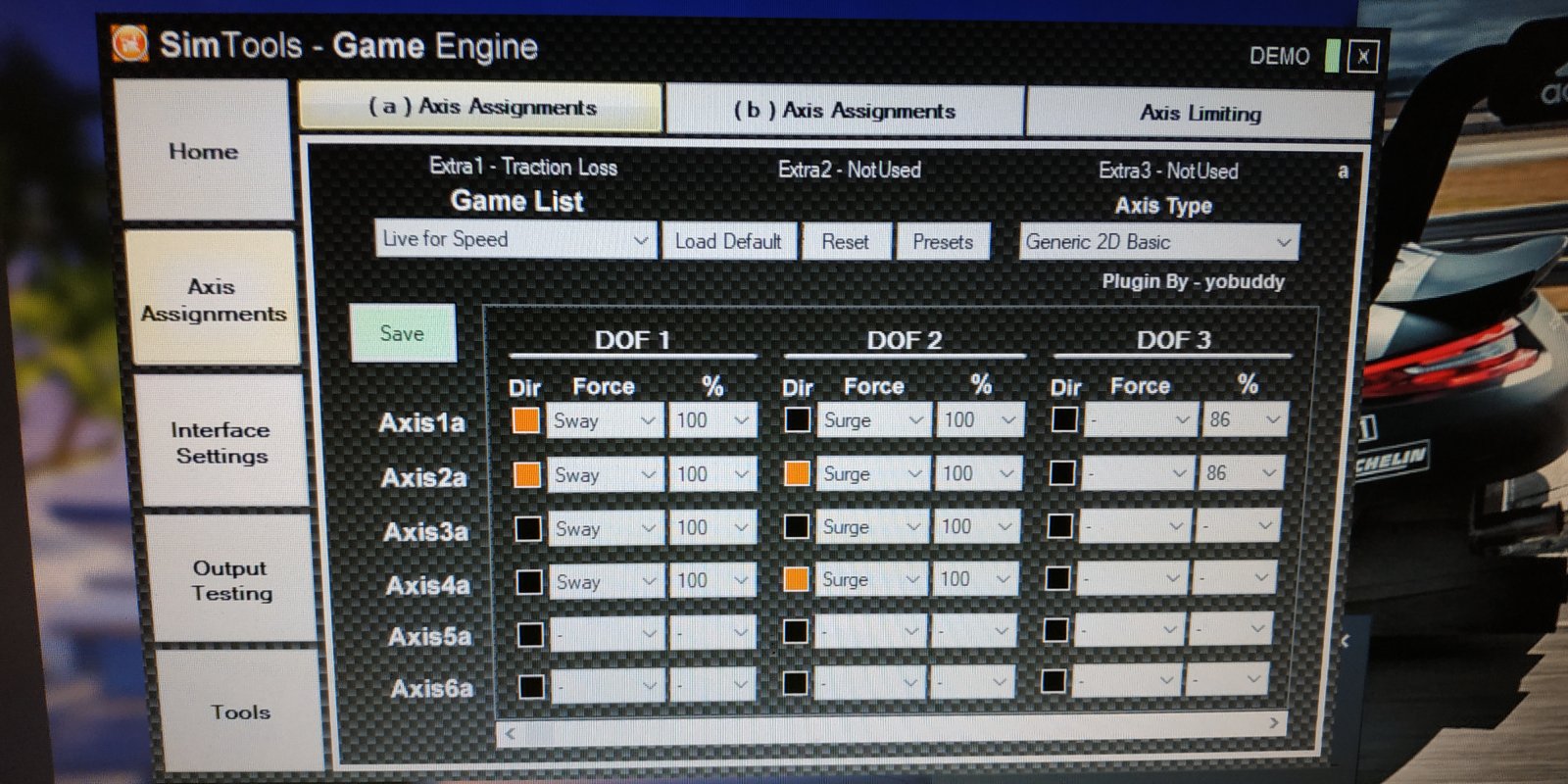

    +55 / 1 / -0
    DC motor, Arduino
    A bit of time to get familiarized with simtools, , launching LFS with those settings: IMG_20200627_155720.jpg
    And it works!
    Quite easy finally, just need a bit of fine tuning now

    is it possible with simtools to use a DOF on a certain range, not from -100% to 100% but for example from -20 to +90?
  18. Banfy
    Banfy FR/AU
    Jun 11, 2020
    131
    Australia
    299Coins
    +55 / 1 / -0
    DC motor, Arduino
    to be more precise with an example
    actually, with -100 to +100 range , my surge at zero puts the servo position in the middle and apply already some pressure on the wedge.
    i would like zero pressure for surge between -100 and zero, and the full servo rotation dedicated to surge positive values (full servo range allocated to positive acceleration)
    I am not sure if this should be done with simtools or with the arduino code...?
    In the tuning center, i have not seen a way to manually assign min max which could potentially solve my problem
