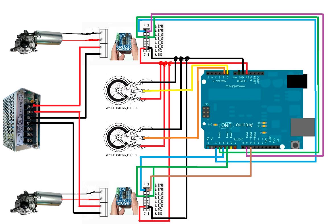

    Mounted the 3 pots last night and made the last control rod. I cannot find a 3 motor diagram for Arduino and IBT2s. Can anyone helpe out with that please? Would the green from the third IBT2 go to 6, and the blue go to 7 of the Uno R3? This is the last thing holding me up from testing.

    Sorry, forgot to add the diagram I'm working with. Would the correct config be green 6 (PWM) and blue 7? Wiring-2-Motors.jpg
    21,723
    152,051Coins
    +11,063 / 56 / -2
    I am presuming you are using SMC3 from the picture, in which case you are better off using a second Arduino for the third motor, because of the Arduino processing.

    Ah man. Yes I am planning on using smc3. I haven't seen any tutorials on using a second Arduino. Are they wired in series or do I need to get a separate USB cable for it? This is gonna set me back quite a ways timewise. Gotta do what I gotta do I guess.
    21,723
    152,051Coins
    +11,063 / 56 / -2
    Yes you need a separate USB, and the computer will assign the second Arduino a different com port.

    So the 2nd Arduino arrives tomorrow, but I have yet to find how to wire the IBT2 for motor 3 to it. Would I wire the IBT2 into PWM pins 2, 3, and 9 of the second Arduino? Or to PWM 6, 7, and 11?
    Also, did power on testing on Saturday. One of the IBT2s was bad. 3 more of those arriving tomorrow as well. But for the controllers that worked, they dialed in pretty quickly. As of right now, rig is stripped down for clean up and paint. I'ma post a lot more pictures after work today.
    21,723
    152,051Coins
    +11,063 / 56 / -2
    In SMC3 you basically replicate what you did with the first Arduino, just using a different com port and only wiring one IBT2.
    In SimTools Interface settings you can add the second Arduino specifying its com port and the additional interface setting.

    Just to be clear, the wiring position for motor 3 on the 2nd Arduino does not matter? I can wire it in same position as motor 1 on the first Arduino?
  13. noorbeast
    21,723
    152,051Coins
    +11,063 / 56 / -2
    Yes you can, it is differentiated by comport.

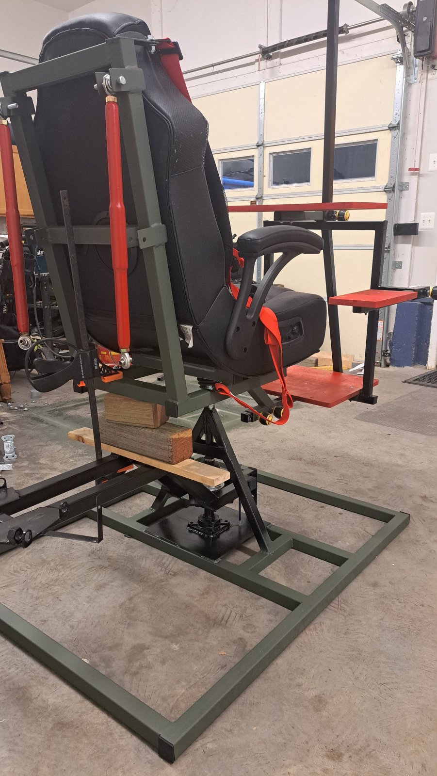

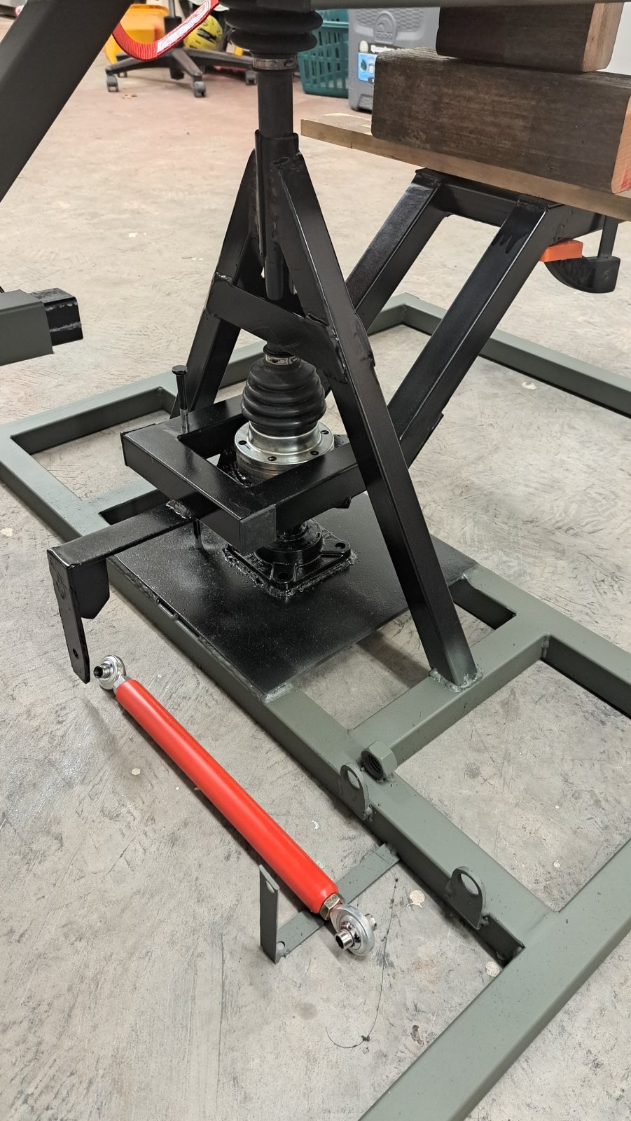

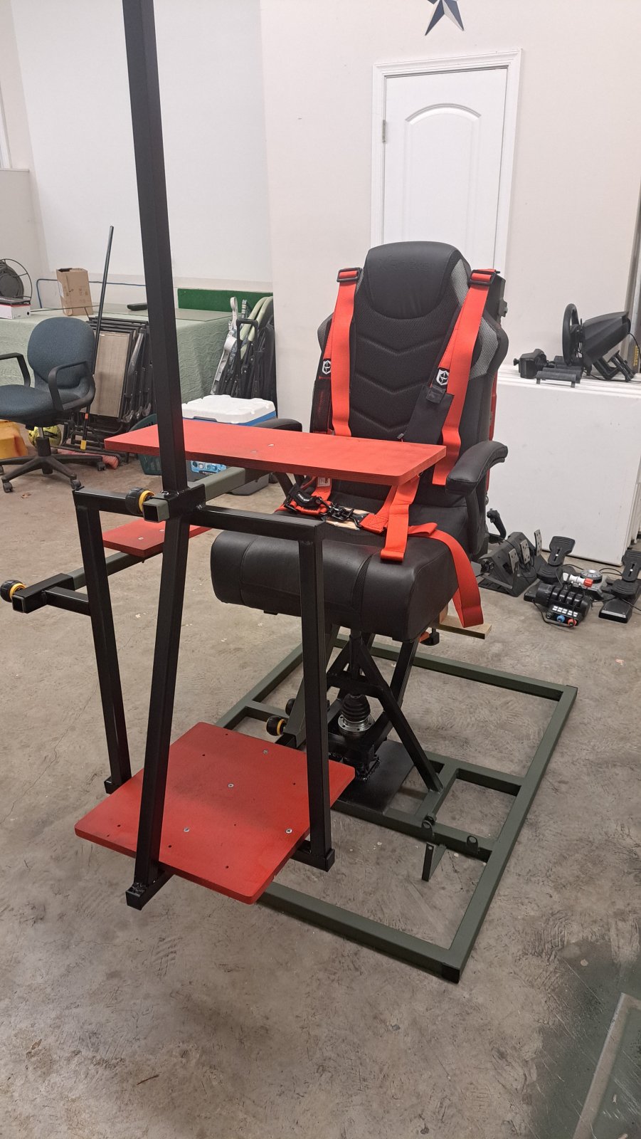

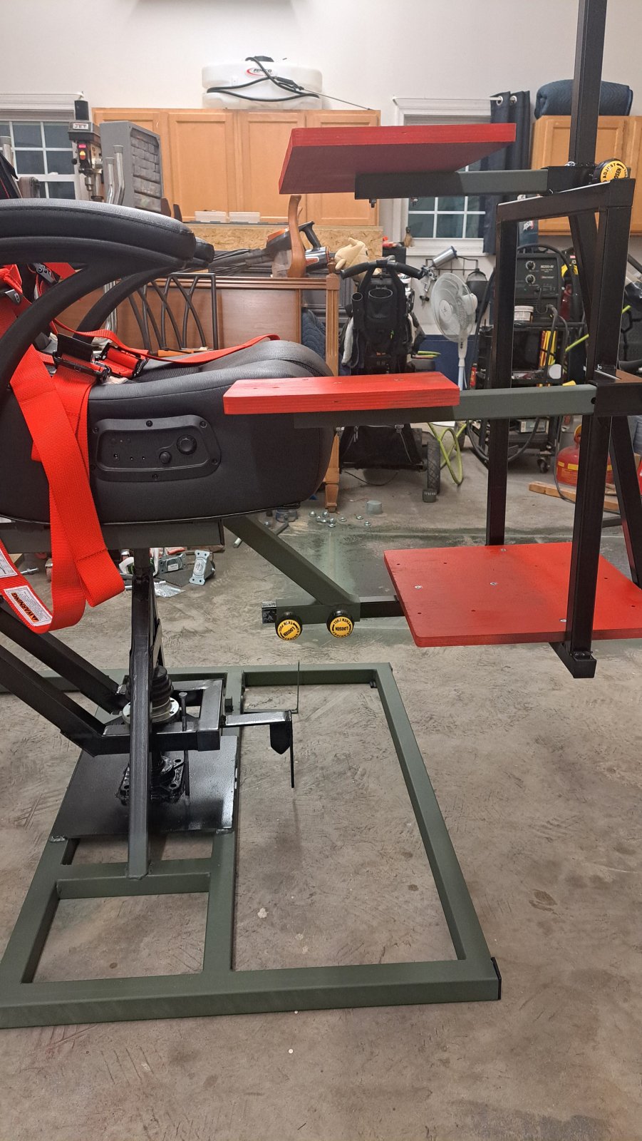

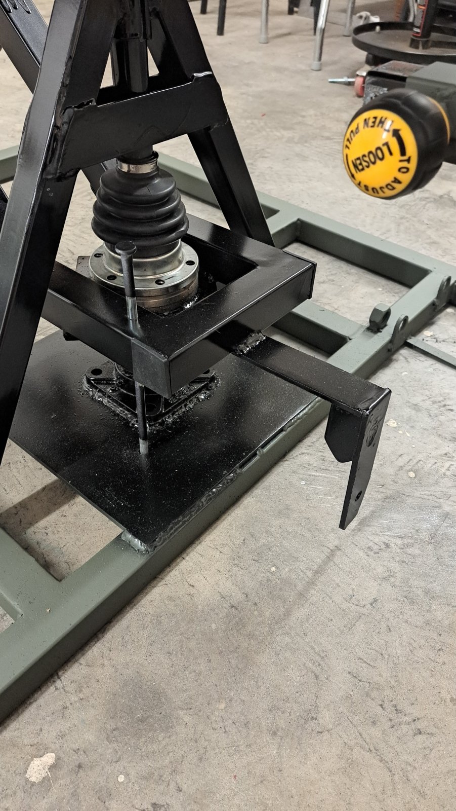

    Buj818 Member
    Jan 15, 2024
    51
    282Coins
    +12 / 0 / -0
    Motion platform

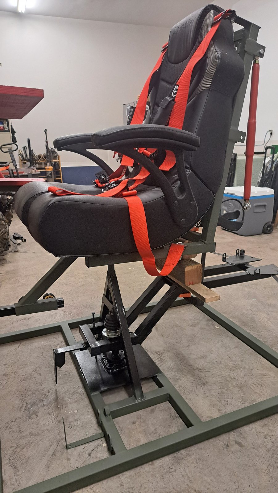

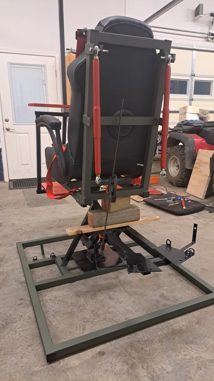

    20240306_175818.jpg 20240306_175832.jpg 20240306_175850.jpg 20240306_175907.jpg 20240306_175924.jpg 20240306_175942.jpg 20240306_180038.jpg
  15. Buj818
    Buj818 Member
    Jan 15, 2024
    51
    282Coins
    +12 / 0 / -0
    Motion platform
    So the structure itself is 95%'ish finished. Gotta make TV mount and possibly a dual caster wheel drop for the rear. The electronics are half way finished, hopefully done by Friday night, with full motion in seat testing Saturday.

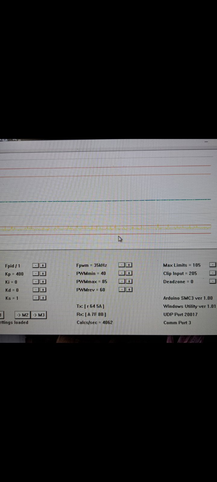

  19. Buj818
    Buj818 Member
    Jan 15, 2024
    51
    282Coins
    +12 / 0 / -0
    Motion platform
    Having a ridiculously hard time testing in SMC3. Pots are accurate, all centered, but when it comes time to motion test, it will only do 3 revolutions and then the motor cuts and the arm of the motor being tested just drops to max bottom. The sine wave is nowhere near close to clip or max. Only powering 1 motor at a time. This happens with all 3 motors. Watched multiple tuts, and no matter what I try, it keeps dropping out on me. Manually, I can move it with cursor without any issues. Any suggestions or should I just move into simtools? Screenshot_20240309_171603_Gallery.jpg
  20. noorbeast
    21,723
    152,051Coins
    +11,063 / 56 / -2
    My guess is if it is cutting out without reaching the limits, and particularly if unloaded, it would most likely be faulty hardware, so PSU or control boards.
