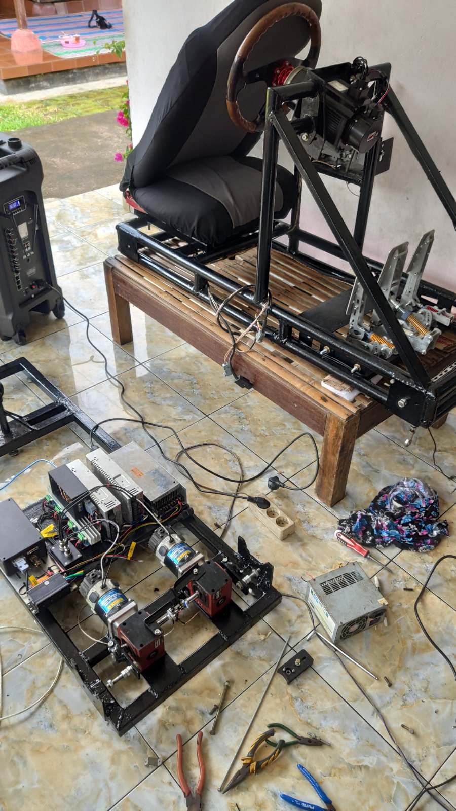

    why pitch not working?? but when output testing everything works normally. and when in the game and pressing the accelerator pedal, DOF does not provide a rear pulling force (pitch goes up) as well as when braking the pitch does not give a trip down. only he is in the midpoint. but for roll I think work. and is there any reference for this? for example the output testing roll when we slide it to negative it should rig rig to the right or left, and vice versa, because I was right "but confused by this. thank you very much

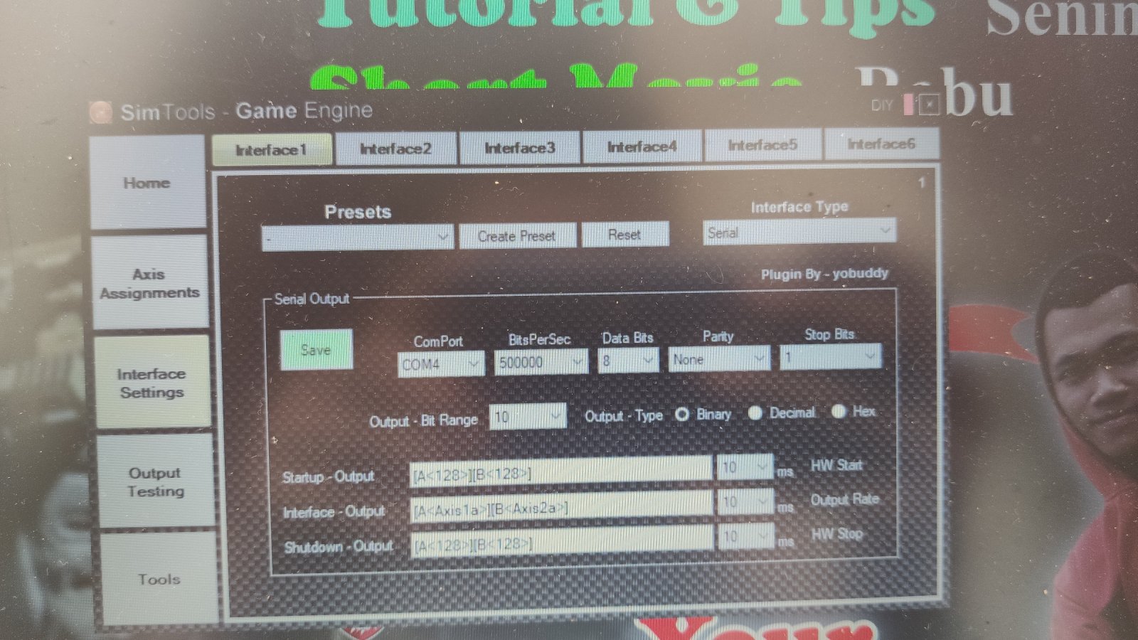

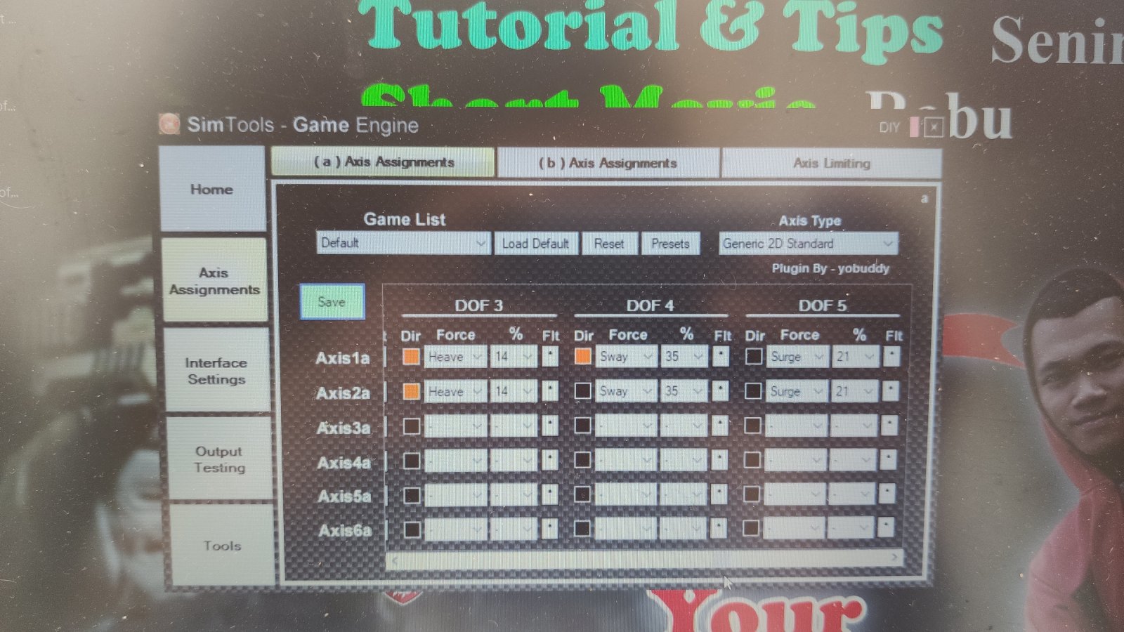

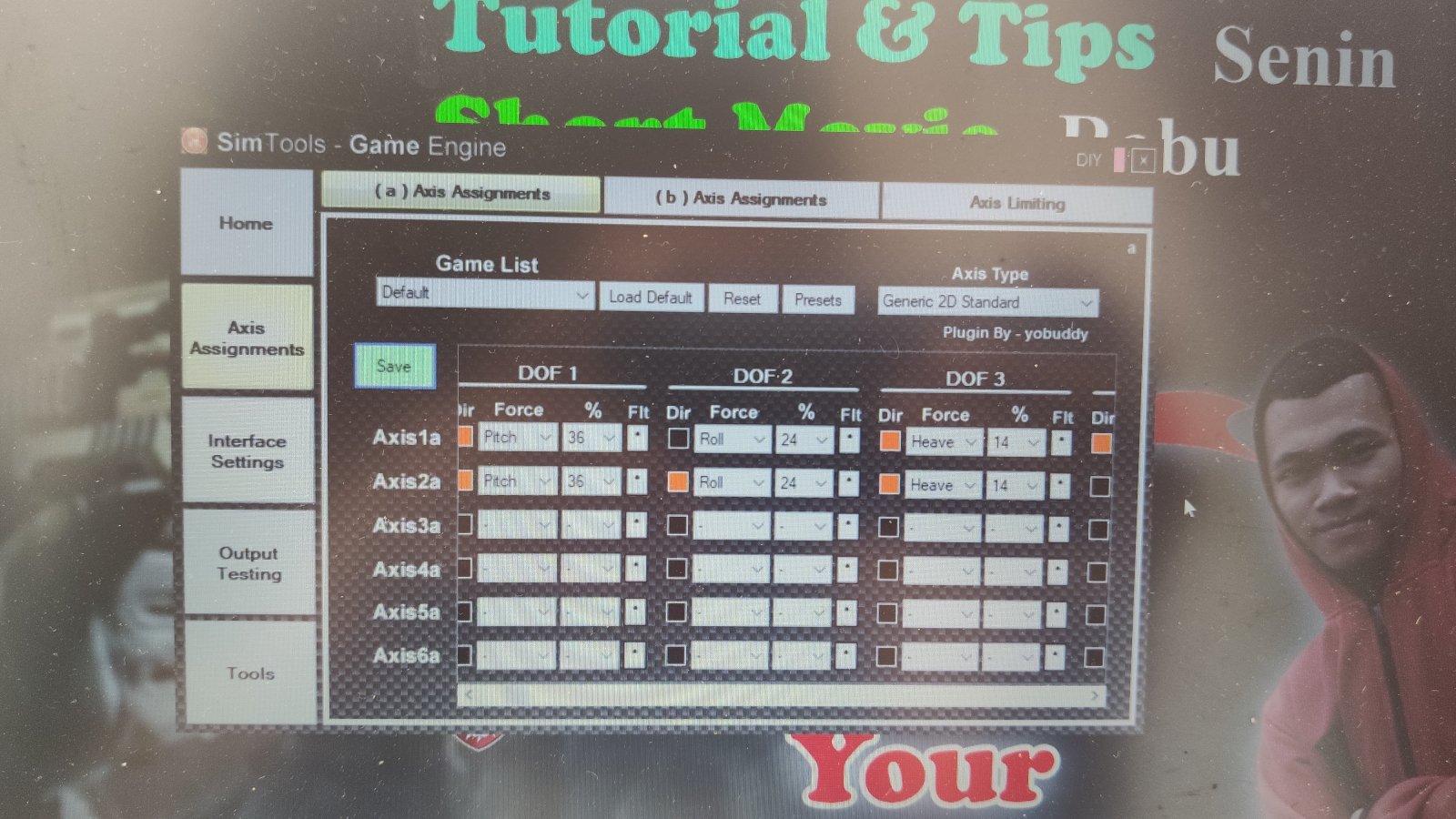

    This is my setup, when i output testing everything is ok, roll, pitch, heavy, sway, surge are ok.
    I follow the intruction on DOF roll tilt left or right, same also for other axis

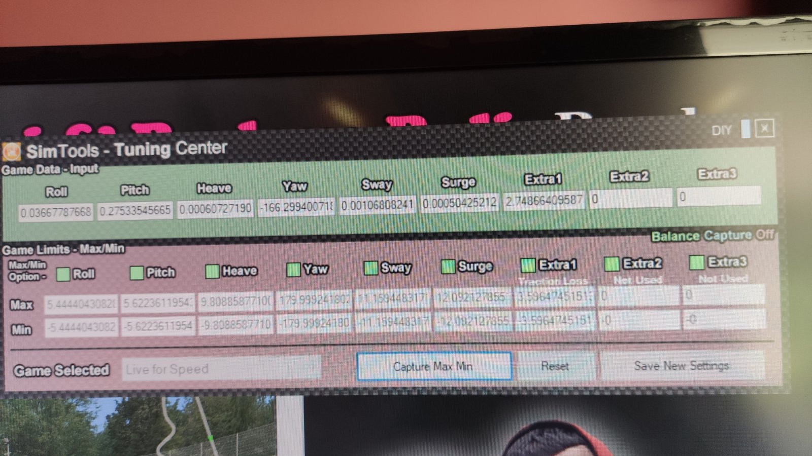

    What are the game Tuning Center values when the game is running, particularly for surge?
    Have you captured the Tuning Center values, see the tuning tips in the FAQS: https://www.xsimulator.net/community/faq/steps-to-create-a-motion-profile.228/

    The Tuning Center values are likely too high, in particular for surge, which for some games may end up being a value below 1.
    Temporarily disable other axis by setting their values to 0 and as a starting point set surge to 0.5 in the Tuning Center. You should be able to feel the effect and tune it further from there, before re-enabling other axis.
    When trying to capture Tuning Center Max/Min values, aim for about 80% of your normal race speed, you don't want to crash or hit anything, but you do want to realistically capture the motion at speed and track events, such as potentially riding a curb in a corner.

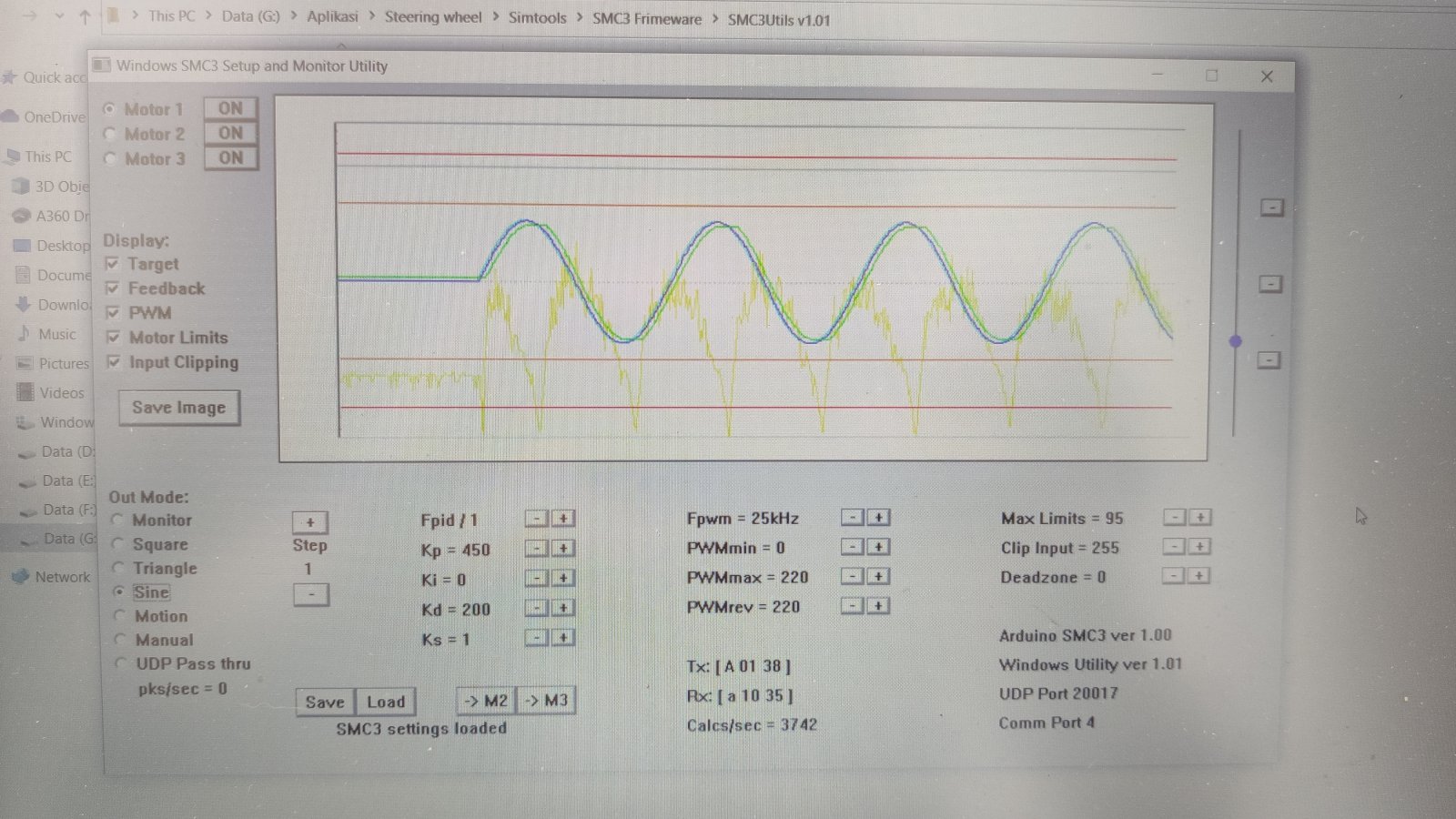

    Ok i got it sir, but for now, when never i hit or crash something arduino will disconnect sir, what wrong? Because of emi??

    EMI can be one possible cause/factor, but there are others, the settings (SMC and SimTools) may lead to power spikes that the PSU and/or USB (normally produces and audio alert) can't handle.
    As an experiment, in Game Manager, under Profile Editor, lower the Intensity Lever to say 94%, does the disconnect still happen?
