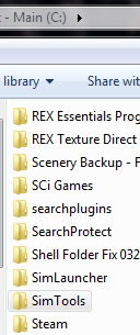

    ScreenShot001.jpg bsft - You will see in the above left screenie, I have SimTools "installed" in the root of C:\ - I don't like installing anything IF I can into ProgramFiles folder

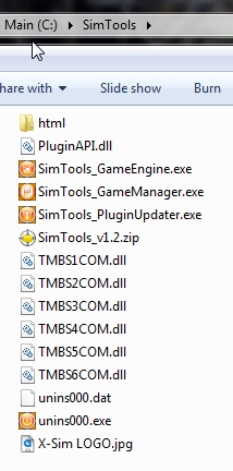

    ScreenShot002.jpg The second screenie shows the contents of the SimTools Folder - There is NO Plug-Ins Folder.....present
    Do I need to just make a new folder named Plug Ins - and when I d/l plug-ins, just put them into this newly created folder???
    Thanks again,
    Tom

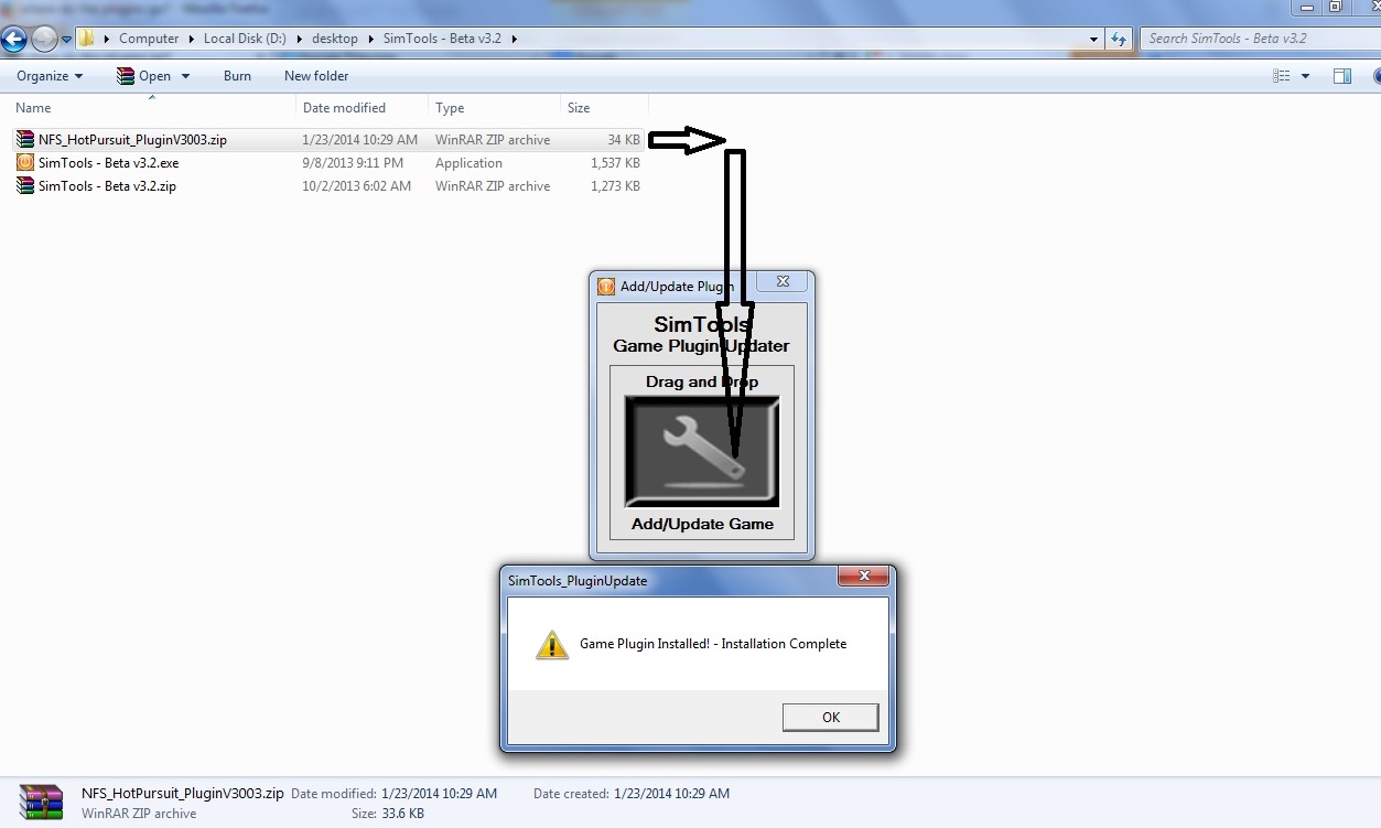

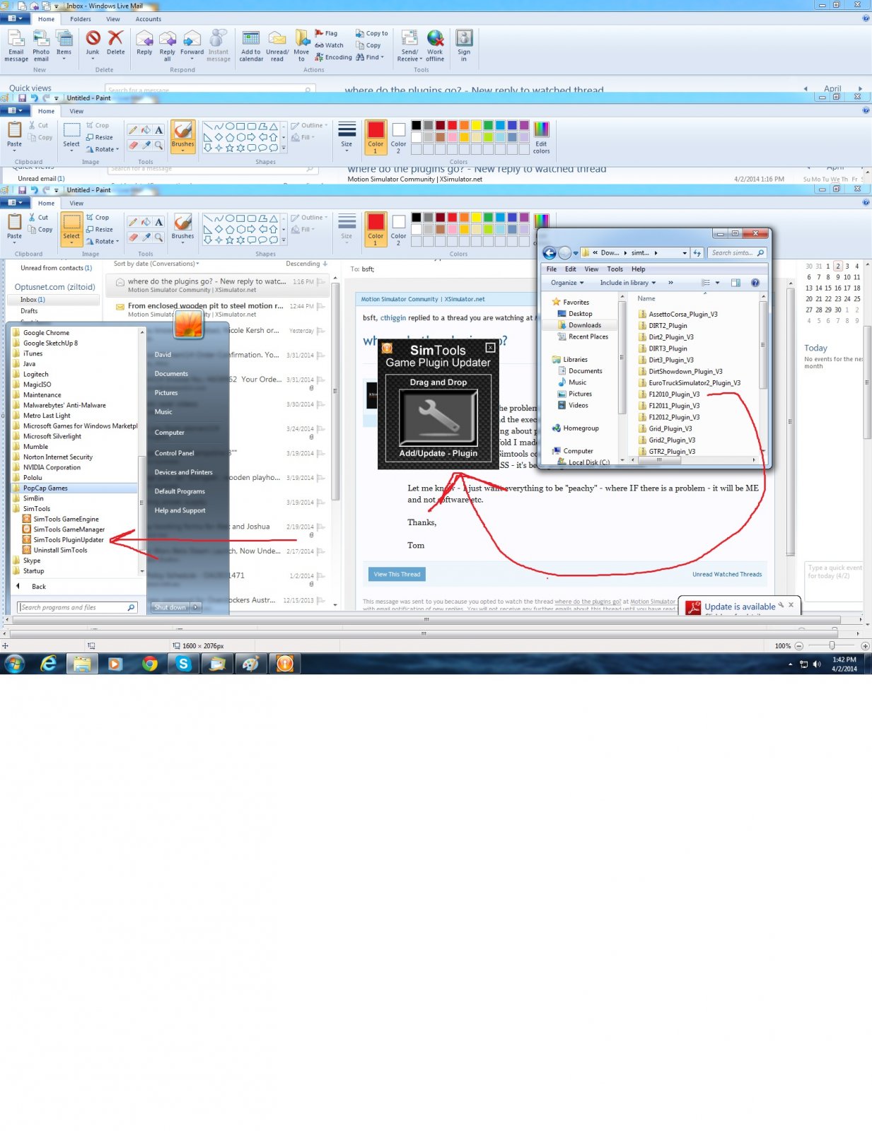

    Dear Tom ... the "GamePlugin Updater" is a program to run and it will self update for you ...
    just run it and as @bsft said ... [ Drag ---> Drop] ... the zipped file of the game plugin in its square window ...
    SimTools is easier to update than other programs you may based your thinking on ;) ...
    Then Go open the Game Manager ... you'll find the game name with it's all related forces profile is ready to go .

    Yes sir, I do know that we "drag & drop" the plug-in on the SimTools Game Plugin Updater - and if successful, we'll get the window stating Instal.....Complete.
    What I am asking - in the SimTools Folder - is there "another folder" named Plugins???? - and when you download a new plugin from the forum, you "save it" into that Plugins Folder - and of course from there,
    you would "drag&drop..............
    From looking at your heiarchy, YOUR plugins "reside" in your root SimTools Folder??????
    Hope this makes sense now of what I am asking instructions on.

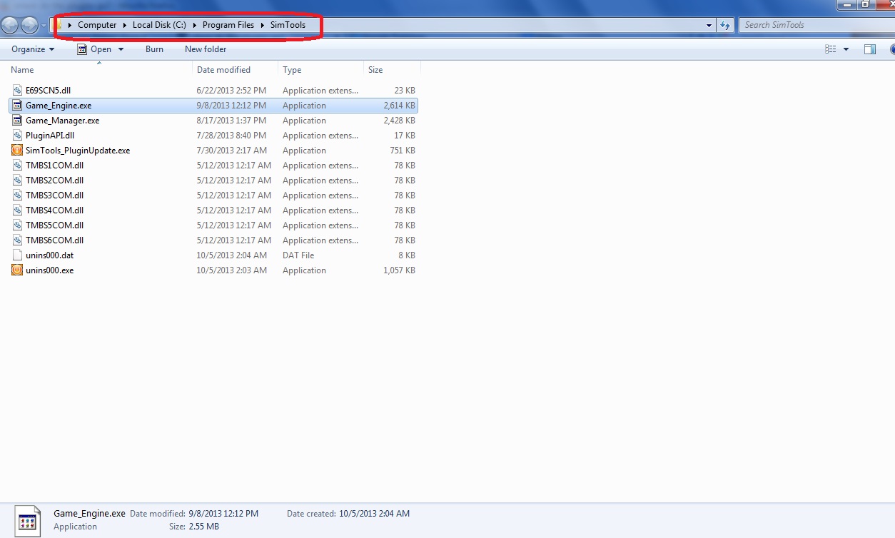

    No sir , There is no sub folders ... Me too ... No folders inside SimTools main program folder ... it's just dll's and data files ... what made you think there would be ? Unless of previous experience on some other programs update basics ...
    For WIN-7 Administrator rights to copy files there on drive C:\ and for more easier to integrate such updates without restarting or stopping the program ... I guess for such copy past operation in some old programs as this is history now ... SimTools is much powerful ... Don't let the history stuff confuse you .
    The previous post picture is a desktop folder where I first downloaded and put all related files into it ...
    Keep Up The Good Work ...:thumbs

    To install plugin into Simtools is very simply,
    Don't Unzip the container file. Keep as a backup.
    Close the Game Engine.
    Close the Game Manager.
    Start the Game Plugin Updater.
    Drag and drop the zip file to the plugin updater.
    It then sets all the files to their right locations , no need to mess with plugin files ever.
    Patching the game with Game Manager does all the game side of thing you just need to point it to the right directory and press patch, it does everything for you.
    The provided tools where made to make this process as simple as possible as our previous hell of doing this in another software was totally mad, this is painless and easy, let SimTools manage this for you, Manually copying files across is known to cause problems.
    Sorry I hope I have made this clear, please don't copy files around use the tools SimTools provides.
