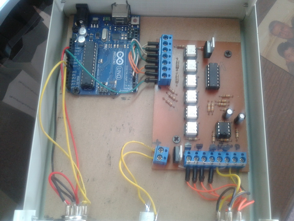

    Hi @speedy
    calculations are ok but let say when i just was testing on breadboard the resaul was deferent as I tested one channel compared 6 parallel channels
    and then what it actually makes the situation better resault was when I used side resistors arround 2.5 time bigger than for input resistors ,well as your
    calculations, what if using 390 ohm for input resistors and something arround 1 K for side one.
    unfortunately ive done this a few months ago and no video here.i attach AutoCAD file for sprint layout. please you do final edit
    here is my own set up
    about the jumper ,YES;) buddy
