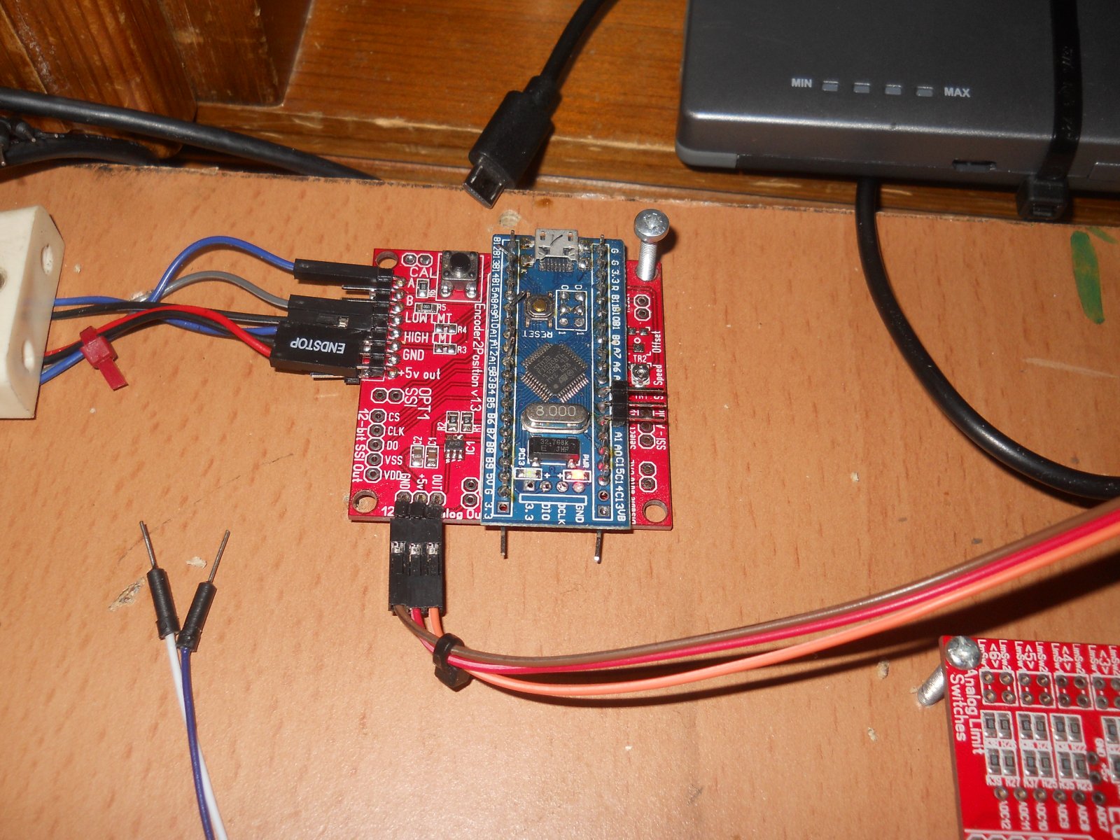

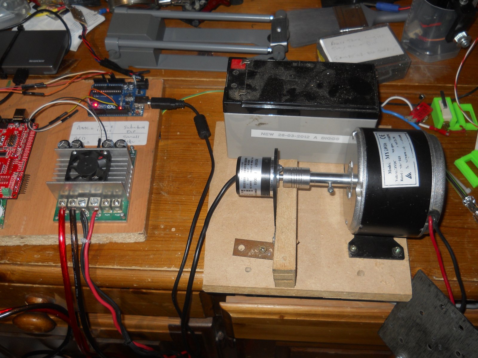

    hi guys a bit pleased with myself at this little test today , as you may or may not know I have been looking into usung Thaanos's Encoder2pos Interface to allow me to use Optical encoders as an alternative to Rotary Pots .. well 1st of all I have the units running well on my trial setup using Encoder2Pos Interface,Sabertooth 2x60 and trialed on two software interfaces
    1 AMC128USB, Ians BFF 6dof motion controller Software, encoder2pos interface with 600ppr Optical encoder..
    2 SMC3 Packet serial , encoder2pos interface with 600ppr Optical encoder , Sabertooth 2x60
    having had some success with the 1st option and after trying BlazinH's SMC Packet serial option I had a light bulb moment ( this may have already been attempted but for me it was a 1st...) anyways thinking that the Encoder2pos interface spits out 0 - 5V for a your actuator total distance travelled, once calibration is done then hmmmmm why not connect this to the ARD SMC setup .....:)
    after a little fine tuning i'll be dammed, the dam thing seemed to work a charm ...that was the YEEEE HAAA Baby moment.
    its early days yet and until I can get sorted Simtools V2 wise I need to do more tests , but have to say so far it look good . Will post Video once I tidy the man cave a wee bit and make spaghetti wiring look semi presentable ..

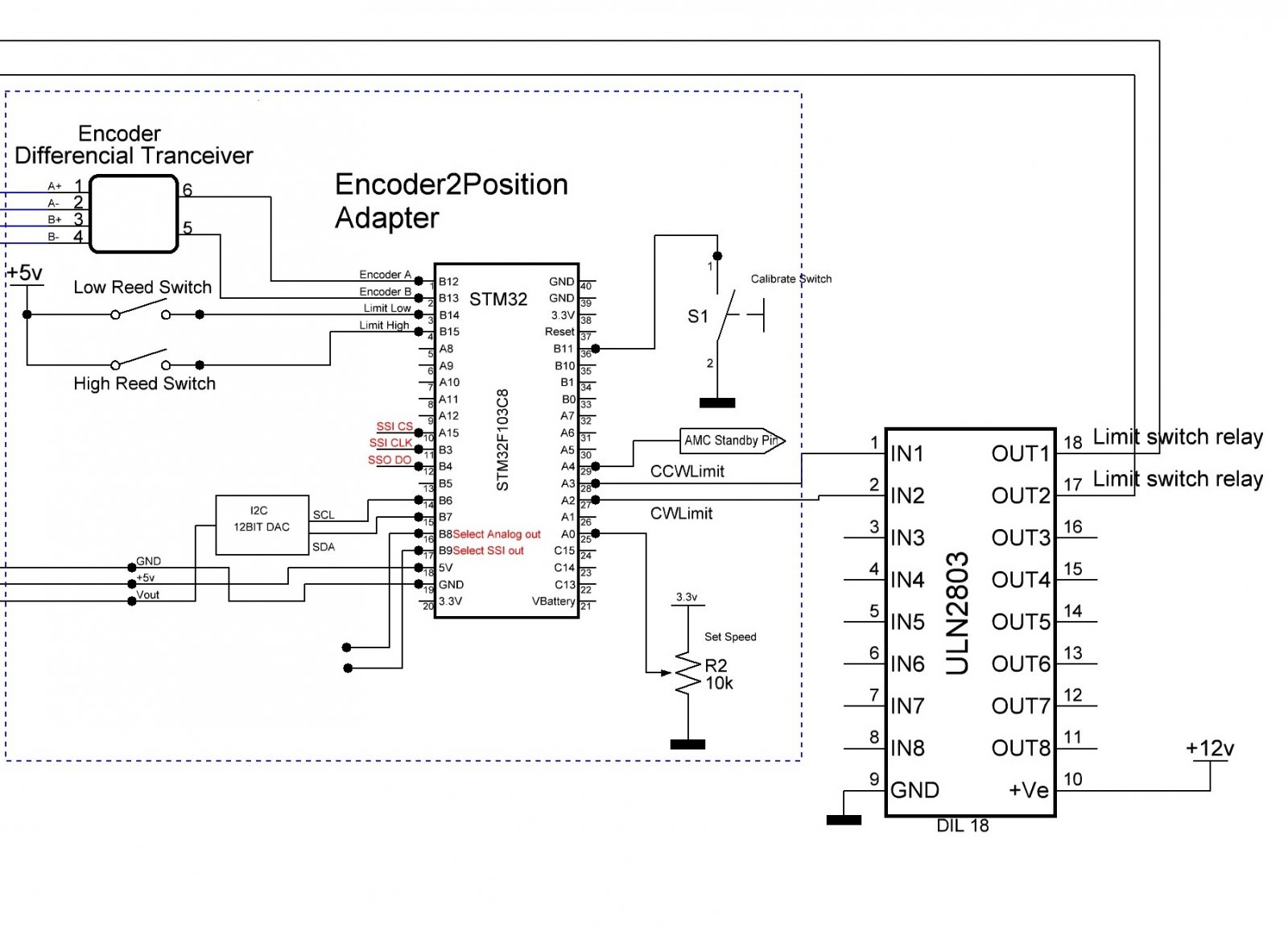

    Don't forget, you need to have the SMC3 be steady in 50% while the encoder2position module calibrates, otherwise the motor won't move to both directions to complete the calibration. As soon the calibration on the Encoder2position is done, it indicates its ready by a LOW signal on pin A4 (HIGH during calibration).
    This also means you need to be careful not to calibrate the motor while the SMC3 is performing motion from PC... perhaps you can alter it code to block motion and set the output to 50% while the A4 output is HIGH.

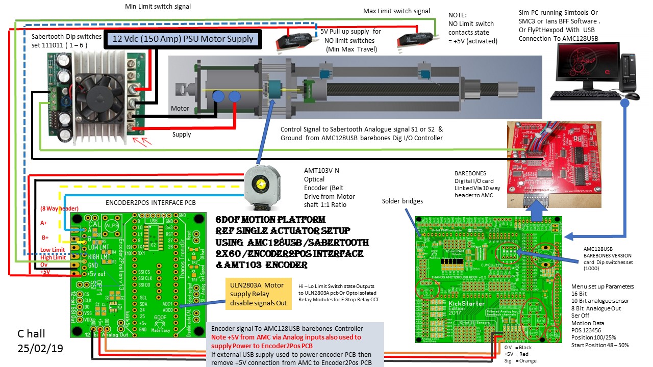

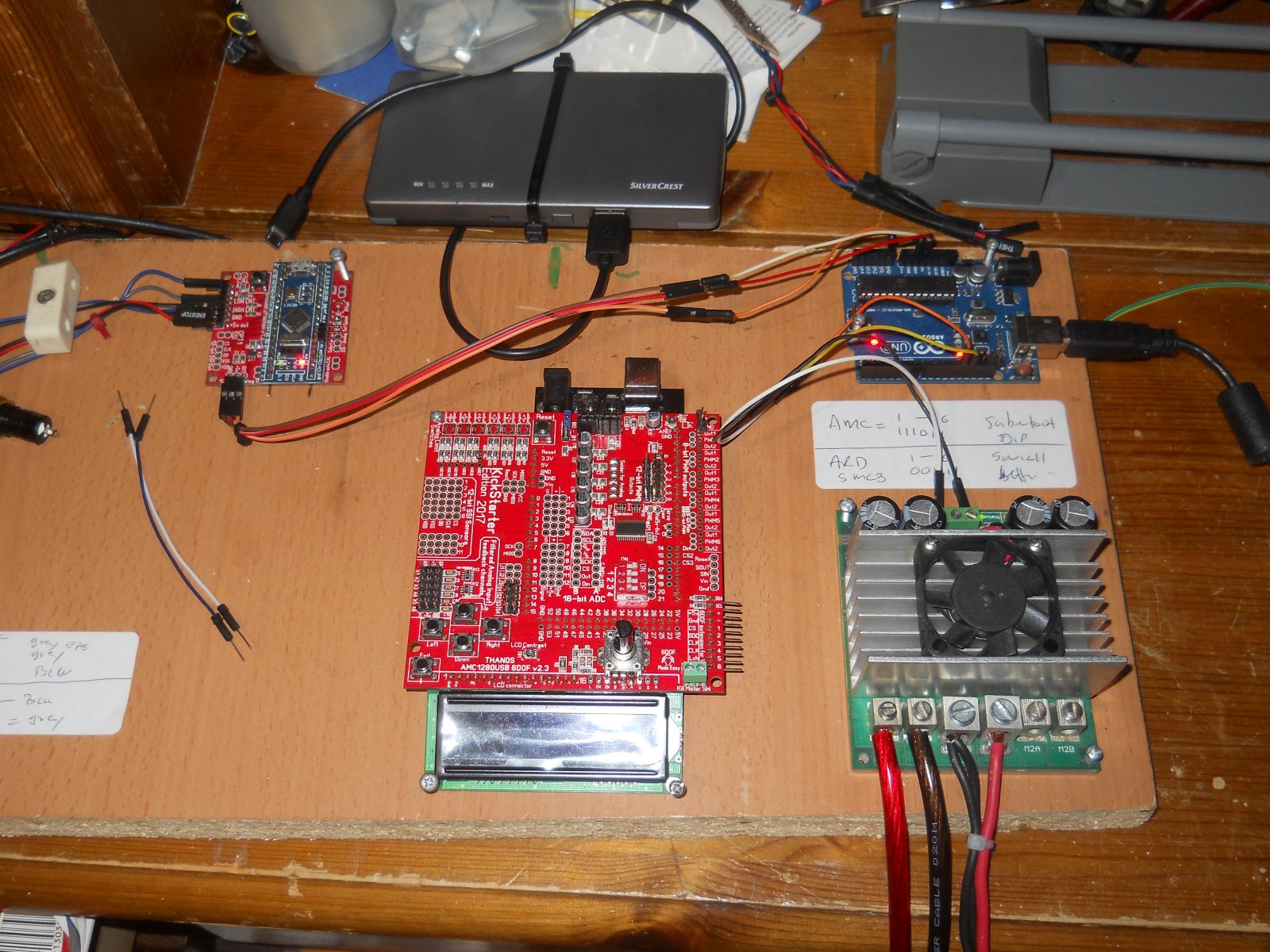

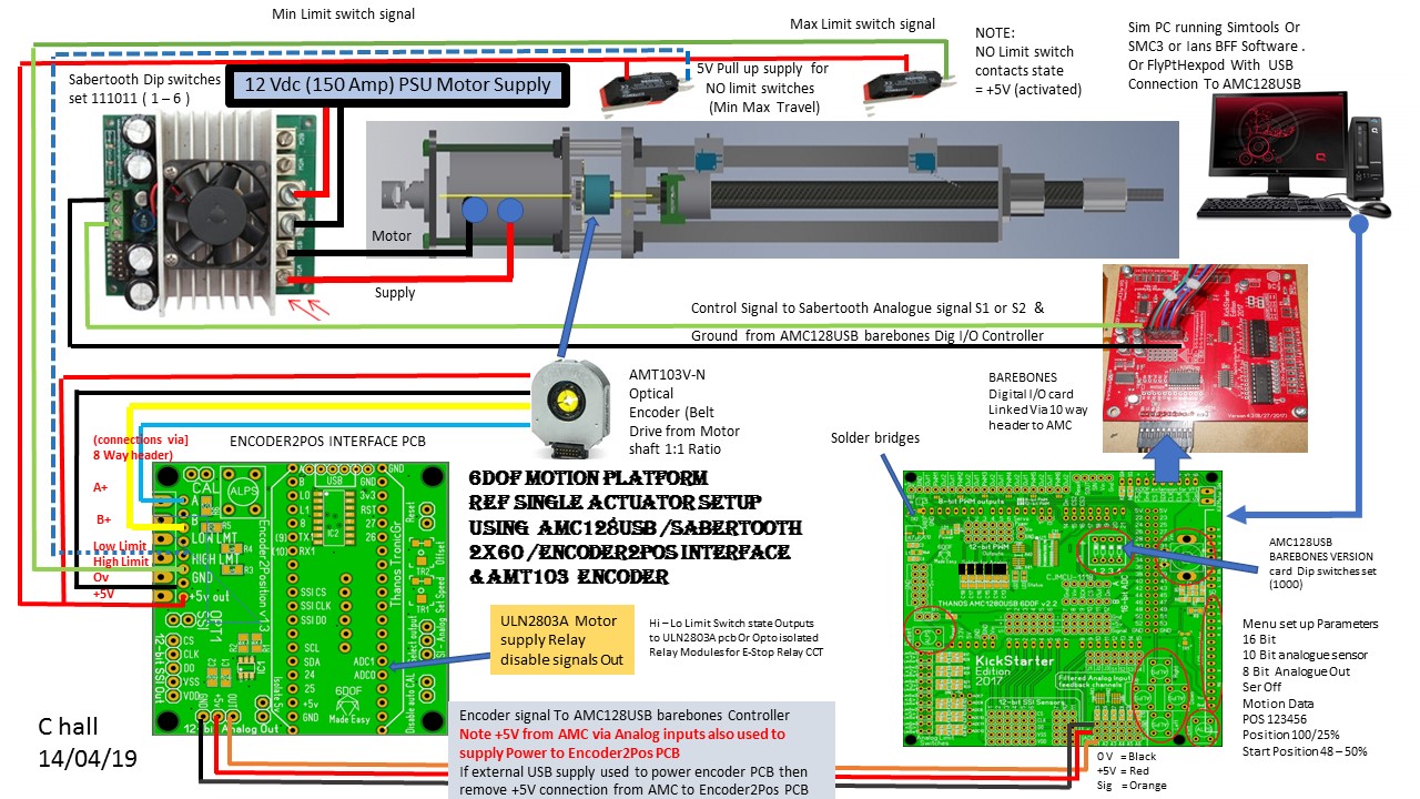

    Hi Crew , Small but positive update, so Basically after beating my self up trying to get the New Encoder2Pos Interface working i was about to call it Quits when @Thanos came to the rescue yet again .:)
    As mentioned in the AMC128USB posts i turns out the Optical encoder i was using was nit Compatible and led me to all sorts of test issues which eventually made me think i will have to stop and move on..
    Anyways Thanos Recommended an Encoder which he knew worked and so i opted to give this test one more try , The Encoder2Pos interface was fine the AMC128USB Barebones version was also fine and so once i added the new AMT103 Encoder all my lost position errors went and the Actuator now has a reliable Encoder Option fitted, so i once again had a safe to use powerful Actuator .
    Been stress testing it as much as i can , and so far the results have been very promising , my confidence that the actuator wont try to kill itself or the operator has increased tenfold and i have as yet not once seen the E-stop limit switches being tripped ,
    i have attached my pictorial connection diagram , and will post proper updates describing how i set the system up in the next few post .
    With the tests now going better i anticipate the next step will be to Buy more Encoders and retro fit them to my remaining 6 actuators ---Then finally after this long laayoff i can get to play with my fully working 6DOF platform
    more to come :)

    Which encoder were you using before because looking at it I have bought one myself to test and it looks the same as the one you had lots of problems with. Was it one of these ?
    Wisamic 600p/r Incremental Rotary Encoder Dc5-24v Wide Voltage Power Supply 6mm Shaft

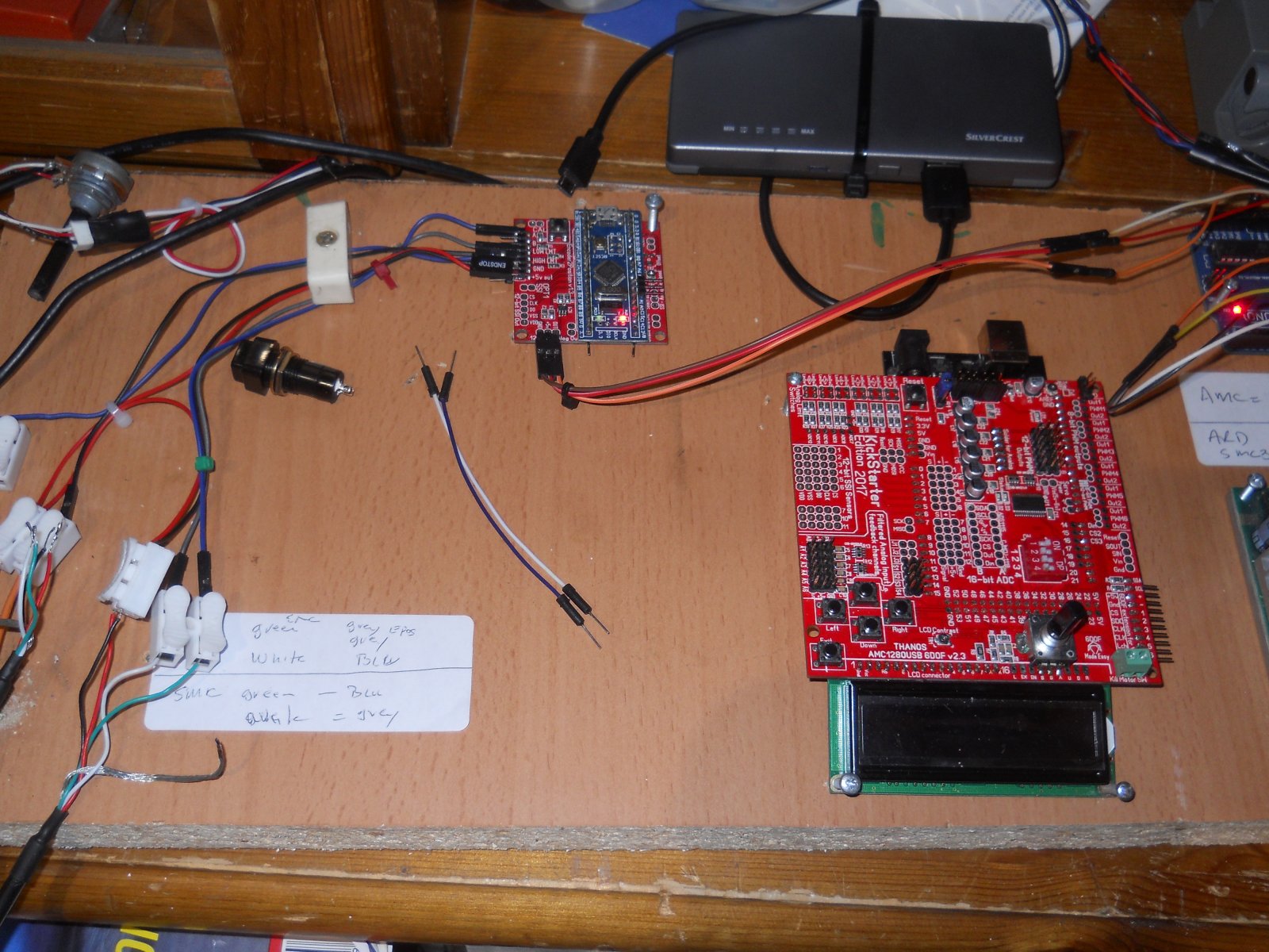

    Hi @SilentChill yeah mate you ended up doing what i did , these are similar to the ones i bought via flea bay and Nowt but grief trying to get system to work safely ..the AMT103 were Circa £18.00 A pop so now considering the price difference you would save a bucket load of hair pulling. note these amazon / flea bay type encoders work fine on other projects but found out they are just not really compatible at moment with the Encoder2Pos Encoder interface im using .
    Been manually testing this setup now through FlyPT for these last few days now, using my spare actuator, and there's a mile load of improvement, the main thing for me is that the actuator is safe again .. it was scary trying to get the system to work with the original encoder and to be honest i was about to chuck towel in and to his credit @Thanos set me on the right track , so once again im a happy camper .. i bought my 2 from Digikey UK ( funny thing is it was shipped form USA ??? ) no biggie as it was here in a few days .. .. Cheers @SilentChill
    What interface are you using with the encoder at the moment ?

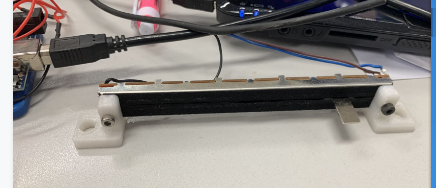

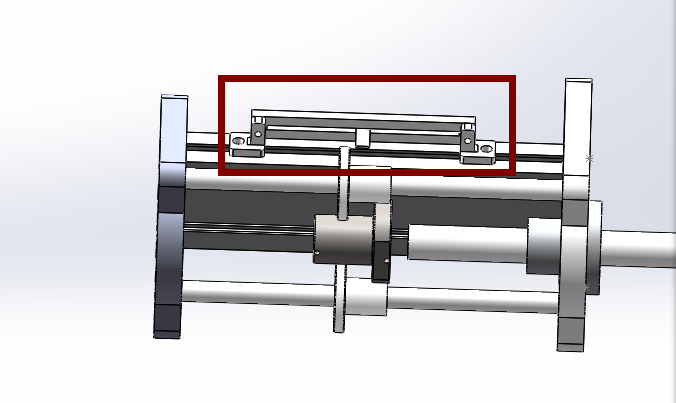

    Very good project, I use a push-pull potentiometer!
