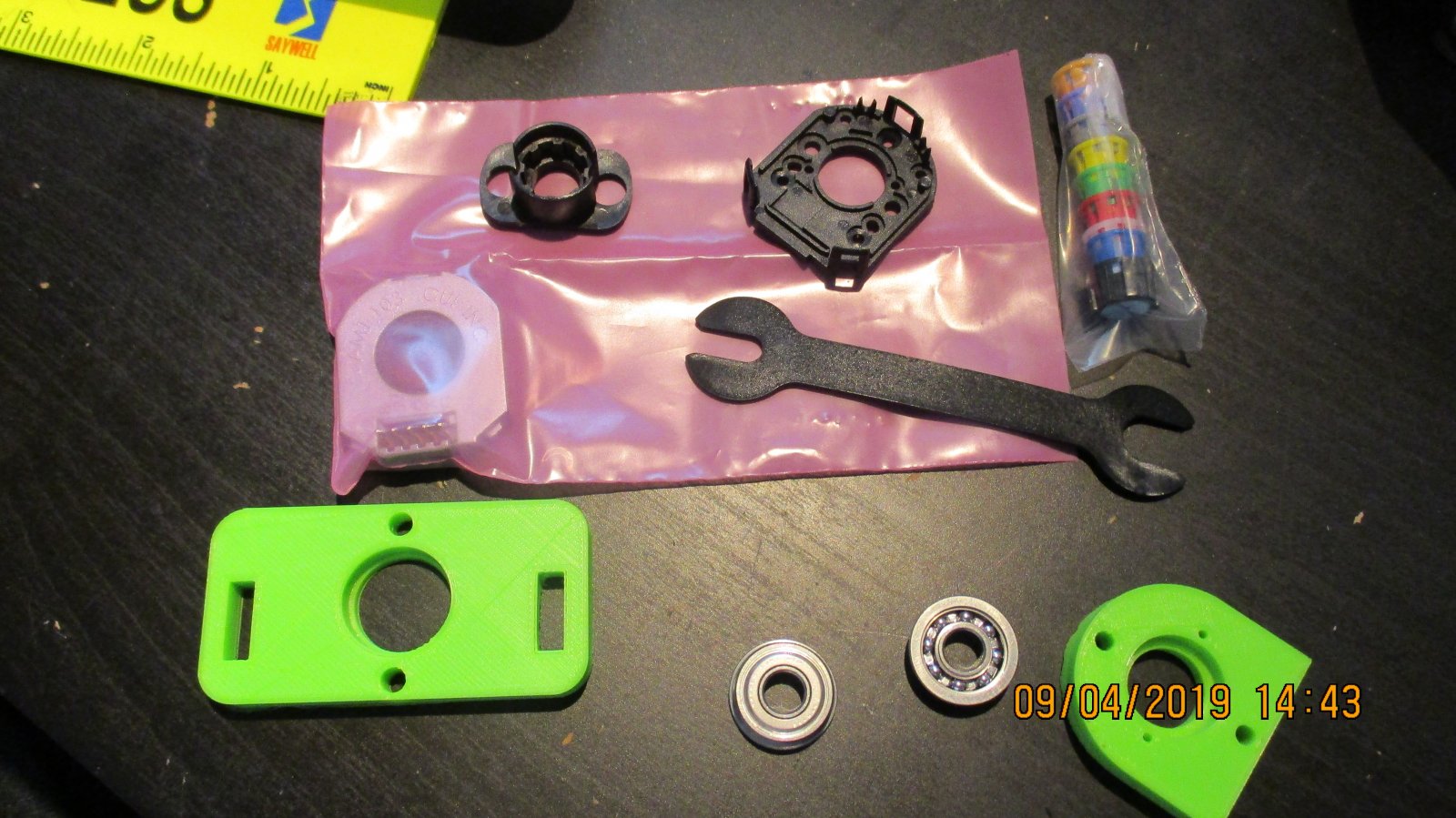

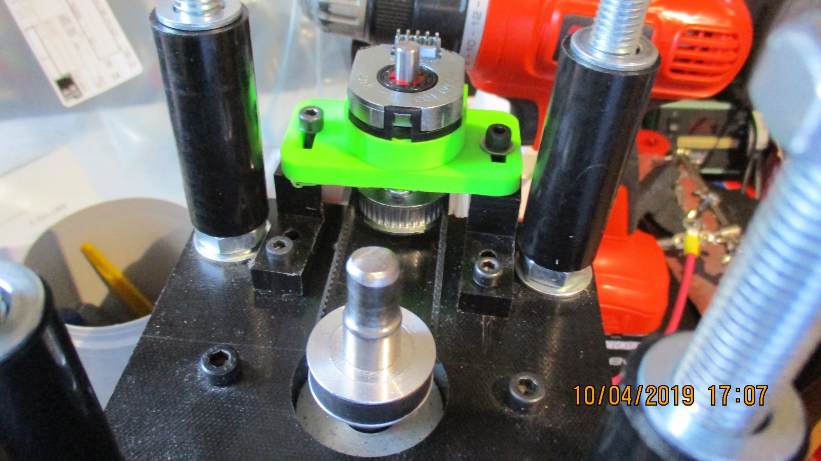

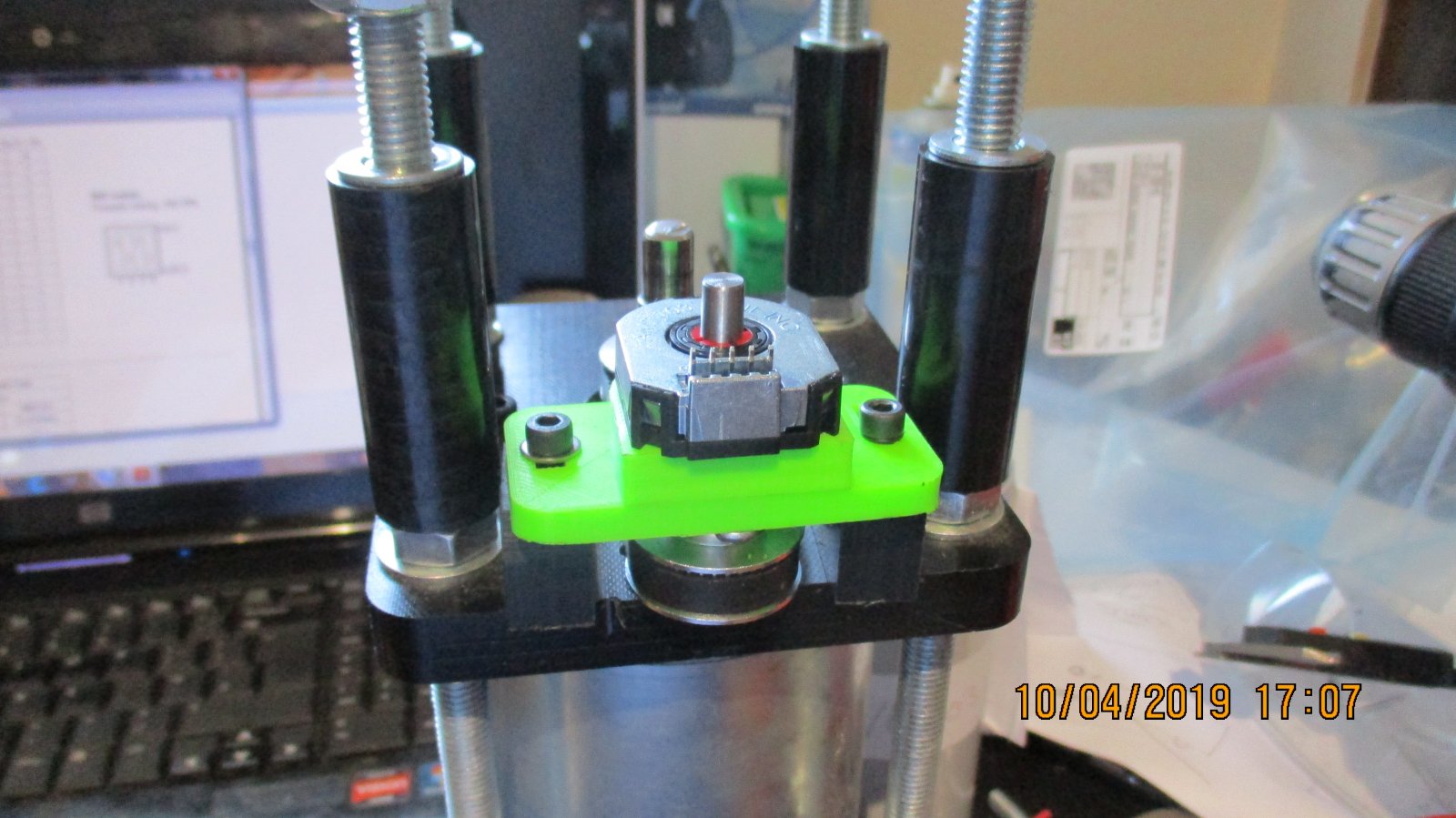

  19. wannabeaflyer2
    Jun 12, 2015
    724
    london uk
    8,362Coins
    +958 / 7 / -0

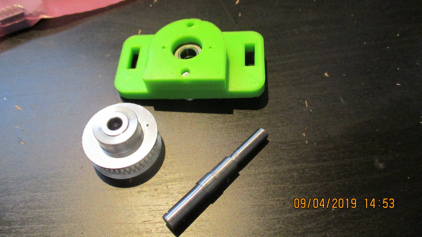

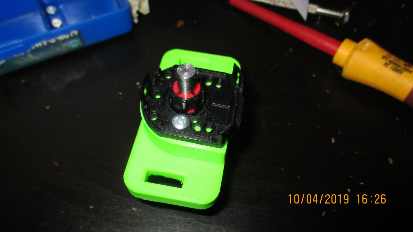

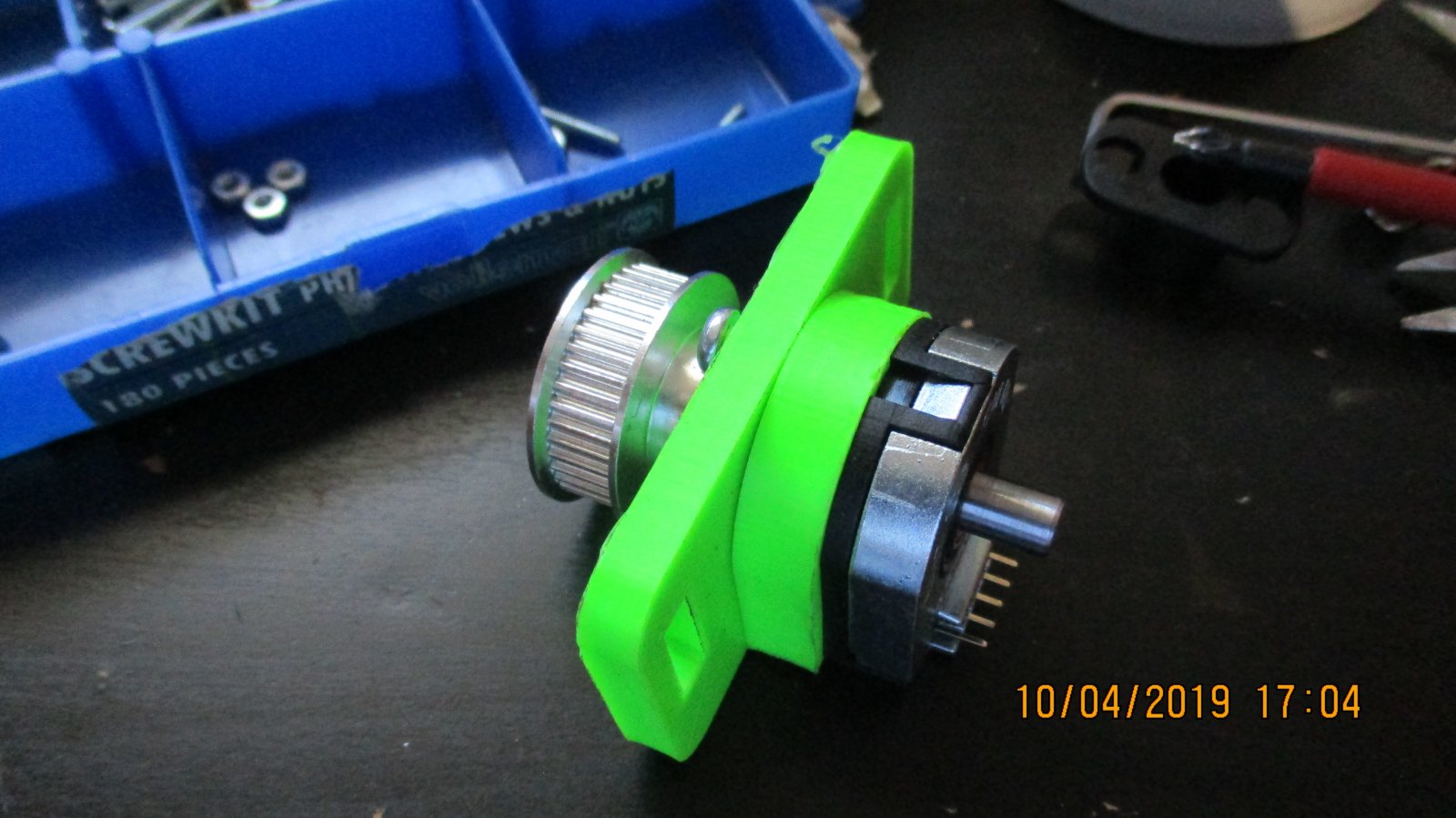

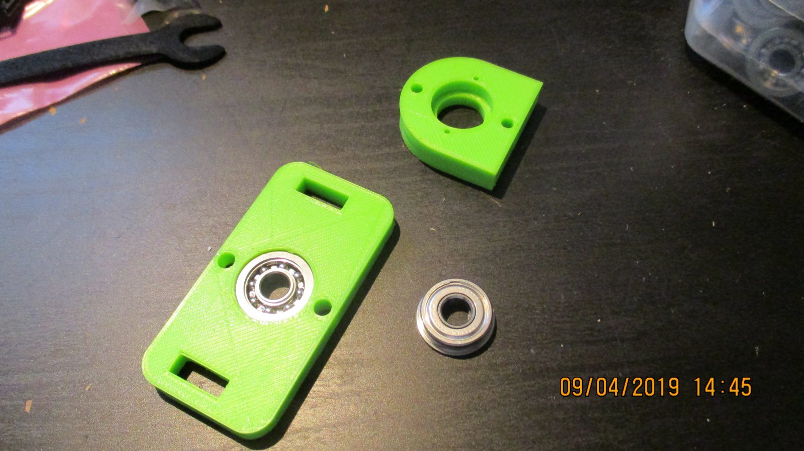

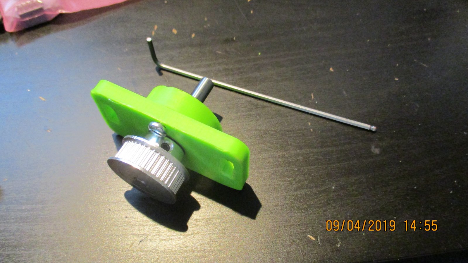

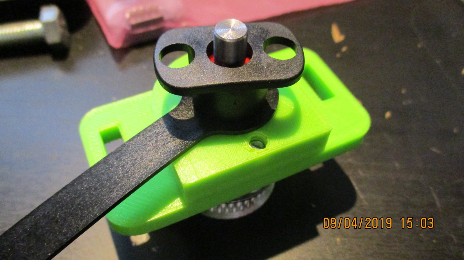

    Hi @Thanos My New AMT103 Encoders have arrived and 3D mounting for belt drive adapted ...was a Bugger As I had to Modify some M3 Fitting screws to suit But sorted now .. a few Picks of the assembly before testing starts Tomorrow hopefully ..
    Fingers Crossed for this trial using this recommended encoder..
  20. wannabeaflyer2
    Jun 12, 2015
    724
    london uk
    8,362Coins
    +958 / 7 / -0
    Hi Guys yes I Know im only posting test setup info but thought it would be good for others to learn from my mistake , Ok heres the latest , and Big Thank you Again to @Thanos for bringing my sanity back :)
    been having a Play ( testing ) the New AMT103n capacitive Position encoder as recommended by Thanos, and so far the big smile is back on my face (for Now LOL ) as it seems my lost position fault has now gone and the Actuator seems to be tracking correctly no matter how fast I move the sliders in FlyPt ..
    so Hindsight being what it is ( someone here called it a female dog ...totally agree :) ) , it seems the 600ppr Optical encoders I was using for the initial tests with was the wrong type for this Interface and all of that along with the mother of all assumptions combined, sorrta lead me up the proverbial garden path ( don't forget the doubting sanity part as well ) so its great to be able to say / report that with this new encoder fitted, and after calibration, the combination of FlyPt works Over full slider Distance and does not hit either high or low limit switches , Plus I have not yet tripped the E-Stop Limit switches Either .. ( Currently I have 2 Sets of Limit switches set up on this actuator ( one set for Encoder Calibration and the Other as Runaway Fail safe ) .
    Money well spent if this progress Follows through on all the other actuators which will need to be upgraded Once I really stress this Encoder setup and if all goes well I can have confidence that the system wont throw a loopy because of lost Actuator Position ..
    Will now move my comments out of this Post and place any future update under my DIY actuator Posts .. Cheers @Thanos and @hexpod for your Patience and assistance .and to all the crew here for making this an ace forum
    So as it stands at the moment, I have my test setup of Sabertooth 2 X 32 .Amc Barebones ,Encoder2Pos Interface and Belt Driven AMT103 Encoder working with FlyPt for one Actuator the other 5 will be Upgraded soon dependant on me brutalising this test phase :) new Wiring diagram will be posted for AMT103 Connections /Actuator setup ..
