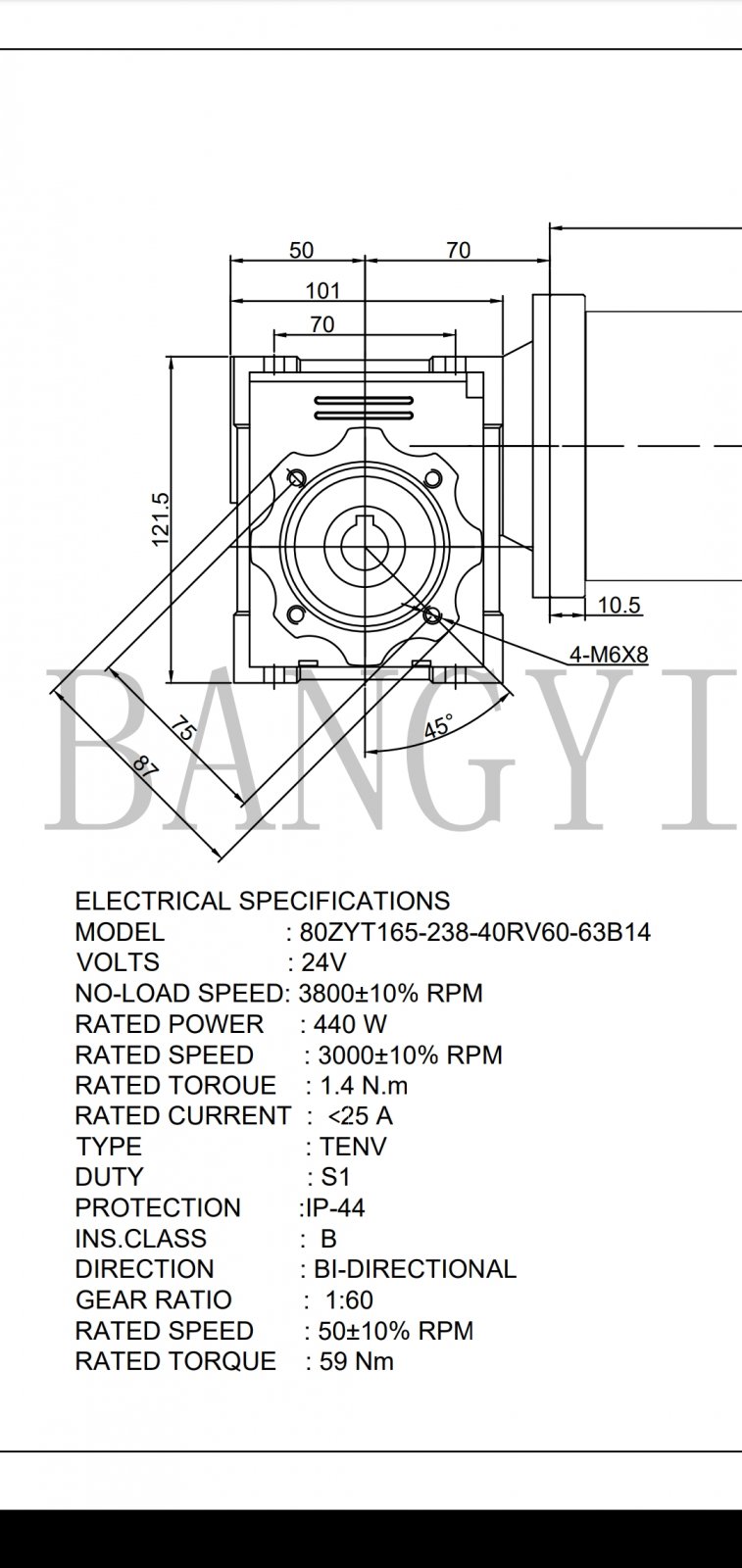

    I m new in the forum and i start doing my own 2dof seat mover based on the sck gaming project(great video).
    I m looking for suitable motors with autolovking system when they are power off i contact with a manufacter who send me this motor what you think about Screenshot_20210922-142150_Drive.jpg

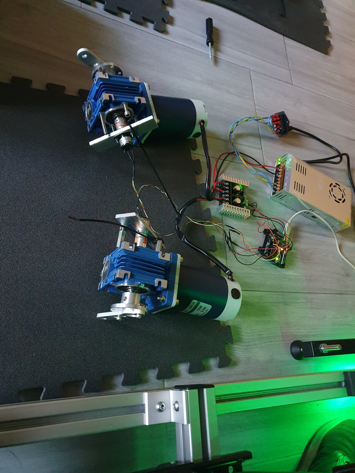

    This weekend if i get all the shipments... i will start with th 2dof seatmover

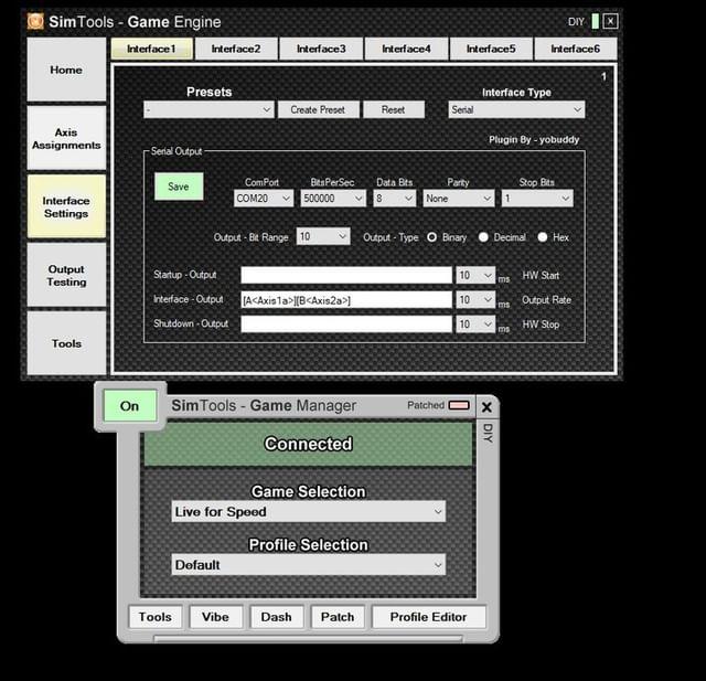

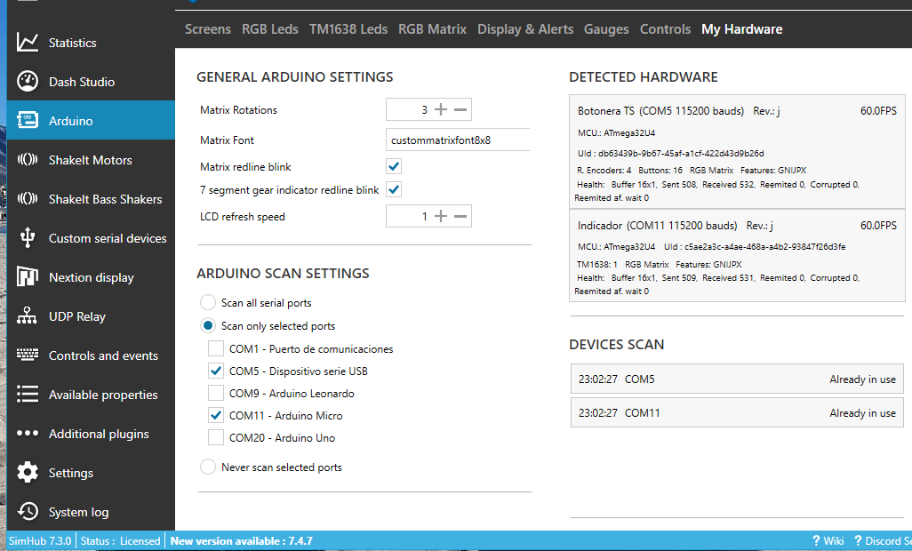

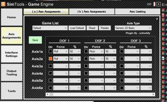

    Im using arduino uno r3 and sabertooth 2x32 set it up to 115200 bauds.
    But no results with simtools, also i have most of time issue conection with the smc3 for the first time i boot.
    Then works perfect, i try modifying the com port to 20 with similar result.
    I don t change nothing in the sketch.
    I hope someone could help me
    Thanks!!

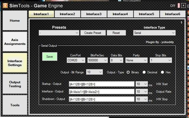

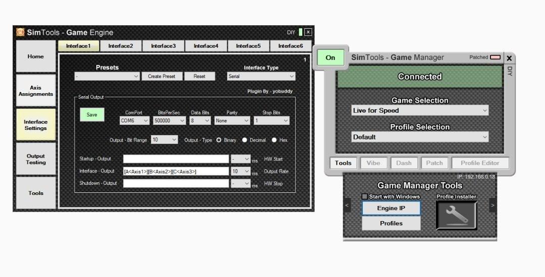

    In different pictures you have different settings and different Com Ports.
    Can you please verify what ComPort is actually being used.
    Normally with SMC3 the rest of the Interface Settings would be:
    BitsPerSec - 500000
    Data Bits - 8
    Parity - None
    Stop Bit -1
    Output Bit Range - 10
    Output Type - Binary
    Interface Output - [A<Axis1a>][B<Axis2a>]

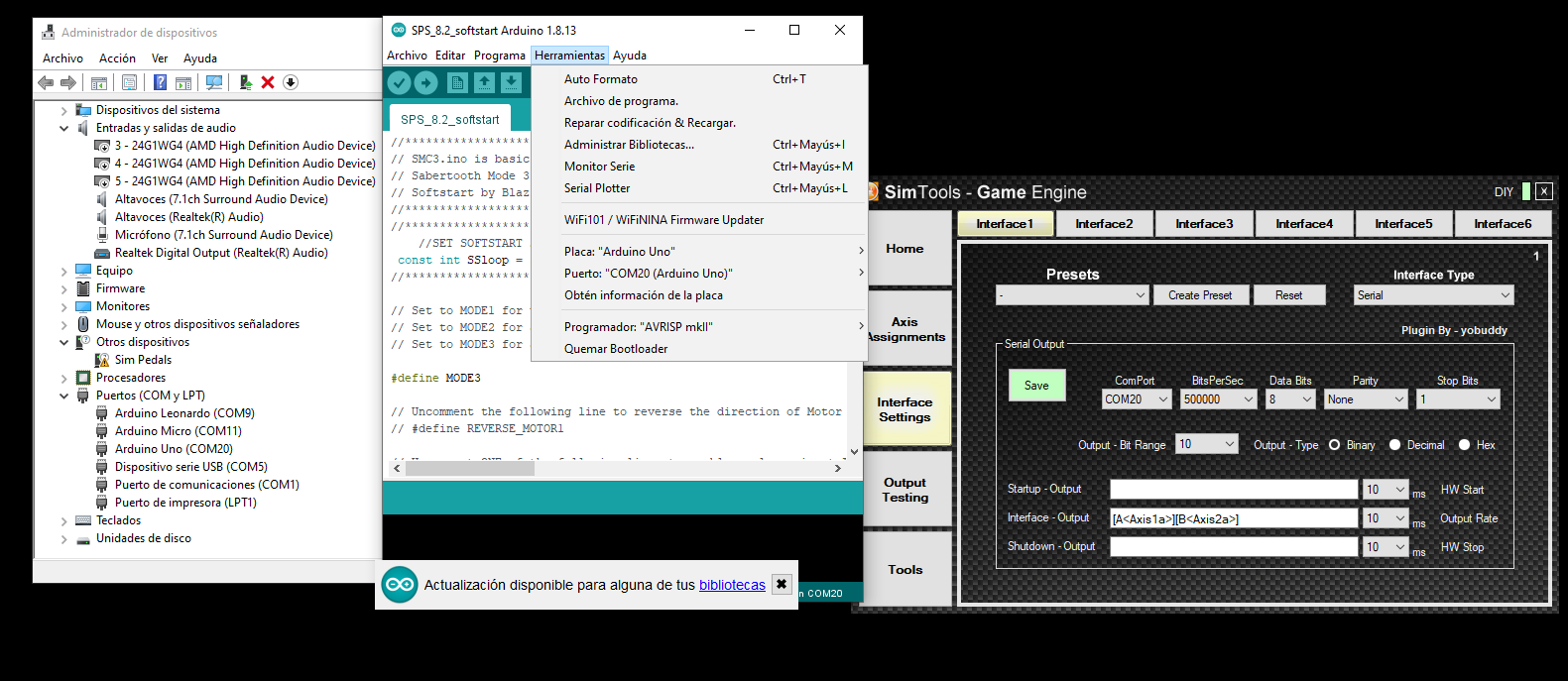

    Im using the one you post in port com 20
    21,581
    151,100Coins
    Can you please verify the Com Port with a picture of Device Manager and the Arduino IDE under Tools -> Port

    first of all thanks for your replies
  12. Turbaso
    Turbaso New Member
    Sep 21, 2021
    26
    Mechanic
    San sebastian
    113Coins

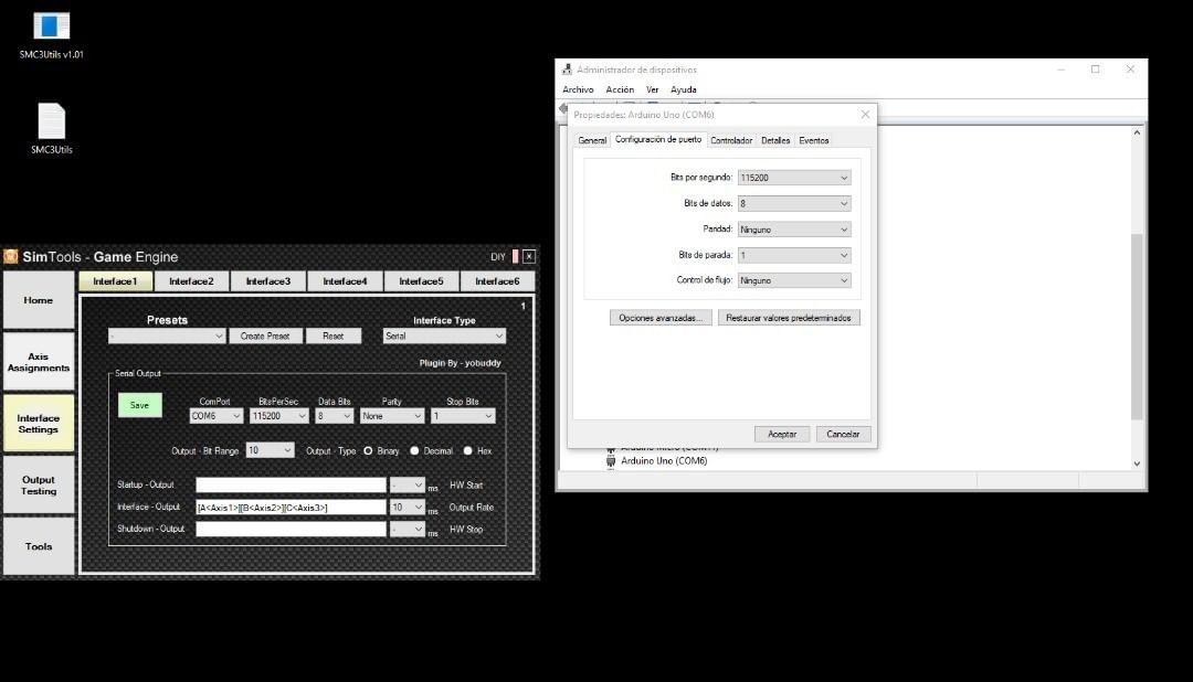

    this is how now is configured, with no results
  13. noorbeast
    21,581
    151,100Coins
    So just to take it one step at a time, to aid troubleshooting, with this Com Port SMC3 is properly configured and works as expected?
    Make sure SMC3 is shutdown before starting SimTools, as both can't run at the same time, as that will cause a Com Port issues.
    In SimTools is a Default Axis Assignments defined?
    Does Output Testing work as expected when the Default Axis Profile is defined?
    If not, please temporarily disable your antivirus and firewall, restart SimTools and check if either may be interfering with communications.
    Also make sure your computer is set to English Local, as that is a intermittent known bug: https://www.xsimulator.net/community/faq/simtools-language-setting-bug-change-to-english-local.233/

    I try all as describe working in smc3 but not in simtools with the firewall disable.
    Also some times need more than one plug and unplug to be detected by smc3 tools but never with simtools.
    I will try this afternoon i never read about the issue of the language so i will try and post

  17. Turbaso

    No Way!
    I found the issue
  18. Turbaso
    Turbaso New Member
    Sep 21, 2021
    26
    Mechanic
    San sebastian
    113Coins
    I don t say that i was running simhub, who was scanning all the arduinos connected to the pc. that was the reason some times smc3 does nt recognize the arduino and others yes

    thanks for answering it was my mistake don t saying nothing about running simhub for the bodyshakers

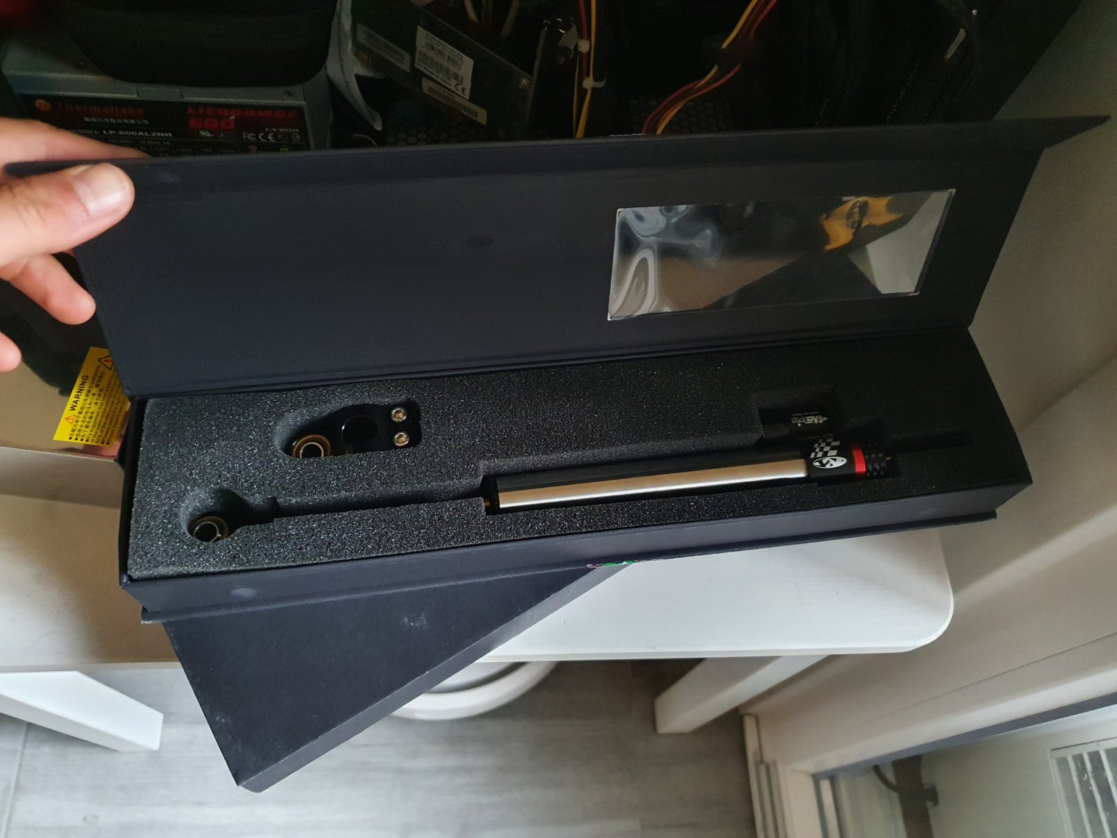

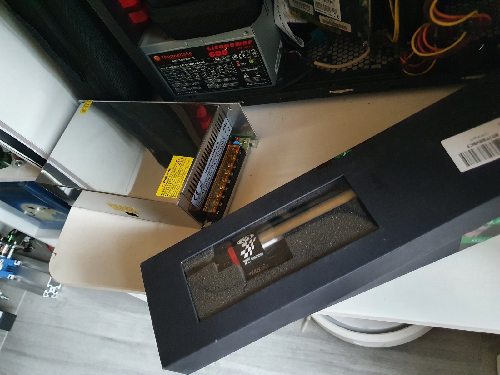

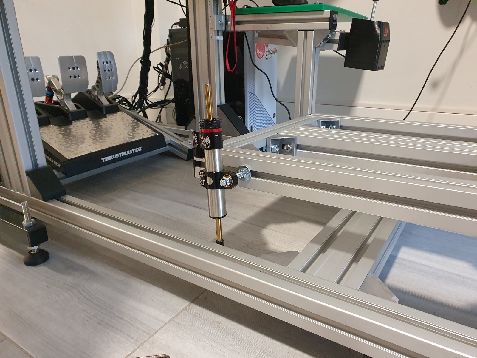

    Today arrive a more powerful psu and the damper i pretend to use to reduce the slack of the wormgear
