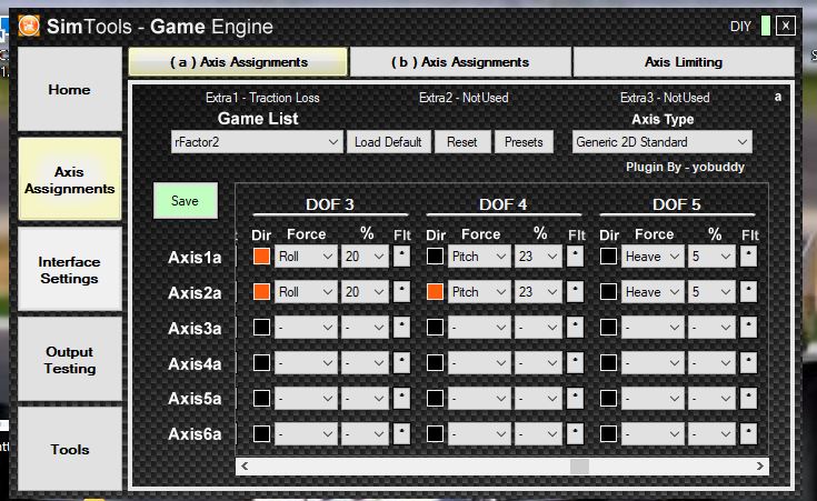

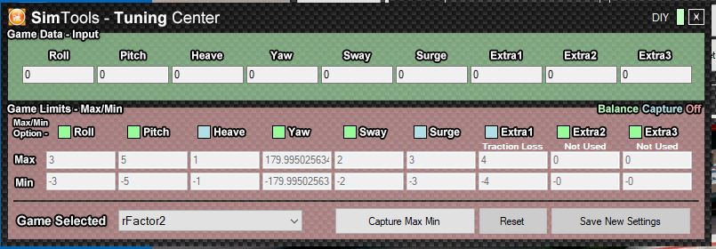

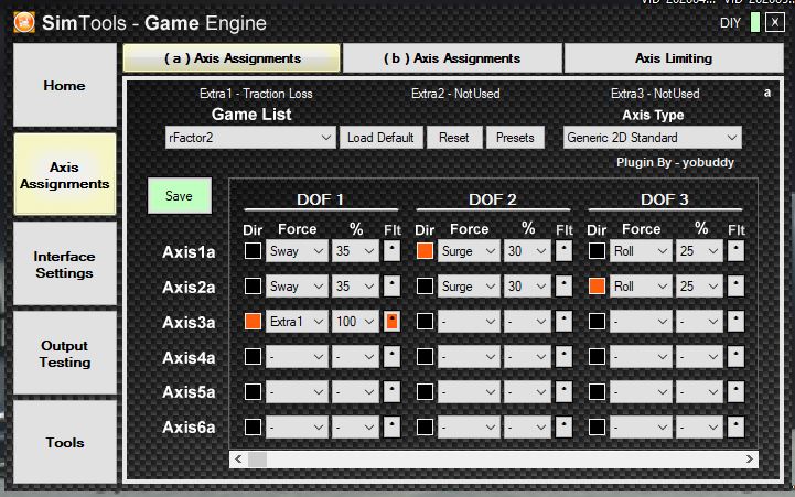

    I had some problems with the RFactor 2 configuration about the display setting and the Studio-397 didn't solve too. So I decided to re-install by Steam the software, but before I deleted every folder about RFactor 2.
    Now, it seems to be ok, only some mods have problems, for example DTM machines mods.
    I write because during the set up of axis assignment I 've observed the the sway and the roll didn't move, I set only axis 1 with 20% ,then 40%, then 100% but I didn't feel any movment. I've re-installed the plugin file but nothing is changed and I reset the values in tuning center.
    What's the problem?
    Best Regards
    22,225
    154,819Coins
    +11,226 / 57 / -2
    Does Output Testing behave as expected?
    Can you please post pictures of all of your settings, including the Tuning Center while RFactor 2 is running.

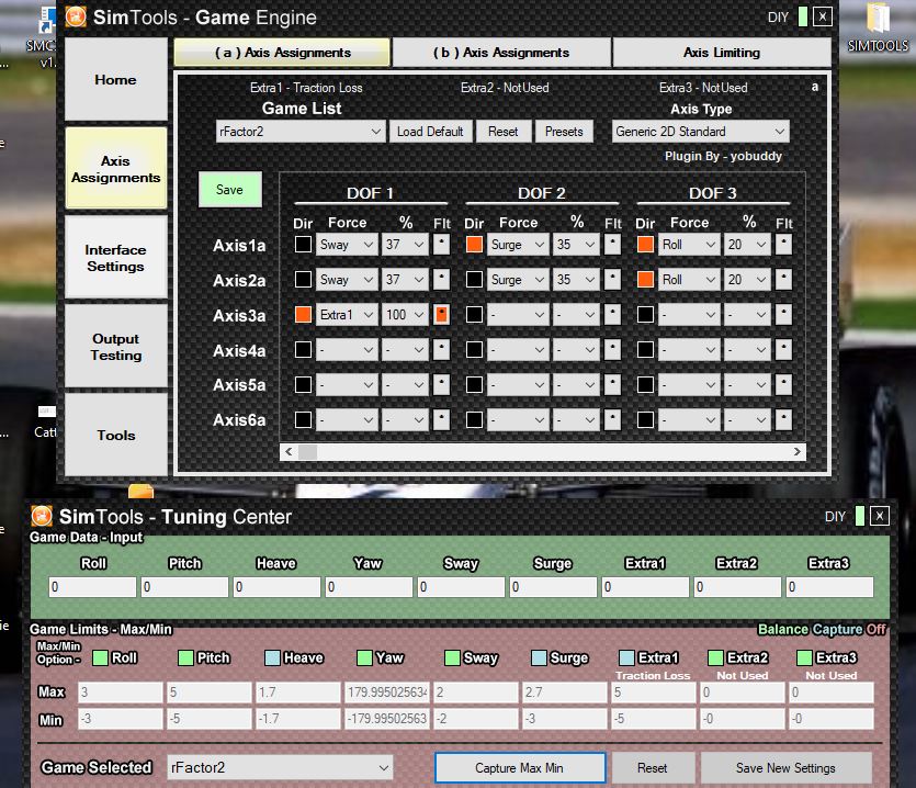

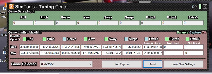

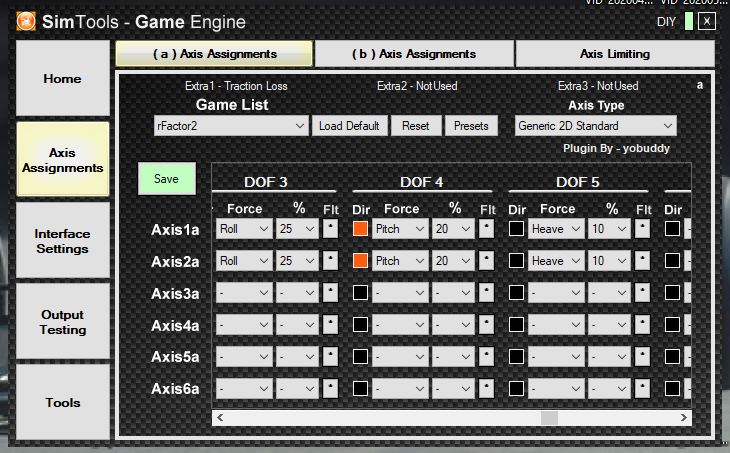

    I made some tests and in the attachment you can find the setup parameters about axis assignment and tuning center before customizations and after.
    as long as I have not intervened on tuning center parameters the playseat reacted little, now I've some difficuties to setup the forces' breadth and the frequency , because there are many diferences between set only a force, for example sway, and set sway and roll at the same time.
    I'm trying to record a video in the next days.
    22,225
    154,819Coins
    +11,226 / 57 / -2
    I am not certain but it sounds like you are trying to adjust all the axis at once in the Tuning Center. Initially you should do each individual axis one at a time, having first captured the Max/Min values as a baseline, then tweak from there, see the tips here: https://www.xsimulator.net/community/faq/steps-to-create-a-motion-profile.228/

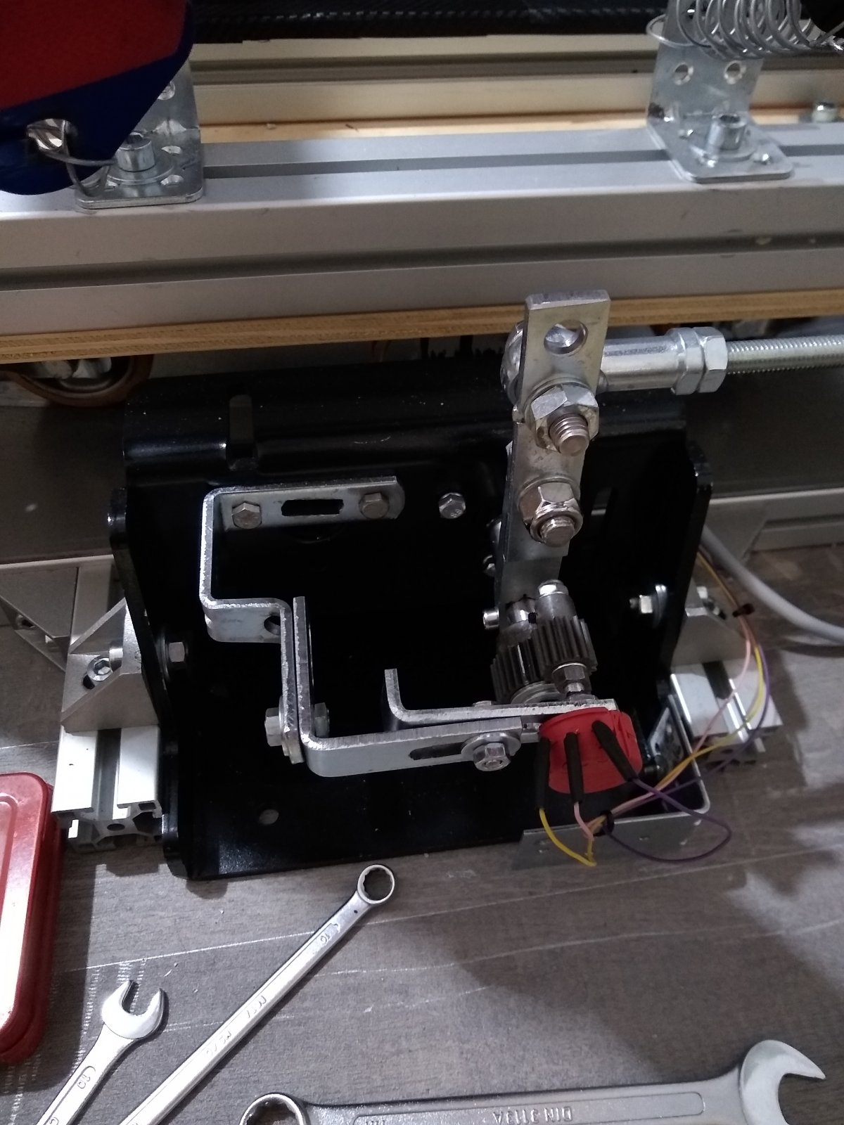

    Honestly, noon excites me even the traction loss effect, I'm afraid it's the fault of the type of engine, van's wiper motor.
    Any suggestions?
    Regards
    22,225
    154,819Coins
    +11,226 / 57 / -2
    If your motors are not adequate to drive the rig at a desired level of performance, for a given design, there is only so much that can be achieved via tuning.
    Personally I don't consider wiper motors very well suited to a compact style rig, which requires lots of torque, I use 200w motors and 60:1 wormdrive gearboxes on my compact rig.
    If more performance is what you crave perhaps it is time to consider a motor upgrade.
