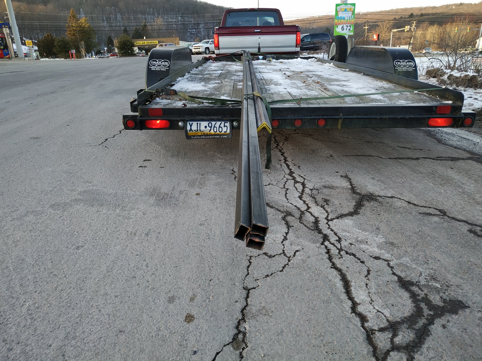

    So my heart nearly leaped from my chest when I saw the price quote this morning for the steel stock I need. I was just about to sit down and do a redesign to use as little steel as possible.
    Fortunately I looked at the quote again and saw that... well that I'm an idiot. I told him three of each, so each line on the quote was for three, not one! $200, not $600. =)
    Now I just have to try to get my trailer pulled up and out from it's hole, with a 2 wheel drive pickup and snow on the ground.

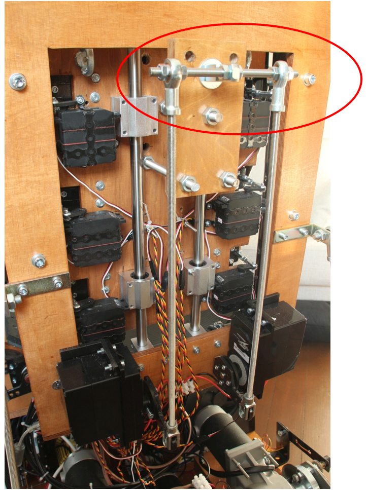

    I also once had two motors run in parallel. In my case these motors were lifting the backrest of my seat in order to increase the sensation for 'heave'. I had the same concern as you, and therefore I mounted the rods in a way that they were able to move independently from each other, at least in a range of some centimeters. Here is a picture, in which I have highlighted the relevant area with a red circle.
    More details can be found in my build thread.
    Edit: I guess that even small deviations in the synchronous motor movements will cause the motors to work against each other, which in turn will cause high currents, heat, and reduced overall torque.

    Thanks @MarkusB . Unfortunately I don't think that approach will work for my design but it was a clever solution! It would work if I put the lift actuators all the way at the back but I'm nervous about counting that heavily on the vertical slide rails for lifting a very, very heavy and large load from one edge.

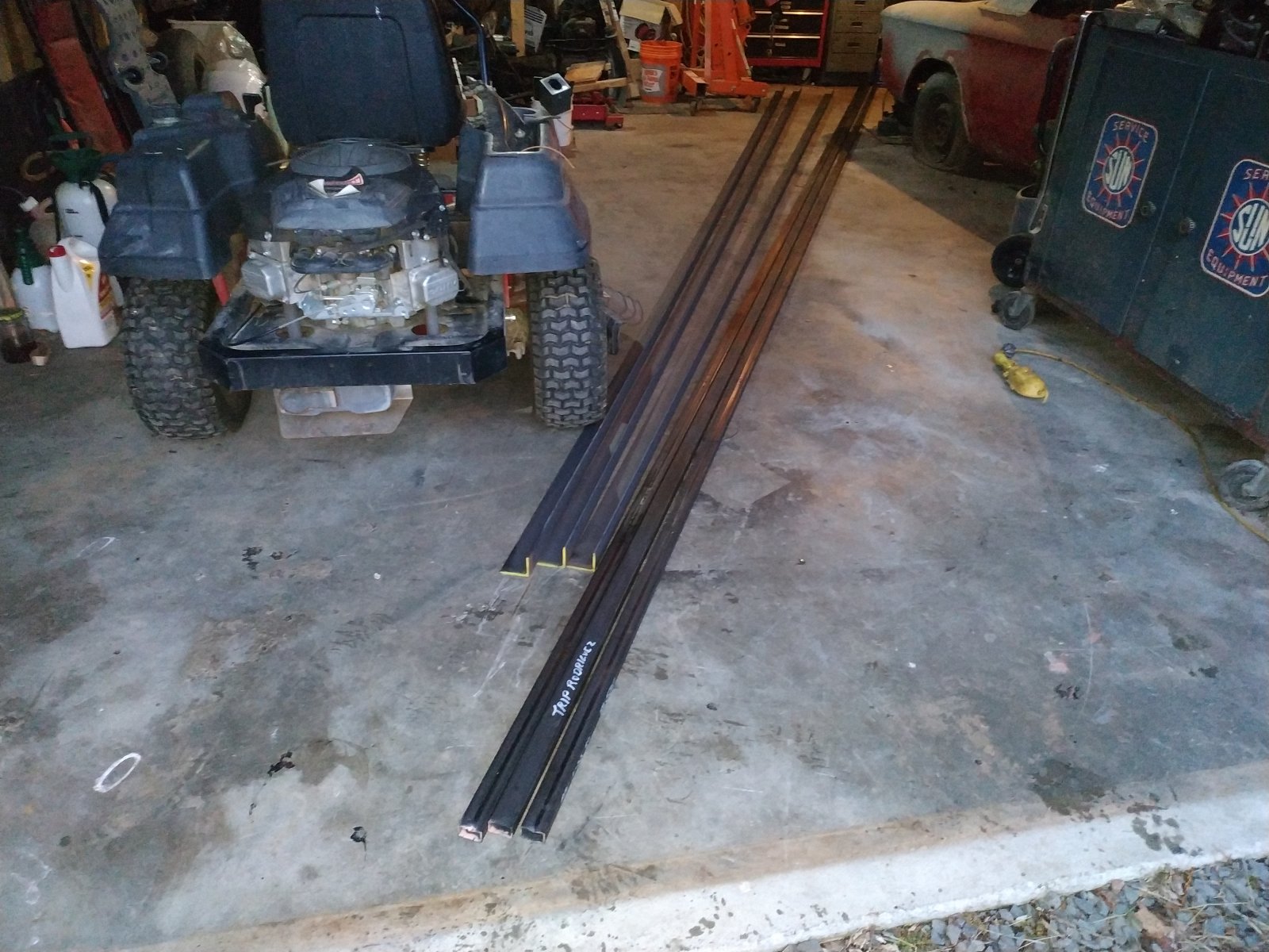

    Now it really begins! I got the trailer out no problem and picked up my steel yesterday.
    I wish everything was in one place for a photo before I begin, but I don't think it's worth taking the time to move everything around twice just to take a picture. I expect to make the first cuts and welds Friday if all goes well!
    72 linear feet of 2" x 2.5" x 3/16" angle
    60 linear feet of 1" x 1.5" x 14 gauge rectangle tube

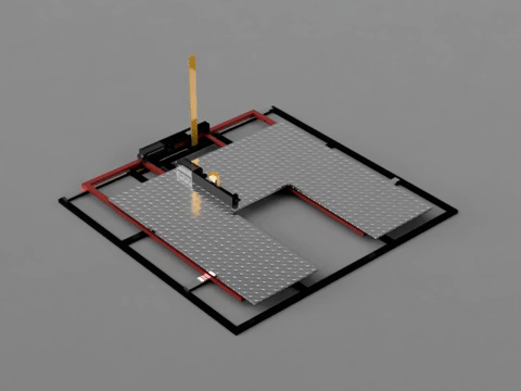

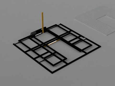

    Alright so I didn't quite get to making the first cuts, but I'm now ready to set up the saw and get started. Hopefully Wednesday, tomorrow I probably won't have time.
    I spent my time tonight making a final drawing of the first two frames to make sure I was satisfied with the dimensions and how things fit together. I wound up making quite a lot of tweaks to the design to simplify the build and mechanicals.
    The yellow vertical you see sticking up is welded to the bottom most frame. This is what the sway actuator nut will be attached to. It will have braces to stiffen it up. The reason it sticks up so high is that same yellow post will be the actuator for the G-Seat back sway DOF.
    I almost certain I can shorten the length of the platform at least six inches due to the final sway actuator layout, so I'll be taking a look at that before I start cutting.
    This is just the platform for the elevator, and the sway table. There will be some superstructure added to the elevator platform (the lower frame here) at the points where the guide towers and actuators will be attached. Atop this will be a set of slides for surge with the cockpit floor on them directly so the total height/thickness of the floor will be 3.75 inches. The leg area will be sunken in, so it will be about 3 inches lower than that. Every inch I save in height is one more inch of my heave travel I can use without my Huey overhead panel hitting the ceiling!

    Surge table drawn.
    Render of final sway/surge table design. Changed the upper frame to red to more easily see the separate parts. It's approximately 6 feet (183 cm) square at the outside edge. Bigger than I hoped but I wanted to leave plenty of legroom and make sure that all future cockpits would fit on it.
