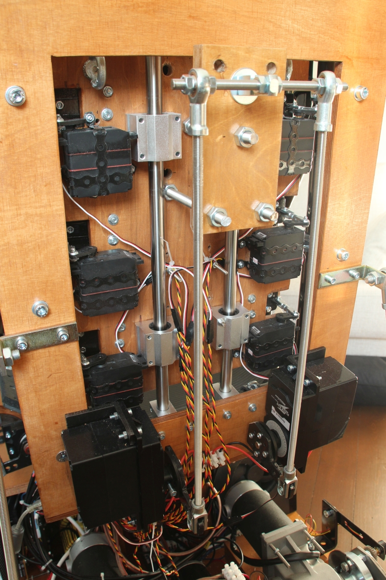

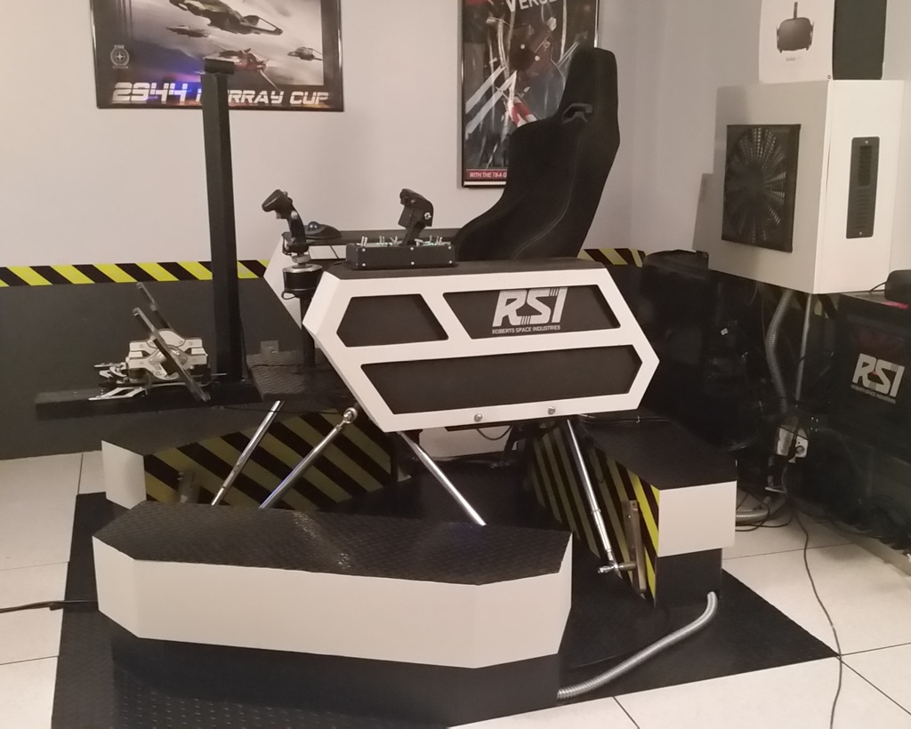

    Note: This image is/was my first motion sim build, this thread is about replacing it with something much better for flight!
    Shortly after I completed my first motion simulator build I learned about G-seats and immediately knew it was something I wanted to add to my setup. In order to build my 6DOF motion sim I looked around online until I found a particular set of components a couple other people had used and reported great success. This is the sim I found online and borrowed the parts list from:
    I bought all the same critical parts so I could be confident the sim would work. All of the dimensions and aesthetics were my own designs, but the selection of motors, gearboxes, and electronics were tried and true. The first image in this post is my simulator after completion, the second image is the design I mostly copied:

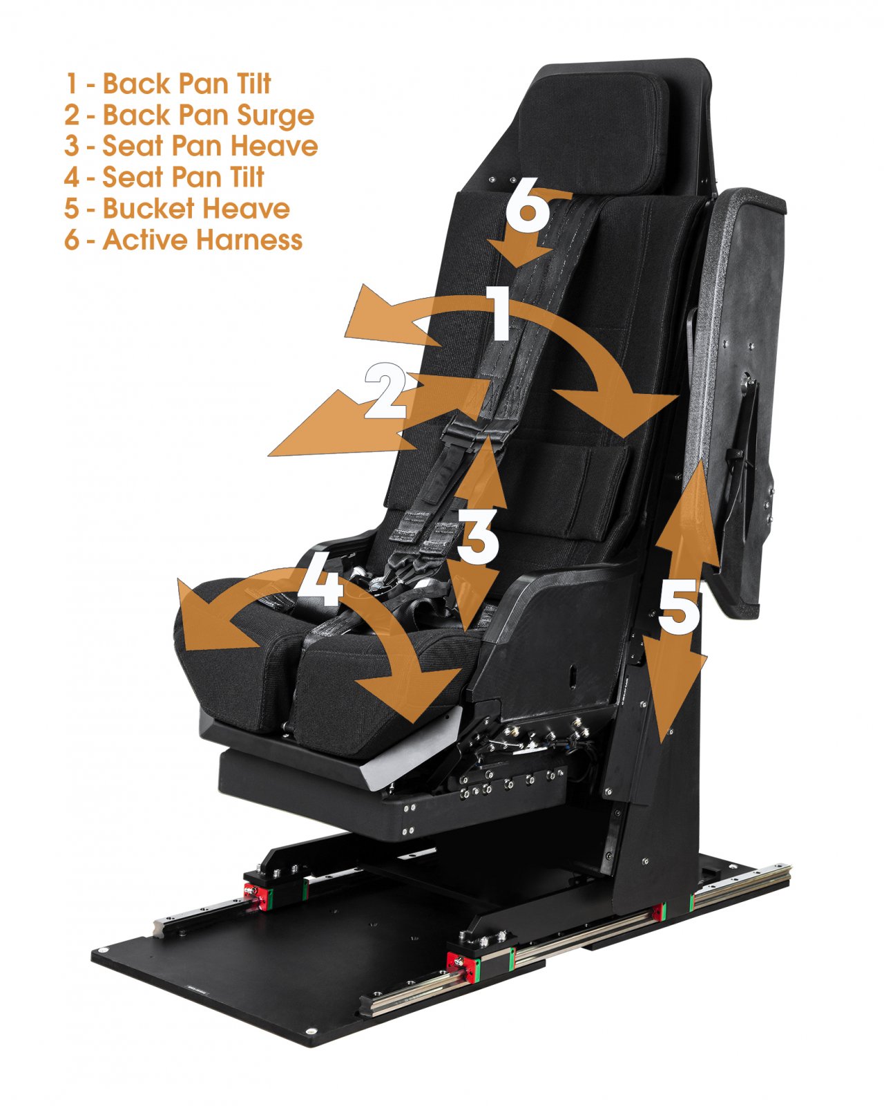

    The most interesting thing I found was the True Q DMS "Dynamic Motion Seat" system by ACME https://www.acme-worldwide.com/trueq-dynamic-motion-seat-g-suit-systems/
    They have numerous graphics and videos depicting the operation of their seats which are of particular interest to me because these seats are designed specifically for aviation. Even better for me they have models specifically for helicopter simulation which is my highest priority (followed by Aerobatics, Navy jet fighters, warbirds, and finally racing sims). These ACME G-seats have at least one novel design characteristic I've not seen anywhere else. The seat bottom cushion tilts left and right. Take a look at the video here.
    These seats also share some features with SeatTime's most recent experiments. The seat bottom and seat top being independent and able to operate either in the same or in opposite directions depending on the cue required. In particular, having the bottom move up while the back moves down and vise versa seems very useful.
    They've even got a specific model for the Huey, which is the helicopter for which I'm building a full cockpit! The one they built this seat for is a fully modernized Huey that is a HUGE performance upgrade from the Vietnam era DCS and XP11 versions of the UH-1 I fly, but the seat design is still very similar with the exception of the headrest that was added.
    I've spent hours looking at their videos trying to see how they are using the various axes to create each cue, but have had limited success. I have learned that while some of their cues adhere to the the concept of not moving the pilot in the opposite direction he should, others violate it. My current plan is to hybridize this general design concept with SeatTime's three-panel heave and surge mechanism concepts hopefully along with some of my own innovations.

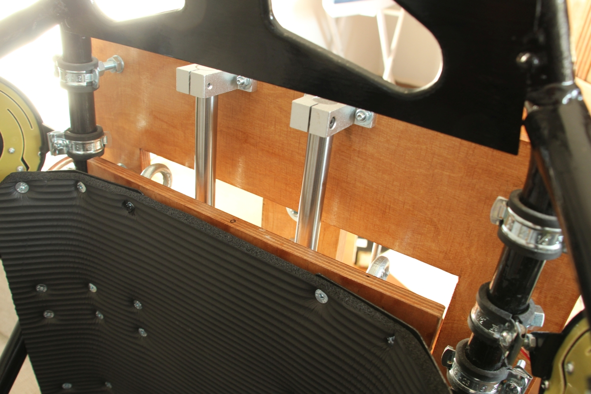

    your added the question above into @SeatTime 's thread, but I prefer to answer to your thread because it actually is related to your own thoughts.
    I implemented such an up/down-movable seat back in my previous rig:
    See also the initial post of my build thread for some more details.
    I still like this idea, but the effect was rather weak and hardly noticeable. I will re-implement it in my new rig, but this time I plan to combine a 'down' movement of the seat back with an 'up' movement of the seat base and vice versa.
    I will try to do this without separate motors for the seat back, just by connecting the seat back via a bowden cable to the moving seat base. In this way the seat back shall remain on a globally(!) fixed position and just move relative to the seat base.

    Thanks for the reply Markus. Sounds like you and I have very similar plans.
    I'm going to try a very similar approach. For heave my bottom cushion will operate the same as SeatTime's design, but simultaneously the seat back will move the opposite way to hopefully add a bit of additional pressure or lift while helping prevent the pilot from moving the wrong direction spatially.
    I would definitely prefer this be separate motor with independent axis control, but for cost saving I think (initially at least) the bottom cushion heave and seat back heave will be driven by the same motor via bowden cables.
    For surge I'm also thinking about tilting the whole seat forward or back a little to help keep the pilot moving the correct direction but I'm not sure if I will try that yet.
    I also I don't know yet if I'm going to try the bottom cushion tilt I showed above, have to think on that a bit more yet.

    Ok I think I've more or less finalized the plan.
    I'm going to build the G-seat with just three of the motors, and with the other three I'm building the heave elevator for the entire sim. It should have 24-36 inches of heave travel (600-900 mm).
    The G-seat will by a hybrid design based on Bergison's, SeatTimes, and the Acme military models.
    From Bergison I take the concept of having the entire G-seat tilt in the pitch and roll axes in addition to the pressure paddles.
    From SeatTime I take the seat back sway concept and the three-panel design of the G-seat paddles that go down/back in the center while the sides apply pressure the opposite way. Also most of the linkage concepts for powering these things and the Bowden wires idea.
    From Acme I'm taking the seat back heave and my favorite element which is the tilting bottom cushion.
    Designing a mechanism that would allow me to have the bottom cushion independently tilt and also still have the three panel heave design, be compact, and not interfere with one another was my biggest challenge so far.
