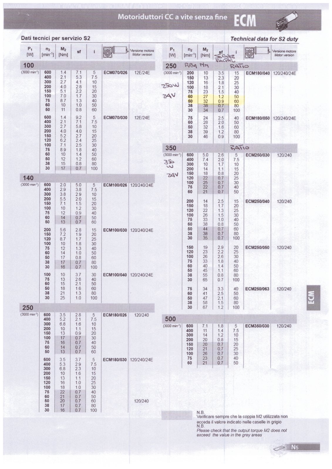

    Hallo!
    I'm evaluating the realization of a new project inspired by this
    and the excellent work as realized by MWB https://www.xsimulator.net/community/threads/mwb-4-dof-simulator.8968/
    As you can see 4 engines are needed. The structure will be in aluminum.Approximately the four engines will have to move a weight of 140Kg (pilot, peripheral structure).
    I'm geared towards these geared motors, which I hear very well in Italy. In particular ECM180 / 040 24V 250W.
    I was thinking of the model with gear ratio 60: 1, speed of 50rpm at the gearbox and 32Nm. In your opinion, are they too slow? Better gearbox with 50: 1 ratio, gear speed 60rpm and 27Nm?
    To have so much speed and a lot of torque together there would also be the ecm250 / 040 24V 350W with a ratio of 40: 1, speed 75rpm and 33Nm but cost much more.
    What do you suggest?
    Thanks for your support
