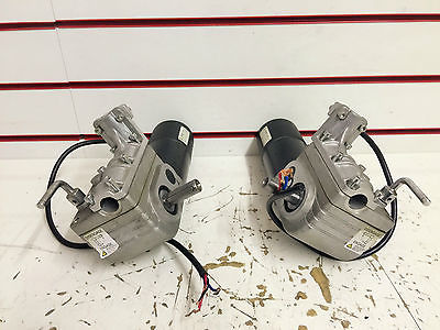

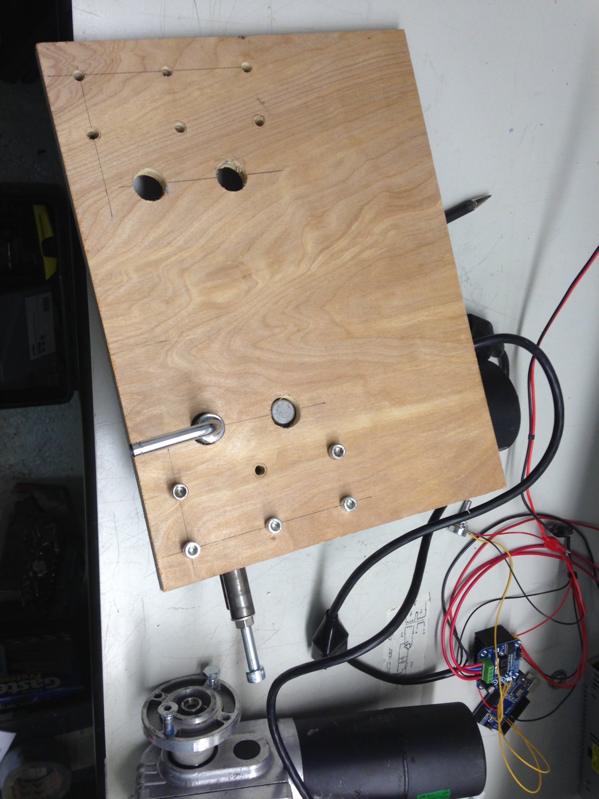

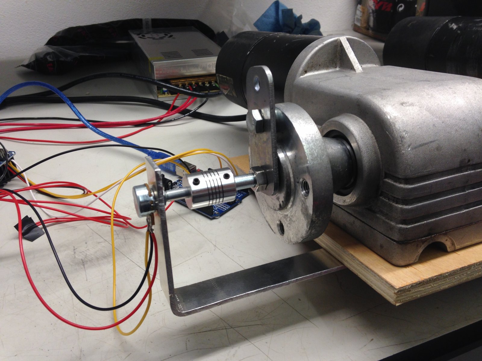

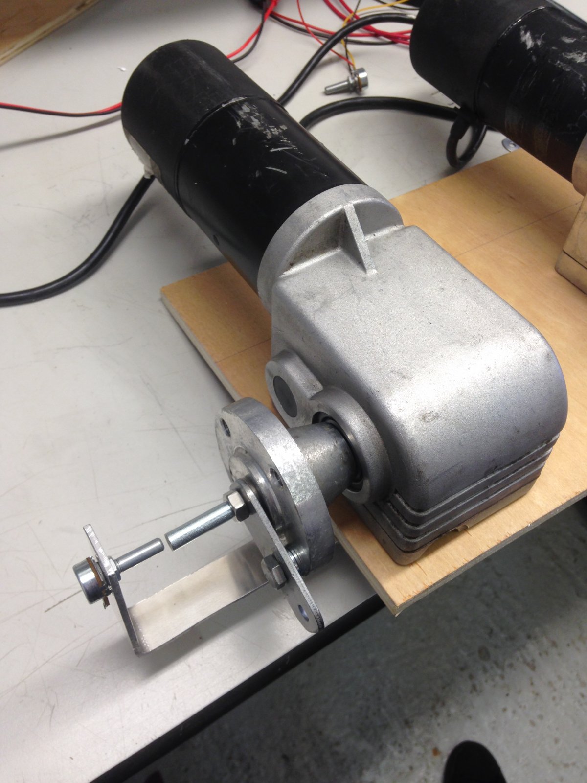

    What realy got things kicked off was finding a pair of Invacare wheelchair motors on eBay, I had been hunting around for windscreen wiper motors for quite some time, but was not convinced that they would be up for the job.
    I have seen some fantastic builds using them but I always planned to go 6DOF at some point and wanted to be able to upgrade. The motors are not perfect for the job but for £50 I'm happy to try and make them work, biggest problem is that there's only one output shaft From the gear box, so it 's going to be a bit tricky fitting the potentiometer to the same shaft as the arm, without the risk of the arm hitting the pot. The motors are 24V 110rpm and I think about 150W all the gears in the gear box are metal and they seem very robust. IMG_3920.JPG

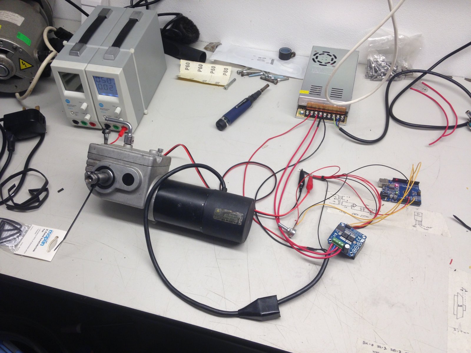

    Mock up of one of the motors connected to an IBT-2 H-Bridge/UNO R3 Arduino IMG_3279.JPG

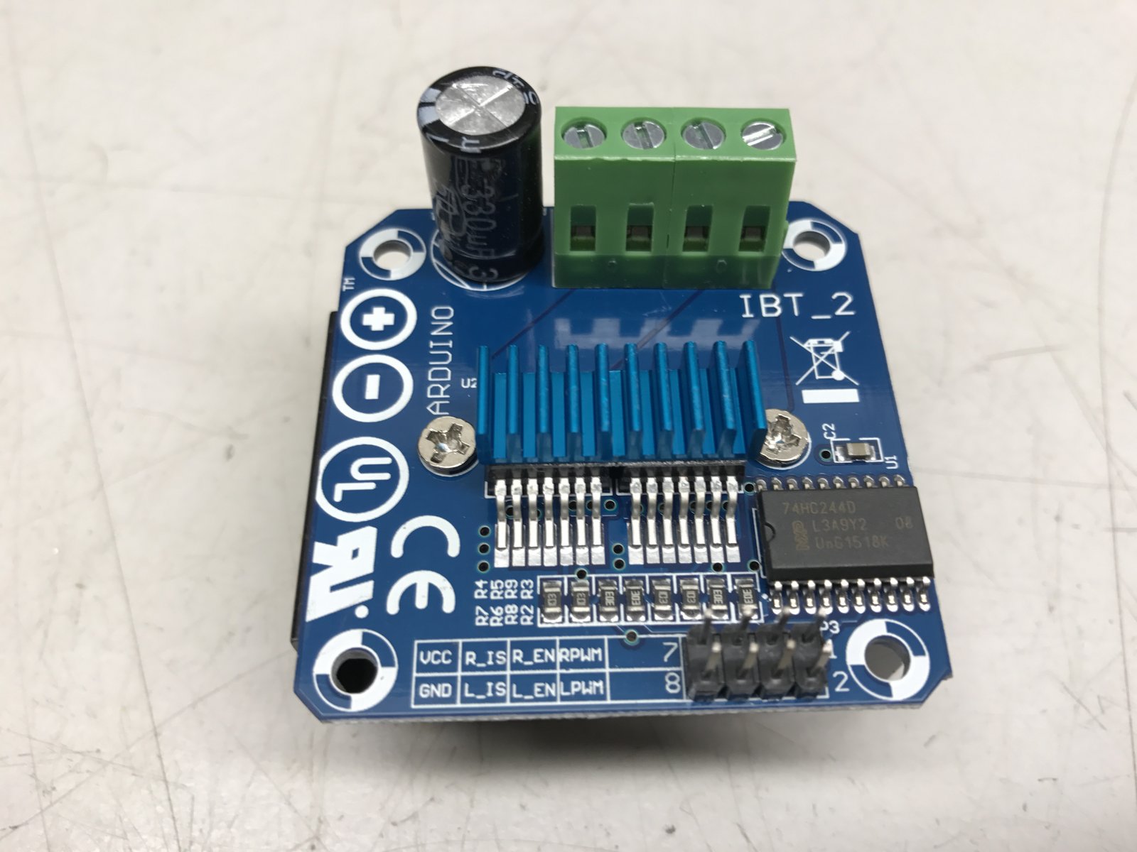

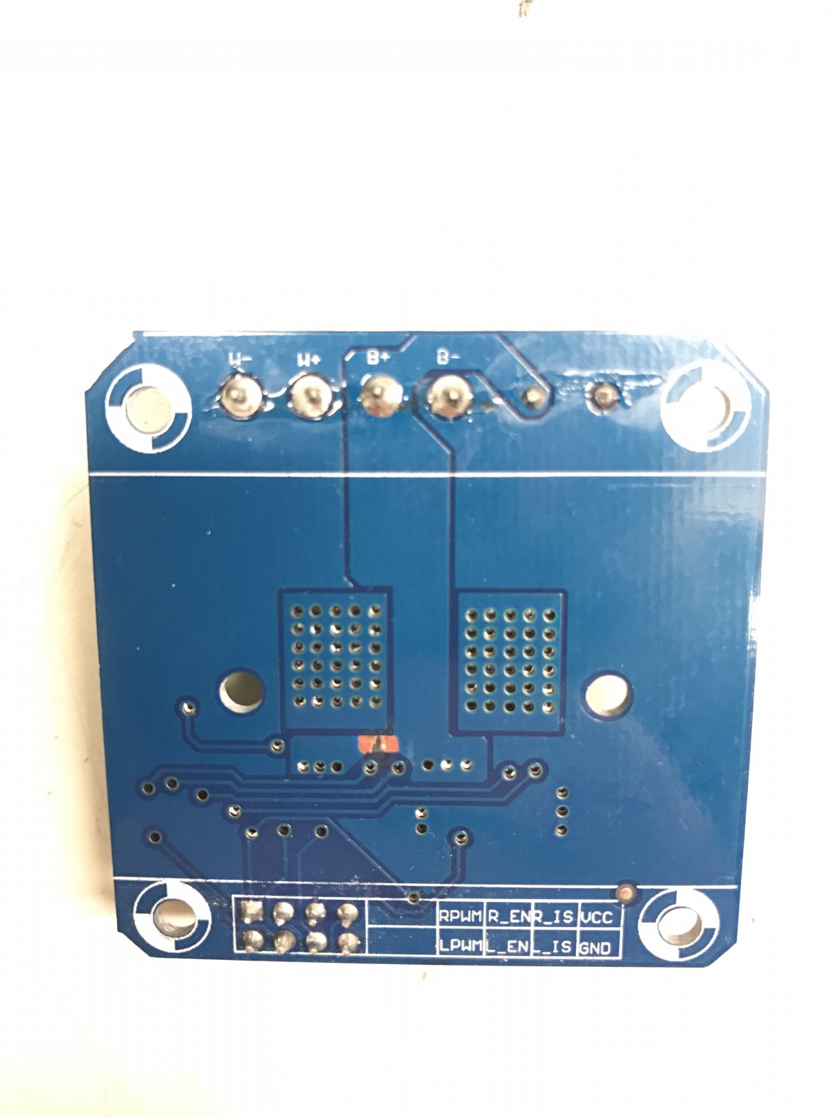

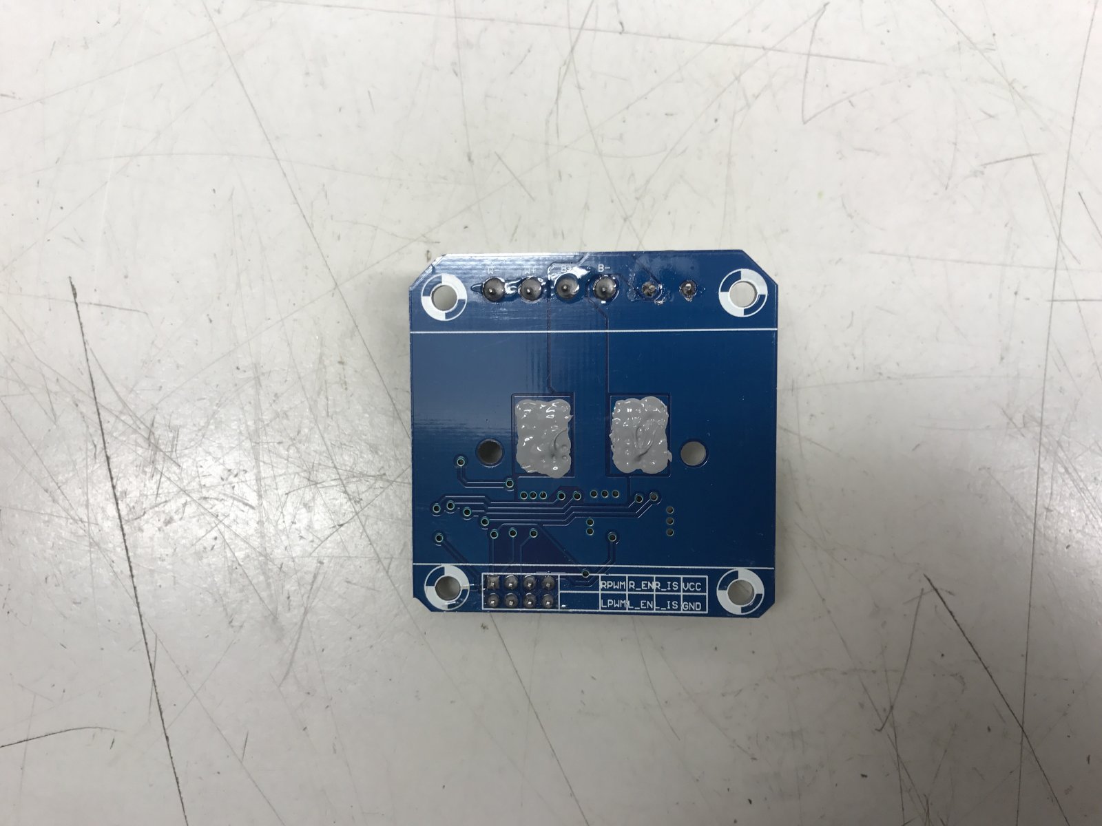

    Last night I managed to pop one of my IBT-2! On closer inspection it seems that one of the tracks underneath the heat sink had burnt out has anyone seen this before? IMG_3922.JPG
    I have my suspicions that I may have put to much voltage into it, after looking it up max input voltage is 27v and I put 28v in

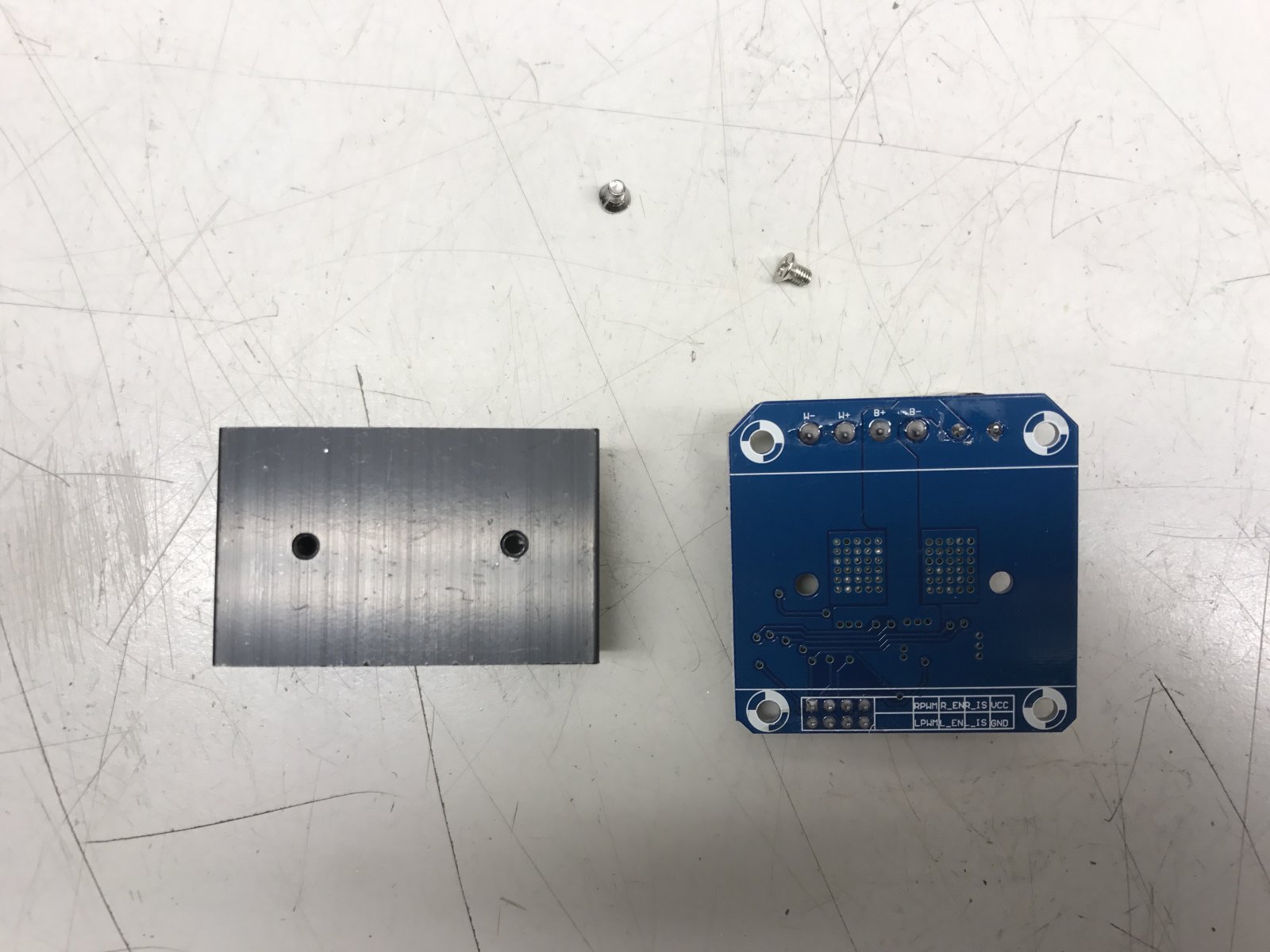

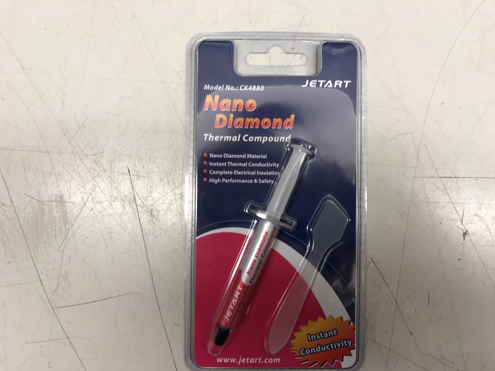

    Anyway moving forward, I have a spare!! so another thing I noticed was that there was no thermal compound between the board and heat sink. I have a fan on the heat sink but I noticed when it was working that the power chips were running pretty hot. So off to Maplin I go!!

    Back from Maplin with some goodies!!
    Got some thermal compound
    Also saw some small stick on heat sinks, every little helps!!
    Thought they would be good to stick on the front of the power chips.

    Yeah I've read first thing you do with those chips is unscrew the heatsink and thermal paste them up :thumbs

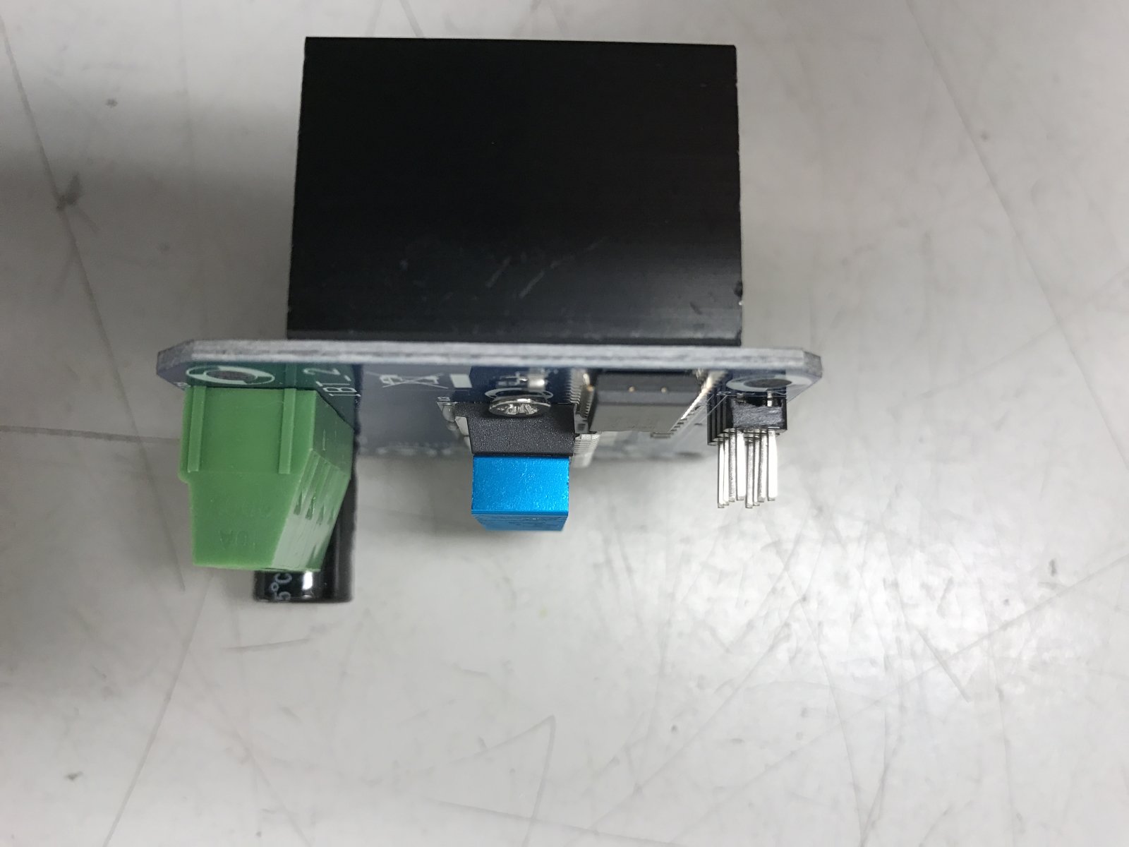

    Upgrade to the IBT-2 all done!
    IMG_3925.JPG IMG_3929.JPG IMG_3930.JPG IMG_3931.JPG hopefully this will make them a bit more robust

    Pics of the test rig I built for two motors, so that I can connect to Simtools with out having the motor roll around the bench.

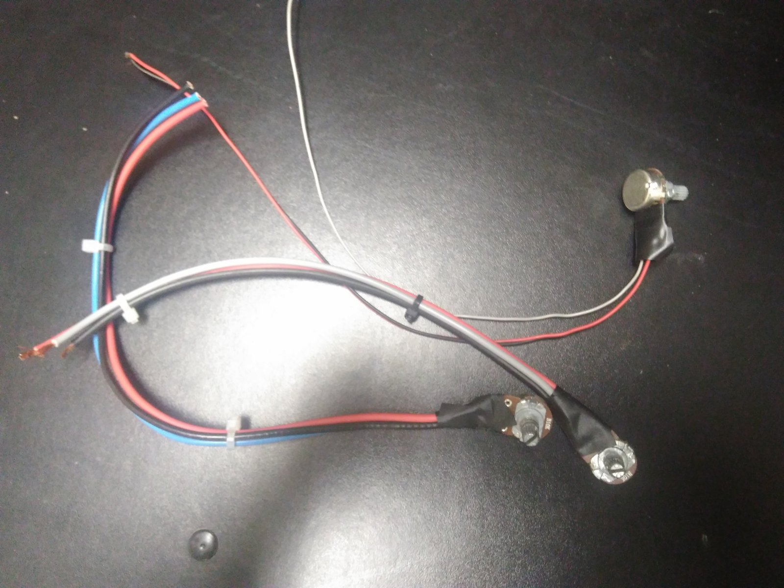

    @MWB May I suggest you going straight to the Hall Effect Pots? You know, it's just a matter of time till you're buying them, cause the other pots will die sooner than later and before dying they won't work well and you'll regret you hadn't bought hall effects pots before (happened to me and to a lot of others too...) ;)

    @MWB I agree 110% with @Blame73 cheap pots are great for a base test but before you finish the rig get them ordered and fitted ;)
