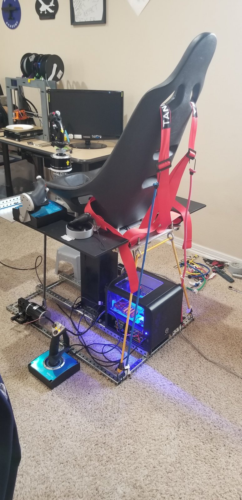

    I have the same problem with my setup. I fixed it by using bungee cords to keep pressure on the levers at all times in order to keep them on one side of the backlash.

    You can see the bungee cords in the following picture. They simply pull the back end of the seat down which in turn keeps pressure on the levers and keeps them on one end of the backlash.

    Backlash is experienced when the motor changes direction, so I'm not understanding how this would help that. Could you explain?

    3DOF, SimforceGT
