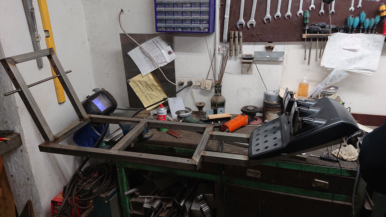

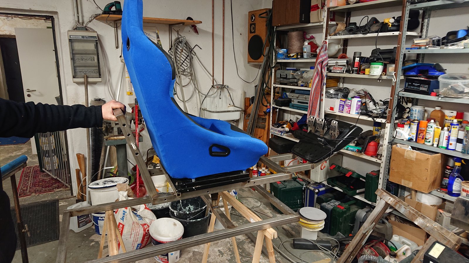

    Yesterday we could test our new approach: I removed the wooden structure and we build a compact frame out of steel (my friend helped me as he is experienced in welding). I bought a new lightweight seat (~ 7 kg) as well.
    It is much more stable and ~ 13 kg lighter as before.
    See pictures and videos here (with LFS running on a laptop). Later I want to use it with my PS4 and PC2 :)
    I have to smoothen the movement, as especially when shifting the movement is to heavy and to sharp.
    So next days I have to investigate in Tuningcenter and "Trial and Error".
    I also ordered some rubber feet for mounting below the construction for a stable position.

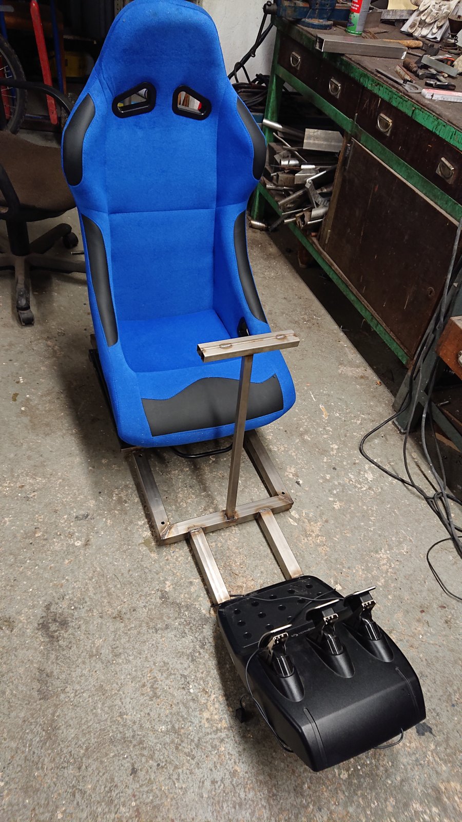

    So here is the result after hard work :) But it was fun !
    Some fine tuning needs to be done, but it's working good with the PS4.

    Looks very good!
    What is the dimension of the steel tubes in your frame? 30x30x2mm?
  5. Arazok
    Arazok Member
    Mar 26, 2018
    183
    Computer scientist
    791Coins
    +32 / 0 / -0
    35x35x2 mm
