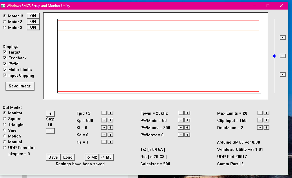

    OK, wiring is done and checked with smc 3, all if fine as for the harware stuff...again, but i am off to a very rough start with smc 3 values, i have a lot of jerking and oscillating which i managed to reduce a little bit by lowering PWMrev to 0 (previously at 210) but as soon as i try to put weight, it starts to oscillate again, badly enough that i noticed some loose screws lol. I did some reading bout the smc3 soft but i am a bit confuse for what more i could do...need help with that please. Here are the typ. values for all, they all are shaking the same way so i dont think it is a hardware issue.
    also, when i went to see how to set-up simtool for this particular set-up with 3 sabertooth on 6 motors, i am a bit mixed-up about how to set interface, i saw that we need to put it like that: Example [A<Axis1a>]
    question is; do i add to that [B<Axis2b>]
    so it looks loke that;[A<Axis1a>][B<Axis2b>] under tab ''Interface 1''
    and then for the second sabertooth, i write something like this:
    [C<Axis1c>][D<Axis2d>]
    under the tab ''Interface 2'' and so on for third saber.
    tks so much for help

    Hi, @noorbeast, is there a reason why i am not getting any feedback? have i done something wrong? does my post show-up?...just saying that because usually some people jump in to help fast?? just surprised, not complaining here :)
    tks
    22,185
    154,750Coins
    +11,196 / 57 / -2
    Members check threads and respond when they can.
    SMC3 must be fully tuned and responding as expected before messing with SimTools.
    I a presuming you are using @BlazinH's modified SMC3 code: https://www.xsimulator.net/communit...ket-serial-pid-motor-driver-w-softstart.9277/
    You should follow the guide for using the SMC3 utility: https://www.xsimulator.net/communit...driver-and-windows-utilities.4957/#post-48121
    I don't use SMC3 or Sabertooths, so others are better placed to give SMC3 tuning advice.
