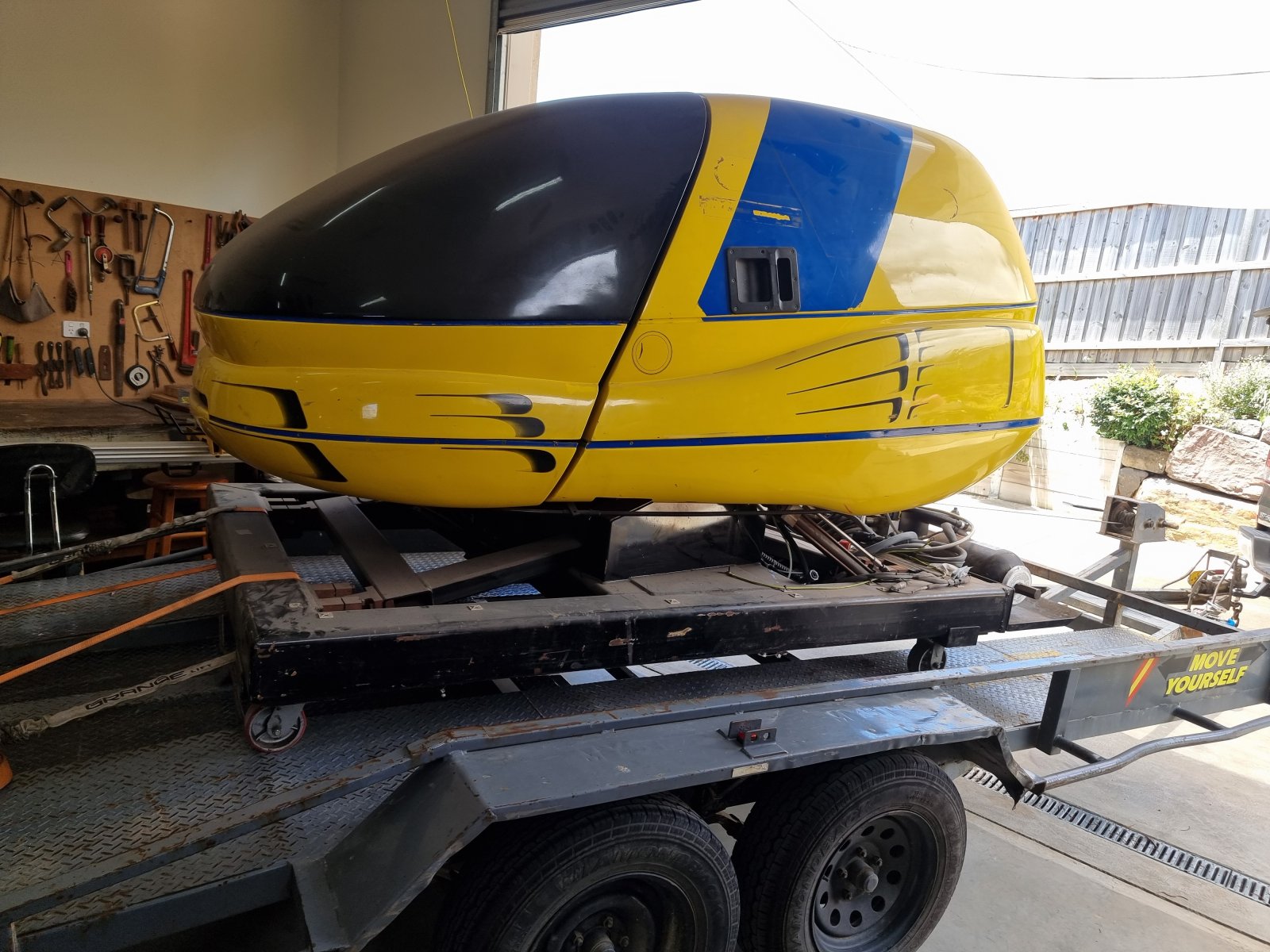

    G'day all , I've just got my hands on a commercial hydraulic motion simulator . Back in the early 2000's these things were in shopping centres and I'm looking at upgrading it with new software as a personal sim. Its running hydraulics and was hoping i may get some help .
    Thanx in advance.
    21,581
    151,100Coins
    Most of these old arcade style motion rigs run as locked down proprietary systems.
    The first thing to do is photograph all hardware, particularly stickers with model numbers or similar identifying features.
    But don't get your hopes up, often it is easier to rip out the hardware and replace it with modern stuff that can be controlled.

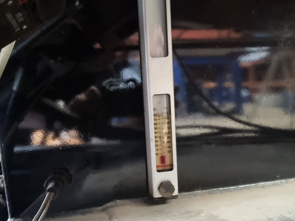

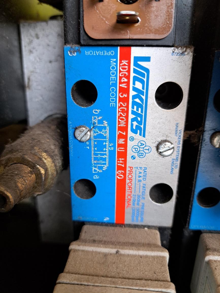

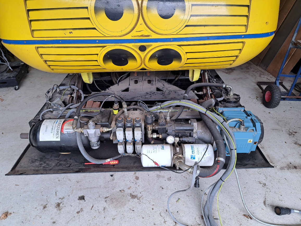

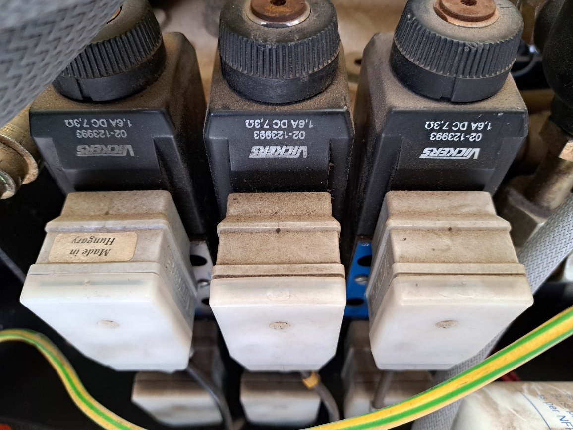

    heres some pics of the data plates on the valves and the motor.
  16. Aerosmith
    Aerosmith Active Member
    May 30, 2024
    418
    self employed
    2,451Coins
    +249 / 0 / -0
    3DOF, AC motor

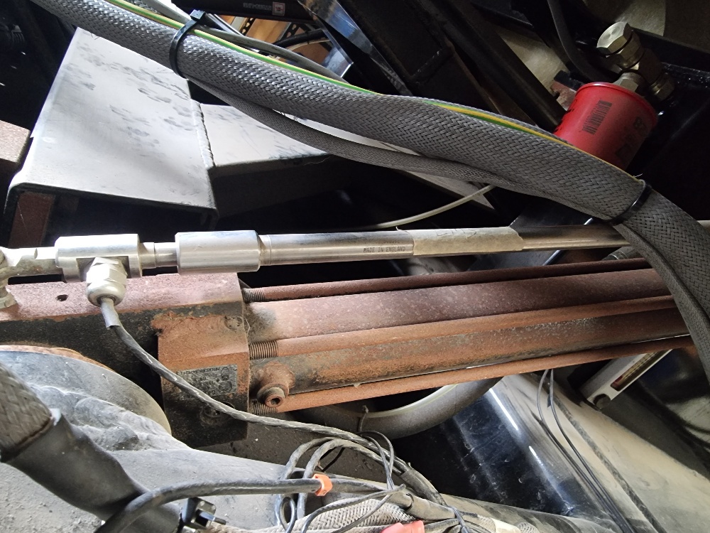

    Ok, I can see an oil tank, the hydraulic pump, a pressure accumulator and three proportional valves. I'd check the oil and the filters first and then disconnect all the electronics. Then power the pump and see if you get some pressure. Connect a lab power supply to the solenoids one by one. If you raise the voltage from 0 to 24V you should see the cylinders moving. If the hydraulics work you can try to get the electronics running.
    I've found some info about the valves. Theese are spring centered open loop (no feedback) types. This means you don't get any information about the actual position of the plunger. It is roughly proportional to the voltage apllied but don't expect much bandwidth. You can only apply slow voltage changes otherwise the valve will overshot and cause oscillations.
    Can you see some sort of position sensor at the cylinders? There should be a glass scale or string-pulley-encoder unit for each cylinder to provide position feedback to the software.

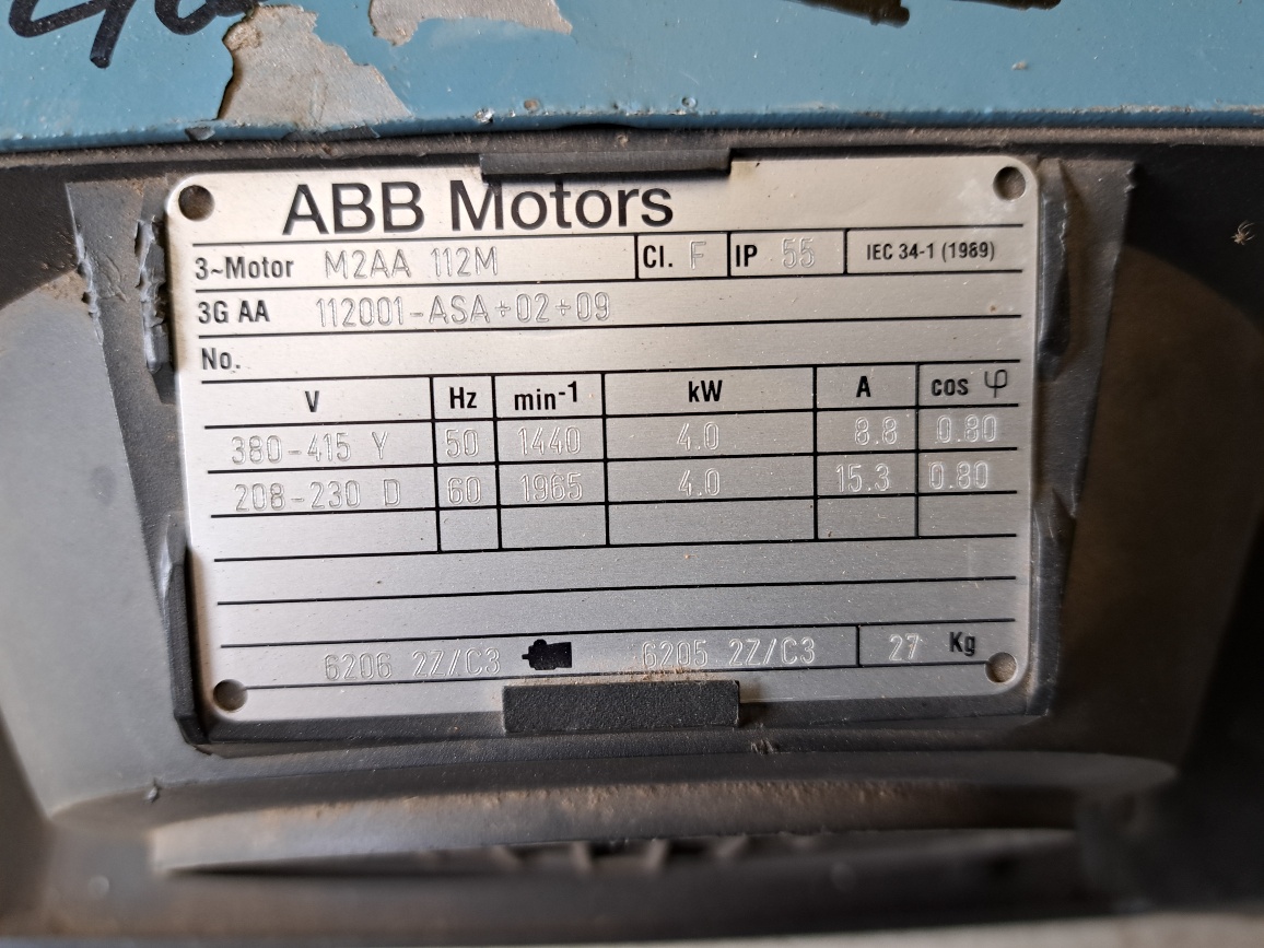

    All mechanical systems are working according to the previous owner. There are no oil leaks from the wiper seals or connections. Mechanicly its in great condition. Its got linear encoders on each cylinder. I cant power it up at the moment as i dont have 3 Phase power . This will be sorted as of tomorrow , I'm picking up a phase converter i got cheap.

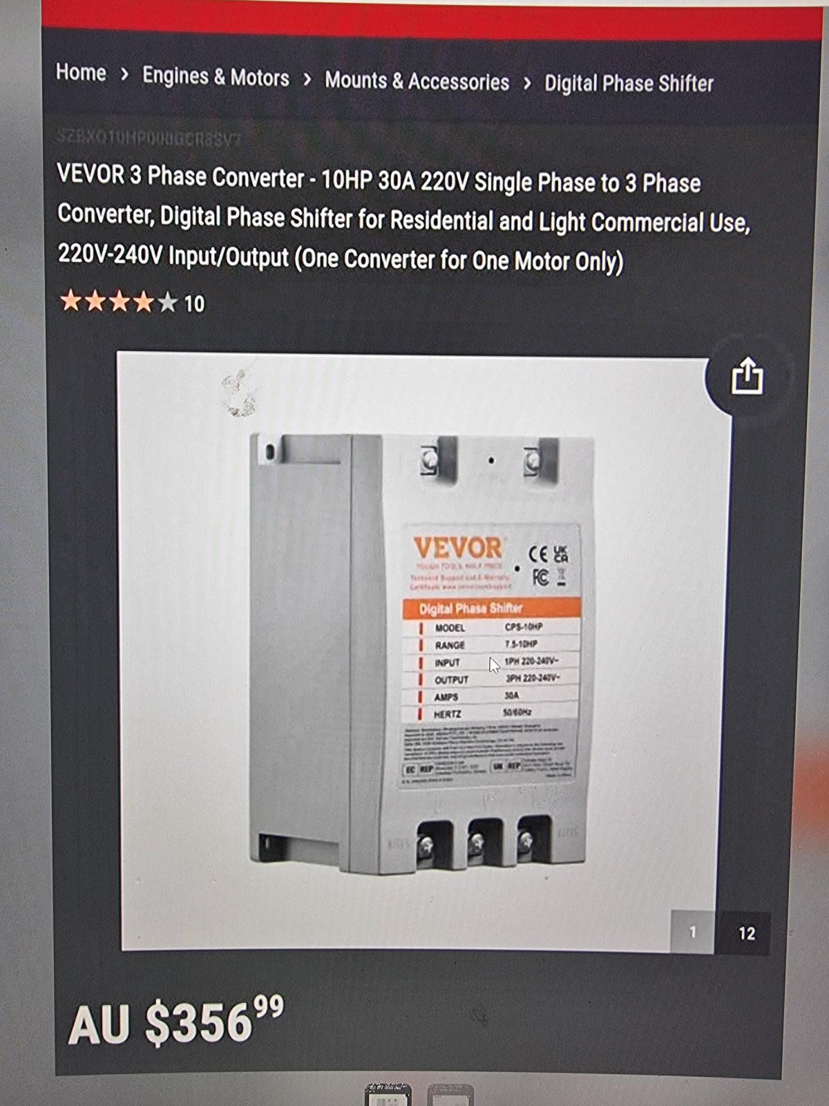

    Yes there are linear encoders on each Cylinder. I've been reading the manuals and found that the API is LABPAC for Dos created by Laboritory Solutions back in 1994 for there Labtender IO card which is what we have. Very basic software according to my mate and he sounds confident that he can write code for it.
    He currently has the laser disc pulled apart for cleaning as its not working well and been sitting for some 20 years. Still waiting on some parts for the 3 phase conversion. The hydraulic pump runs on 3 Phase 415V power in Delta , but we have opted to change it over to 3Phase 240V Star as i could only get a phase converter from 240 v Single to 240v 3 phase. Amps are a bit higher although the power cable to the shed is able to cope.
