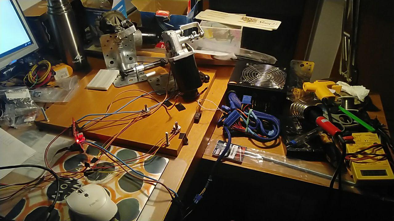

    Hey there!
    Carlos here.

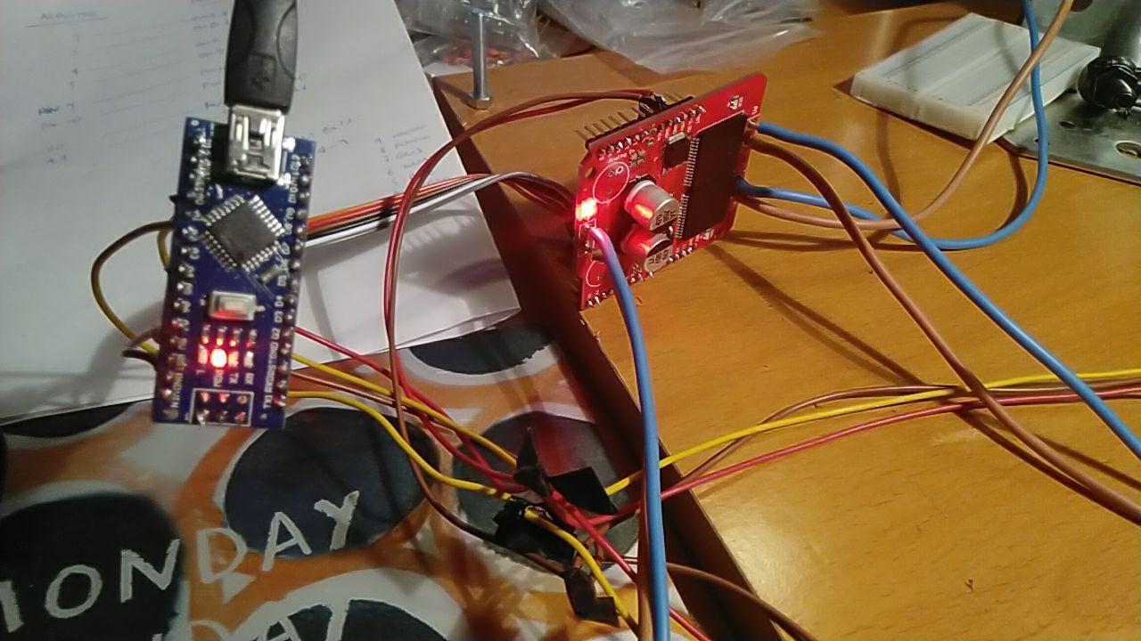

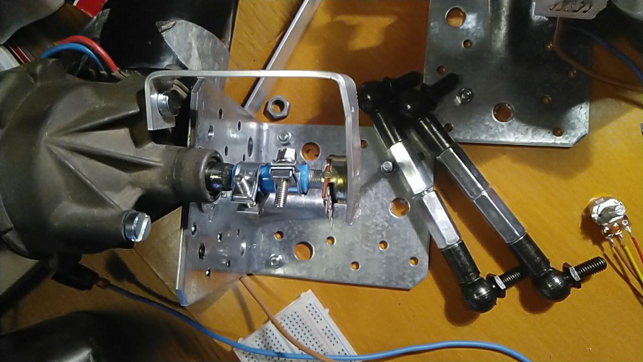

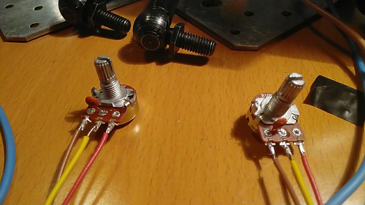

    It`s been like a month, when I started my project and am a bit stuck. I`ve got all the parts and just need to put it together. The electronics are already connected and are working pretty good with the SMC3utils, but nothing happens when trying to move the motors with Simtools. Looks like there is not output.
    The only thing I can't understand is why there isn`t PluginApi.dll in my Simtools folder so can't set it up.
    If anyone could give me a hand I'd appreciate it.
    Thanks!
    Here you have some pics of the Project.

    You must set up default axis assignments and a correct output interface before you can use Simtools output. Also close smc3 utilites when using Simtools.
