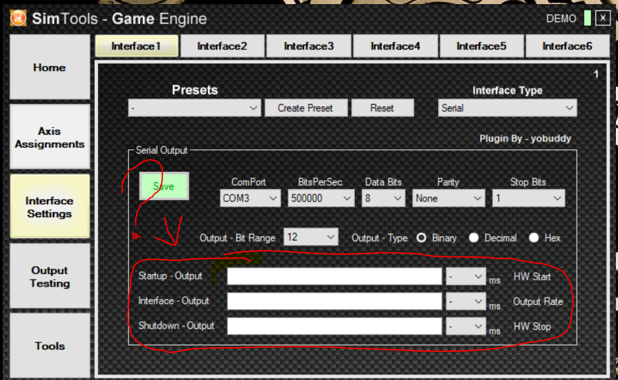

    Hi there!
    I am trying to get an output from simtools but it does not seem to work. I think it has something to do with the Interface - Output in the Interface Settings tab. I have gotten motion out from the SMC3Utils program, i can move the motors just fine from there, but not from the simtools software.
    I have already tried a couple of different codes that i found on the forum.
    The rig is a 2Dof and I'm using one Dual VNH5019 motor driver board with two motors and one arduino.
    21,592
    151,215Coins
    Setup for Simtools 2 is very straight forward, so change to 10bit binary and add Interface Output depending on how many axis you have:
    [A<Axis1a>][B<Axis2a>][C<Axis3a>]
    Set for 10bit binary output

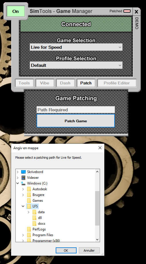

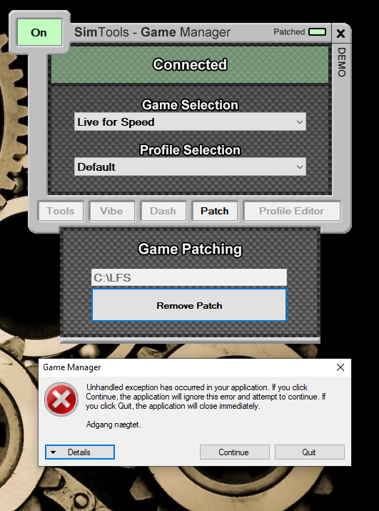

    Hi again.
    I have gotten the motor to move and i am now trying to get data out of LFS. I am quite confused about the game manager because is says in the top right corner "patched", but in the game patching tab is says "patch required". When i then click on the LFS installation directory it comes up with this error message (Pictures below).
    Thanks.
    21,592
    151,215Coins
    Please expand the error message and copy and past the error message here.
    Be aware that LFS has to be run before it is patched, see here for details: https://www.xsimulator.net/communit...run-in-first-person-mode-before-patching.345/

    Hi noorbeast
    I have done the LFS thing.
    The error message first pops up the i open game engine.
    It looks like this:
    System.ComponentModel.Win32Exception (0x80004005): Adgang nægtet
    at System.Diagnostics.ProcessManager.OpenProcess(Int32 processId, Int32 access, Boolean throwIfExited)

    21,592
    151,215Coins
    I believe that message relates to access denied, is that correct @yobuddy?
    Try running SimTools as admin and see what happens @jonas bandier.

    I tried running it as administrator, now it says (Translated from danish)
    "Only a part of ReadProcessMemory- or WriteProcessMemory-
    the request succeeded" instead of "access denied"
    Error message:
    System.ComponentModel.Win32Exception (0x80004005): Kun en del af ReadProcessMemory- eller WriteProcessMemory- anmodningen blev gennemført

  9. yobuddy
    5,408
    50,691Coins
    +5,166 / 19 / -0
    Correct.
    Personally I would uninstall and reinstall a fresh copy of simtools.
    I have to believe the installation didn't go quite right with all the errors your having.
    Take care,

    @yobuddy
    Thanks, i reinstalled it at now it works!
    Strange because i had already triet reinstalling SimTools... but now it works and i am happy!

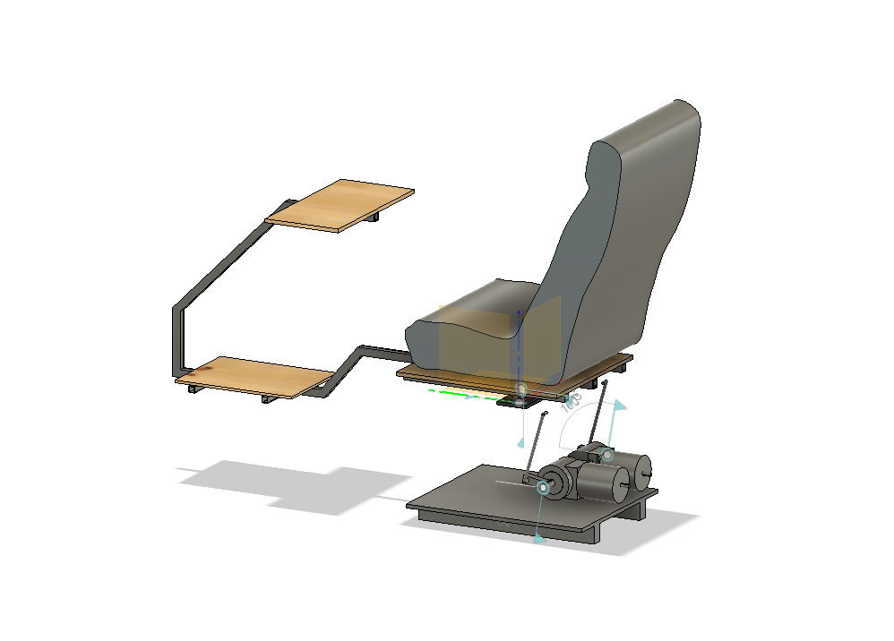

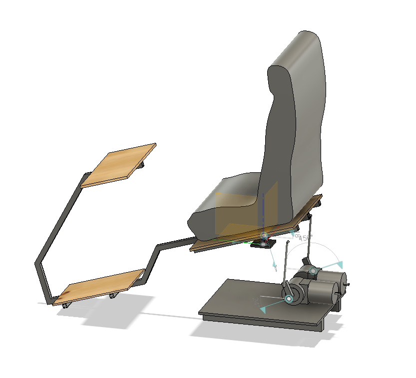

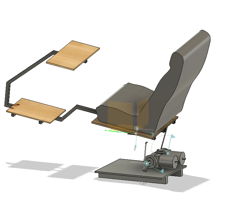

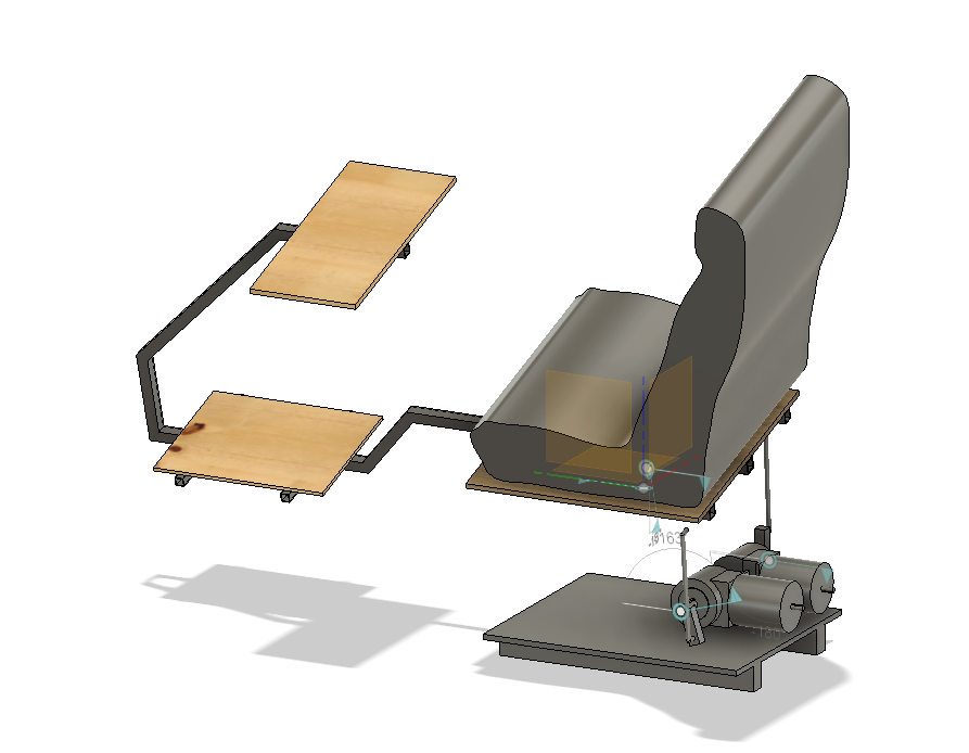

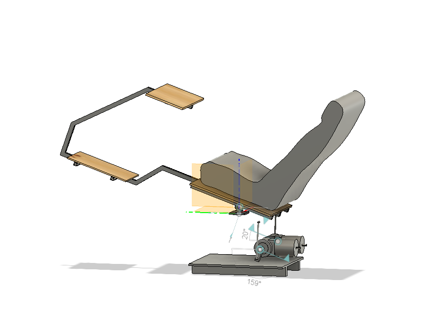

    Here in some pictures of my design (still work in progress):
    Question: what is most important? Greater angle = higher "g force" but slower response or, less angle = lower "g force" but quicker response?
  11. yobuddy
    5,408
    50,691Coins
    +5,166 / 19 / -0
    Less angle = lower "g force", but quicker response for sure!
    Glad your up and running buddy!
    Take care,
  12. dieser
    dieser Member
    Jan 20, 2020
    54
    372Coins
    +12 / 0 / -0
    great progress!
    seems to run fine without load in the video! :)
    i‘m building a very similar seatmover at the moment.
    what exactly do you mean with greater and less angle? the position of the motorshaft to your seat?
    greets
    dieser
