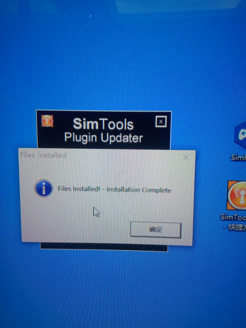

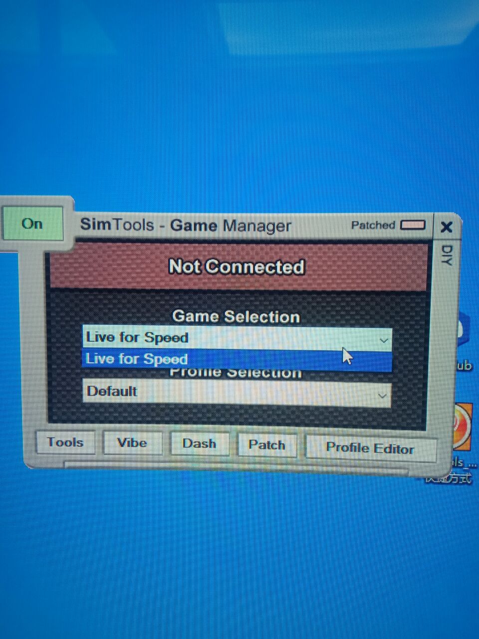

    After the system upgrade to 21H1, the plug-in cannot be installed. How to solve this problem?Specific can see the picture, after the plug-in installed, the drop-down menu without any games.

    As you can see from my pictures, it doesn't help to install any plugins. The Game Manager drop-down menu doesn't show any games.I tried installing Assettocorsa and Dirtrally2.It doesn't show up in Game Manager either

    Are you using a licensed and registered version of SimTools, as the demo version of SimTools will only run the Live For Speed plugin, which is included for testing purposes.

    You could try running GameEngine and GameManager as admin and see if it is a permissions issue.
    You could also possibly try temporarily disabling your antivirus and firewall, then reinstall, to see if either is interfering, as SimTools can trigger a false positive: https://www.xsimulator.net/community/marketplace/motion-simulation-software-simtools.63/
    Just to rule it out a known issue make sure your computer is set to English Local: https://www.xsimulator.net/community/faq/simtools-language-setting-bug-change-to-english-local.233/

    The language setting is English, I forgot to set it yesterday, and the potentiometer will only turn half. I tested it in GameEngine, and the functions are all normal. Even after installing the plugin, the GameManager does not display the game.The firewall is also closed, so I'm going to try running it in admin mode.

    I downgraded the system back to 1909, and it's working now.Seems incompatible with 21H1.Now the problem is solved. Thank you for your help.

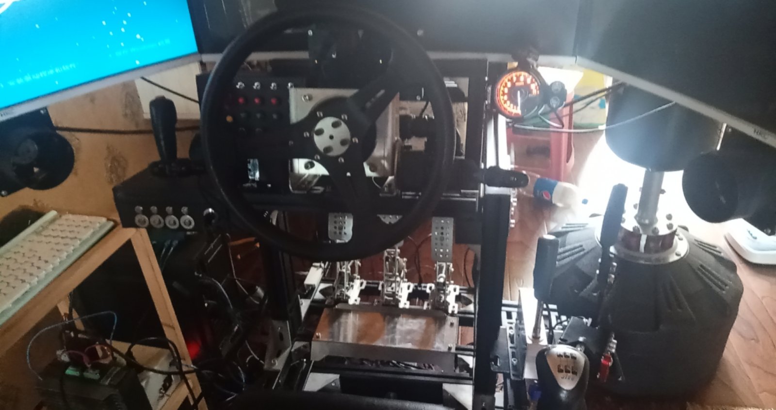

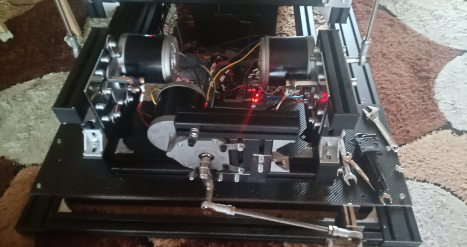

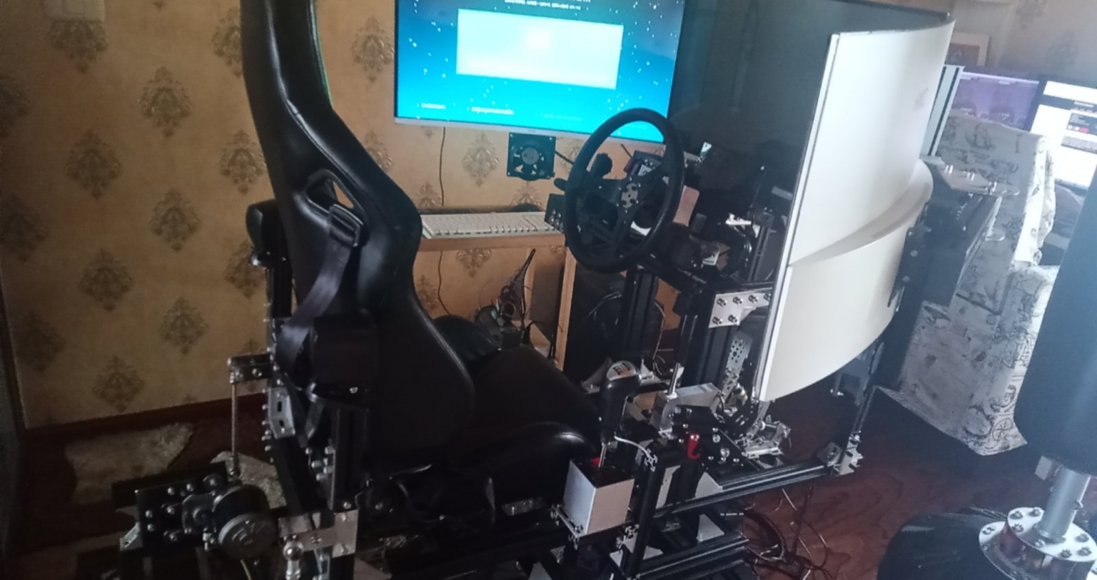

    Incidentally released my chair, DIY is very satisfied.
