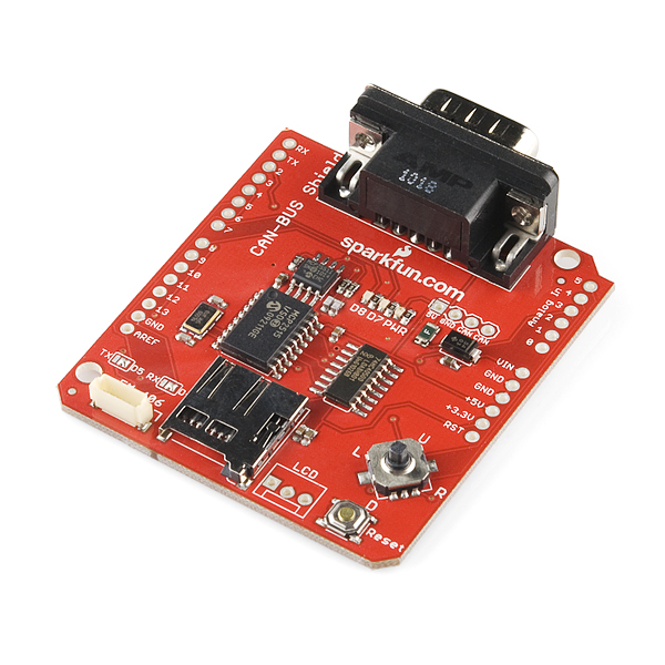

    Buy it direct from sparkfun a lot cheaper. Ocean Controls is only a reseller and adds his bit on.
    Can buy direct from sparkfuns site.
    Then the only issue is to work out what commands do what for a particular dash, this is the info that's the hardest to find, not many documents around the world that has this. Im afraid you have to experiment which is why I never when down this road, easier to hack the board instead of using a can bus.

    I do not know how to buildt but I'll try it and i think i will order a CanBus Shield....
    The can bus is 500kb/s

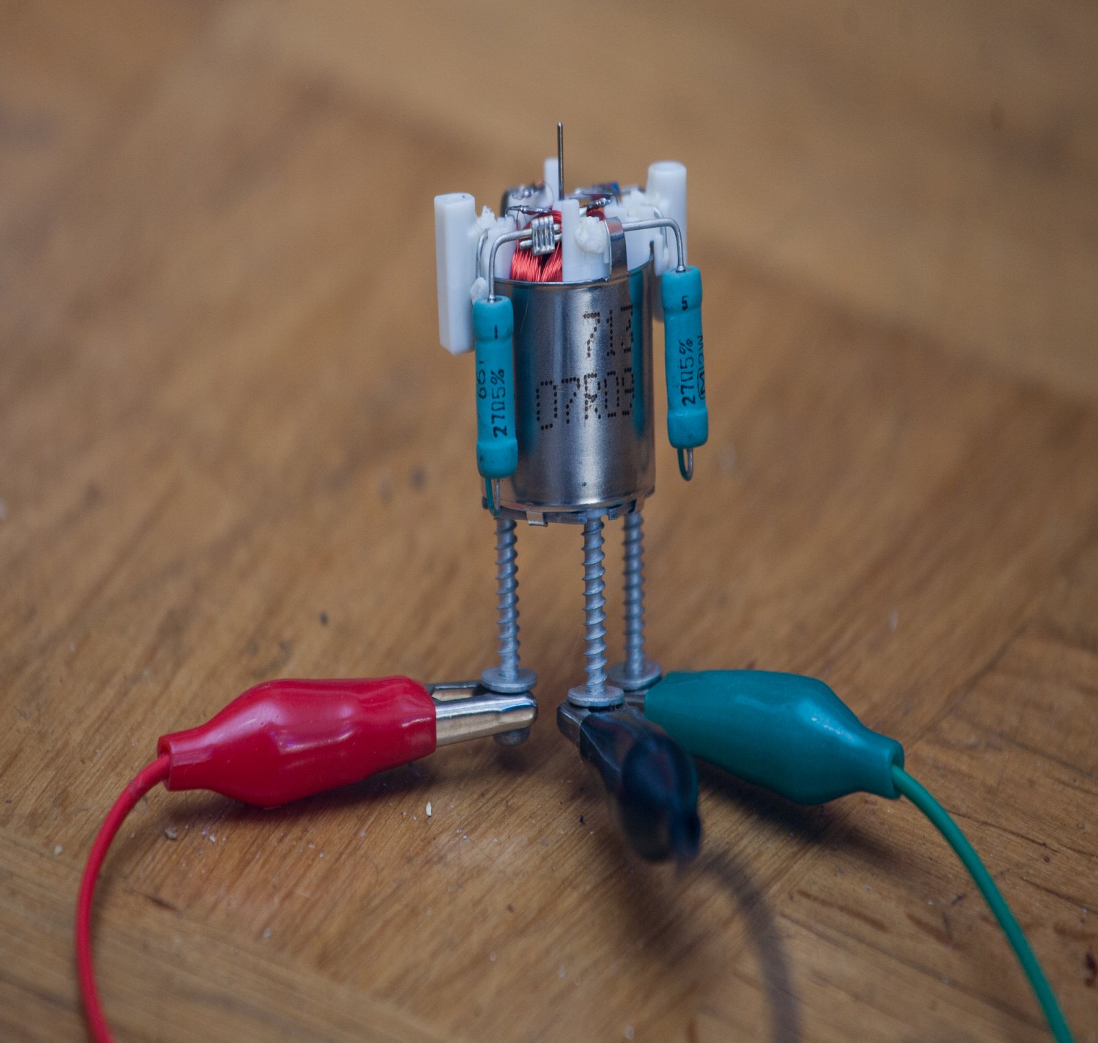

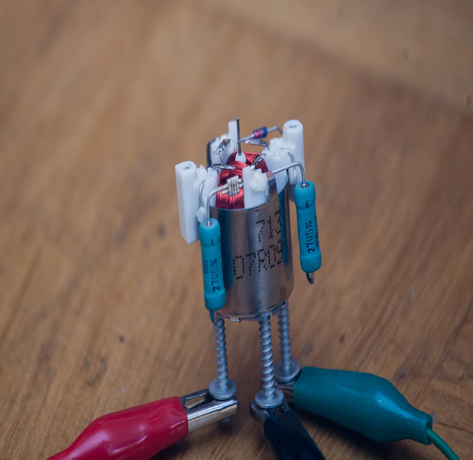

    i'm trying something simmilar. I bought a Hyundai Tacho cheap and stripped it appart. I lo0oked at this Page http://www.technikprojekte.de/Projekte.php?src=Tacho
    The Code there is made for an Arduino Mega. Since i own only Nano and Unos i try to convert the Script. I'm not very fammilar with programming, I'm at the beginning and have made some simple Projects yet. I understand very much of this code but one thing is just not shure.
    Where will be the output Pins for Rpm and Kmh be defined. Is this done in the Tone library or did i miss something.
    I made 2 pictures of the motors. For me they look like steppers, but on the back foil of the dashboard there are only 3 contacts Gnd, Ig+ (i think Ignition+) and fuelunit.
    Sorry for that noobish question.
    Edit: ok i ind out that these are no steppers, these are aircores and will be driven by l293d. But i don't find out very much.

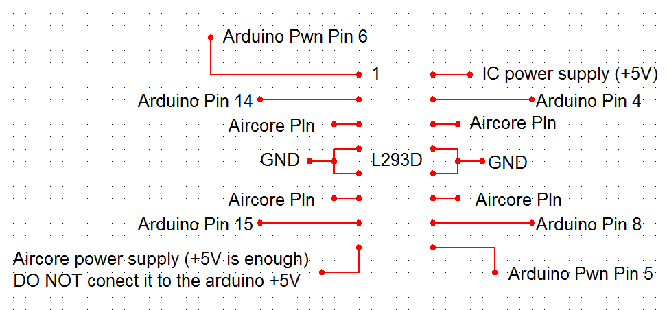

    So i made some further steps. Today i bought some l293D. Currently im trying to get a good movement. I use code supplyed in the link http://forum.arduino.cc/index.php/topic,22480.0.html
    But i can't get smooth motion yet. Also chip gots very warm. I think there's something wrong with the timing. Or maybe i didn't ind the right connection, because i can not define which is sine and which is cosine coil.

    Thanks for link. Yes i've seen this but didn't have tried it until now. I think i'll something other first. Becuase the aircore has a little pcb with controllerchips etc behind. There are 3 connections. Ig+, GND and Signal. I'll try to put a pwm signal on signl pin maybe it works.
    But something is strange i think IG+ will be Ignition + so the power avalible after turning the key. If i aplly 12v to ig+ ang gnd revcounter will go to 5000 rpm o_O
    I have to make some pictures of the whole dashboard.
    Edit: I have found this, http://www.xsimulator.net/community/threads/aircores-ardurino-controller.2502/
    I did same as wimpo did. I have solderd 4 Wires to the back of the aircore and loaderd up the sketch on my Arduino. After some switching around the wires i got it right. Now i know which pin connects to which coil and what is the right order. At the moment I am able to get some basic lagging 360° output.
    But i've got some timing problems. I have to make more tests. Hopefully my skills are goud enough.
    Edit: Seems like I am on the right way, but maybe this dashboard from a hyundai wasn't such a good choice. The Problem is that the aircore have 2 coils. I'm able to control the range from 1000-4500 fine, but for range from 4500-8000 the polarity of the 2 coils needs to be inverted.
    At the moment i try around with the l293d as descriped often by articles found on google.
    But since i'm very new to microcontroller programing it's very difficult. Maybe someone with more coding knowledge an help me?

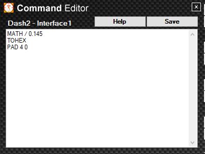

  15. jjanu
    jjanu LiveForSim Gold Contributor
    Apr 13, 2013
    72
    Multimedia
    Québec
    649Coins
    +63 / 2 / -0
