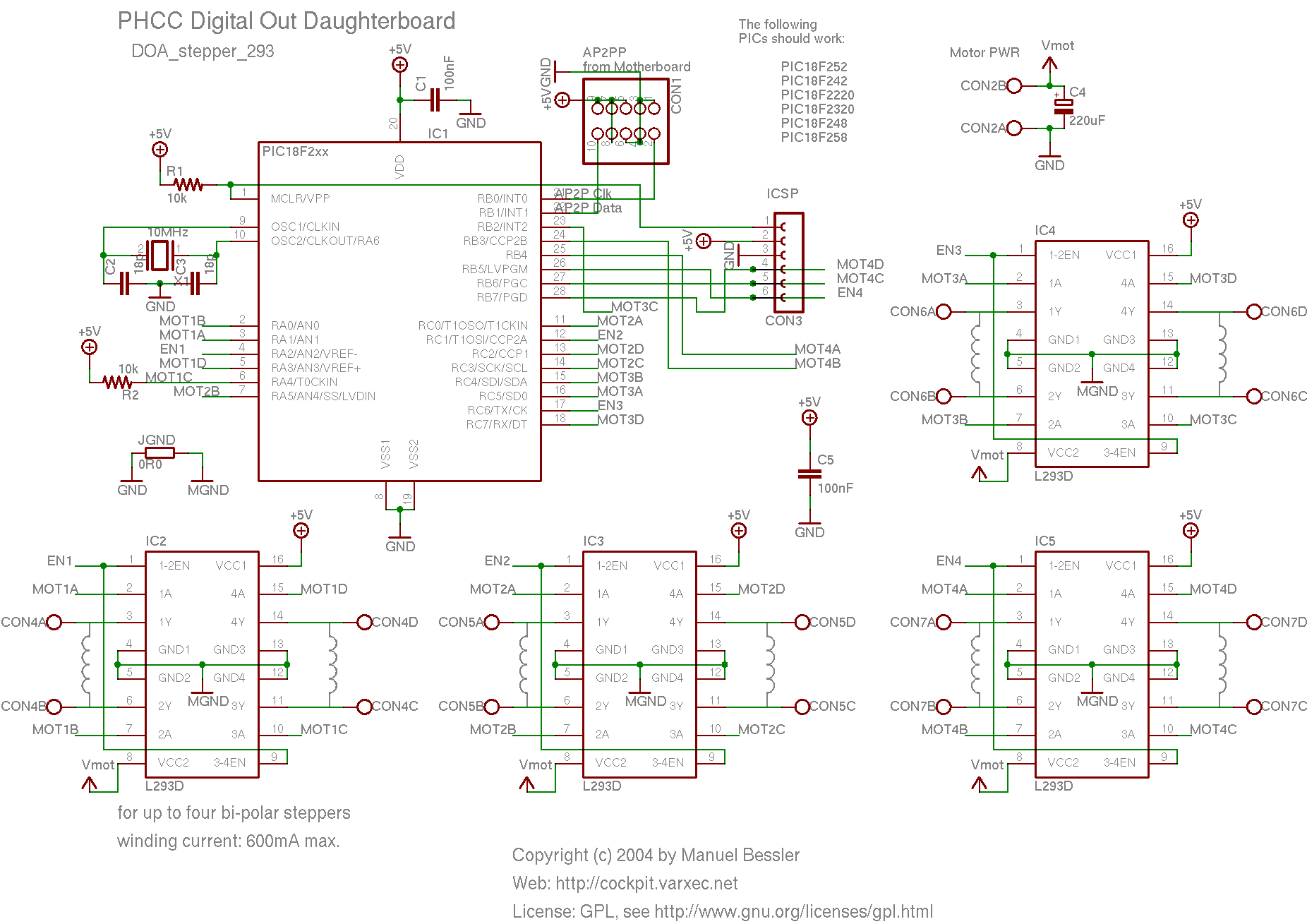

    Wimpo, its true... Air cores are similar to steppers but analog !!! And they require from you to have excited the opposite coil in order for the active one to precisely positioned because they lack permanent magnet !!! Thats how they got their air core name :brows:

    ok we have 4 wires
    what do we need to give them so we could set it to one position?
  17. Mambo

    Here is some interesting info on the principle they are driven with PWM signals... There is a table the shows the combinations!
    Air core gauge multi frequency pulse width modulator patent 005309087.pdf
    Most of the electronic circuits shown there can be replaced by just a simple hbridge chip like L293D ... :rofl:
    We can build it!!!
    Thanos
