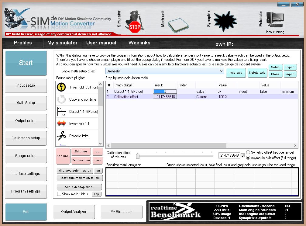

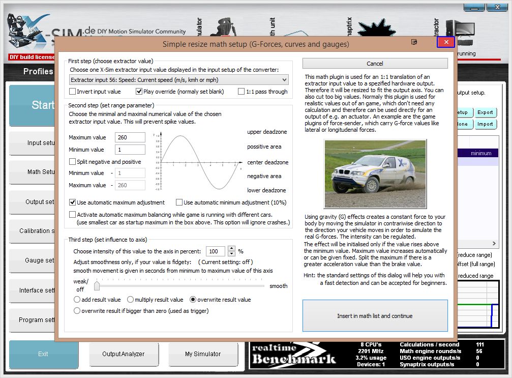

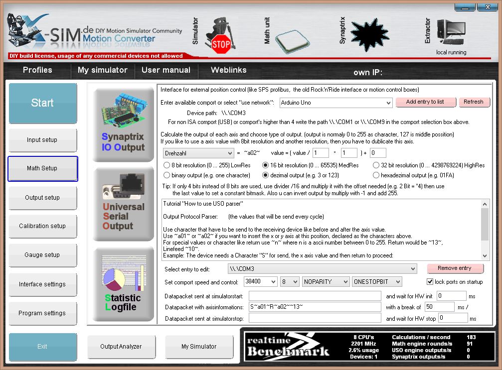

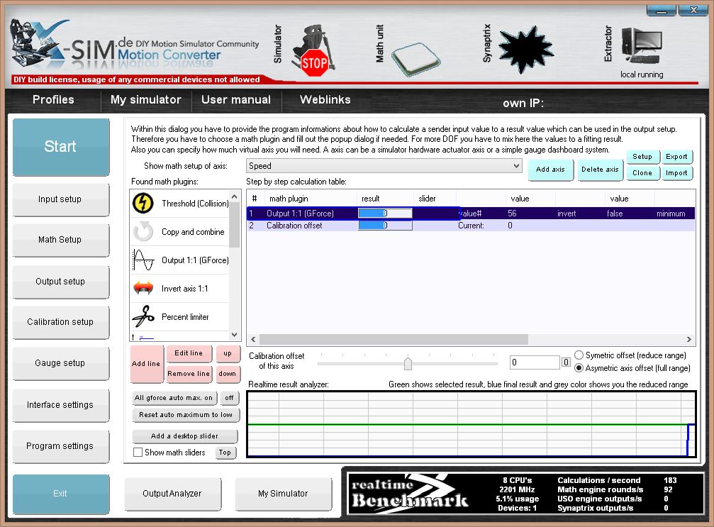

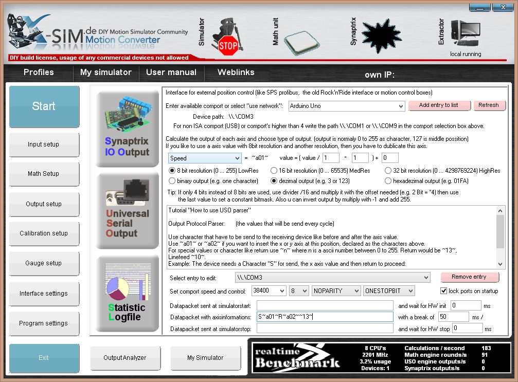

    now i controll my e36 cluster with x-sim and aruino uno.
    (sample from here )
    this work fine but i will use GameDash.
    how can i convert ?
    Arduino code:
    #include <Tone.h>
    Tone kmh;
    Tone rpm;
    void setup() {
    kmh.begin(2);
    rpm.begin(3);
    Serial.begin(38400);
    void loop() {
    if(Serial.available() > 0) {
    char kind_of_data = Serial.read();
    delay(1);
    int Data100 = Serial.read() - '0';
    delay(1);
    int Data10 = Serial.read()- '0';
    delay(1);
    int Data1 = Serial.read()- '0';
    //Daten anpassen: aus 1 wird 001, aus 10 wird 010 etc.
    while (Data1 < 0) {
    Data1 = Data10;
    Data10 = Data100;
    Data100 = 0;
    int Data = 100*Data100 + 10*Data10 + Data1;
    //Speed ausgeben
    if (kind_of_data == 'S') {
    int Speed = map(Data,130,250,10,318);
    if(Speed > 316) {
    Speed = 316;
    if(Speed < 33) {
    Speed = 0;
    kmh.play(Speed);
    //Drehzahl ausgeben
    else if (kind_of_data == 'R') {
    int Drehzahl = map(Data,0,630,0,270);
    if(Drehzahl > 270) {
    Drehzahl = 274;
    if(Drehzahl < 25) {
    Drehzahl = 25;
    rpm.play(Drehzahl);

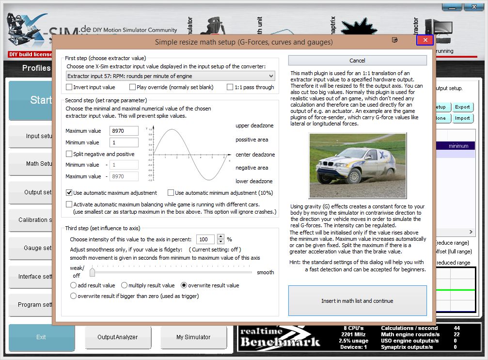

    x-sim config:
    regards Andreas
