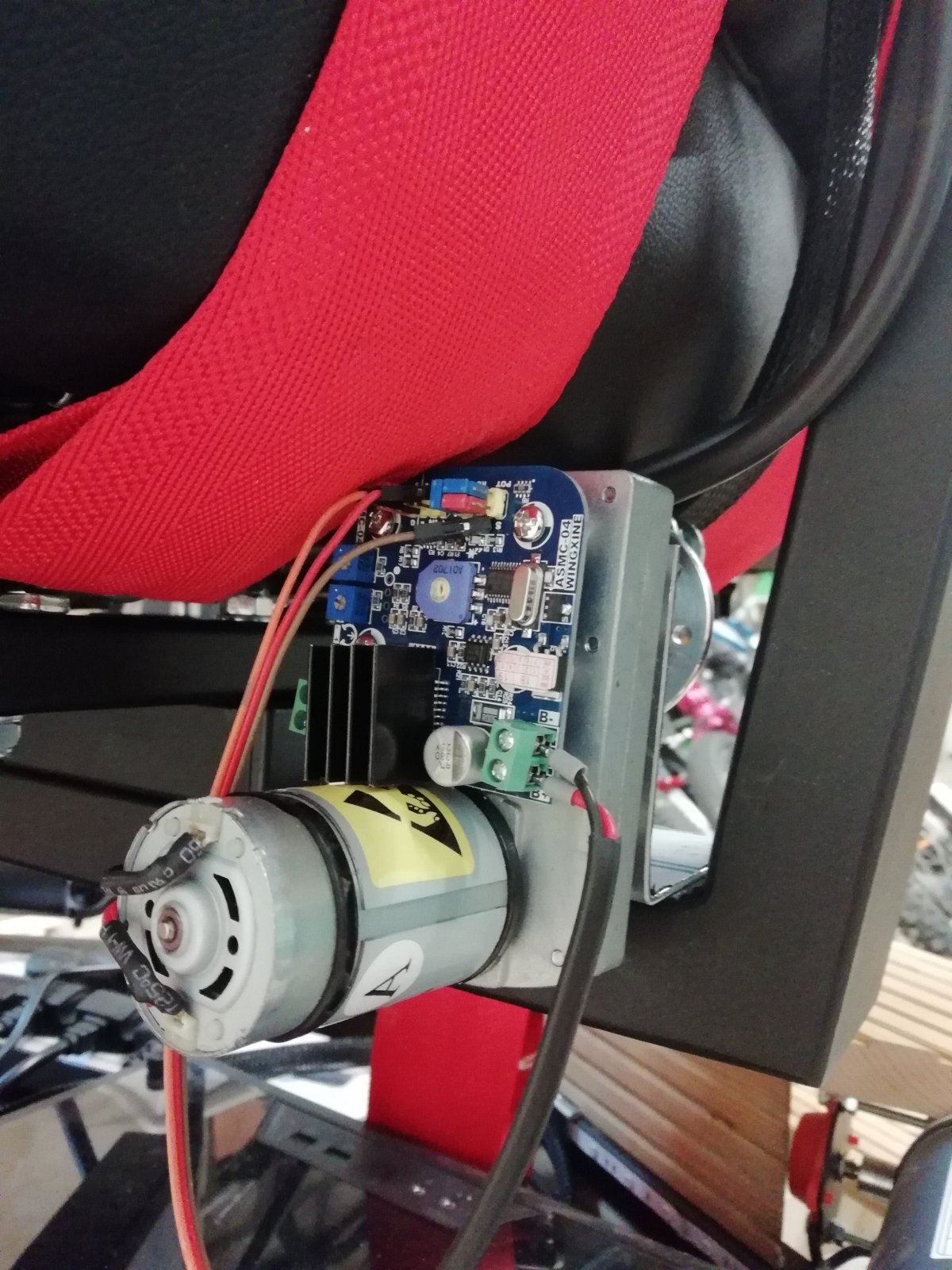

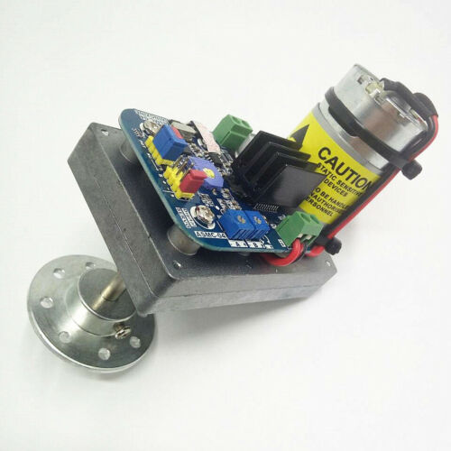

    I use one of these high powered servos:
    They are only £60 or so and give an astonishing 110kg/cm of force. I use mine on top of my Hexapod as a seatmover. I use it with a bar connected to the seat to move the seat fractionally closer to the steering wheel on braking and a little further away on acceleration. This is as well as the whole rig moving with surge.
    The effect is not for everyone as some want there to be no movement between the seat and pedals/steering wheel to ensure they can brake accurately but with subtle movements (I've set mine only moves the seat a maximum of 3cm or so) I feel it really adds to the feeling of braking and acceleration which the motion rig doesn't provide on it's own even with a G-seat. There are different benefits to be had from motion rigs, G-Seats and seat movers. I can't stop adding and wanting more! I remember reading on this forum how once you start, you get sucked into a spiral of adding and tinkering for ever more - How very true! o_O Maybe a G-Skull next...

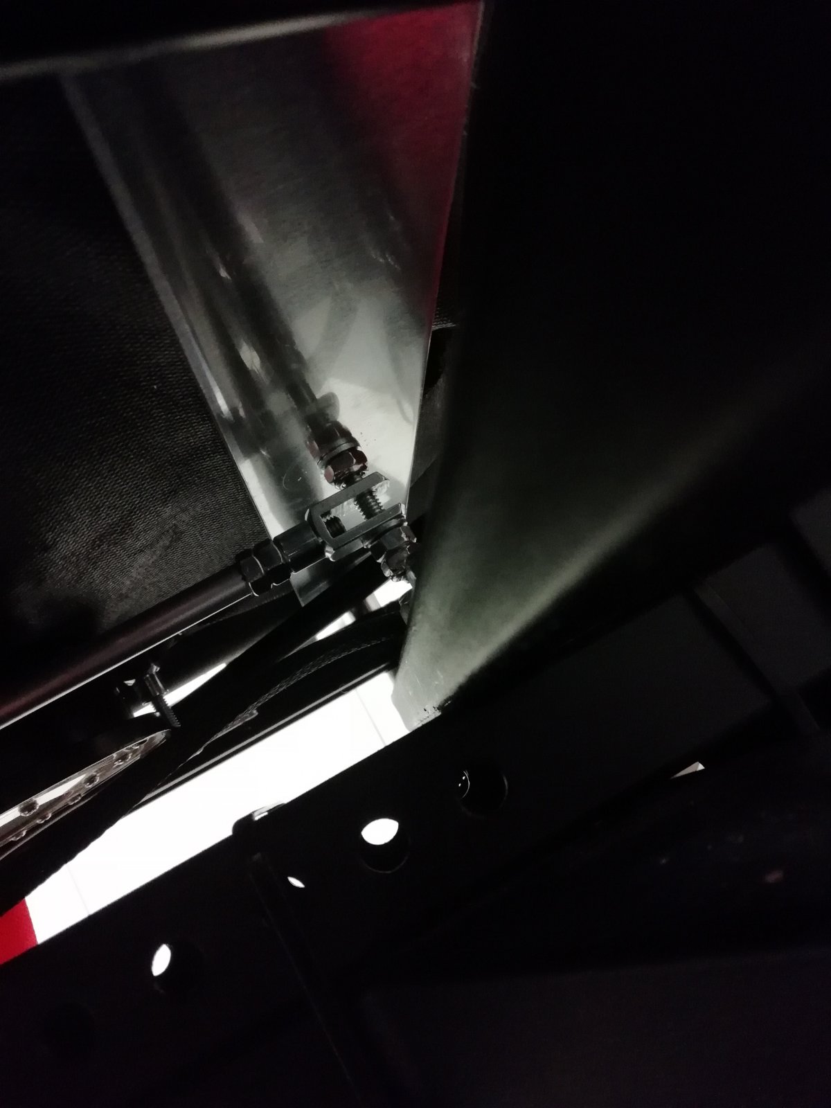

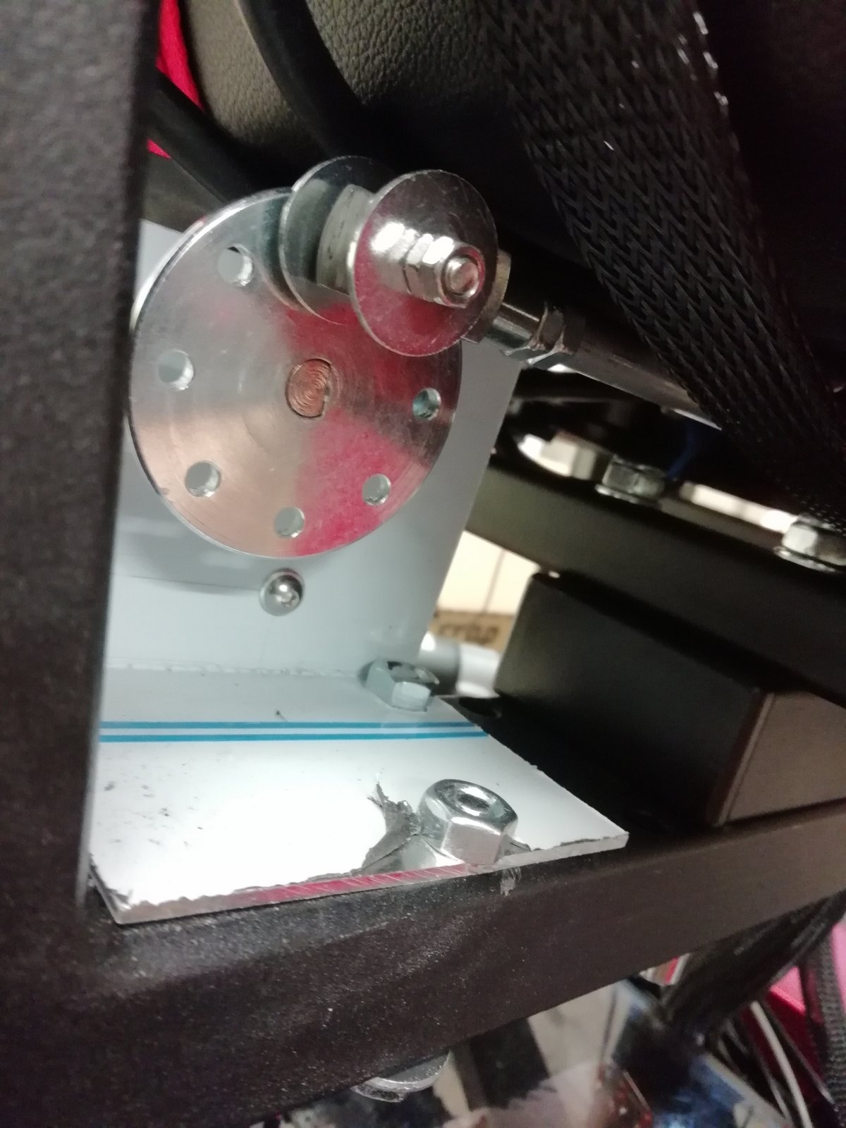

    Its nothing terribly fancy and I haven't neatened anything up yet (I've ordered a 3d printer and intend making an enclosure to house the servo PCB and controlling arduino board)
    I've attached some 6mm threaded rod to a couple of male clevis parts and attached these with washers and nuts to the servo wheel near the back of the chair and a strip of aluminium attached to the chair mounts with a bolt sticking down near the front of the chair. I found the threaded rod could flex a little under strong braking so stiffened it by running it through some 8mm aluminium tubing. With some fiddling, I found the whole range from 0 to 180 degrees on the servo was more than required, so I've set it to only move between about 45 degrees either way. It gives a subtle movement forwards and backwards relative to the wheel and pedals but that's all I wanted, too much feels unnatural. I initially had hooked up a 40kg servo I had lying around. It wasn't powerful enough but convinced me that the surge effect of the seat moving added to the hexapod movement I was already getting was worth pursuing.
    For the sliding motion, I'm just using the standard seat rails normally used for sliding the seat forwards and backwards for adjustment. As it's just a prototype, I haven't even removed the seat adjustment bar - its held in the up position with a zip tie! Very professional I'm sure you'll agree. I'm sure drawer runners or similar could be used instead, anything that keeps the friction to a minimum.
    The servo is attached with a bent piece of aluminium to form a bracket, it's probably sitting a little higher than it needs to be but the bottom of the seat still clears it when it moves backwards (just!)
    Happy to have my brains picked but I'm very much a tinkerer, there are others on the forum with engineering, electrical and programming qualifications who may be able to give better advice! It's an excellent forum though and there are lots of people who are very helpful and happy to give advice and share ideas.

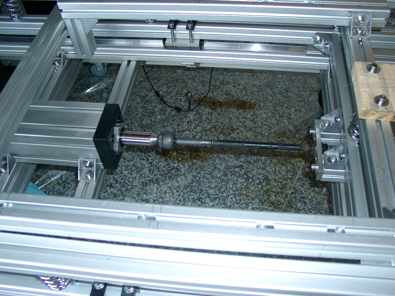

    4DOF
    SFX_surge.JPG push pull moded SFX 100 motor

  13. wingert
    wingert Active Member
    Aug 10, 2020
    130
    744Coins
    +100 / 0 / -0
    4DOF
    The basis of the actuator is the SFX 100 project (only push)
    https://opensfx.com/
    this Video shows the principle of the SFX push/Pull mod. First version with 6 srews.
    this video shows the easiest way to get the desired slider with the only necessary 2 holes and 2 screws.
    additional you need a collar such as this, drilling out to 30mm with two 5,5 mm bores
    https://www.maedler.de/Article/6231...5CdI_Evsrb58purbuiRxKrXjtm278ZkWJ1O6IvPu9GM_y
    Software could be FlyPt mover Controller Code arduino mega this
    https://www.xsimulator.net/communit...o-mega-for-aasd-15a-and-similar-driver.14421/
    I hope it is understandable
