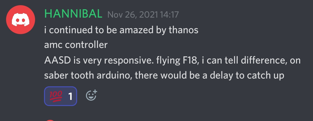

    And some feedback on Discord from AMC-AASD15A user that upgraded from DC motors and arduino recently...
