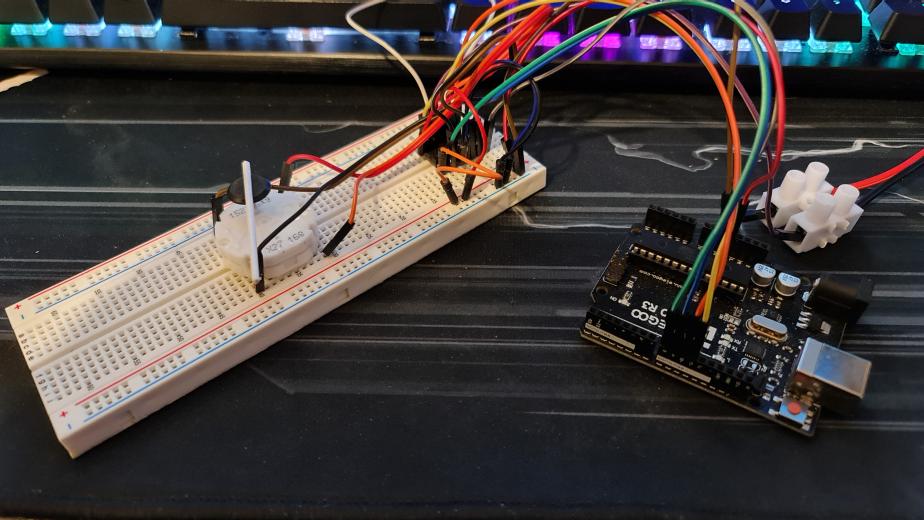

    Okay my lap time in LFS is 15 hours i need help
    ive been at this all day and night and its 10 to 1am and im stuck,.
    i read about this here by RacingMat
    https://www.xsimulator.net/community/threads/driving-diy-cluster-gauges-with-gamedash.5896/
    and well the code and im guessing the library is very old and no good
    im using a L293D h Bridge with RacingMats code and it didnt stop the jutter and the slowness
    so i thorght to hell with it ill use the Stepper.h library arduino comes with.....
    i cant get it to move the gauge it just makes a noise and sometimes locks up like its trying to do something
    here a picture of what i have
    so here is my code i have for the stepper.h library
    Code:
    // D8 to p2, D9 to p7, D10 to p10, D11 to p15. 12V on pin 8 only
    #include <Stepper.h>
    int stepsPerRevolution = 600;        // Change this to suit the number of steps per revolution for your motor
    byte Rpm;
    Stepper MotorRPM(stepsPerRevolution, 8, 9, 10, 11); // initialize the stepper library
    void setup()
      Serial.begin(115200);
    } // End of setup()
    void loop()
      if (Serial.available() > 0)  {
        Rpm = Serial.read();
      MotorRPM.step(map(Rpm, 0, 255, 0, stepsPerRevolution));
