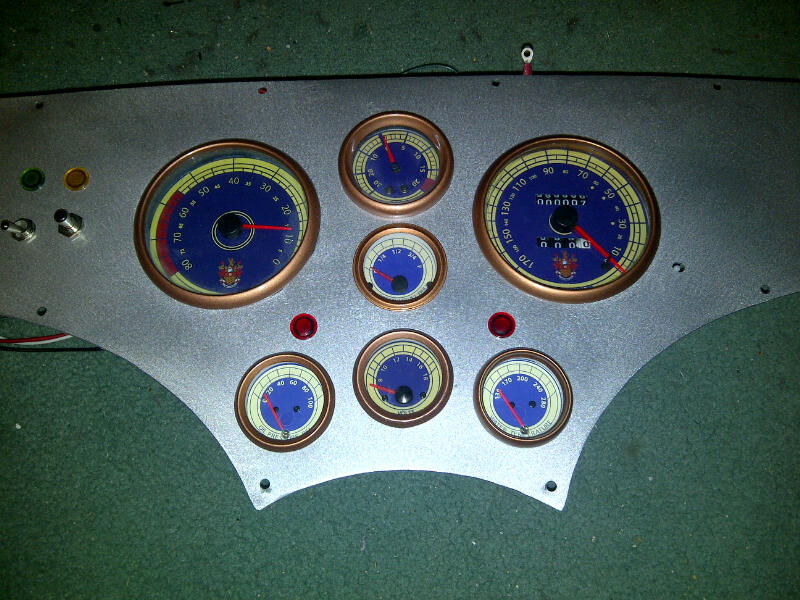

    After the giant LED gear indicator, I intend to build a big DIY cluster :)
    - Arduino
    - stepper motors : switec x27.168
    - lighted needles
    - GameDash

    Here is a first trial video!
    It's really fine for a first test with a balsa needle, without optimization.
    To gain more speed, I'll supply the motors with 10V instead of arduino's 5V

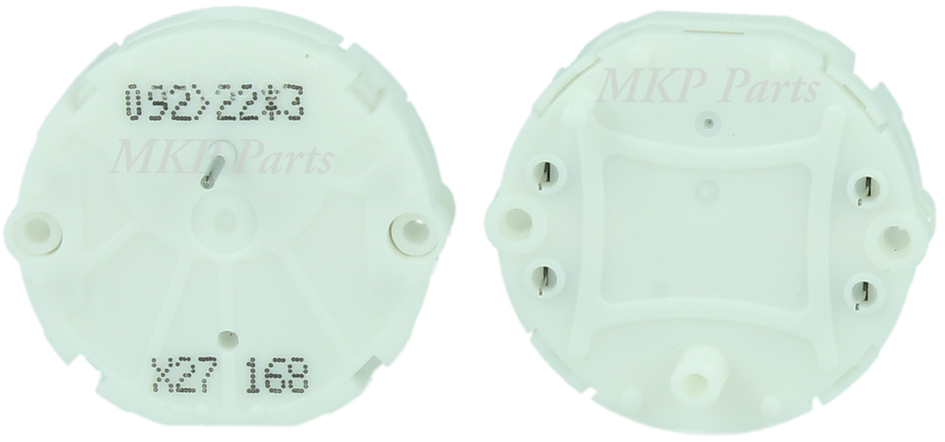

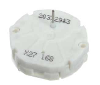

    • Switec X27.168
    these stepper motors are used in real cluster instrument
    a buyer guide
    the cheapest I found are on Aliexpress @2€ each
    http://www.aliexpress.com/item/5pcs...GMC-Cars-And-Trucks-2003-2006/1456148765.html
    but many can be found on eBay
    switec X27 search

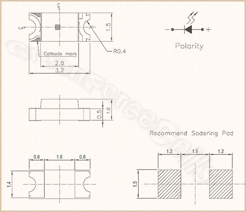

    • some CMS LEDs to light the base of the transparent needle
    led spec.jpg led.jpg white 1206 smd led
    I got 50 leds for 1€60
    http://www.ebay.fr/itm/50-x-1206-White-Super-Bright-LED-SMD-SMT-Bulb-Lamp-Light-High-Brightness
    or 100x for 3$ on ebay.com
    LED Type : SMD 1206 LED
    Lens Colour : Water Clear
    Emitted Colour : White
    Peak Wave Length (nm) : 6000-7000K
    Forward Voltage (V) : 2.7 ~ 3.7
    Reverse Current (IR) VR=5V 50μA
    Viewing Angle : 130 Degree
    RoHS: YES
    Material:AlGaInP​
    Those leds are used in automotive cluster: so it will be perfect for my needs​

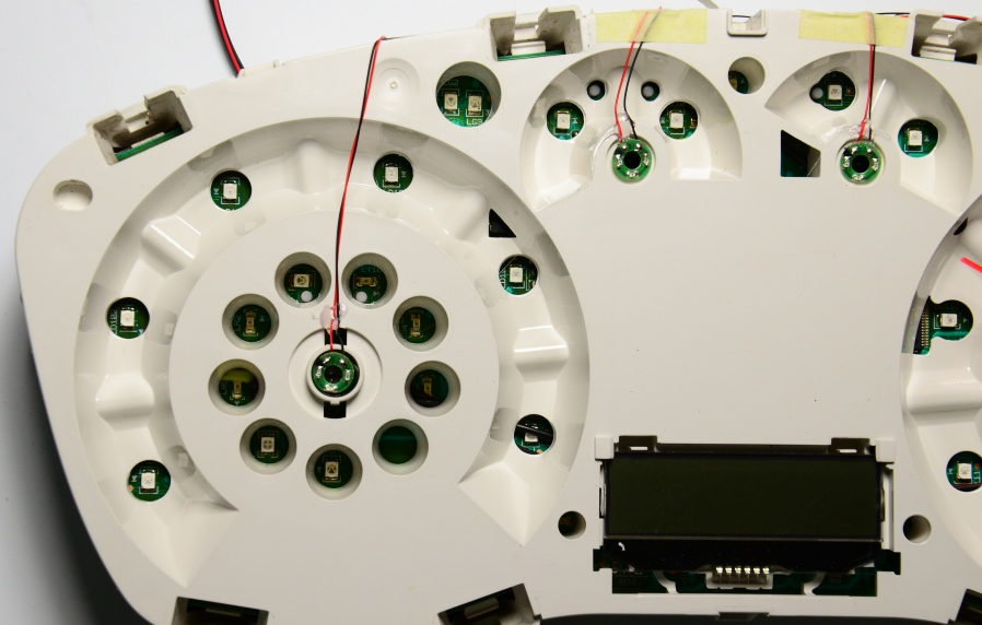

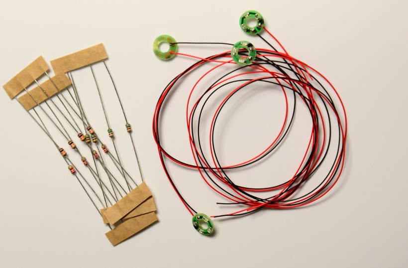

    backlight LED assembly

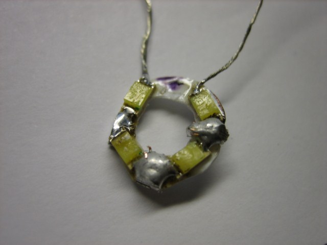

    CMS LED are really small and can be useful for this use

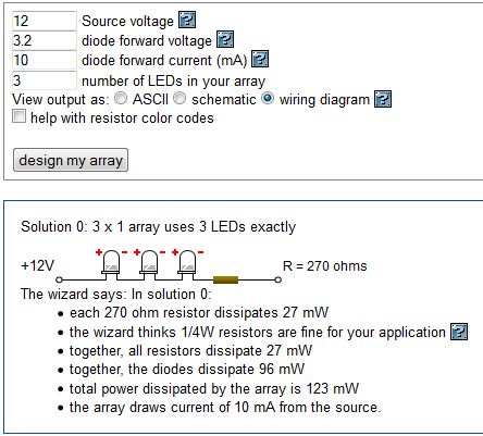

    Some nice resistor calculator online:
    http://led.linear1.org/led.wiz which deals with serial LEDs and write the results with a nice layout.
    -> R = 270 ohm

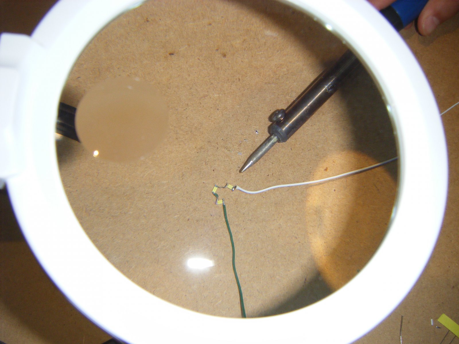

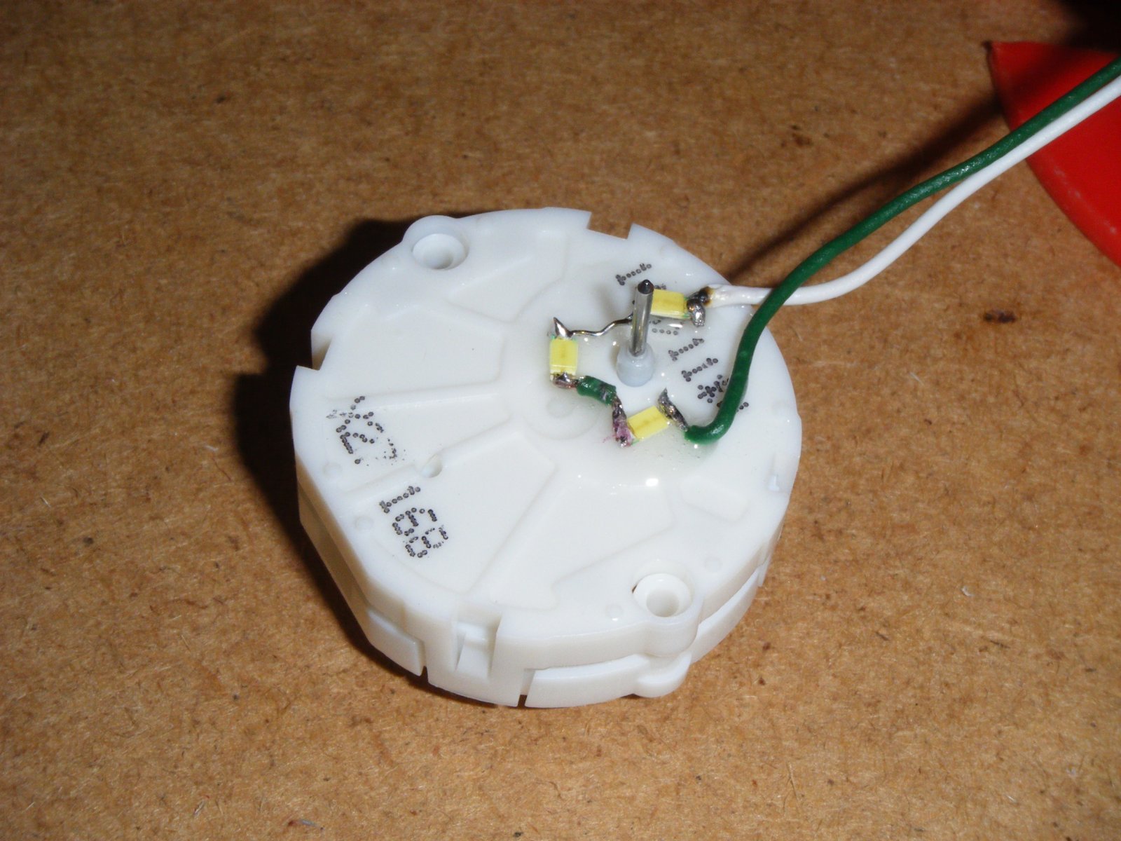

    the LED are VERY small!
    I had to keep the previous LED under a wet tissu to prevent desoldering... when I soldered the next one... :mad:
    and it's fragile, i will need a round support:
    for the first one, I glued it! with bi-components glue

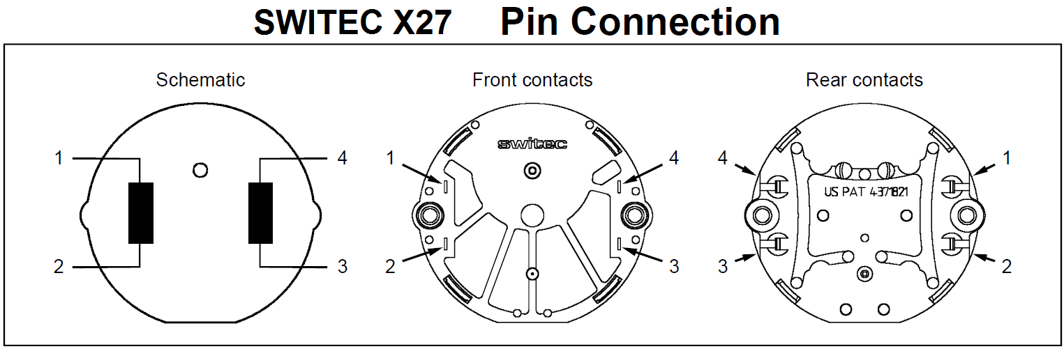

    Motors wiring
    If I want to drive 5 gauges, I'll need to extend the number of digital pins...

    Switec wiring: the arduino drives the 2 poles with 4 digital pins.
