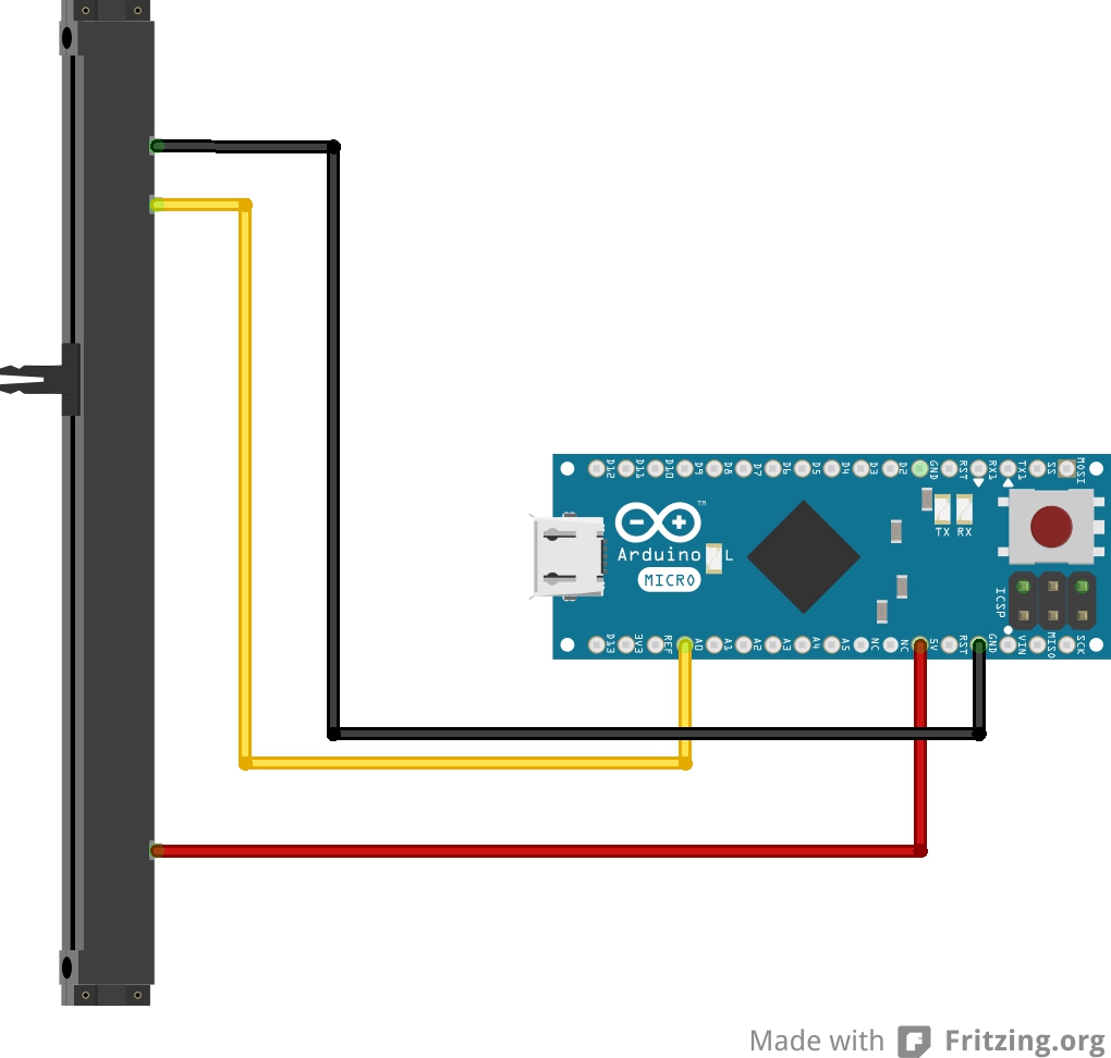

    I built in analogue handbrake with arduino micro, and a sequential change with a usb board, any question here I am

    [QUOTE = "zapata_h, post: 175792, miembro: 9215"] Construí un freno de mano analógico con arduino micro, y un cambio secuencial con una placa USB, cualquier pregunta aquí estoy [/ QUOTE]
    If you can take a hand of scheme and code that I imagine that being arduino, you need code I thank you.

    Here I enclose the schema and the arduino program, remember to copy the libraries in the arduino library, otherwise it will give you an error when compiling the project

    You must use Arduino Pro Micro, otherwise it will fail to compile due to failure of the joystick library, (USB)

    perfect apart from hand brake can also be removed with that plate to make a secondary change.

    To make the sequential change you would have to modify the arduino code or use this board that I have, you can use many buttons. You can find it in aliexpress, amazon ... its name is "usb zero delay", perfect for sequential change switches

    and for hand brake is not worth that plate is true arcade a greeting

    The plate I only use it for the sequential change
