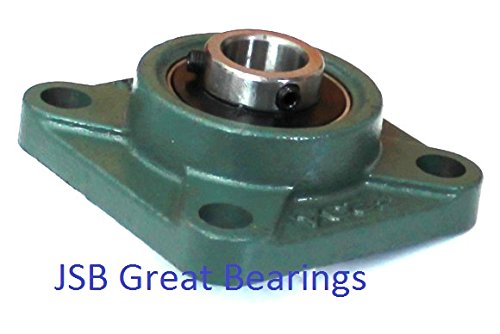

    What are you planning to use for the front TL pivot, a lazy susan or something else?
  3. bspriggs
    bspriggs New Member
    Feb 26, 2017
    26
    North Carolina, USA
    382Coins
    +8 / 0 / -0
    3DOF, JRK
    Planning on using this with a 3/4" shaft.

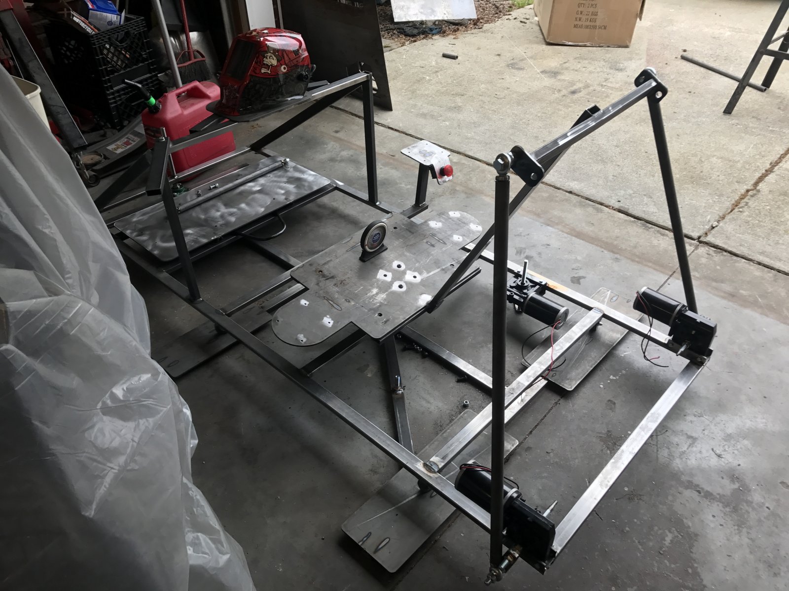

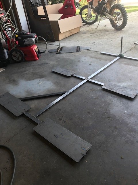

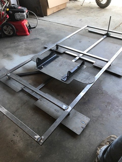

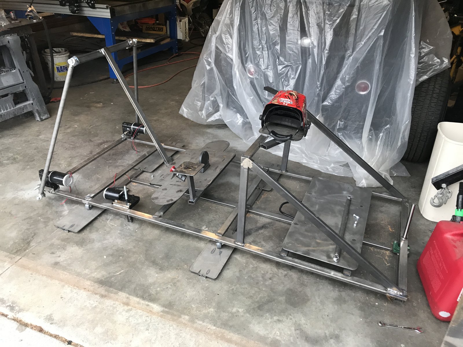

    Here are some updated build pics....

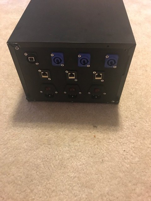

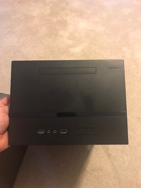

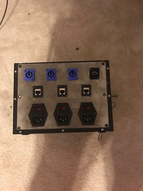

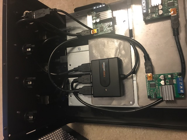

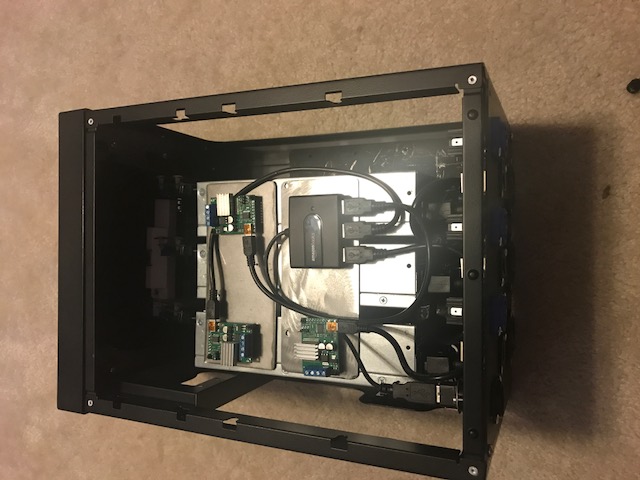

    Here are some pics of the electronics box. This is an Antec mini itx case. Im using 3 HP server psu's with breakout boards from ebay. The back plate is cut using my CNC plasma table. I will be mounting a fan in the top of the case to blow directly down on the JRK's.

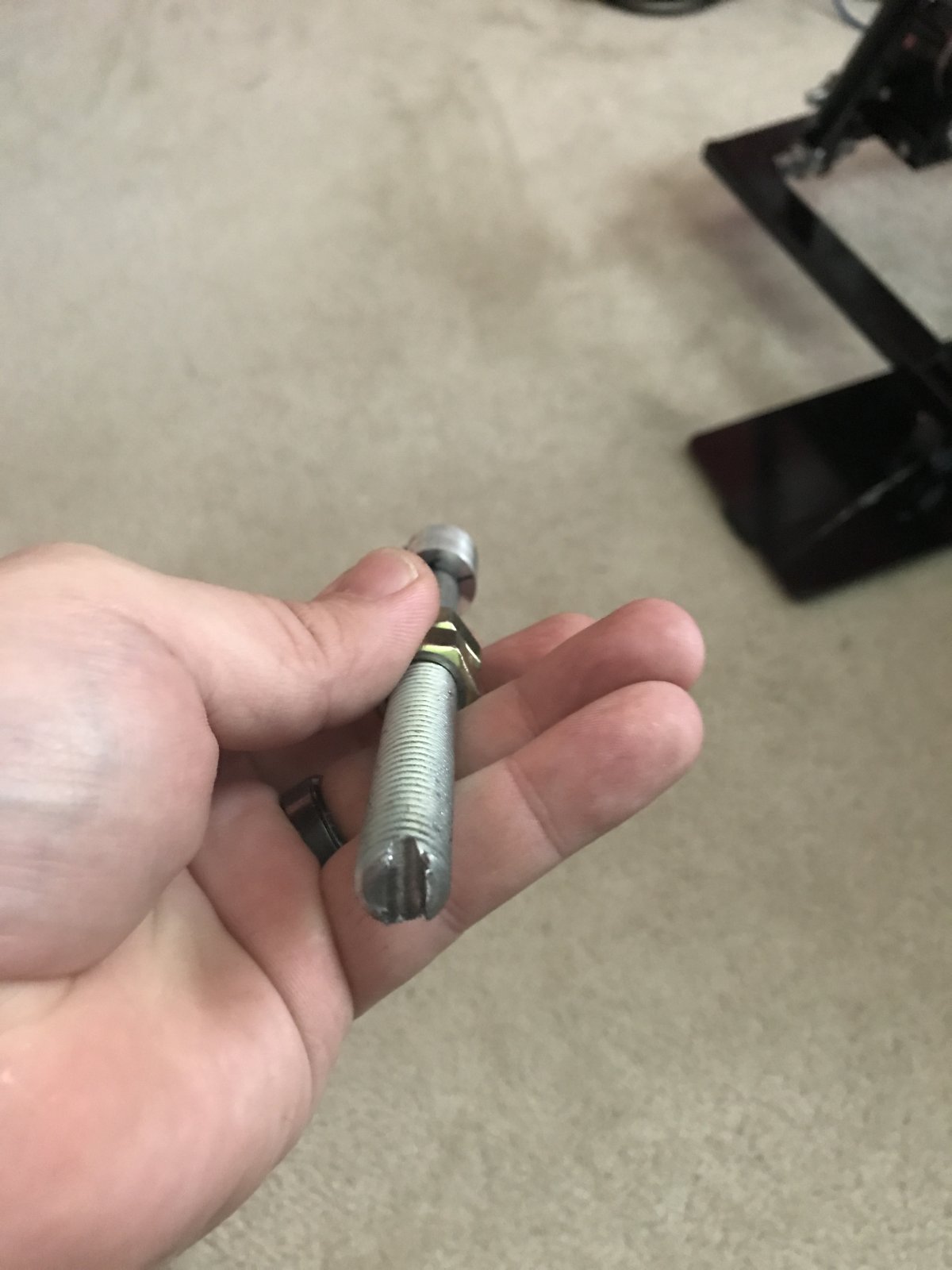

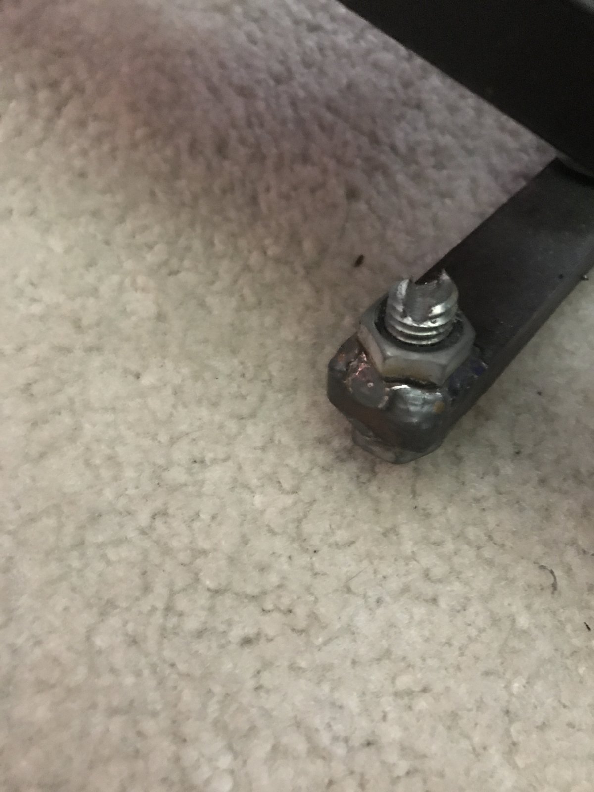

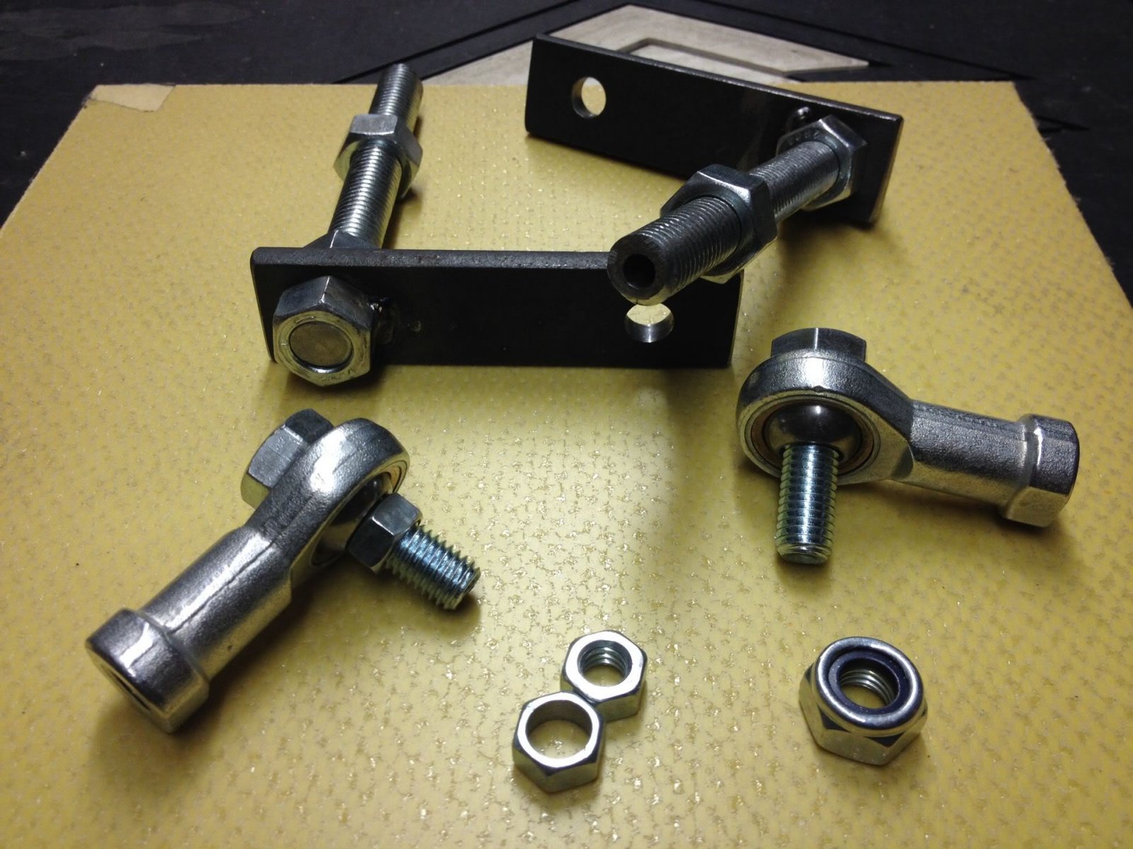

    Trying to wrap my brain around the attachment of the levers. I've read the threads and seen the pictures. I understand on the lever side the nuts are welded to the lever on both sides. Are those nuts then also welded to the threaded rod? If not what keeps the rod from unthreading from the lever/nut assembly. In the pictures I've seen I can't see where the lever/nut assembly is welded to the threaded rod.
  15. Nick Moxley
    17,054Coins
    +2,504 / 30 / -2
    I see your concern from a technical side, but the fact i took 2 Big arse wrenches along with some red loctite on the threads and CRANKED those suckers as hard as i could. There is No way there coming out as proven by 4+ years of service with no issues on that front. Technically adding a Bead to the Nut and Rod would be wise, but not really needed.
    Also a Tip, when tightening the Main Threaded rod in the motor shaft, Dont go all HULK on it, You can damage the shaft itself if you go crazy on tightening.

    More pics....getting closer. Hope to be running in next couple of days.

    So I've got the rig up and moving and have ran into a problem. The 1/2 motor shaft that the lever attaches to snapped in half after about an hour of running. It broke where I drilled through it to pin it. This happened on the traction loss motor. Kind of at a loss at what to do to prevent this from happening again.
  18. Nick Moxley
    17,054Coins
    +2,504 / 30 / -2
    better/higher grade threaded rod is the solution, tho makes drilling a bit harder. Did you have the hole perfectly centered ? I also opted to drill my own hole in the motor's axle shaft and use a smaller 5-40 bolt so there was more material for the threaded rod.
    realize tho, Inertia is at play here. The heavier the load the more stress that lever/axle has to deal with.
