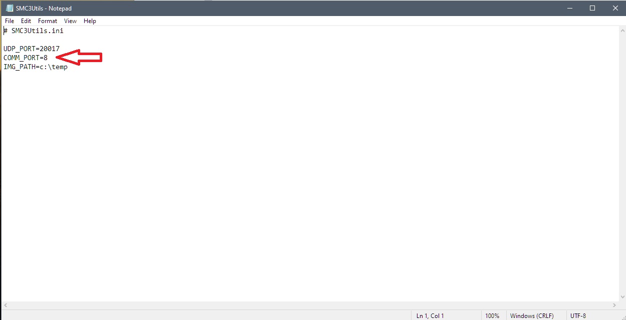

    ok so iv started to try and get my motors turning on my 2DOF sim using SMC3, but im very useless on computers and software, and I am already struggling on simple stuff, how do change the comm port ? its on 1 now and my arduino s on comm port 4 ,the instructions state what to do and I can bring the notebook document and see comm port=8 do i do something with that ?

    The comm port your Arduino is connected to is used in the SimTools Interface Settings drop down, so SimTools knows which hardware it is talking to.

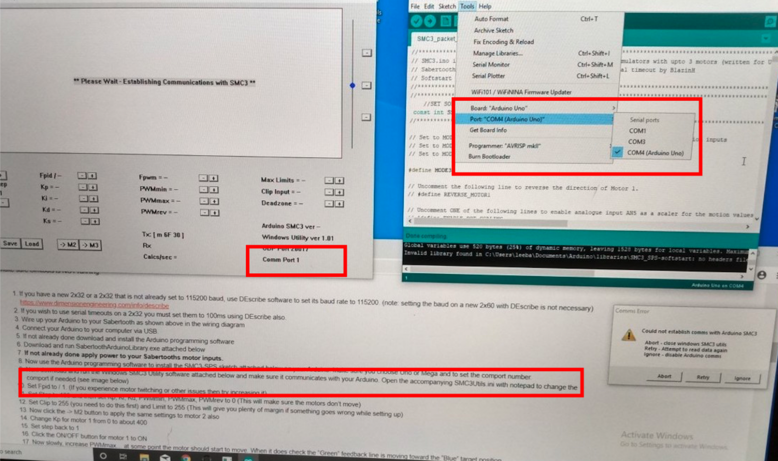

    This is a photo of my screen and the problem I believe im having, and from what I read in the instructions about opening the SMC3Utils.ini with notepad to change the comport, I don't understand how to do that.
    my motors start to twitch with the Arduino program open in this state.
    I feel a little embarrassed about this all, as this is very basic stuff.

  15. noorbeast
    21,725
    152,063Coins
    +11,065 / 56 / -2

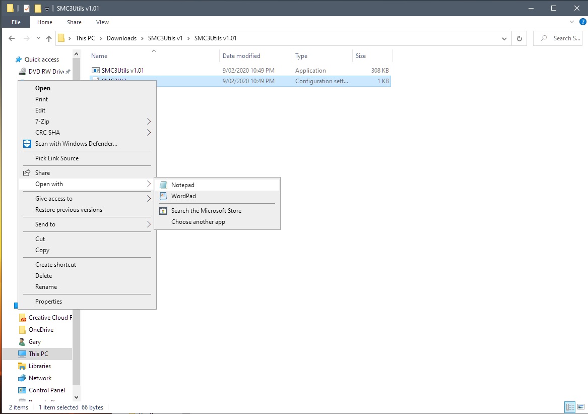

    In the unzipped SMC3Utils folder right click on the config file on Open With -> Notepad
    Then change the Comm Port and save the file

    @noorbeast thank you for your reply's very much appreciated, I have been doing the exact steps but does not chance the commport,I wondering if I have saved something in a weird location.

    Sorted it now, deleted and downloaded again, i think it was something to do with the desktop shortcut.
