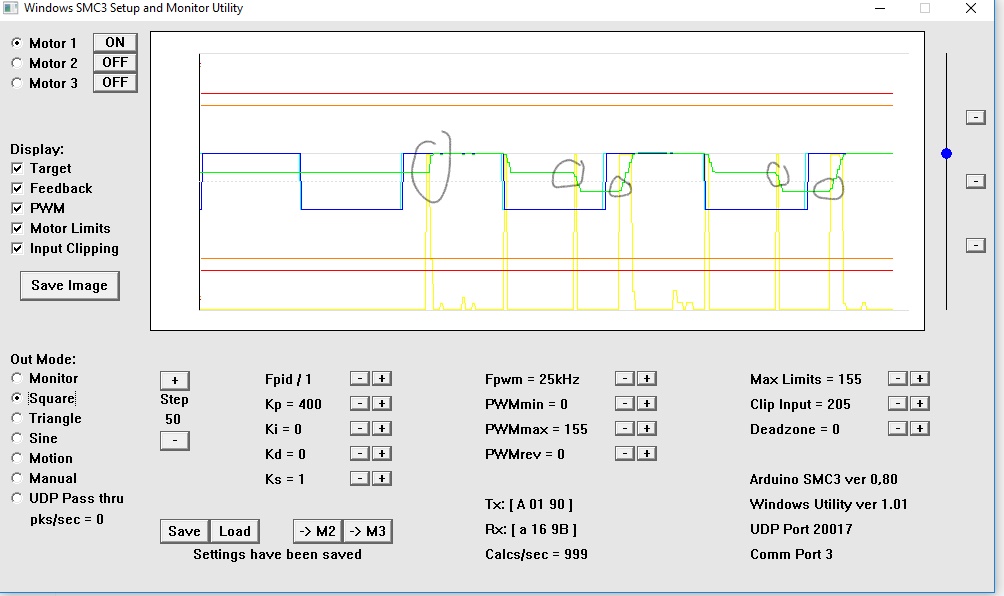

    With your step by step guide I could bring the motors into life:) But I have to face some problems, maybe you can help me with them.
    If the PWMmax is below ~150 the Motors move fine and try to catch the blue line. If I increase PWMmax i face to different problems. My motor isn’t attatched to anything atm, they are just lying around. So, when I increase PWMmax, the switch for “motor 1” in the upper left corner in the program turnes to „off“. I have to turn it on again, that the motors keep moving.
    You can see it in the following picture. The marked points show when I turned the motors on again.
    This error also occurs, when a try to hold the motors manually. I didn’t bold it to a plate yet to figure out if this error will perish. Maybe you can tell me, why the software turns the motors off?!

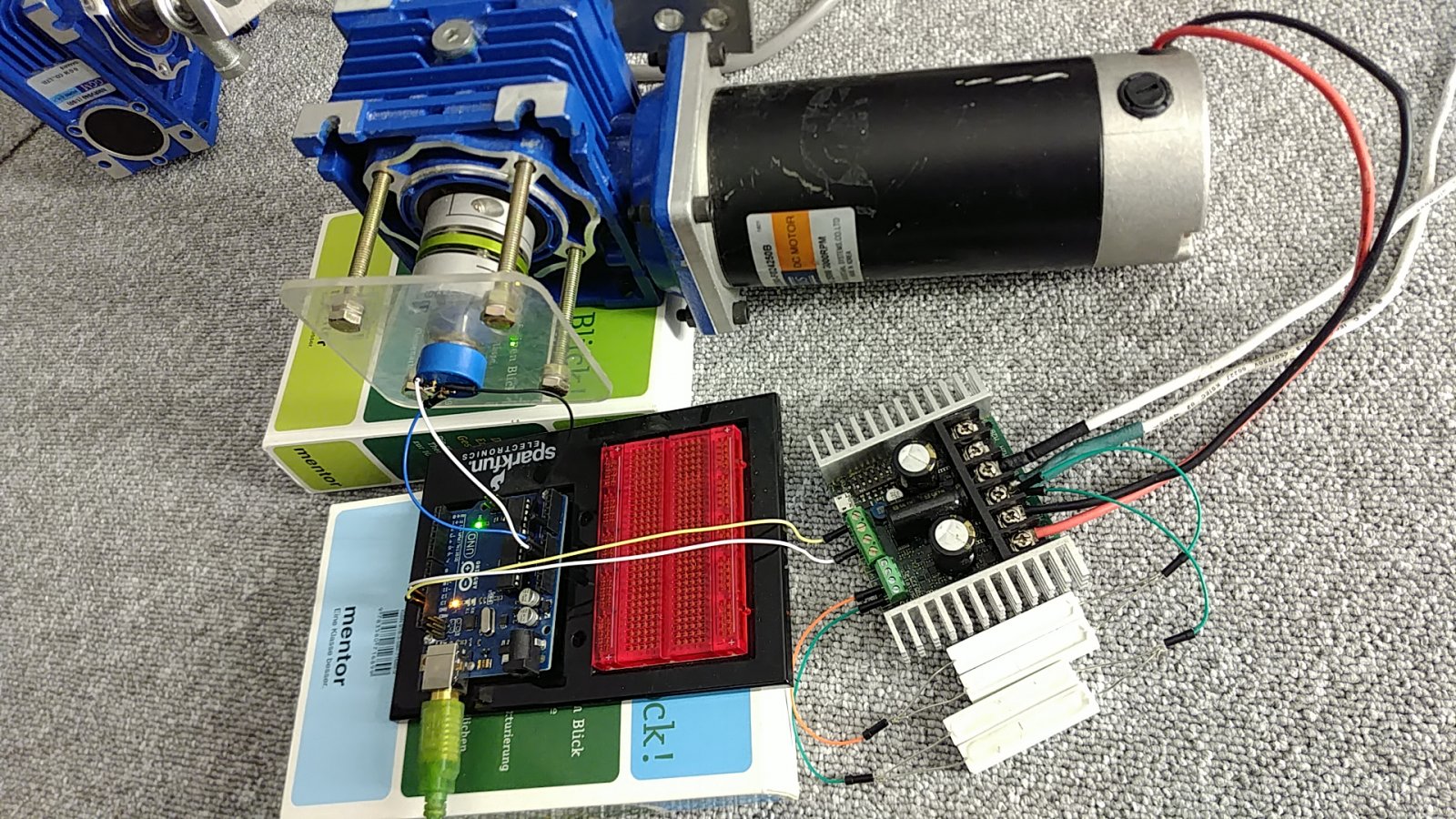

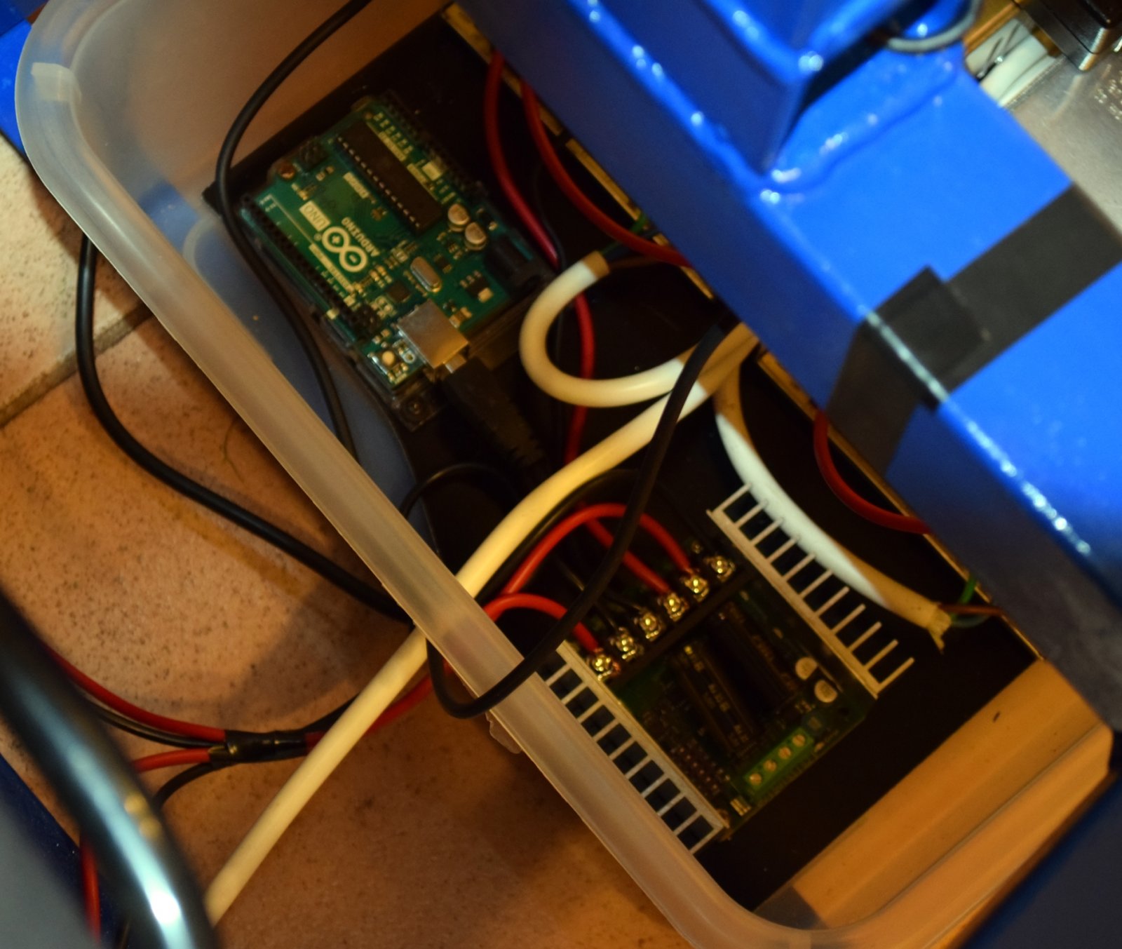

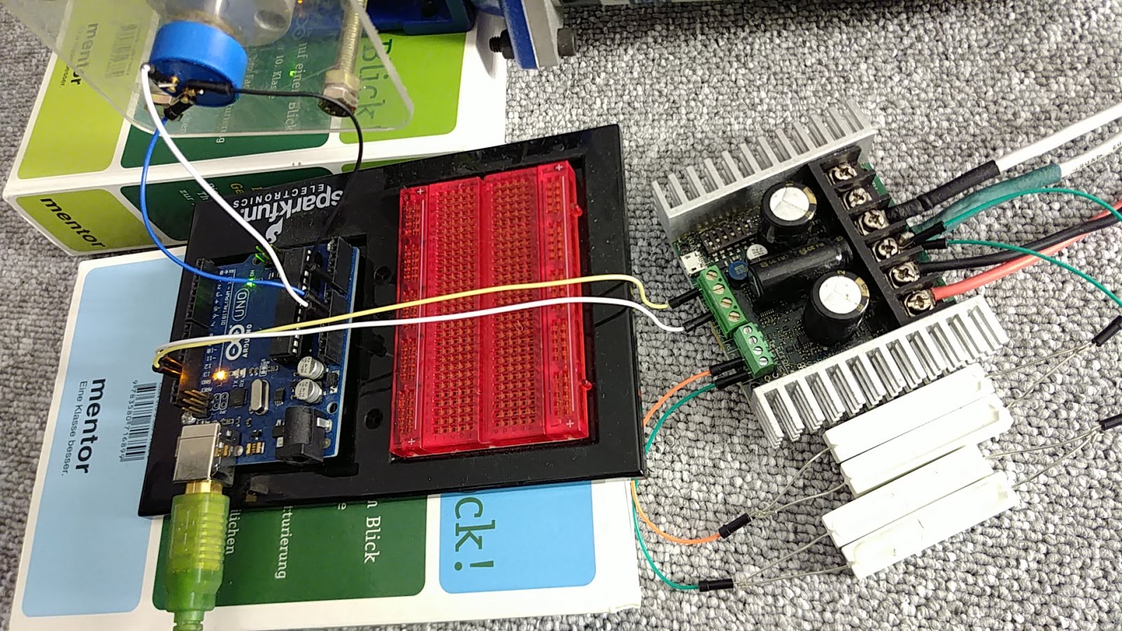

    The second problem shows up when PWMmax is raised even higher or if I put “Out Mode” to manual and am too ambitious with the slider. Then the PSU turns off:mad: I had this error all the time, before I used the resistors. Is the braking current (without ANY load) so high, that the PSU turns off?!
    I’m using a Meanwell 24V 14.6A PSU and have two times two 5.1 ohm resistors parallel. I know, it’s a not the suggested resistor, but I have no 1.6 Ohm atm. The wiring is seen on the following pics.
    Is something wrong? Or do I just need to bolt everything together and use proper resistors?

    I had an idea: since i didn't solder the wires to the pot, it could be, that they lose contact, when the motor is shaking to hard:roll Have to test it, if it solves the problem, it's great, if not, i will ask again.
    But i still need to get rid of problem two...
  10. SeatTime
    2,573
    I would like to see bigger cables going to those surge resisters... - they are high wattage for a reason :).
  11. My.stAr
    My.stAr Active Member
    Sep 7, 2012
    151
    Engineer
    1,064Coins
    +63 / 0 / -0
    DC motor
    Oops:blush Sounds reasonable... will change the the cables :thumbs
    /edit:
    it was the Motoro_O
    Have no problems with the other Motor. The resistors stayed completly cold...

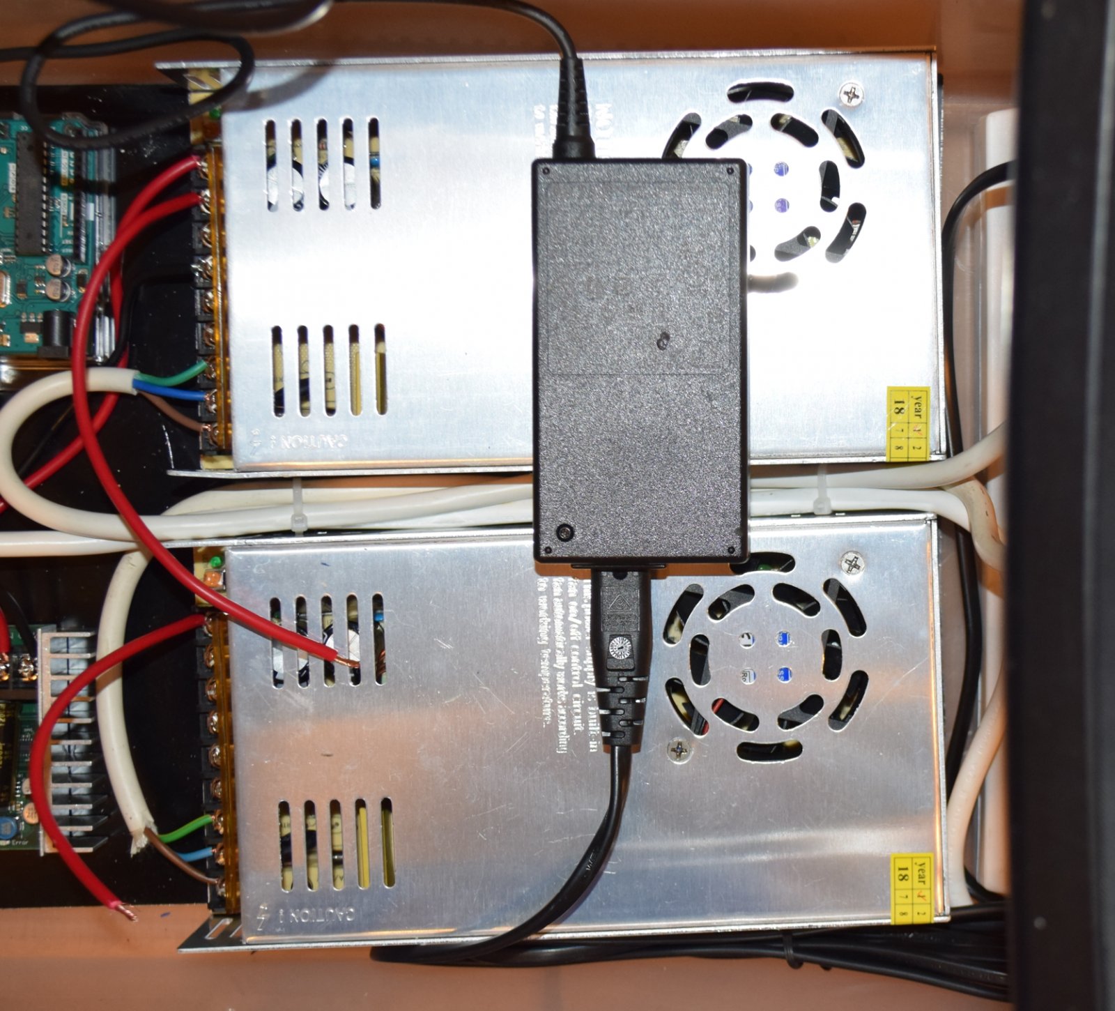

    I have another Sabertooth question that is beyond my electrical knowledge of 1%.
    Naturally I am driving two https://www.motiondynamics.com.au/worm-drive-motor-12v-24v-200w-180-rpm-20nm-torque.html from the Sabertooth and have that connected OK
    but question is how do I wiring my two separate 12V 30A 360W power supplies to the one Sabertooth input.
    I know it says not go over 30 V DC which I will be safe with but it is the in series or parallel wiring config that baffles me and I am scared that I will end up frying a very expensive board
    through my own ignorance, so if you can guide me on how-to to do it without magic smoke appearing I would be most grateful.
    Thanks.
    I hope the pics shows what I am attempting by having a separate power supply for each motor whether that is sensible or overkill I don't know.
  19. BlazinH
    BlazinH Well-Known Member
    Oct 19, 2013
    2,145
    Oklahoma City, USA
    16,664Coins
    +1,839 / 32 / -1
    Starting out I recommend you use one power supply and a 12v lawnmower type or larger battery in parallel (+ to + and - to -). This keeps things simple and serves the best changes of success until you can see if your diy rig is going to work as you planed it to. You can attempt to use multiple power supplies and/or remove the battery later if you still wish to. When your not using the rig though be sure to turn off the power supply when using a battery so you don't overcharge it which is dangerous.
