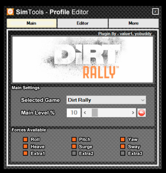

    A super quick way to setup profiles, if you are impatient or just want to test a plugin....
    In GAME MANAGER, set your MAIN profile down to 10%
    (Click Profile manager, set MAIN LEVEL to 10%)

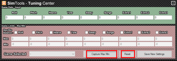

    Fire up your game of choice...
    Then open up TUNING CENTRE (Right click GAME ENGINE)
    UNTICK all the MAX/MIN Balance boxes.
    CLICK on CAPTURE MAX MIN and then hit RESET to put all the values to ZERO.
    CLICK "Save New Settings", then STOP the CAPTURE.
    Once in the game, RESTART the CAPTURE and go for a drive, mount the kerb a few times, brake hard, accelerate, sway from side to side...
    Click SAVE NEW SETTINGS again and then STOP the CAPTURE. (Click SAVE before the STOP... this always catches me out!!)
    This will give you the MAX and MIN of each force / axis as a good starting point and you can tune them from here.
    Only use this method if you have already set the direction of your AXIS as it will not feel right otherwise.
    IMPORTANT: Ensure MAIN LEVEL is 10% or LOWER, or you will shake your SIM to pieces when the MAX MIN level on Tuning is at Zero.
