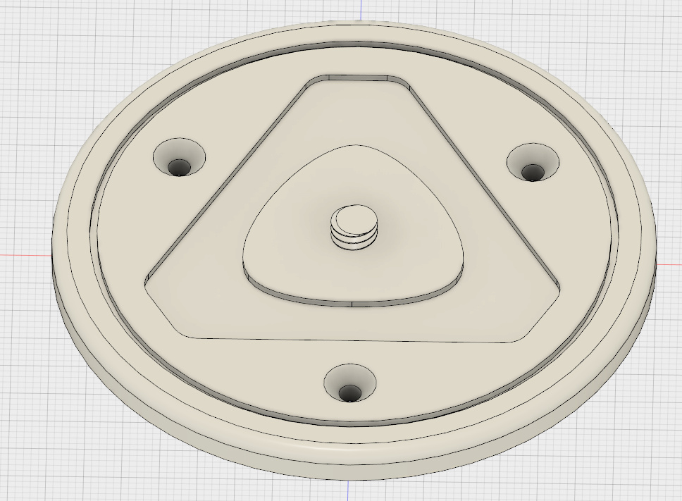

    Here is the mount - it's still printing but shouldn't be long now:
    The .stl file is attached if anyone wants to print their own. Another version for pan head screws here: https://www.xsimulator.net/communit...-vive-and-vive-tracker-a-tracker-mount.10346/
    Info on the Vive Tracker is available here: https://www.vive.com/us/vive-tracker/ It's basically just another tracked item. It's not available yet in the HTC store for regular users, but you can buy them in the developer section for $99. The price may be lower for consumers but no word yet if that will be the case. https://www.vive.com/us/vive-tracker-for-developer/
