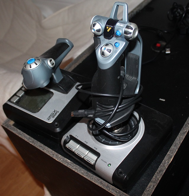

    I was lucky enough to find those in a pawn shop. Now, if I could do the same with a driving wheel and some pedals.

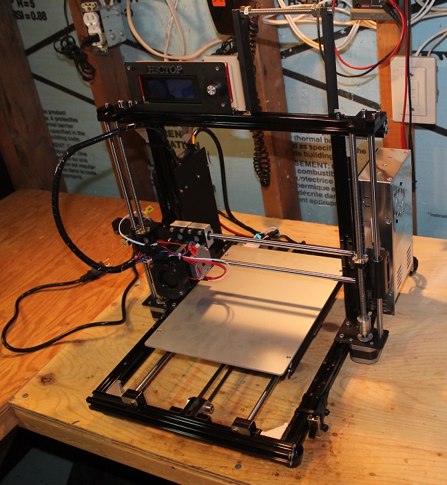

    Because, any build now would be hard without it, my 3D Printer:
    HICTOP Auto Leveling Desktop 3D Printer Prusa I3 DIY Kit Self-assembly 10.6" x 7.9" x 7.7" Printing Size
    1.75mm Black PLA 3D Printer Filament - 1kg Spool (2.2 lbs) - Dimensional Accuracy +/- 0.03mm
    1.75mm White PLA 3D Printer Filament - 1kg Spool (2.2 lbs) - Dimensional Accuracy +/- 0.03mm
    WEONE Silver Metal GT2 Timing Belt Tensioner Torsion Spring For 3D Printer RepRa 6mm Width Belt Pack of 10
    514.28 + 12.59 = 526.87 CAD

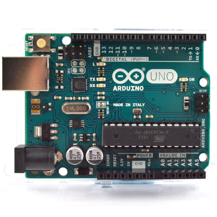

    I'll be using 3 arduino's. So far, I had already one and it is sufficient for testing. They are about 30 Canadian Dollars (CAD) each.

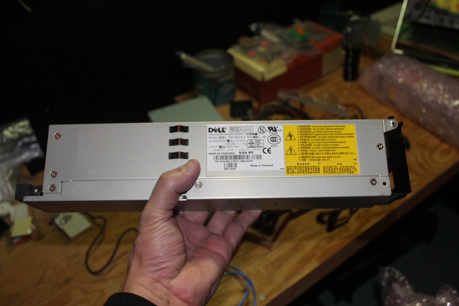

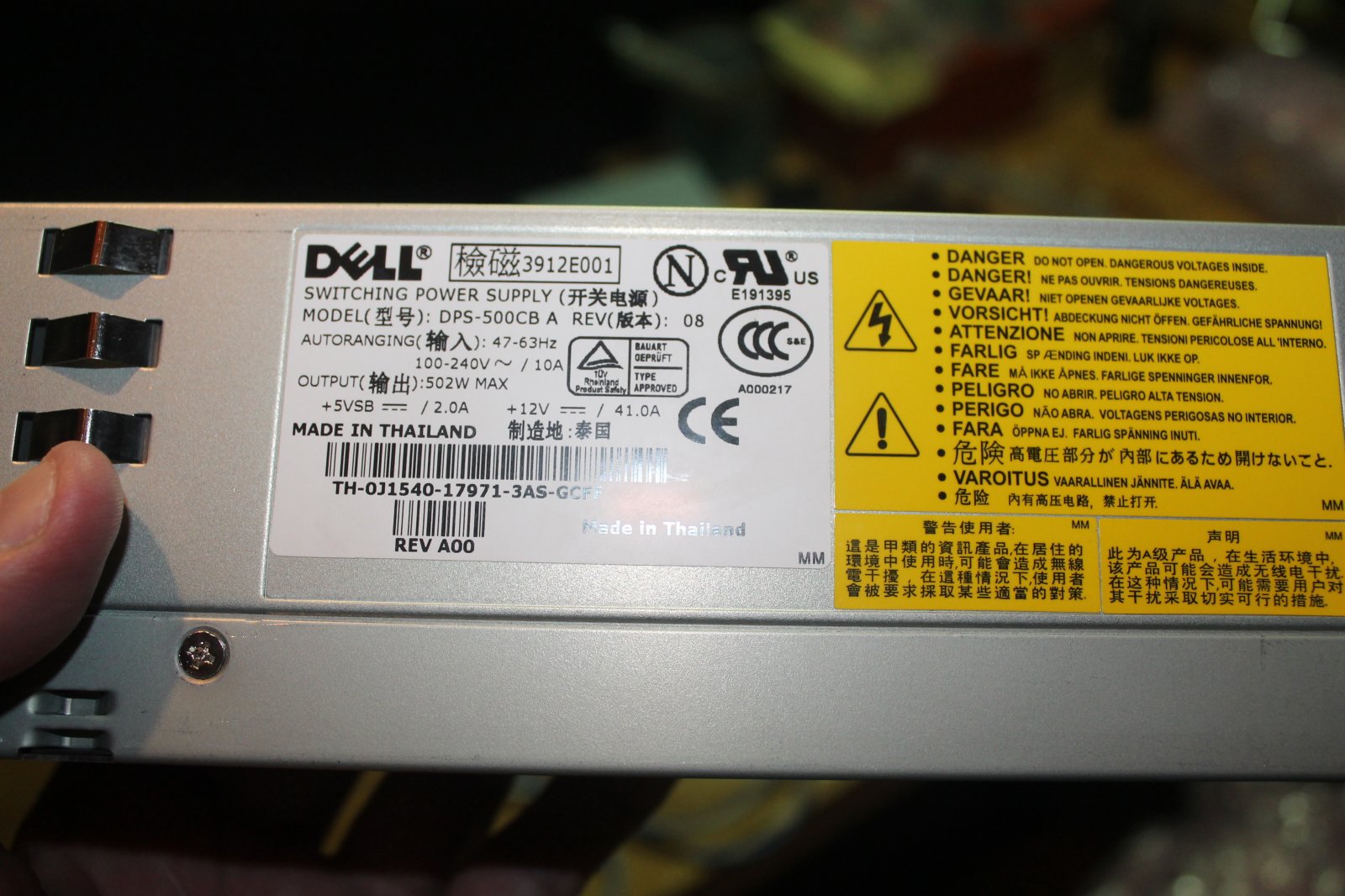

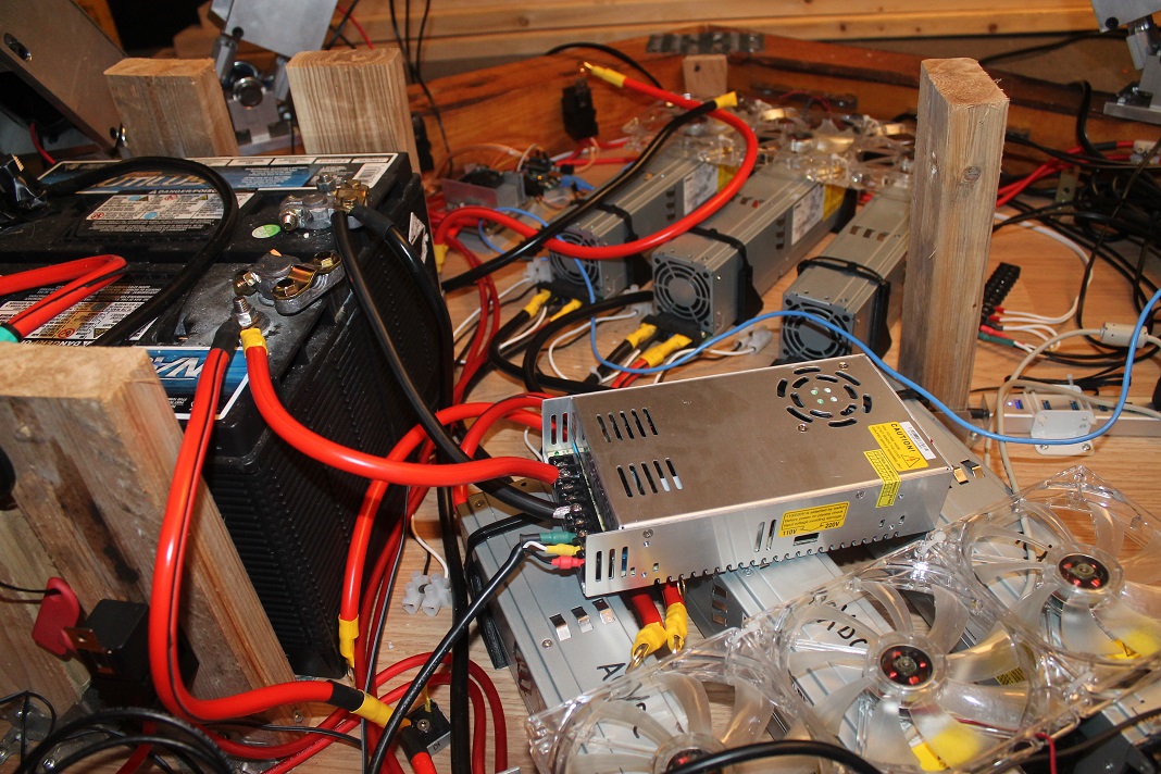

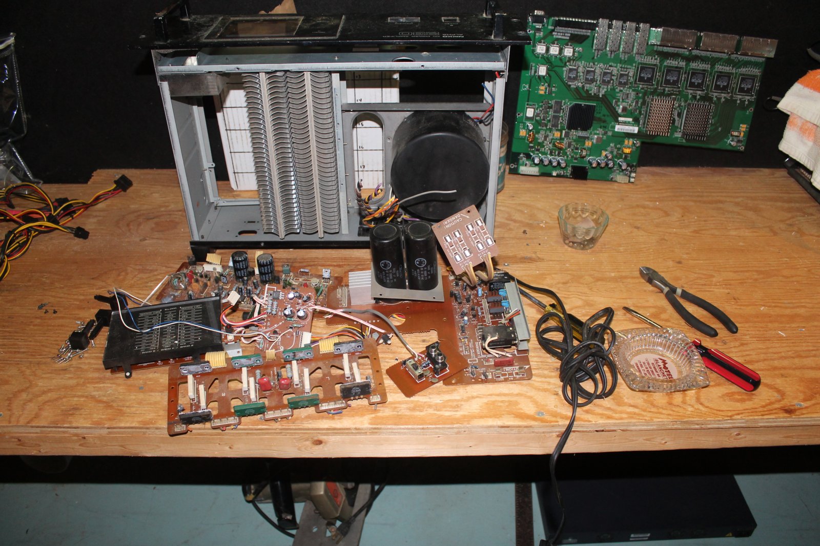

    I was using power Dell server at first: DO NOT USED THOSE!!!!!!!!! They trip way too easily. You're likely to get into troubles. Use DEL power supply instead. Yes, they are more expensive, but they can take the beating!
    Next, the power. Dell server power supply. I know, the order and the real thing are not the same, but they are the same.

    USE THESE INSTEAD: LED PSU! For me, they were 24v / 12.5 Amp. I used 3 of them in parallele and all is good so far. They cost me 70$ CAD each at a local supplier.

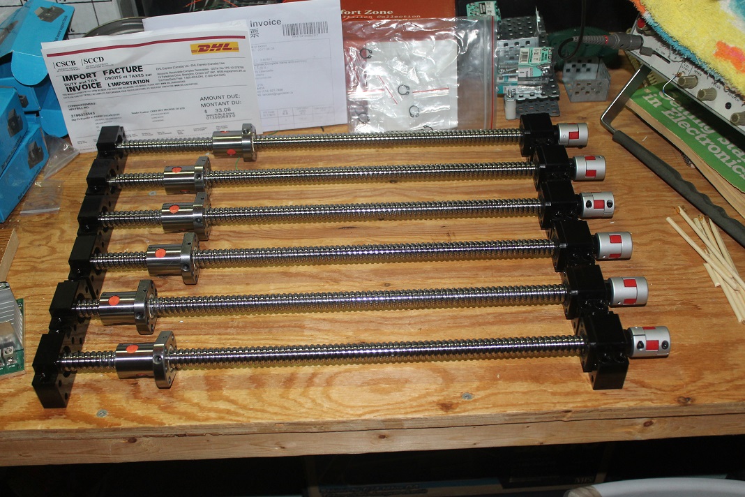

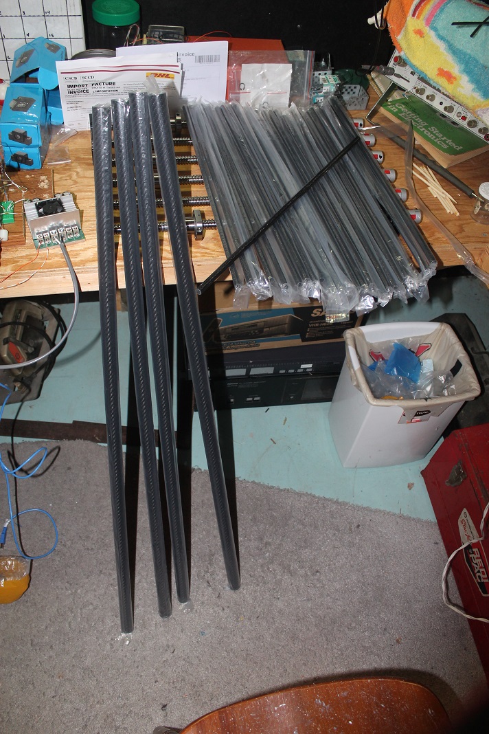

    Le plat de resistance, the 500mm 1605 ball screws:
    This listing was ended by the seller because there was an error in the listing.
    Alternative:
    https://www.ebay.com/itm/Ball-Screw-1605-L500mm-Lead-Rod-Machined-Shaft-Coupling-BF12-BK12-End-Support/221969458155?_trkparms=aid=555018&algo=PL.SIM&ao=2&asc=49566&meid=4650458010944ea6a8babb7f0c2c6ec4&pid=100012&rk=4&rkt=4&mehot=ag&sd=311721599218&_trksid=p2047675.c100012.m1985
    CNC Antibacklash Ball Screw SFU1605 500mm + BK/BF12 Bearing Block Shaft Couplers
    Item# 311721599218 $45.02 USD 6 $270.12 USD
    Shipping and handling $1.49 USD
    Insurance - not offered ----
    Total $271.61 USD
    Payment $271.61 USD
    This charge will appear on your credit card statement as "PAYPAL *HONGKONGYEE"
    From amount $375.02 CAD
    To amount $271.61 USD
    Exchange rate: 1 CAD = 0.724258 USD
    I added a new one after I disassemble one of my ball screw for $38.30 CAD.
    1 DHL Duties, Taxes and Fees for your delivery.
    Total CAD 33.08 (added to bill)
    Now, Carbon tubing for the structure of 6 500mm actuators. 24 10-8mm (500mm) and 4 25-23mm (1M):

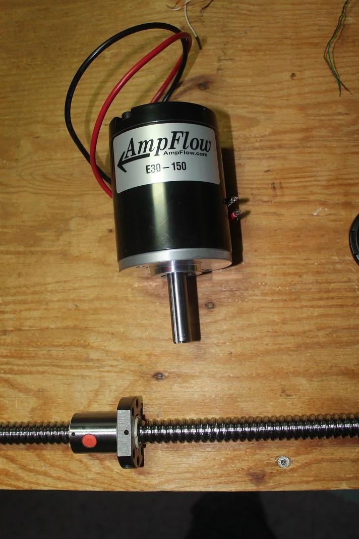

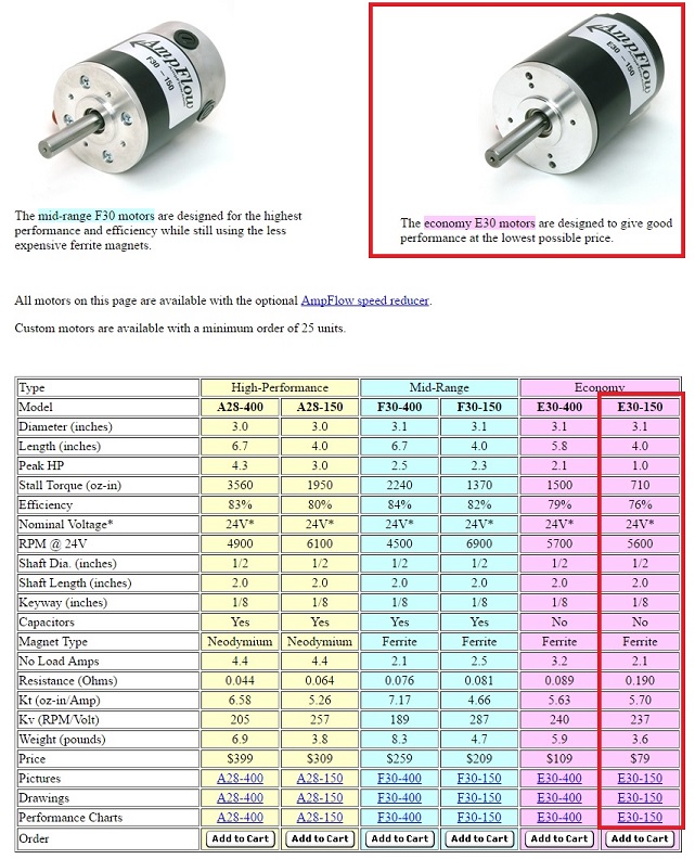

    Another big chunk, the motors:
    I was unable to set the link here. Replace Amazon Site by you know what...
    "Amazon Site"/AmpFlow-E30-150-Brushed-Electric-Motor/dp/B009YJOD56
    Description Unit price Qty Amount
    E30-150
    Item# E30-150 $79.00 USD 6 $474.00 USD
    Subtotal $474.00 USD
    Shipping and handling $97.99 USD
    Total $571.99 USD
    Payment $571.99 USD
    Charge will appear on your credit card statement as "PAYPAL *POWERHOUSE"
    From amount $796.90 CAD
    To amount $571.99 USD
    Exchange rate: 1 CAD = 0.717776 USD

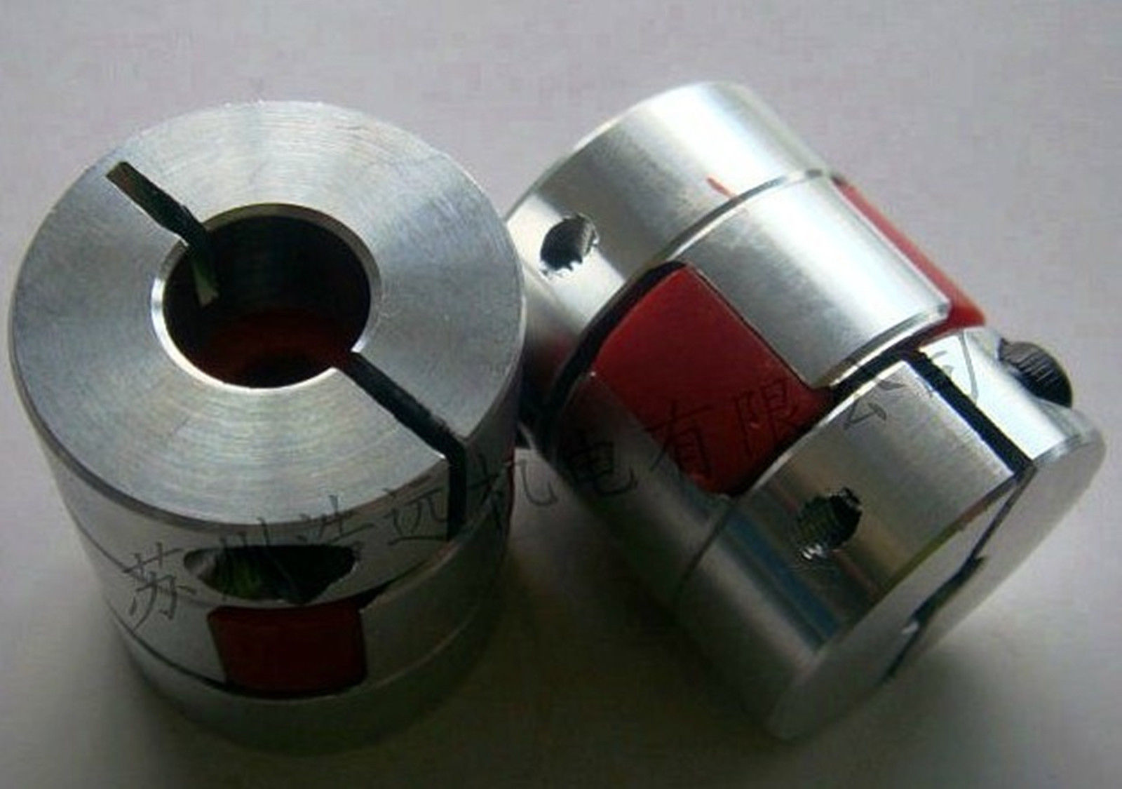

    Some couplers to attache those motors to the ball screws:

    BF 10mm x 12.7mm CNC Flexible Plum Coupling Shaft Coupler D30 L42
    Item# 121001743936 $9.31 USD 6 $55.86 USD
    Shipping and handling $0.00 USD
    Total $55.86 USD
    Payment $55.86 USD
    This charge will appear on your credit card statement as "PAYPAL *LINXIAOYONG"

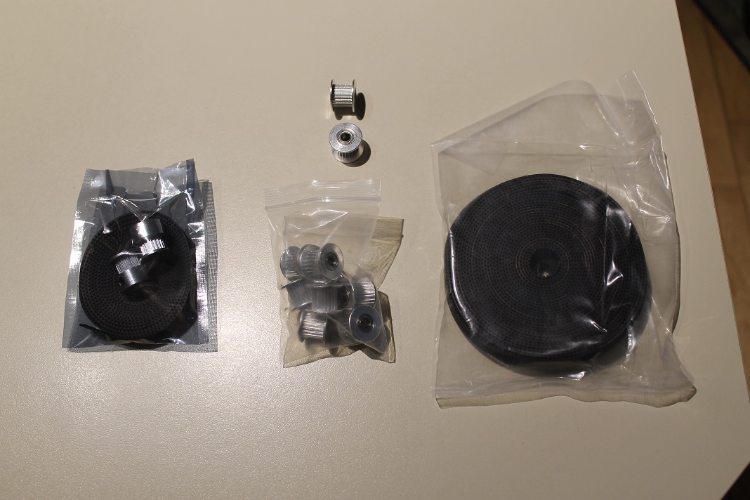

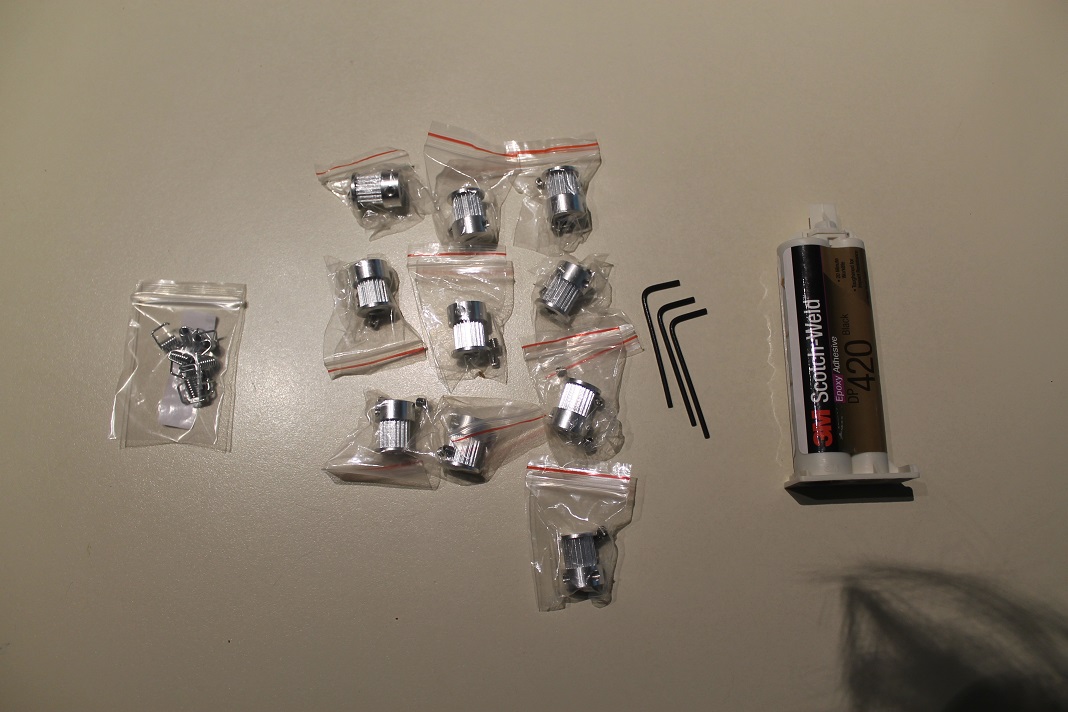

    10Pcs/Lot GT2 20 Teeth Timing Pulley Alumium Bore 8/6.35mm Teeth width 11mm for10mm GT2 Timing Belt and 3D Printer Stepper Motor
    https://www.aliexpress.com/item/GT2...11mm-for-GT2-timing-belt-and/32734625032.html
    $16.90 CAD
    1 Piece 3M Scotch-Weld Epoxy Adhesive DP420 DuoPak 1.25 fl oz #V03-A
    Not available anymore. Alternative:
    https://www.ebay.com/itm/1-Piece-3M...233848?hash=item2a9482e978:g:W3gAAMXQpPhTknxp
    $34.86 CAD

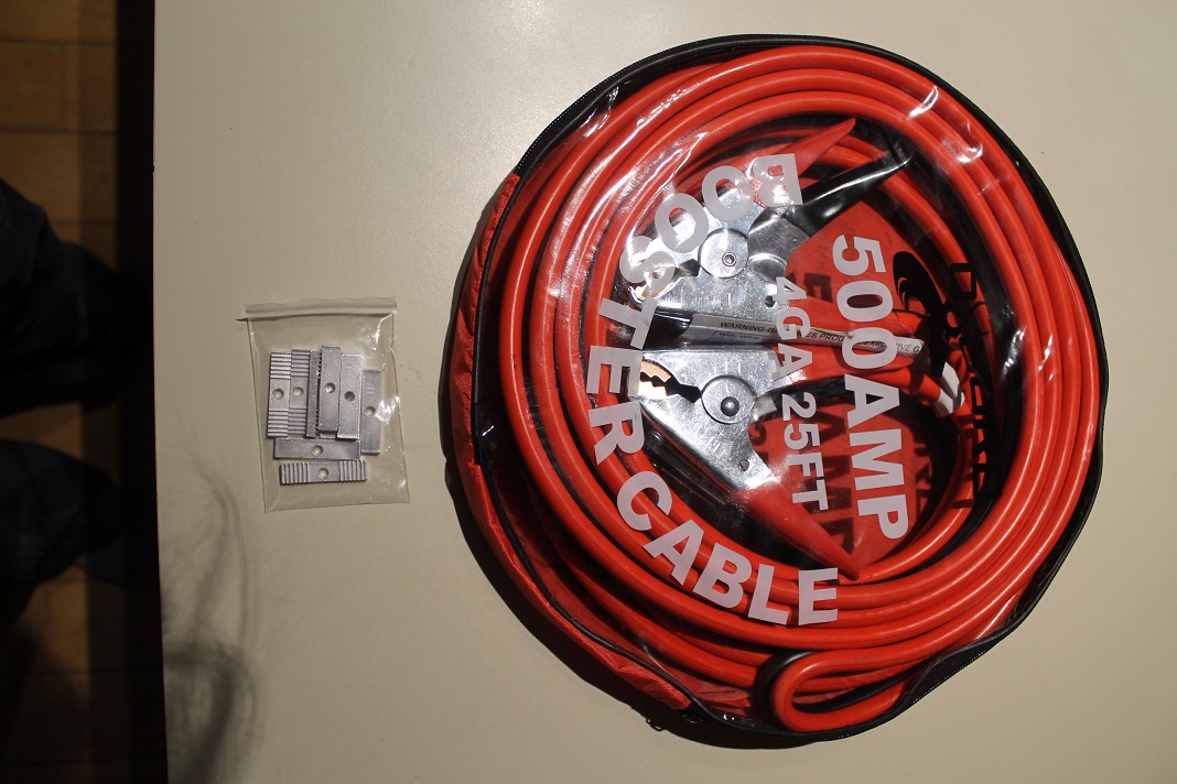

    OxGord 4 Gauge 500 Amp Extra Long 25 Feet Heavy Duty Super Power Booster Starter Commercial Grade Jumper Cables for Emergency Use Auto Battery Starting Industrial Jumping - 2015 Non Tangle Newest Technology with Travel Car Carry Case Bag
    $38.95 CAD
    High quality 10Meters GT2 Timing belt 2GT 9MM Width 9mm rubber GT2 9MM open belt for 3D Printer Free shipping

    5pcs 2GT 20 tooth Idle pulley 20 teeth 20tooth timing Gear Bore 5mm for GT2 belt width 10MM with wheel
    https://www.aliexpress.com/item/5pc...20tooth-timing-Gear-Bore-5mm/32583477241.html

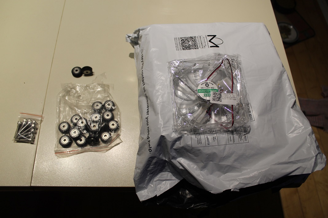

    10pcs CNC Openbuilds Plastic wheel POM with Bearings W type double V type W groove V groove passive wheel pulley for V-slot
    https://www.aliexpress.com/item/10p...e-extrusion-Holder-work-with/32620078515.html
    2 x 11.38 = 22.76 (USD) about $31.70 CAD
    Hot-sale BINMER 120 x 120 x 25mm 4 Pin Computer Fan Colorful Quad 4-LED Light Neon Clear 120mm PC Computer Case Cooling Fan Mod
    https://www.aliexpress.com/item/Hot...uter-Fan-Colorful-Quad-4-LED/32704158261.html
    20 x 2.07 = 41.40 + 6.95 (shipping) = 48.35 (USD) about $67.36 CAD

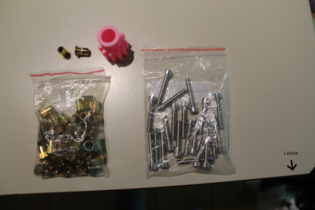

    10pcs M6*30 A2 Stainless Steel Screws Hexagon Cap Head Socket Allen Key Bolt
    $5.27 CAD
    40mm Long M6x35mm Stainless Steel Hex Head Socket Cap Screws 20pcs
    $10.65 CAD
    uxcell® 50 Pcs Zinc Plated Carbon Steel Rivet Nut Flat Head Insert Nutsert M6x15
    $8.62 CAD

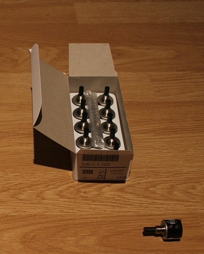

    VISHAY 536-1-1-103 Rotary Potentiometer, Wirewound, 10 kohm, 2 W, ± 5%, 536 Series, 10 Turns, Linear
    10 x 16.26 = $162.60 CAD

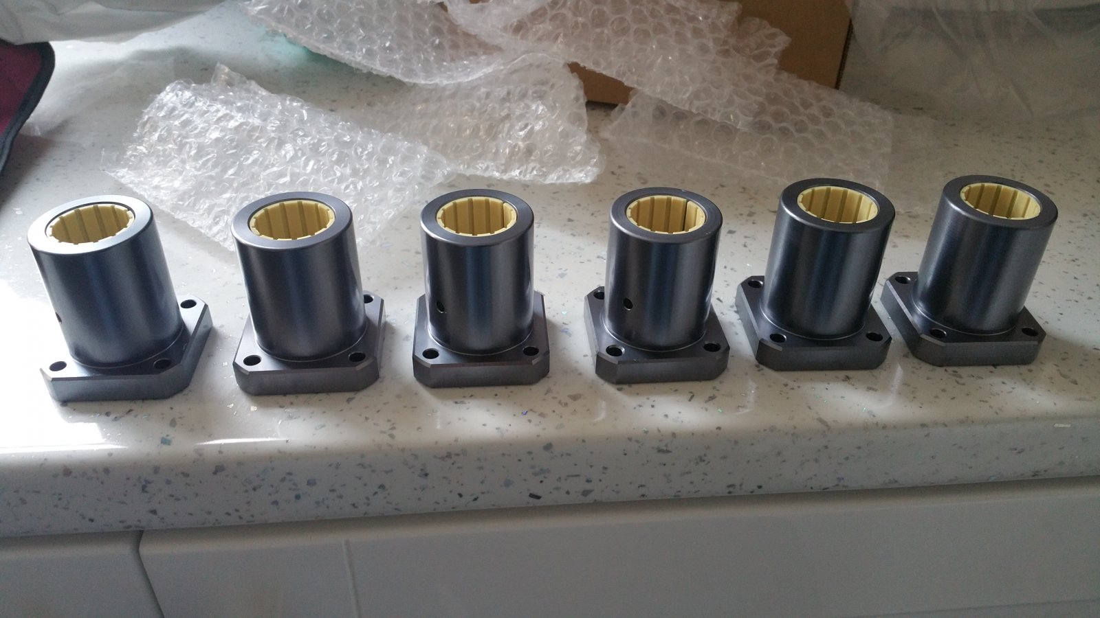

    The actuators end bushing are under quote and should be around three hundred dollars for 5 pieces. I got one as a sample. Will have to order them soon if I want this to be done:
    https://www.igus.com/wpck/3644/drylin_r_fjum_02?C=US&L=en

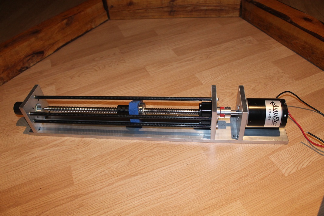

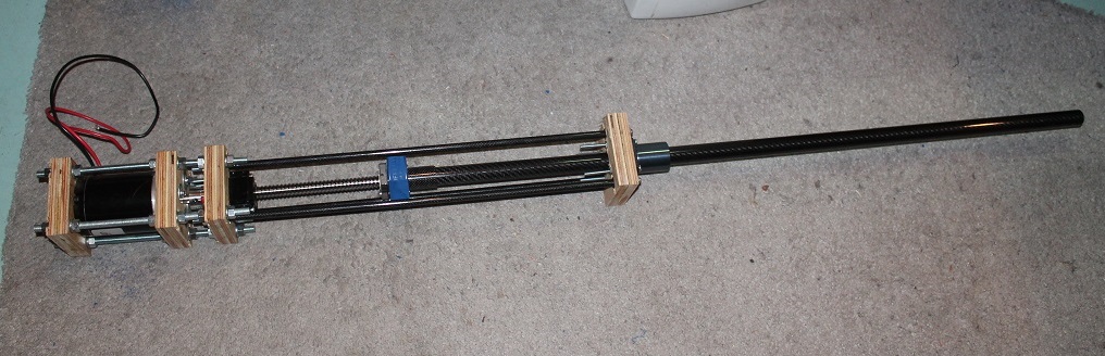

    A friend that has all the numeric machinery to do metal work design me a better actuator from my wood prototype. I costed me 350 CAD for the aluminum parts, and 400 CAD for the work, which add $750 CAD.

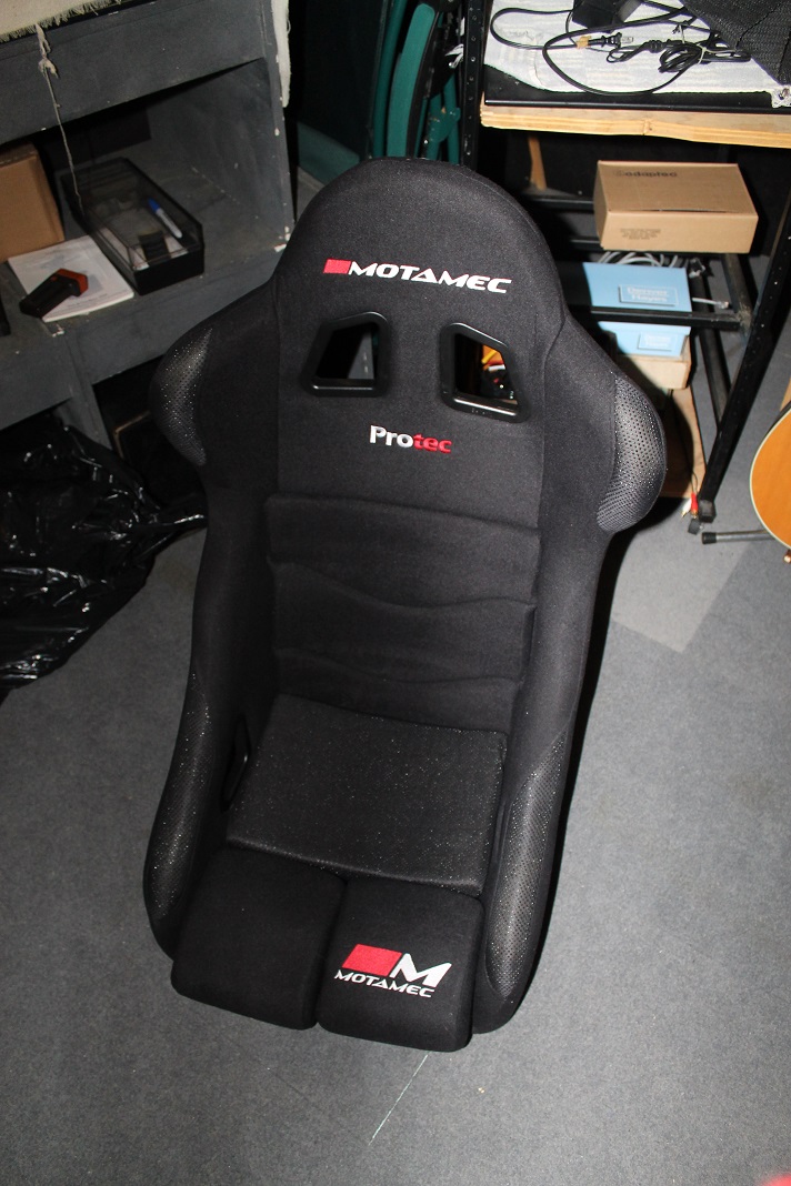

    I have explain in great details why I bought that seat:
    6 DOF from scratch
    $413.99 CAD

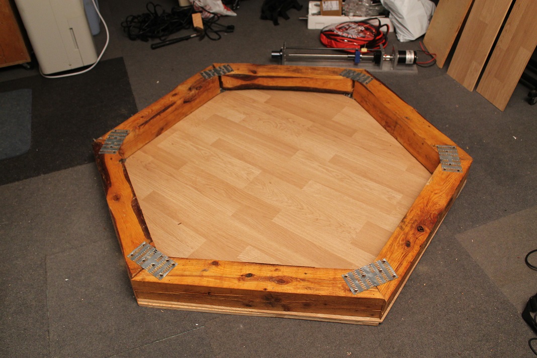

    For the base, I was lucky. My brother had 4 x 4 stud and provide them to me. The floor was a left over and all I needed was a plywood sheet $36 CAD.

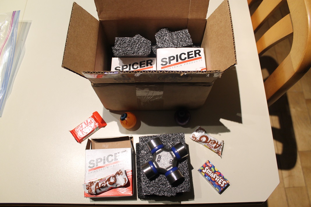

    I still don't know how I will attache those Actuator the the base, but those 'Spicers' will be part of the jonction.

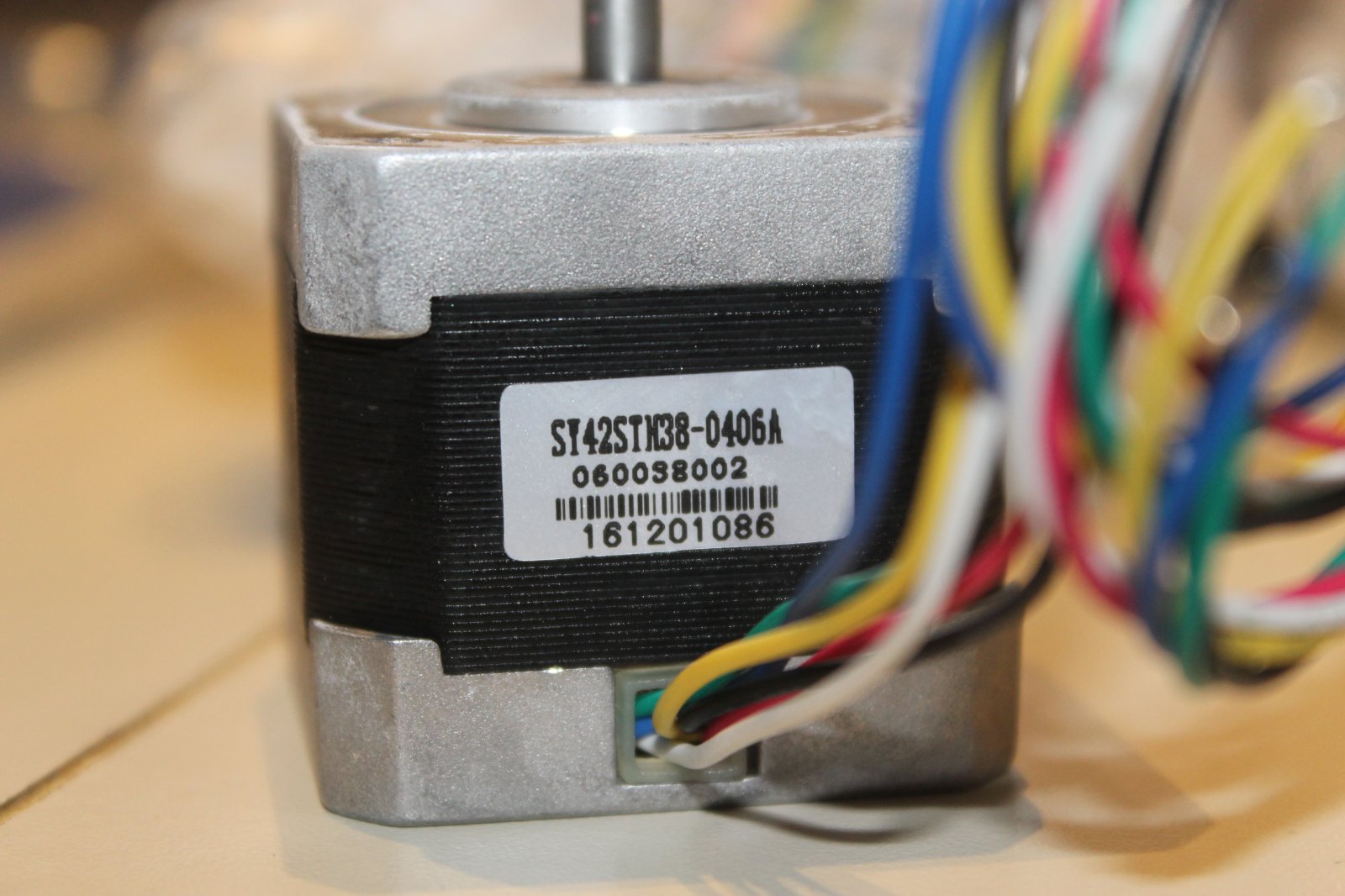

    Even though I read as much as I can on the forum, I already made my first mistake by buying stepper motor for testing:
    12V 0.4A 36oz-in Unipolar Stepper Motor
    Now, it look like brushless DC motor are taking over. Oh, well. Better not get discouraged by first of many mistakes. Like I wrote somewhere else, it is not the worst mistake of all, as they are nice little motors that will help me understand the connections with the drivers/plugins/softwares needed to make a simulator move. I will probably recycle them for other little projects later.

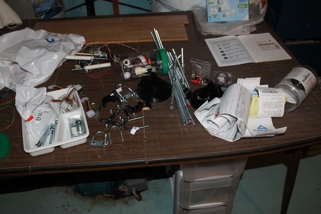

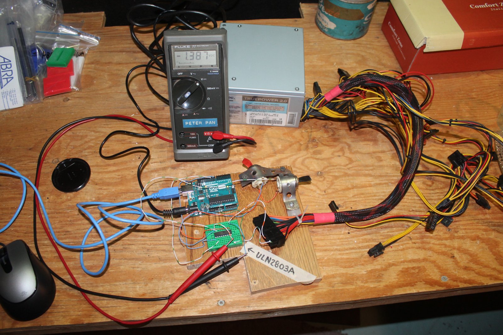

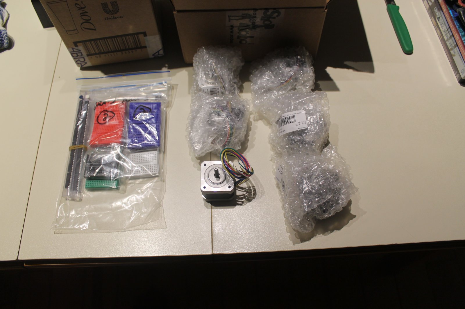

    It seems to be a tradition to take pictures when we receive parts we ordered. I guess it is a nice way to share the pure excitement we always have when we open those little boxes, like a kid the morning of Christmas.
    My little stepper motors and some ULN2803A to control them. I've never used those. I saw them on a youtube video and they look like a nice choice. Some little proto boards. Its been so long since I have done pure electronics.
    Motor.
    I started cleaning up my workbench. It looked more like a storage place. After some clean up, I started demolition. I had this old music amplifier with burned part. It was time for it to be taken apart. With about 6 type of screw, it reminded me how electronics was design at the time. Most of it will end up in the trash, but it is a nice case, a big heat sink and some serious capacitor. Also, when you get warnings about 8 amp, you know that the power supply can drive most of your electronics project. At the right, it is the board of a internet switcher, that you can see the nice case under the bench. Far left, some wires of a computer power supply. It could come handy one day.

    Really? A simple computer power supply to drive motors. Even with a car battery or an array of capacitor for back up current, I find this hard to believe. One thing I am sure, I know nothing about DC Motor.

    About my stepper motors:
    LOL. Definitively, I am good at choosing the worst option. Since I've done nothing yet with those motors, let's see what Roboshop may offer me for an exchange. If exchange is possible, this bring the question: "What do I exchange them for?". Other motors? I already have little toys motors laying around. Maybe some "Arduino"? I'm starting to be afraid to take decisions.

    Just finished to read SeatTime build. I wan't to copy some info from his thread to make sure I don't forget them.
    Ball screws are around 90% efficient, worm screws around 65% , tried belts -noisy under load. Direct drive ball screws is a win for me.

    Houston, we have movements.
    I am so close of a finished 6DOF simulator with me on it.
    Okay, maybe not that close. But hey! I am controlling 2 dc motors with my Arduino and a ULN2803A. Powered with the 5v of a computer power supply.
    I used the wiring schema from this page:
    http://newmediaartist.org/index.php/chapter-12/211-maxuinoarduino-motor-drive-with-transistor
    And this tutorial for the Arduino control program:
    Next step, using simTools to control those motors.
    Good news, Roboshop will exchange my stepper motors for a sabbertooth, with no shipping charge. Wait, this is bad new for my wallet... Oh, well.

    mean well make industrial quality PSU's, better than the cheap Chinese knockoffs.
    i swaped to a small 24v one for driving my AMC1280 after having problems getting stable 24v from the chinese ebay copies, but cant you just buy used PC server PSU's like everyone else? much cheaper

  20. Nick Moxley
    17,056Coins
    +2,506 / 30 / -2
    the Dell 2650 PowerEdge units are nice and beefy for a decent price.
