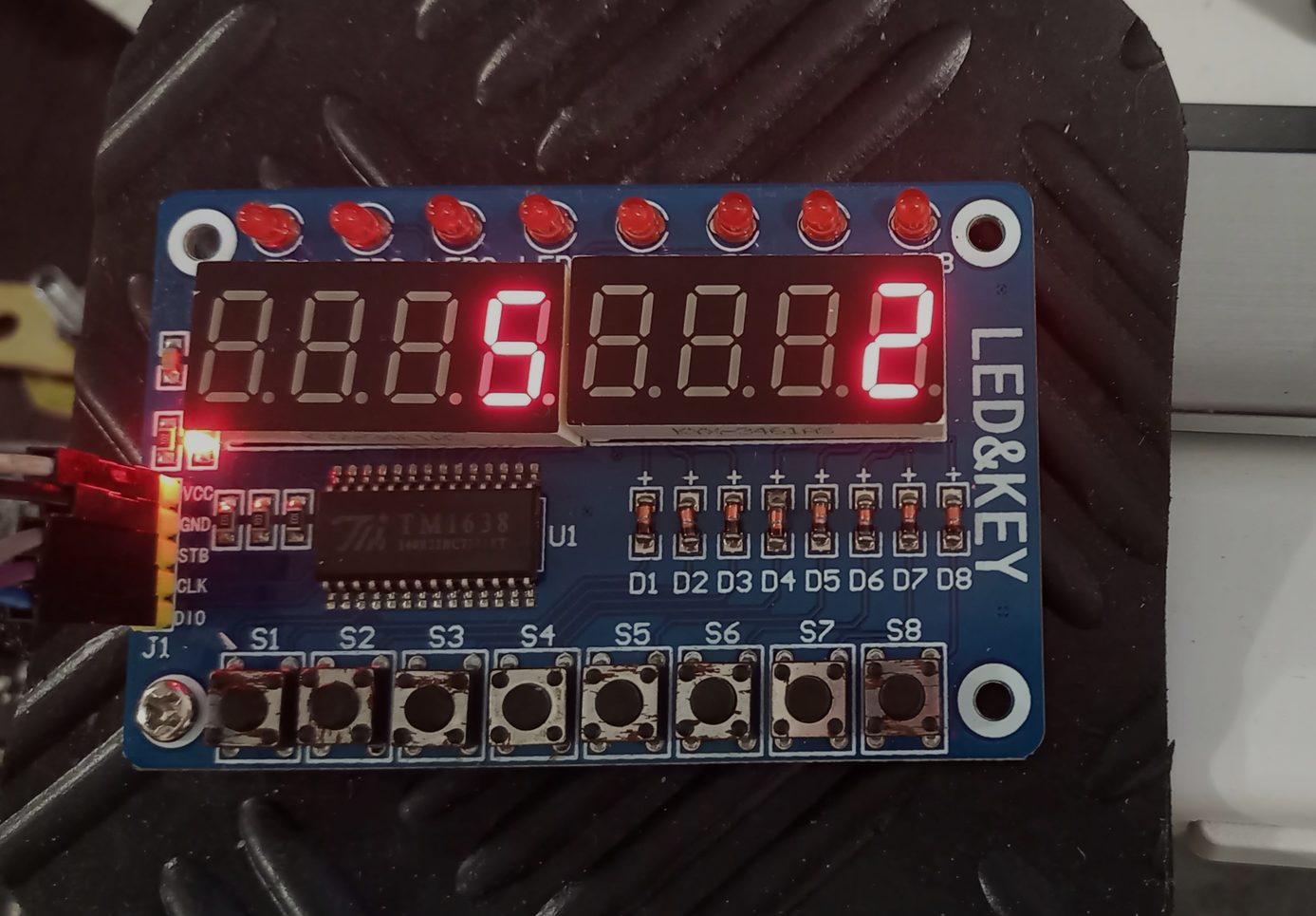

    I connected a TM1638 module to the Arduino UNO where SMC3 is uploaded.
    On the left side of the module (left screen), it shows informations about range1 (SMC3 motor 1), on the right side about range2 (SMC3 motor 2).

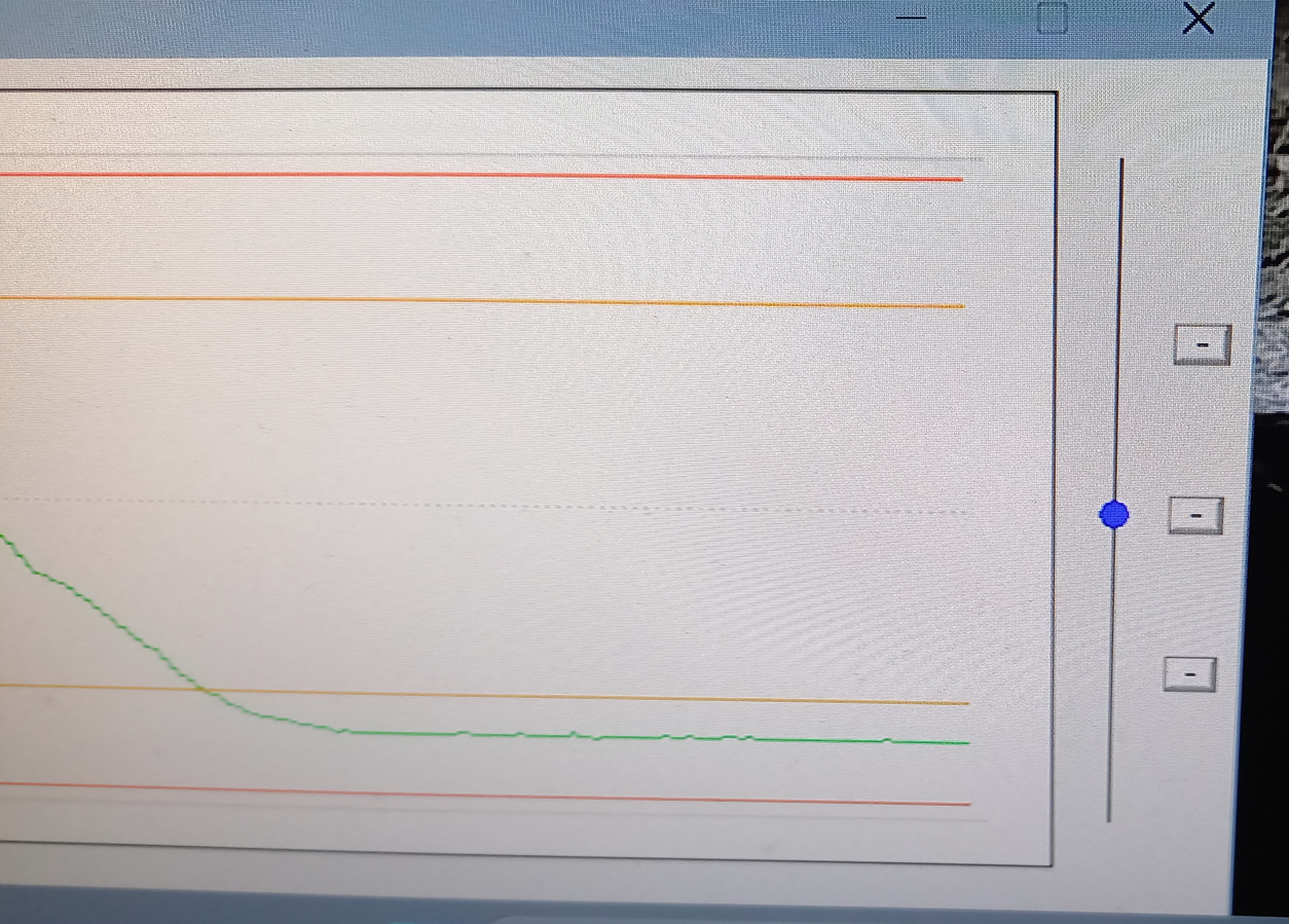

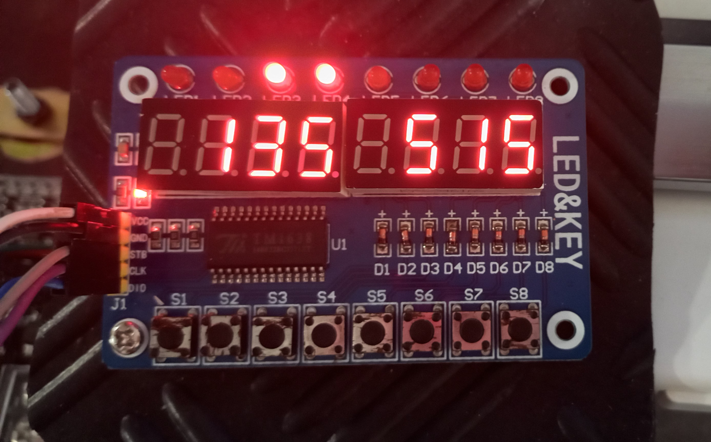

    The leds for each range turn red when inside a clipping zone; the first two when inside the upper:

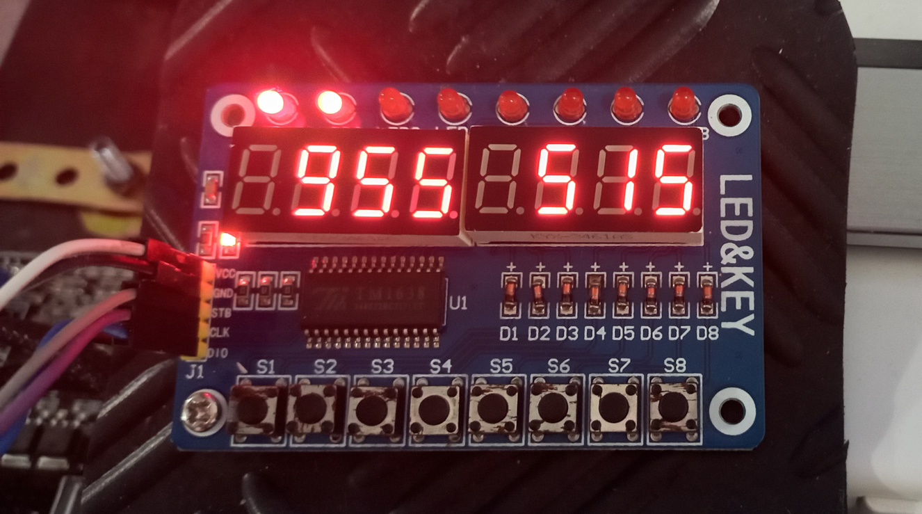

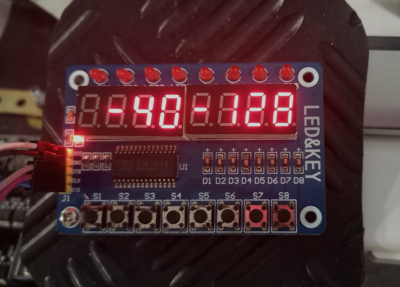

    the second two when inside the lower.

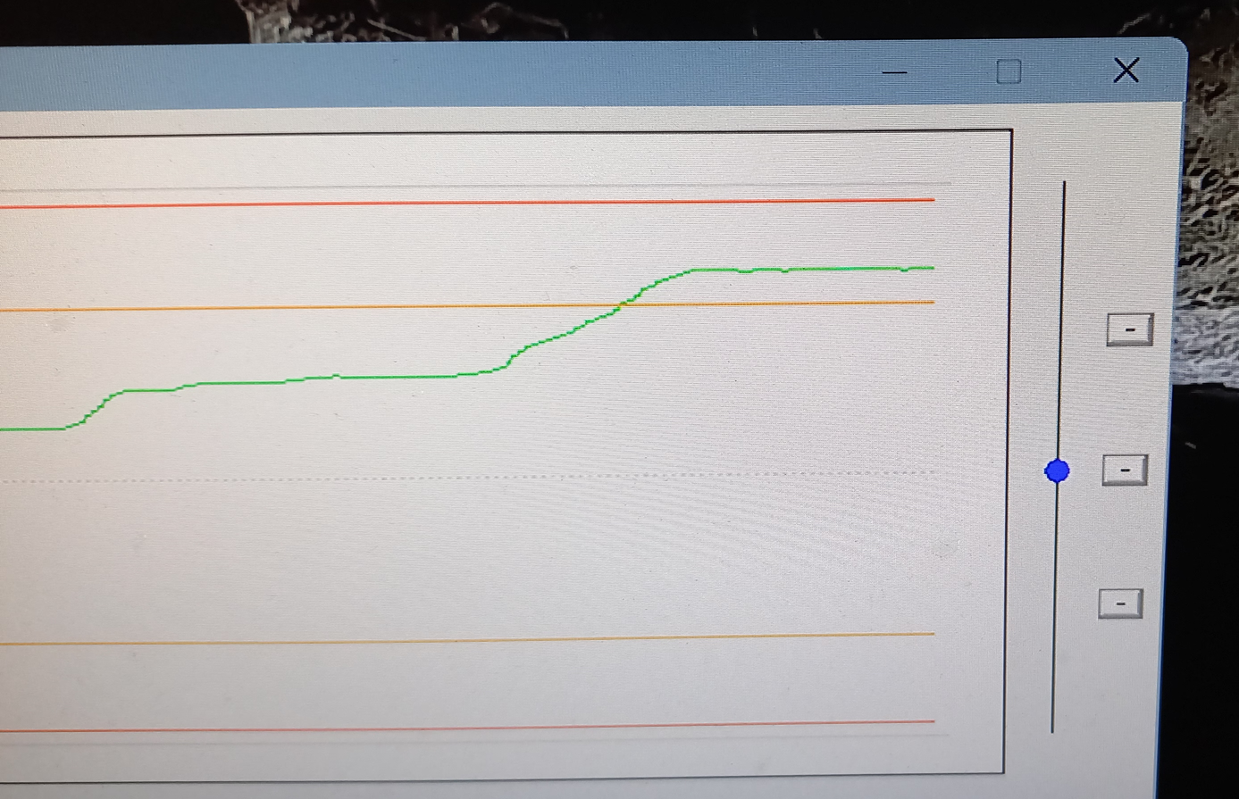

    4. Upper clipping zone reached counter
      • How many times we've entered the upper Clipping Zone
    5. Lower clipping zone reached counter
      • How many times we've entered the lower Clipping Zone
