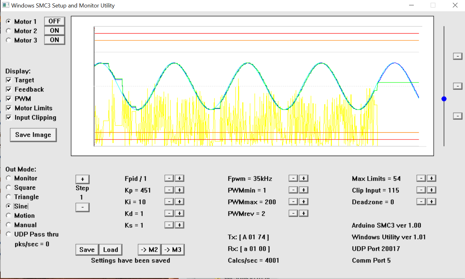

    With these parts I put together a motor test stand to allow me to understand how things work before I invest in real motors:
    I have not been able to get reliable performance with this very simple setup. When I run the sin wave motion generator (or any other motion) the motor will track for 10-15 seconds and then stop tracking. When the tracking stops I can see that the motor is OFF according to SMC3Utils. I cannot turn it back on. If I exit and restart SMC3Utils the motors will come back on momentarily and then stop. Seems like the motor moves to the target position and shuts off. I get the same result with two totally different pots.
    Here is the setup and example of the failure plot with settings:
    Can anyone suggest what I might be doing wrong?

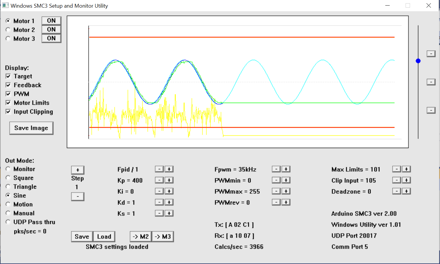

    Good idea to start over. When I got to step 9 I increased the PWMmax and at 60 the motor slowly moved toward the target. When it was almost there it turned off and won't turn back on again. That is I push the OFF and it does not toggle to ON.
    Here is the screen:
    NOTE: The tutorial says to start at Kp = 400.

    I have also seen an additional symptom. With the settings above the motor is still following the input but the position line is light blue. My suspicion is that the incoming communication from the Arduino is no longer working. Since the motor moves in a sin wave it MUST still be receiving the position updates.
    It has been moving for a long time. I have the original Uno not some knock off. I am using a the 1 foot braided cable that comes with the Uno. When I restart SMC3Utils it hangs. Never gets a prompt box like it does when the port is wrong. Totally hangs up. Further evidence the serial port is off line.
    Here is what that looks like:
    So now I am wondering if there is some bizarre grounding issue. The Uno is powered from my computer and the H-bridge is powered from the power supply on the motor side and the Uno power and ground on the signal side.
    Any suggestions?

    I unplugged the H bridge and everything works as expected. These were like 2 for a dollar at Amazon. I replaced it with a different one and it still breaks communication.
    I thought this was the go to H bridge on this forum at present. Its "rated" at 50A so 24V means 120W continuous. Is there an alternative I should consider?
    The power and ground from the Arduino are connected to the power and ground on the H bridge. Is there an alternative way to wire this? Some way to isolate the ground?

    I wired the 3.3v line to the H-bridge (second one) and things work pretty well. It ran for an hour before loosing communications. This is plugged into USB2.0 so there is limited power available. I suspect that is the root cause.
    The motor kept running after the feedback monitoring stopped working. Since the SMC3Utils accommodates this failure mode so nicely I suspect that I am not the only one with the communications problem.
    I am going to investigate tapping off the 24v power supply for 5v supply and using that to power the H-bridge(s). I think as long as I have a common ground that should work. Also, a hefty ground aka wire the grounds to a terminal block and to the Arduino via the outer ring of the barrel connector.

    My conclusion is that I have to be more robust in grounding and powering the external devices. I think with USB 3 you might be OK but with USB 2 it is marginal in terms of current.
    Thanks for all of the inputs.
