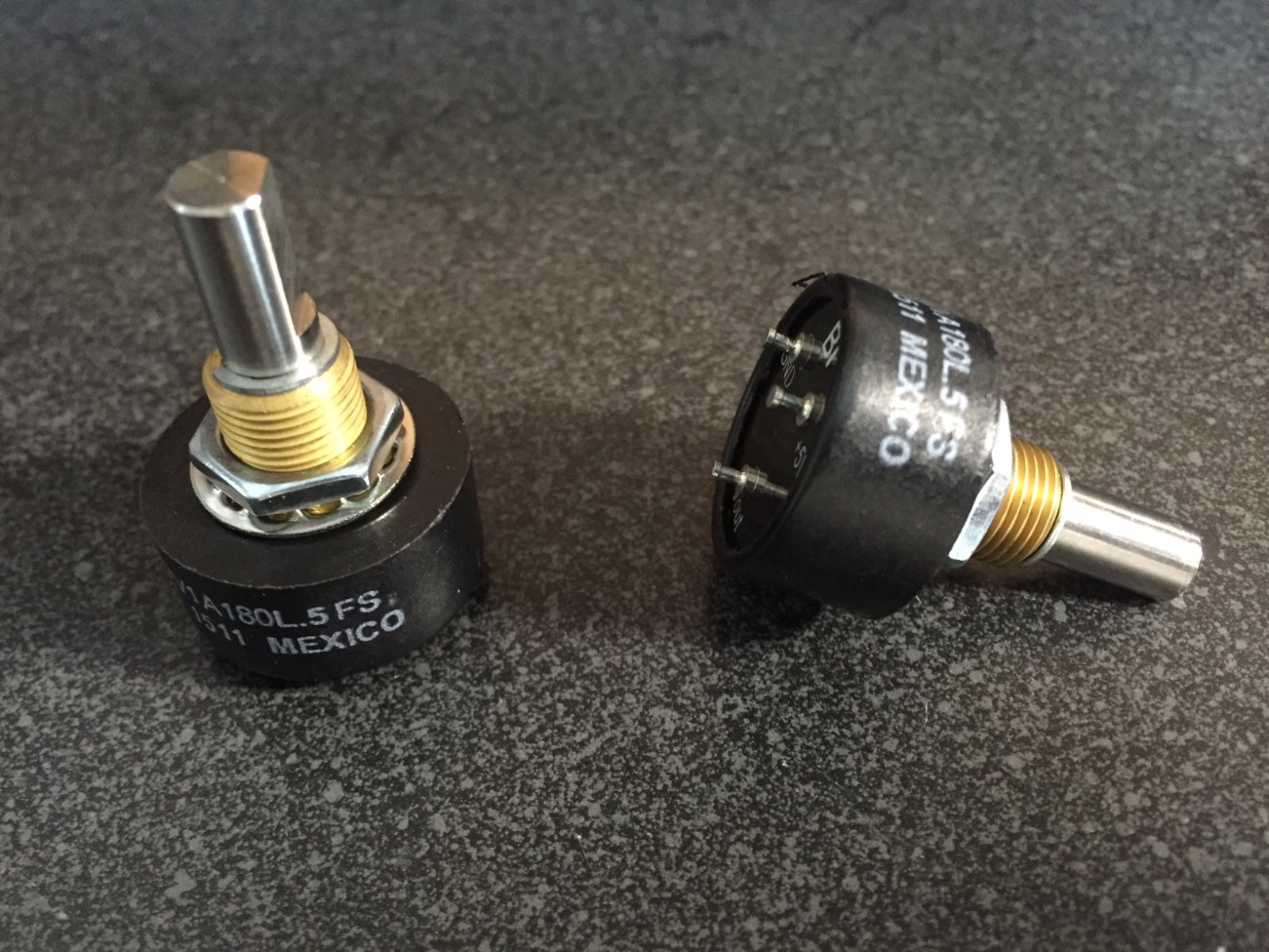

    Yes, go with hall effect pots. In one week both my "conventional" pots "died" after almost a year, and in the last weeks they weren't working well at all, with no precision. The last days you can see the rig moving by itself just turning motors on.
    I bought the TT Electronics 6127V1A180L.5FS too as a replacement.

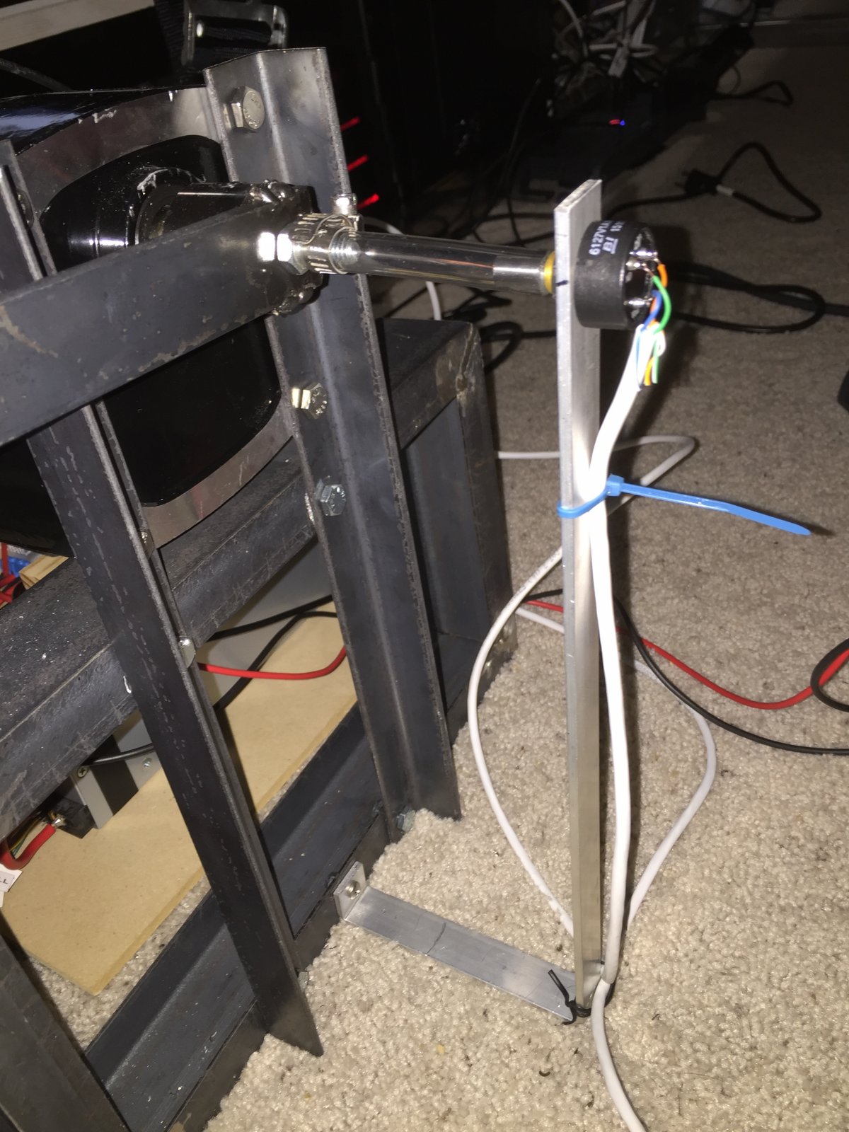

    Halls are MORE Than Durable, Lol I locked one up to a point of needing a LARGE pair of pliers to free it up, Added a drop of oil and its been good ever since. Have no fear, halls are here. :grin
    PS thinking back, I actually locked up the same pot twice, Once i got the Flex coupler's on and a Flexible Pot mount, everything went butter smooth.

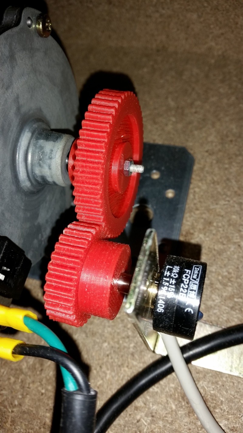

    I've tried and killed a lot of pots, carbon film, cermet, wirewounds. The halls are by far the most reliable and durable. I use the 360's with gear reduction instead of the 180's direct. The only type that was even close to as smooth and accurate was the bourns. The halls also offer a very low resistance to turning which can help reduce oscillation.
