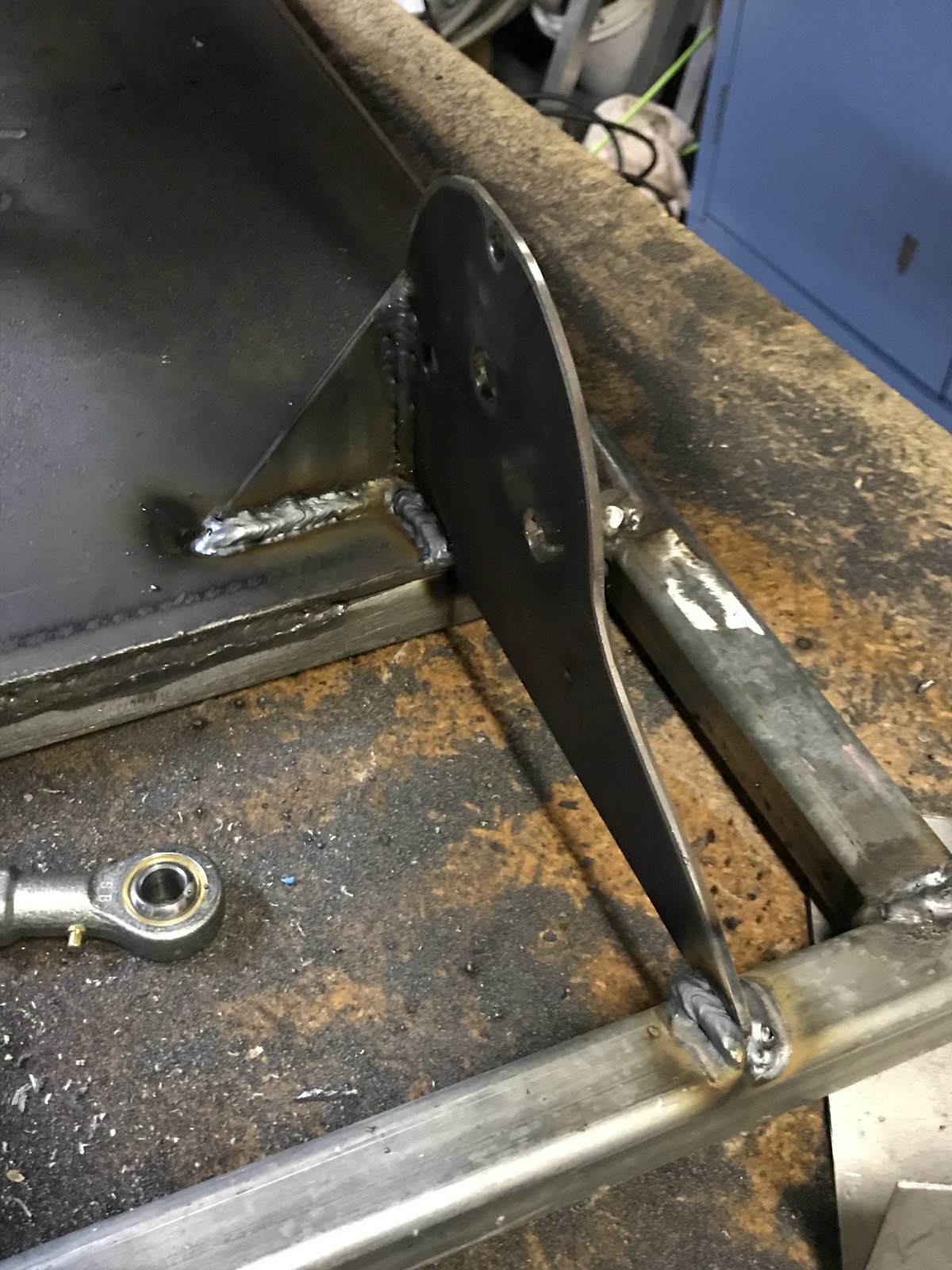

    Can you please explain the thinking and theory behind this? As you can see, things are welded pretty solid so would be a hefty job to achieve this. I'm guessing I have missed something or overlooked something...

    On the physics side a joint on the bottom will put huge stress on the motors as the seat travels through a large arc and the geometry involved is also very problematic in terms of accurate control.
  4. SeatTime
    2,572
    Agree with @noorbeast , I would also add that you have decreased the roll center height, which can feel very unnatural and could cause nausea. Ie. Like driving your car with your seat near the roof.

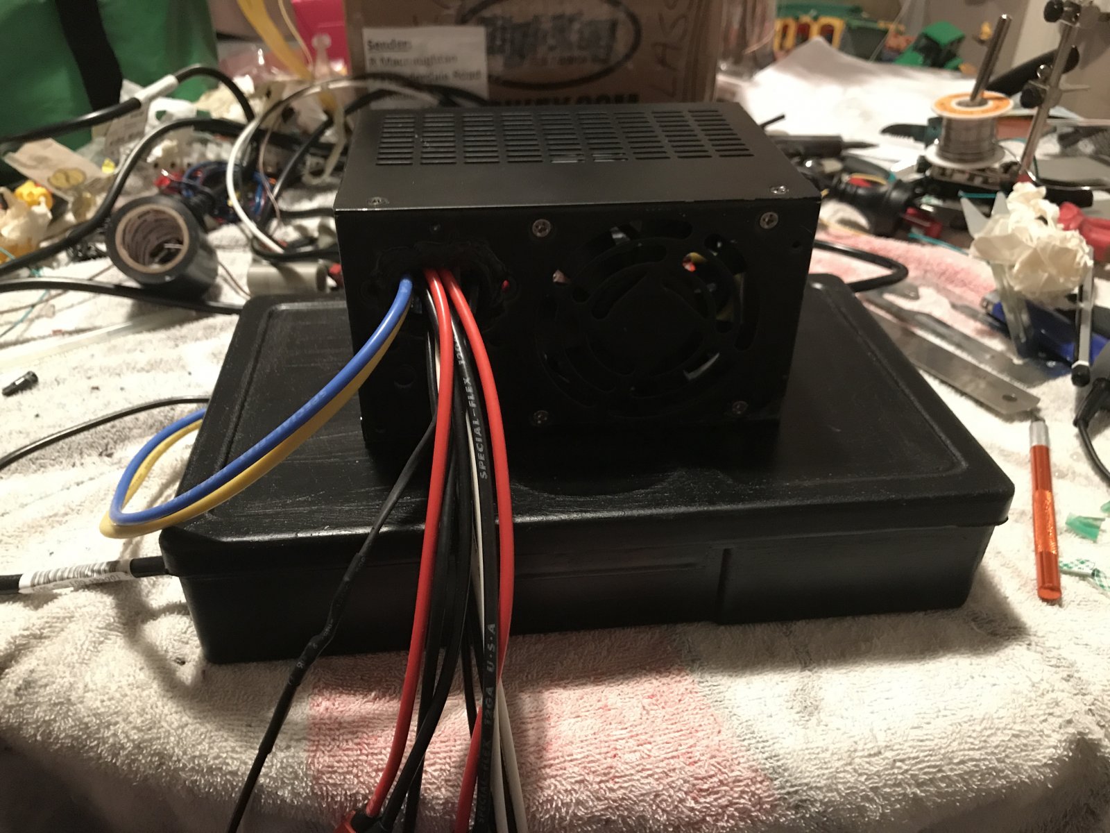

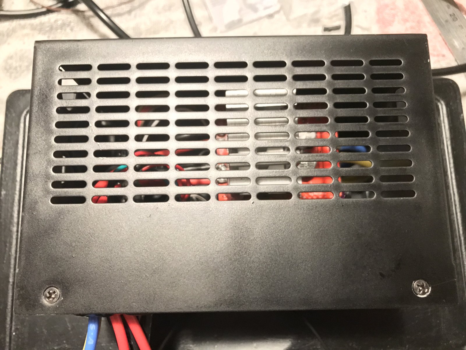

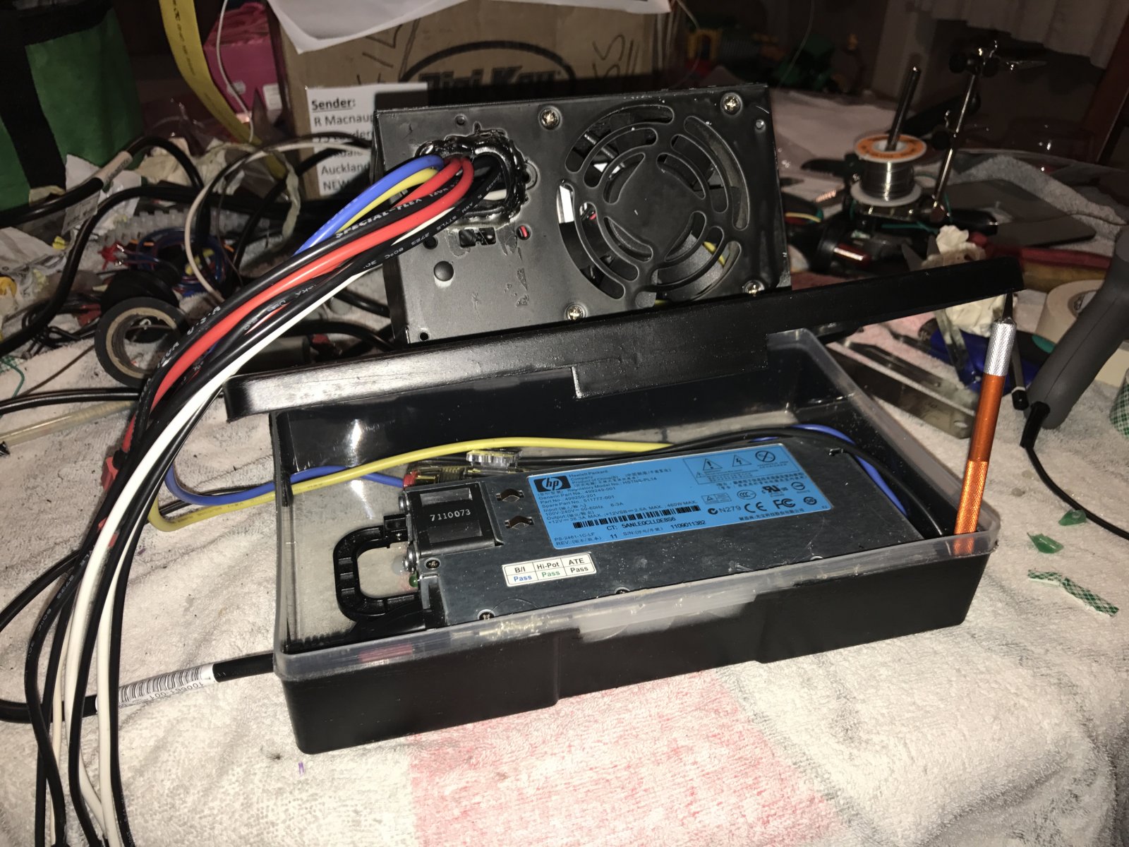

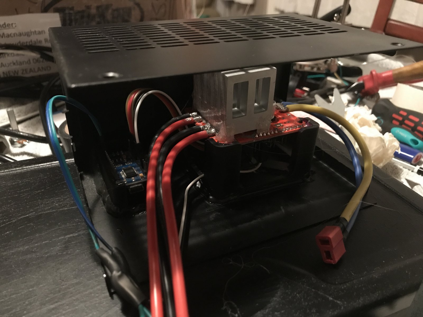

    I am getting closer and closer to wiggle time!

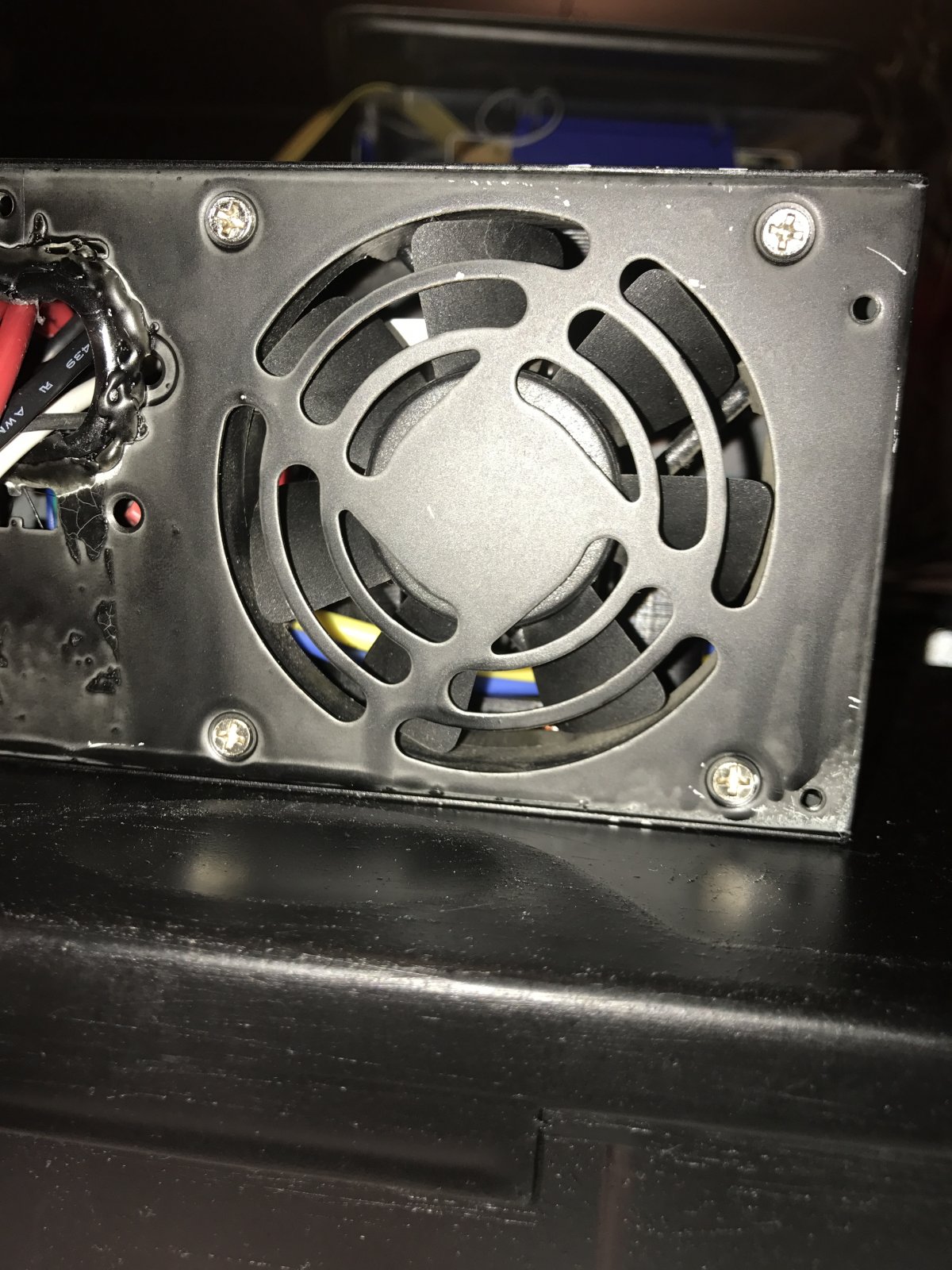

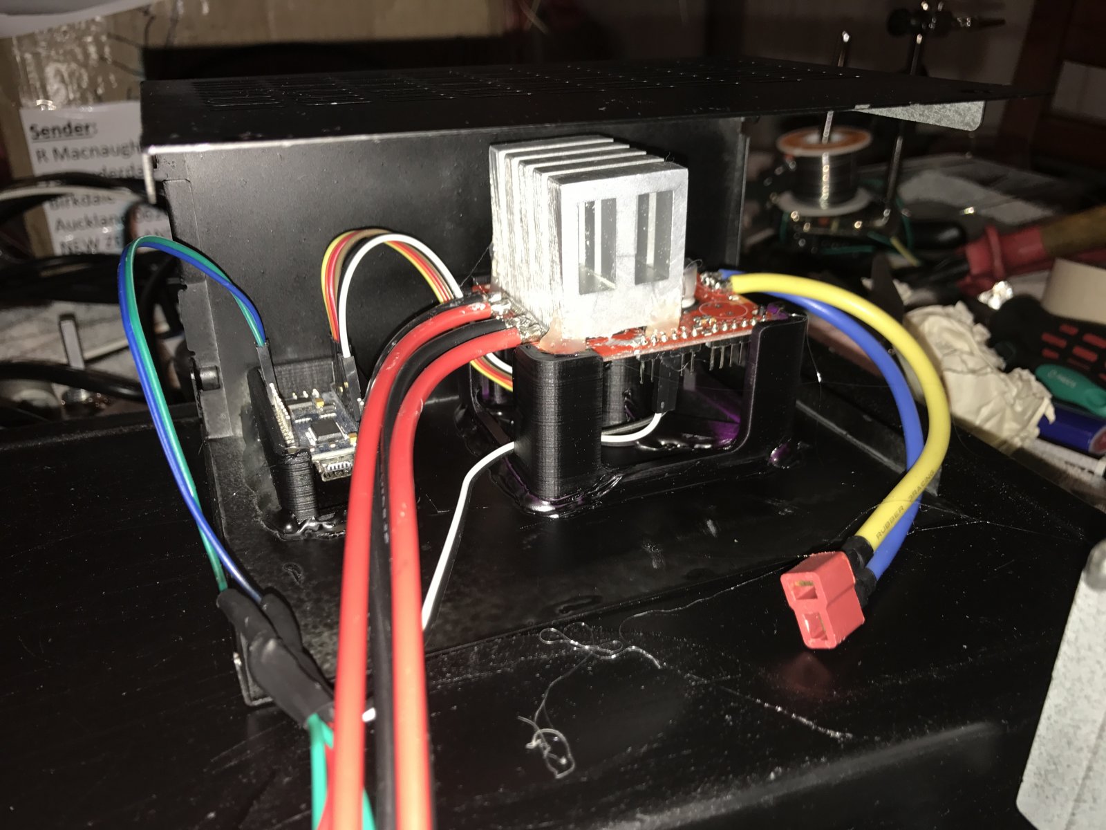

    All of the electronics are now housing and ready for plugs to be connected. I used an old half size PC PSU case and rewired the fan to a manual switch. I designed and 3D printed a little housing/holder for both the MM and the Arduino Nano. You can see the interior picture with the flash showing the 3D housings better. Surely with how i have positioned things, the MM and heat sink should get ample airflow... Some might call it an overkill! :D The PSU is housed in a cheap plastic box, nothing special but its hidden and contained. Need to drill a couple of holes in the lid for air flow but I will get around to that. Quite happy with the concept of it.
    IMG_0875.JPG IMG_0871.JPG IMG_0873.JPG IMG_0880.JPG IMG_0878.JPG IMG_0882.JPG

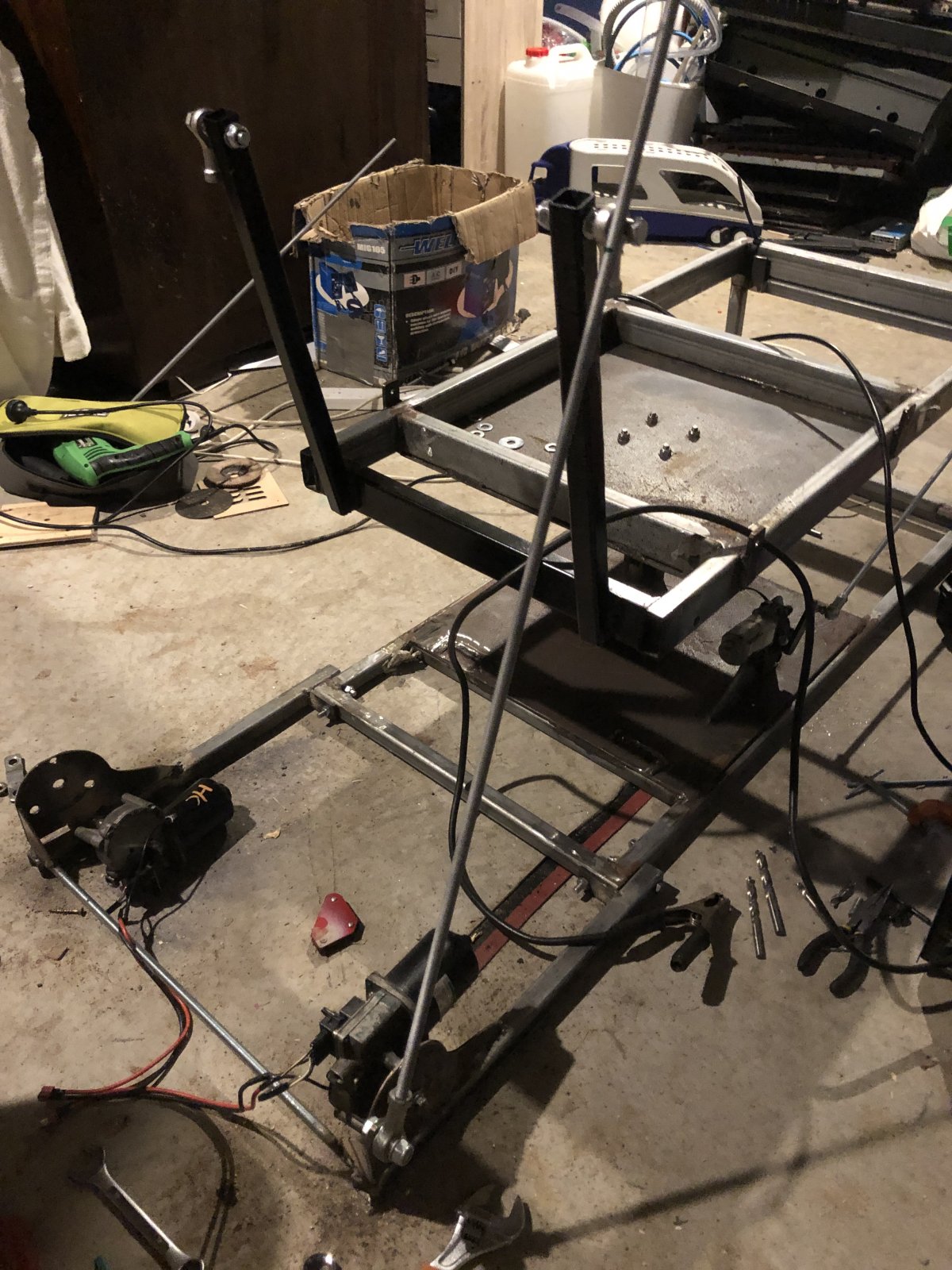

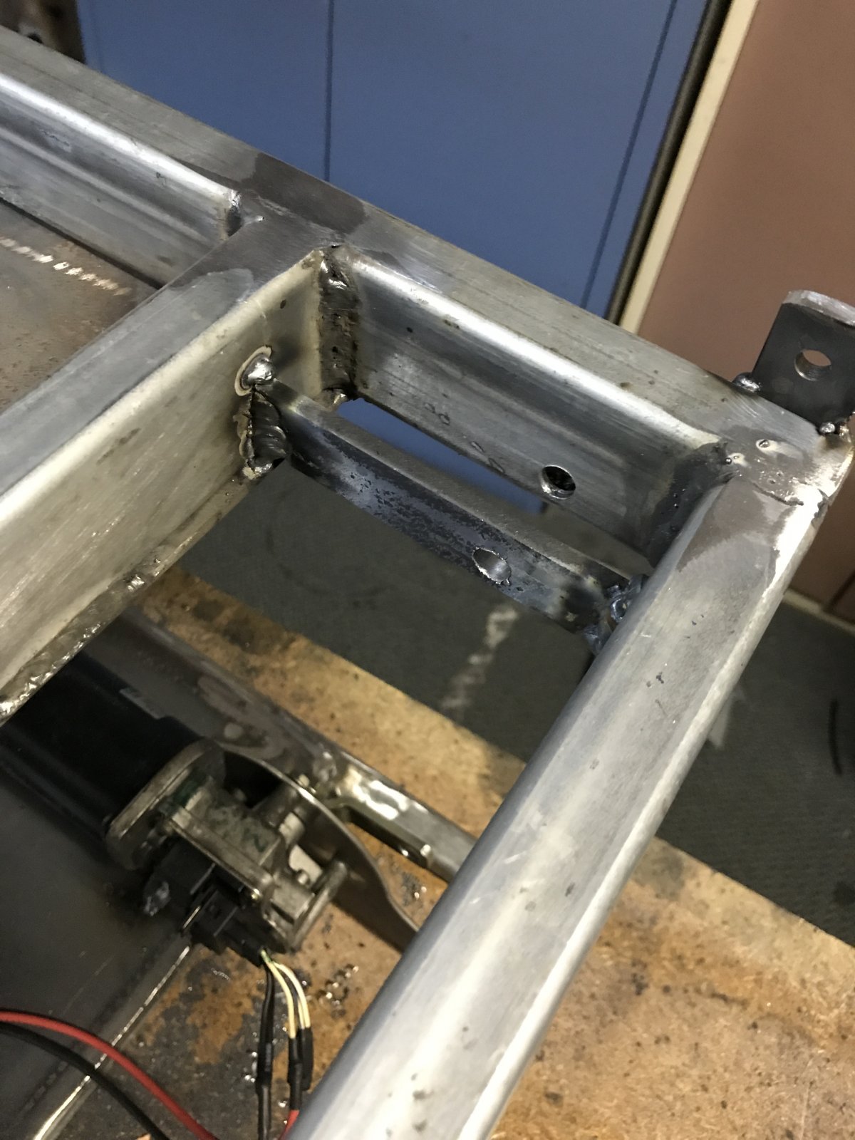

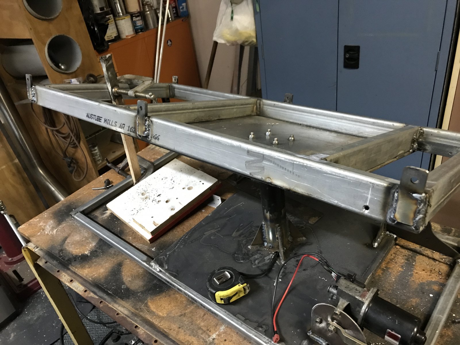

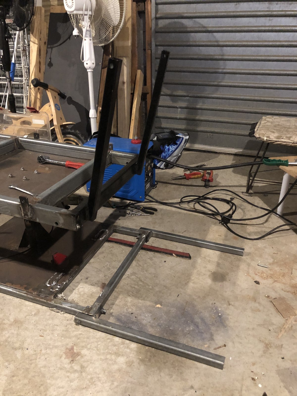

    And now the new motion frame and my existing rig are ready to mate and caress for the first time. All of the flat plate shown in the pictures is 5mm/6mm steel so it might not look it but its solid as a tank. All though there are no pictures yet of them, the armature is complete with tie rod ends/rose joints and they sit inside the rear corners of the frame by bolting through. I listened to advice and went through a few cutting disks and flipped my driveshaft joint so the pivot point is now at the top.
    IMG_0846.JPG IMG_0849.JPG IMG_0850.JPG IMG_0851.JPG IMG_0852.JPG IMG_0848.JPG
    Once I have tested it and am happy with it all working, all of the welding will get a tidy and the steel will get a paint bucket thrown at it so don't freak too much about the aesthetics at the moment. Yes I understand there is probably things wrong and things are exactly how they should be but this is all learning and part of the process for me. Half of the enjoyment is building it and so now its time to just bolt it all together and see how I get on. Only issue with that is I have to tackle the scaring software setup and settings debarkle........ :think

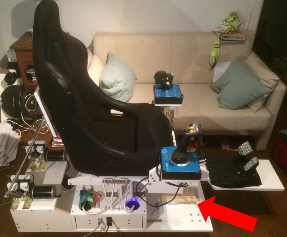

    2 x steps forward and 1 x step backwards...
    So mounted my rig to my motion base and found a slight design floor/oversight. I can confirm that my COG is accurate with me in it and its balanced nicely................ Only problem is, I am 125kg ish. So when I am not in my rig, 99% of the weight is at the opposite end of the rig over the feet and away from the COG pivot point. And with the motors being at the rear, that means there is a lot of weight putting constant strain on the motor shafts and armature which I am not happy with at all.
    Now the unintended, unplanned next step is to make a brace/support to take the weight when I am not in the rig that is on a hinge so it can be levered out of the way when I hop in and then put in place before i hop out.

  11. MarkusB
    Jun 30, 2015
    552
    4,215Coins
    +597 / 2 / -0
    Yes, I know what you mean and I did something similar. You will probably miss it in the post, so here is the picture again. The red arrow points to the peace of wood that I can bring into an upright position for locking the seat. The arrow head points to the hinge.
    Unfortunately I tended to forget to unlock the seat, even after applying this nice tag. Guess the motors did not like working against the lock. :)

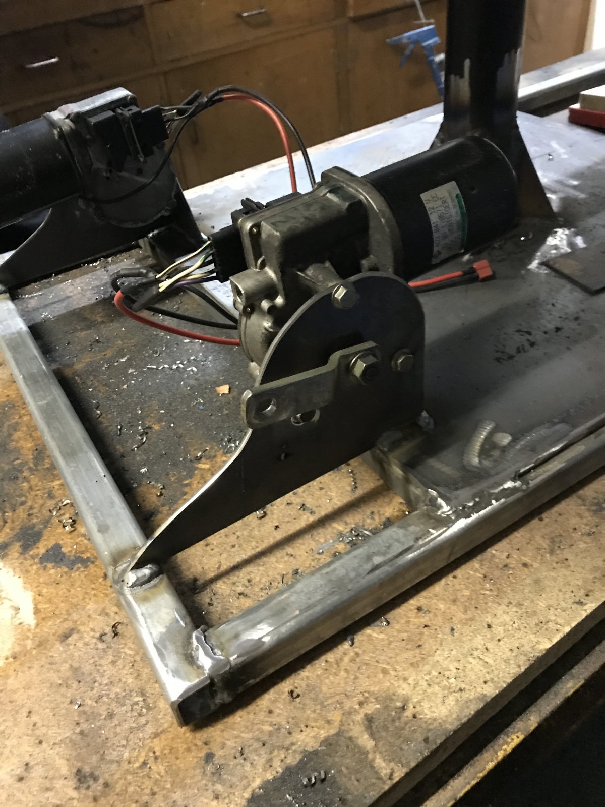

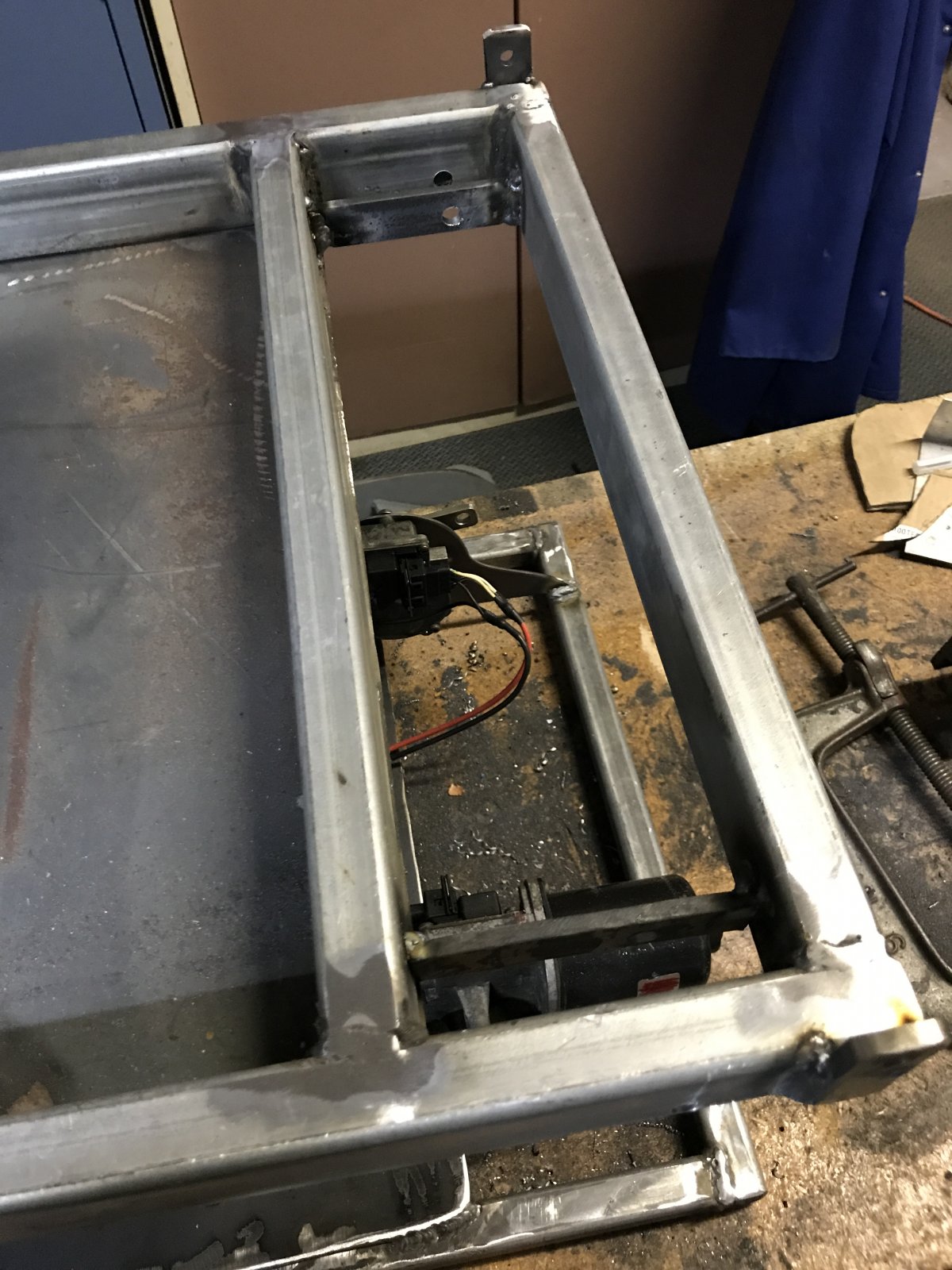

    I have managed to build an extension of my frame to accommodate rear mounting the motors and "shoulder" mounting the pivot arms. Unfortunately I haven't had the funds to be able to buy more steel and I have built the add-on with left over steel and off cuts which means its probably still not ideal but surely it cant be worse off. Two factors i have kept in mind while doing the add-on is "ease of having to break down and shift the rig" and trying to keep the overall size of the rig down.

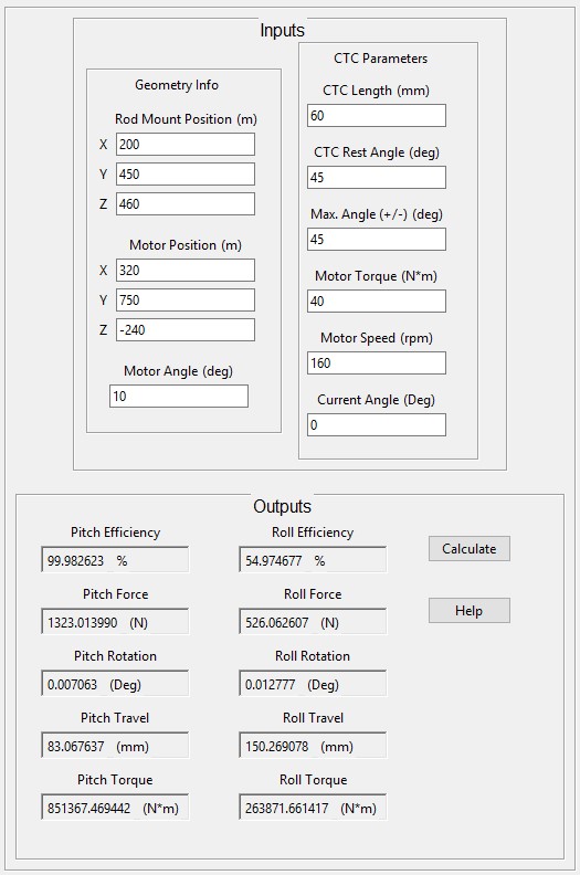

    I have done some calculations comparing before and after with the new mounting positions. The CTC parameters are just default options for arguments sake
    Inboard compact design figures:
    Shoulder mount design figures:
    Yes ideally the shoulder mount would be higher and possibly wider and moving the motors out wider to allow for better roll control but there is where the size and moving limitations came in to play.
    IF this all works = cool
    IF this all doesn't work = crying material

    • Added a brace at the shoulder mount end between the two mount points which also doubles as two shoulder belts of the 5 point harness mounting points
    • Attached a couple of cut down ratchet straps as travel limiting measures so if things go pear shaped, they take the weight rather than the motors
    • Solid welded the motor extension part of my rig rather than multiple bolts. I found it wasn't as rigid as I would have like so just threw lots of hot weld at it
