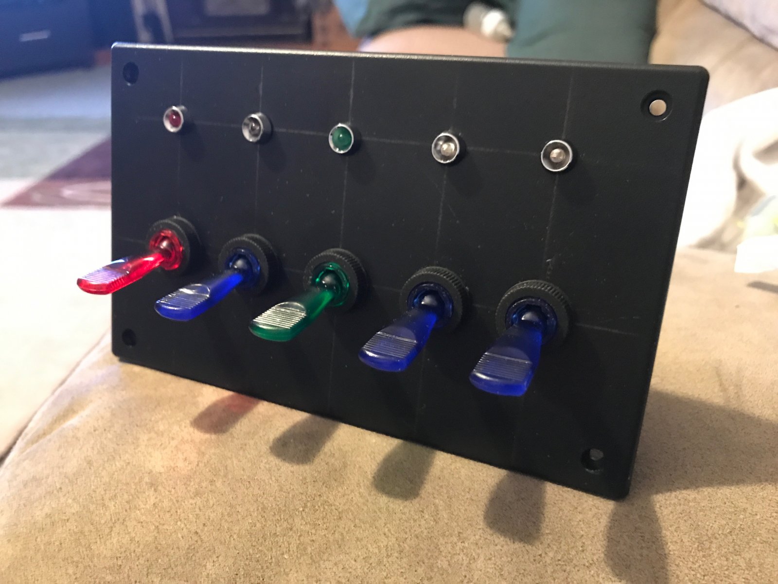

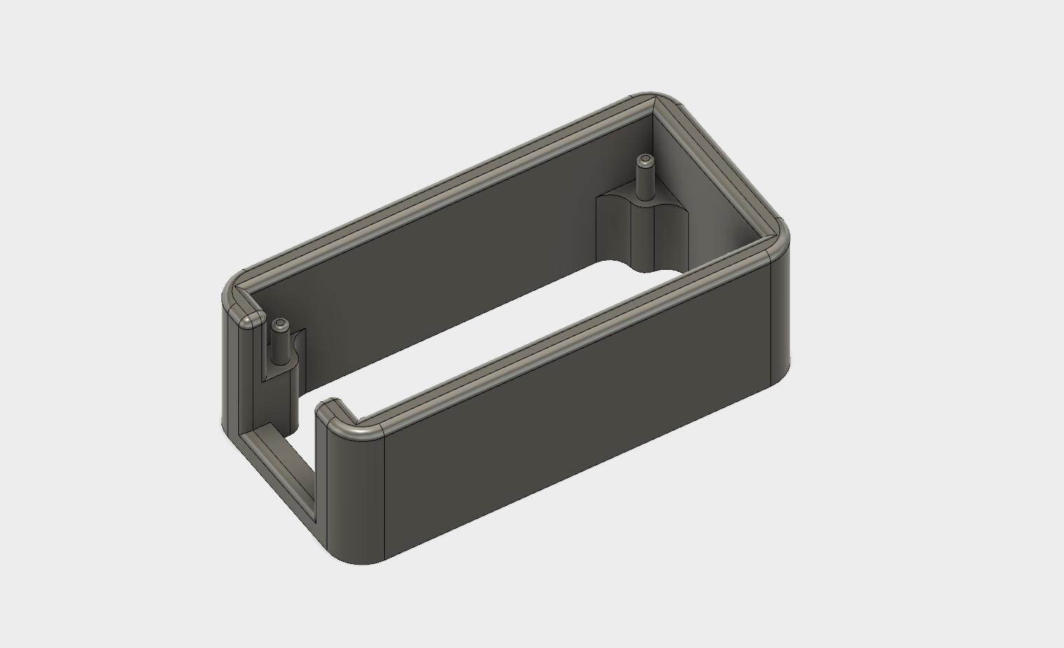

    In the mean time, I have been tinkering with electronics and wiring and making naff things to help make myself feel better. This includes making a nice little simple switch panel to power 3 x fans, butt kicker and master switch of motion system.

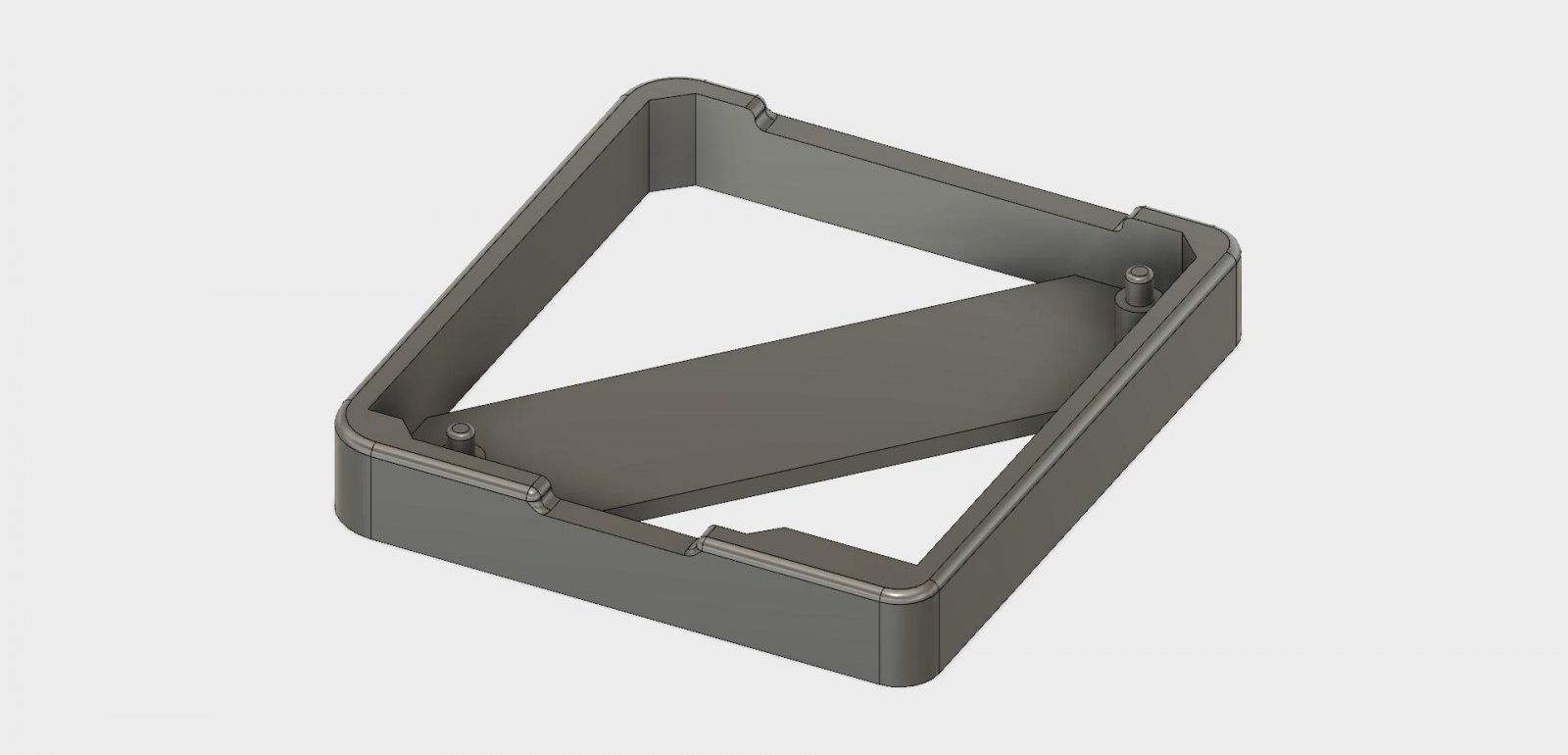

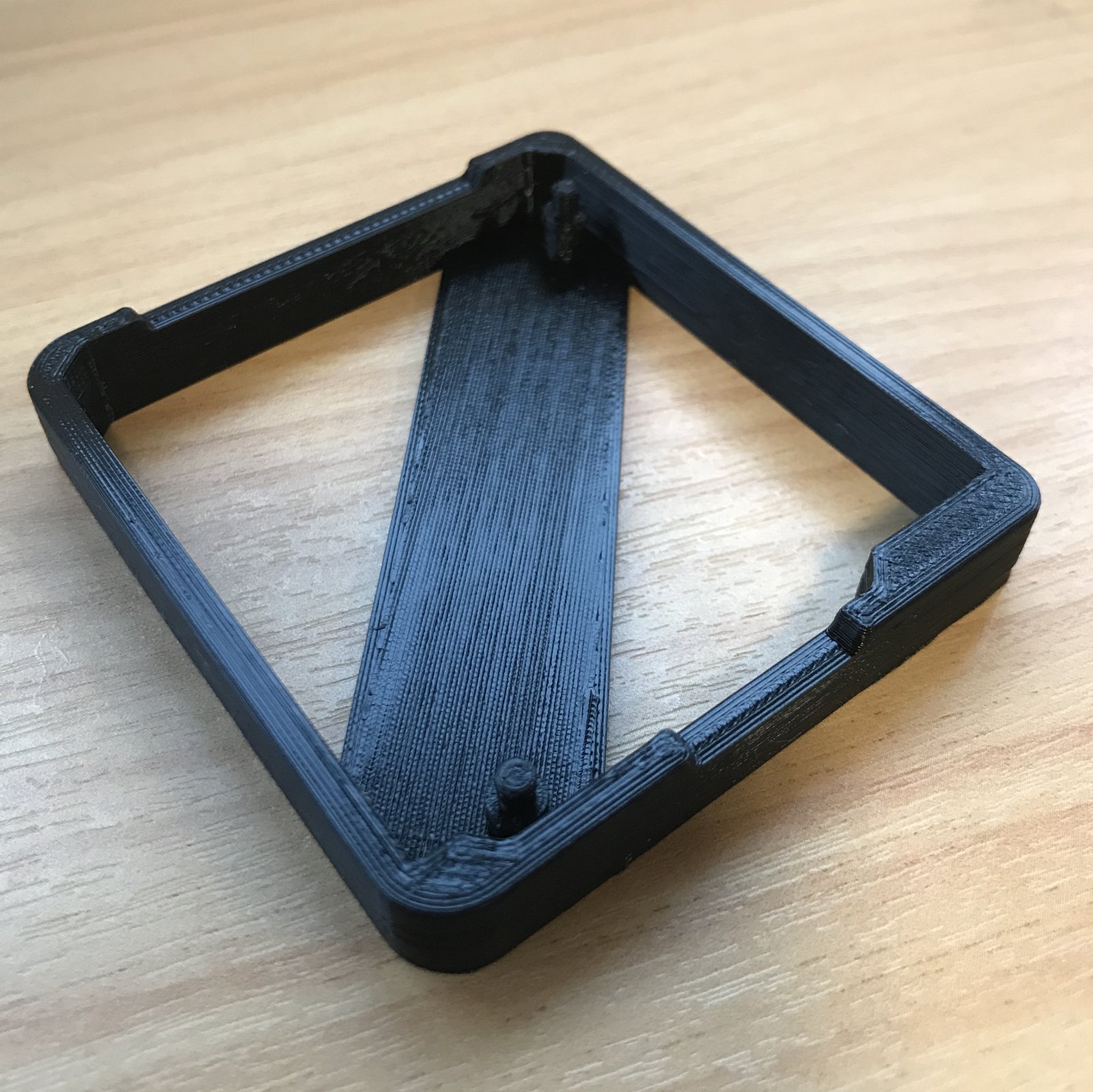

    I have also been burying my head in Fusion 360 and designing little board holders to 3D print for no other reason other than I enjoy designing things. Below is a holder for the MM board so that its not sitting on a metal base.

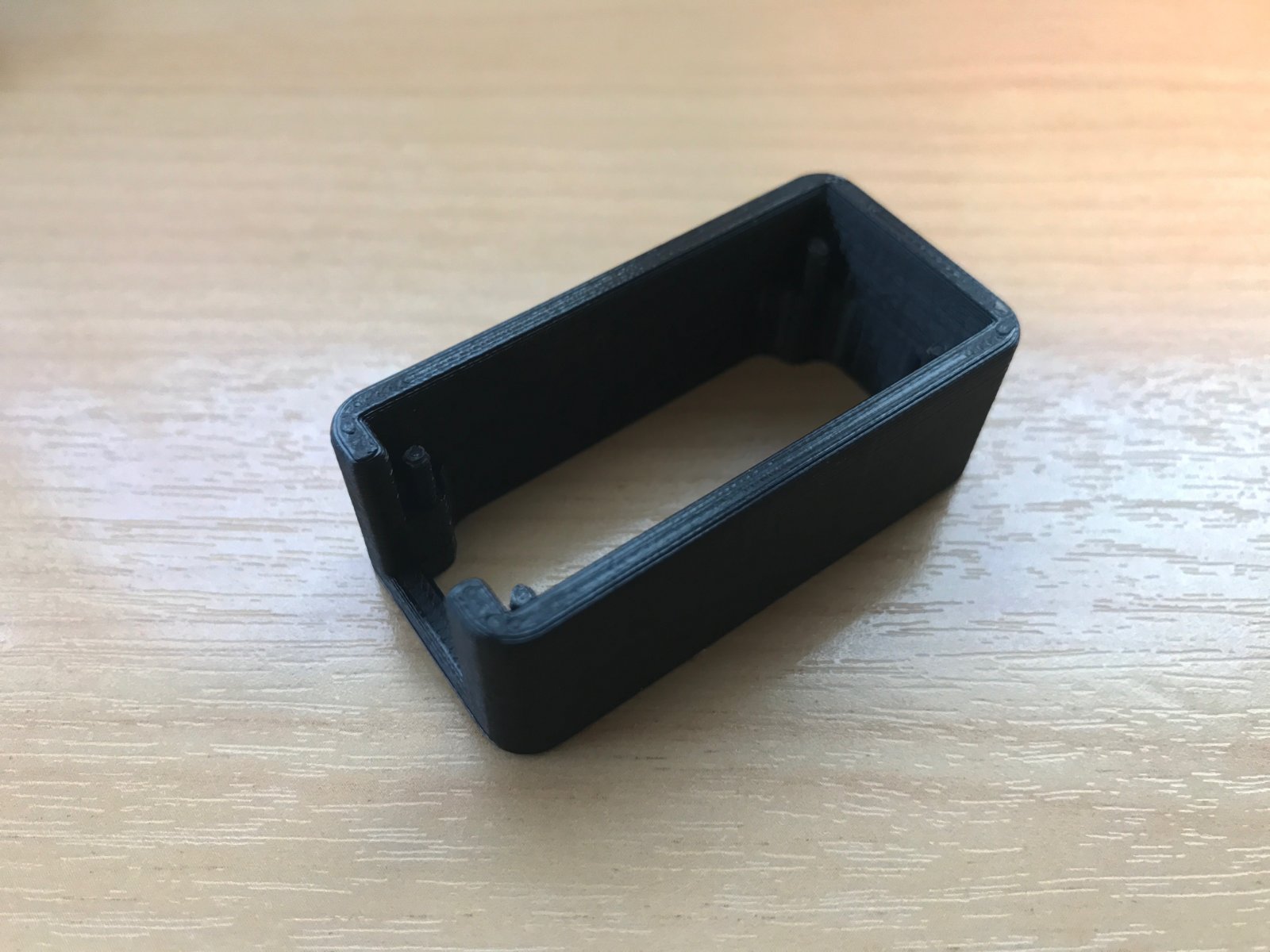

    Nice little 30-40min print for my arduino nano holder.

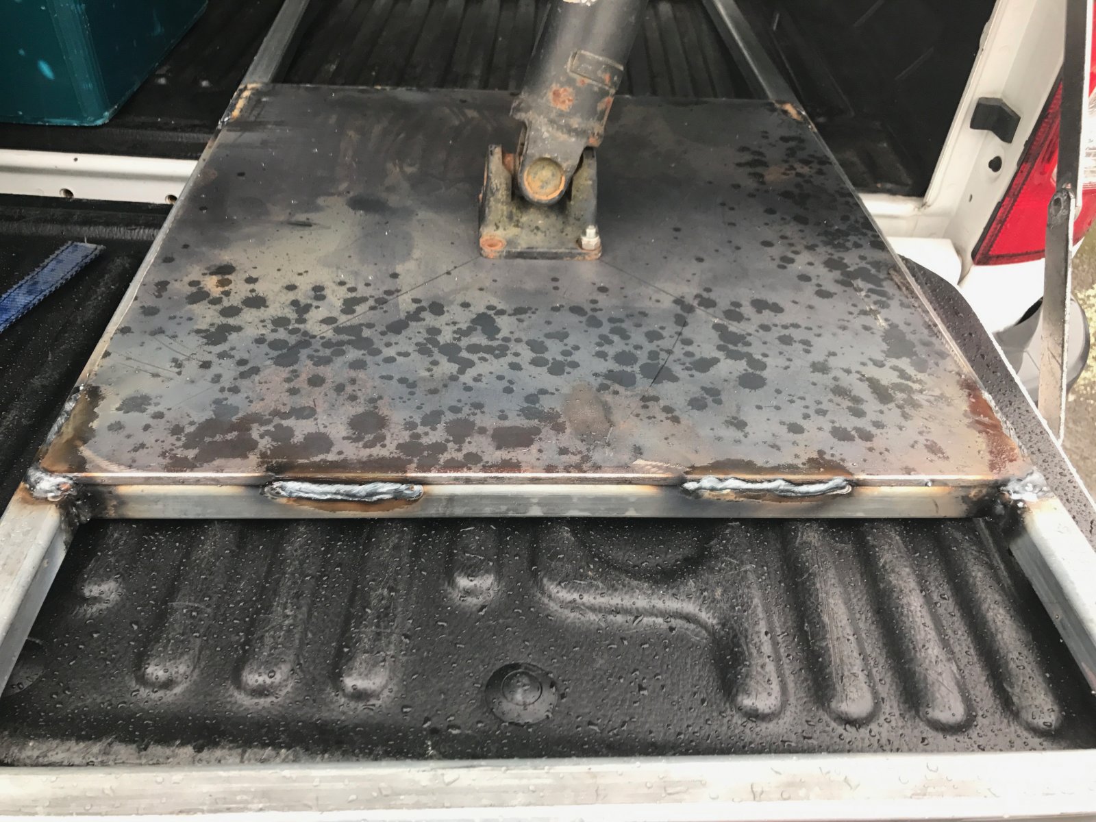

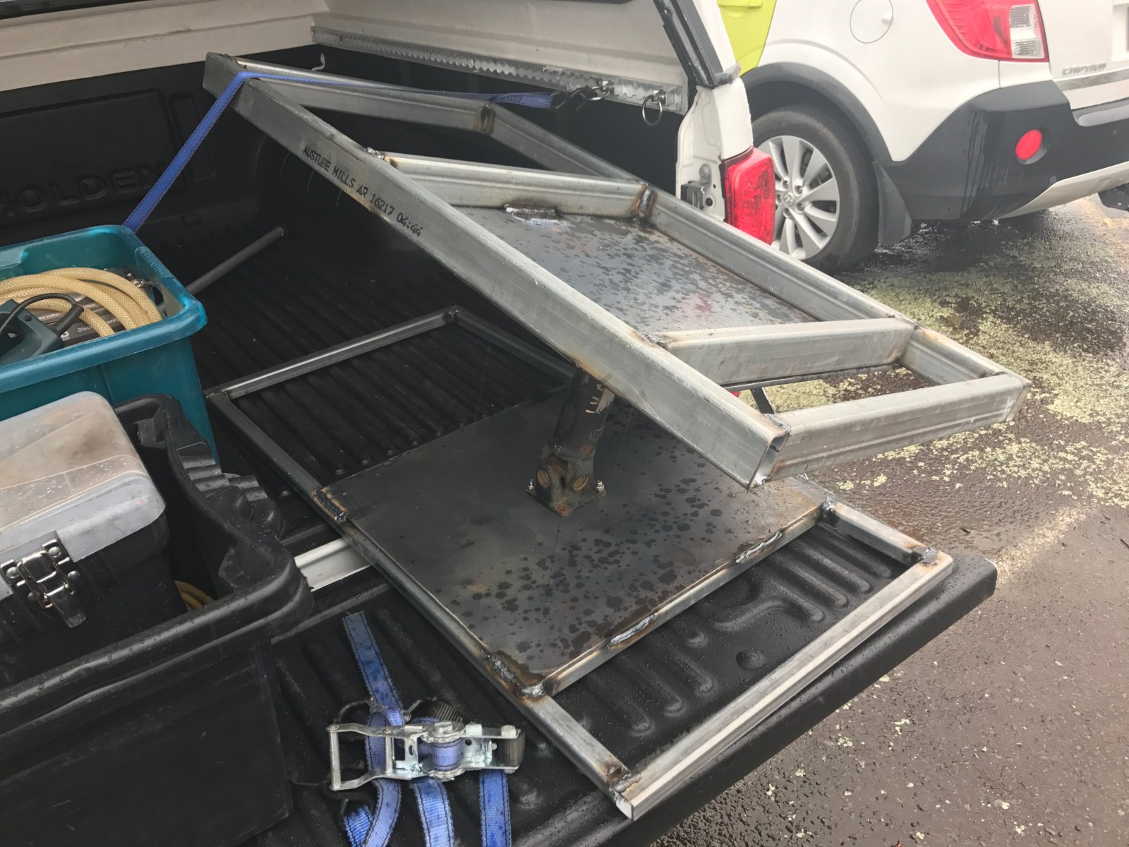

    And my frame, the frame is over half done. The pictures below are of it ready to be tidied up and a couple little add-ons for it to attach to my existing rig without too much drama. In theory, I will add some tabs on the side of the base/platform and then only have to drill some holes in the side of my rig for this to bolt through. My existing rig will sit directly on top of this so that i dont have to rebuild everything and it should make it easy to use with/without the motion side of things. So yes, the welds are untidy and the its still in bare steel but once all the welding is it, it will be ground down, tidied up and painted.
    This thing is solid and should last a long time. The ground frame is 25 x 25 box which is the same as my existing rig. The motion platform is 50 x 25 and the two plates are (i think) 6mm.

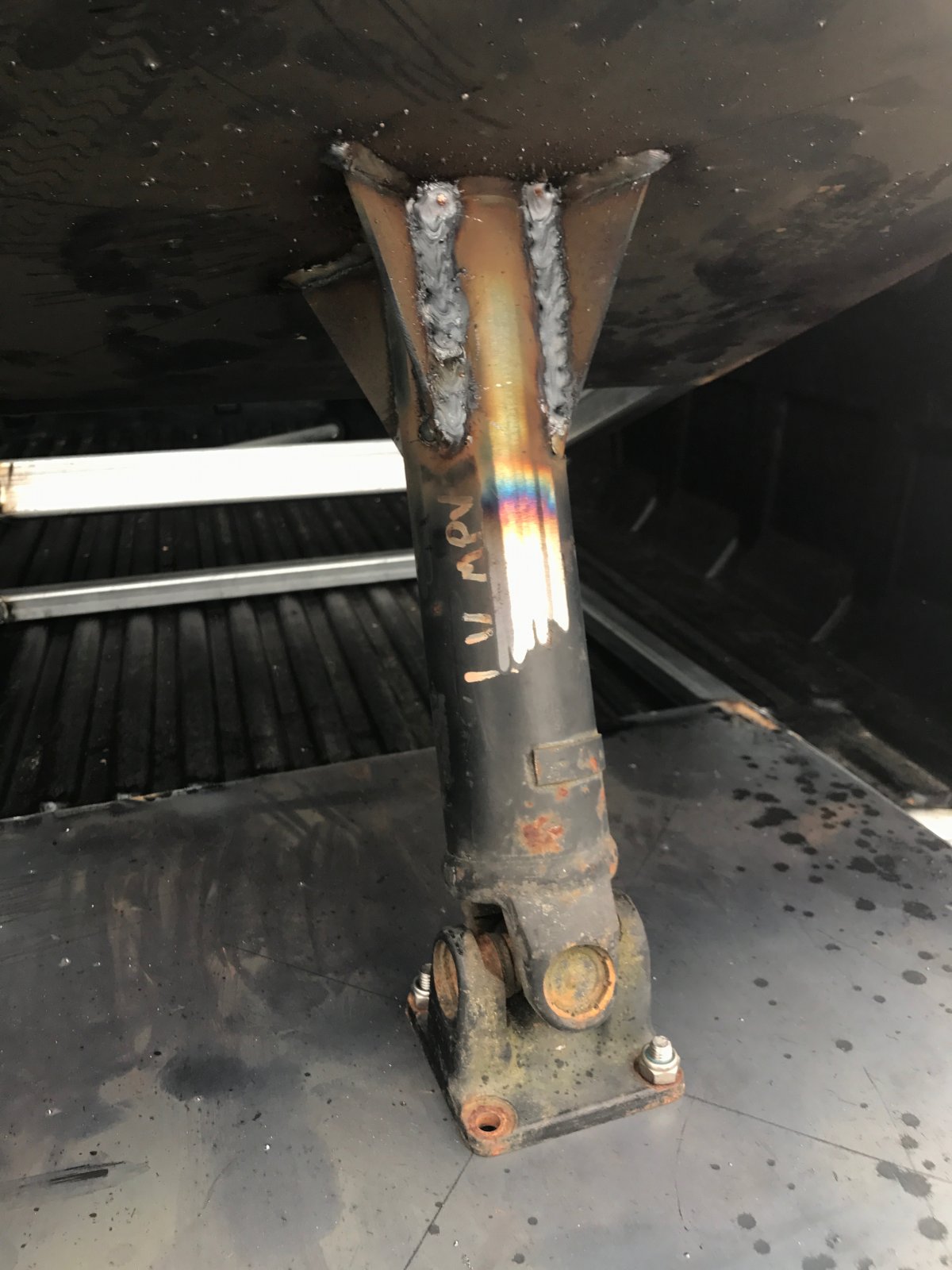

    I may have overlooked this, but how did you determine the position of your universal joint? Your static rig with its 3 monitors (which looks really nice by the way) as well as the movable steel frame look quite heavy, so that balancing everything out (with you seated) seems a good idea. But maybe you have done this already before welding the joint to the frame?
    And good luck with getting your rig moving!

    Hi @MarkusB , you are correct in that i have already done it. To find the center of gravity of my rig, I got a broomstick handle, put it underneath my rig about where i thought was close, hopped in, assumed my racing position and then rolled my rig over the broomstick until i found a "close enough" balance point. When seated in the right position, the COG is not too far in front of my bum hence why the offset position of my uni joint.

    Your frame is ok as long as you flipp it 180 degrees...
    The U joint has to be as near to the seat as possible.
